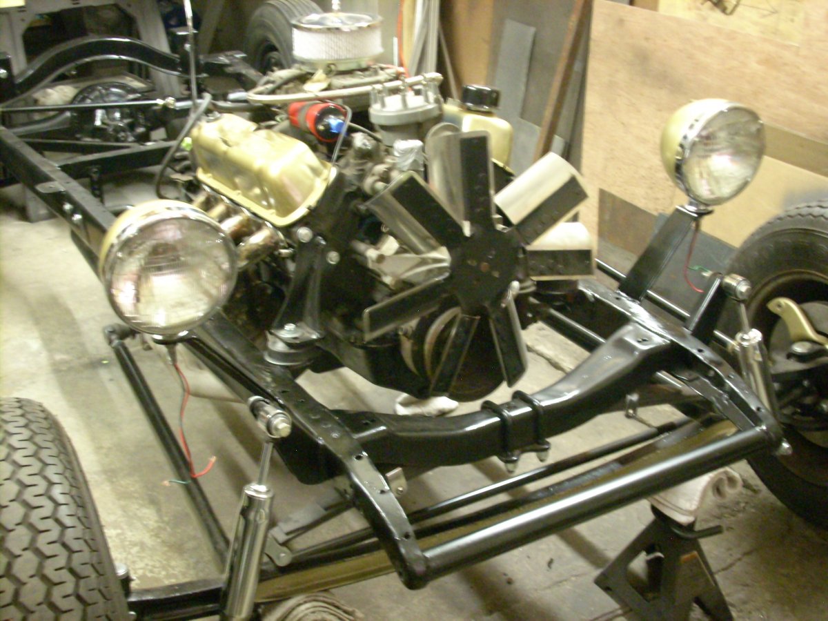

    Here's a '27 T bucket. Built this one from mid 60s Car Craft (I think) series on How to build a T bucket. Rectangular tubing with kick up in back and round tube front crossmember with spring perch.
    I believe the question is: Do you want a frame over front axle car (like pics above) or a suicide type frame with the spring perch at the front (T bucket style, like in Marty's pic directly above)?
