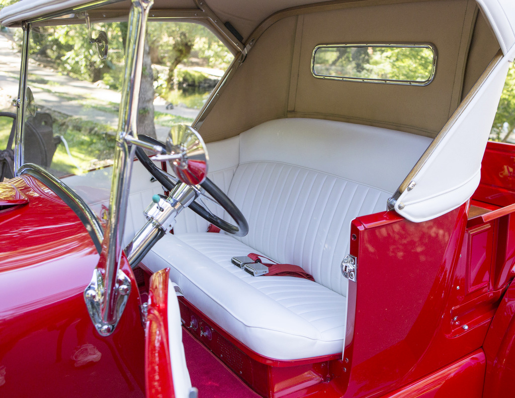

    I'm far from being ready for an interior in my build, but during these times I like to plan future steps. Today, I'm day dreaming about interior/seating options. My last T Bucket had a bench seat, but this time around I'm thinking of maybe Bomber seats..... or not. Here's a pic of my last T Bucket interior. The bottom was padded and lifted out. The back was padded and folded forward.
    So, what have you other Bucket heads come up with? Naturally, pics and a brief explanation of build and comfort would be cool, too.:)

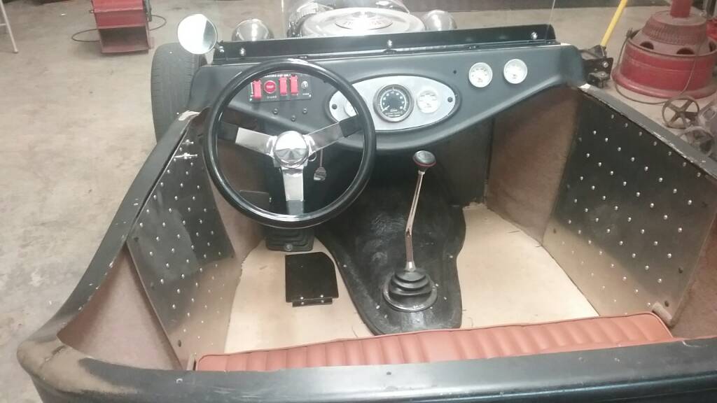

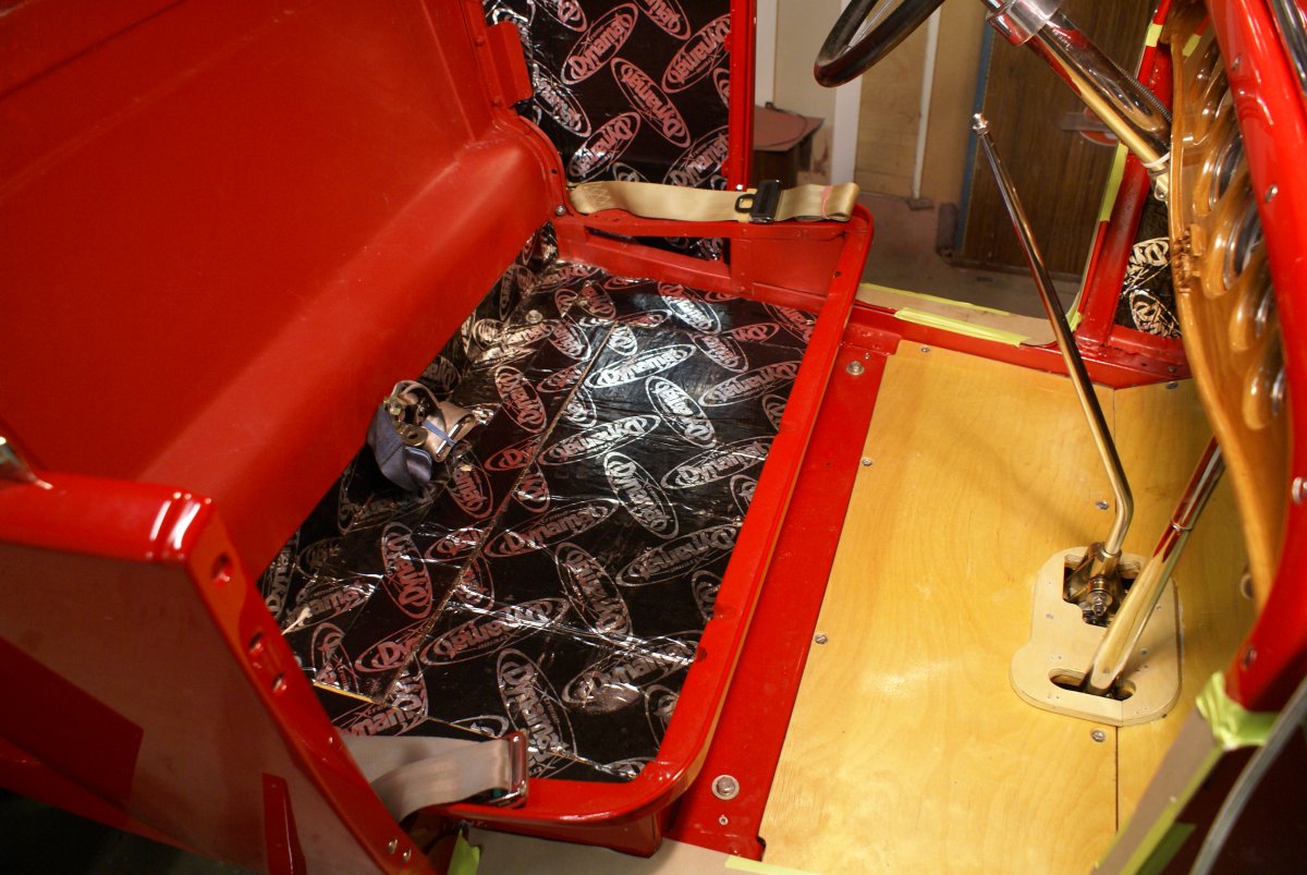

    A lift out bench seat gives room under and access to mechanicals. 13.JPG DSC06173.JPG DSC06174.JPG

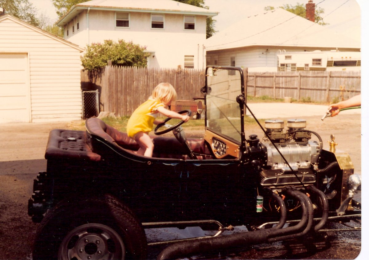

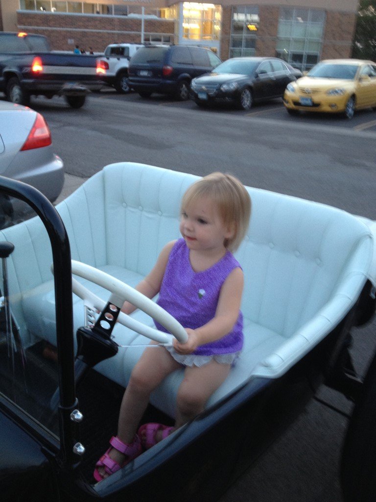

    I used white tuck and roll along with a few ****ons to define the top roll. Seat bottom has foam over webbing and sit on an adjustable height frame. Fair amount of storage space under the seat, too.

    What a little cutie. You've been blessed.

    Thanks, that's my granddaughter Ardun.

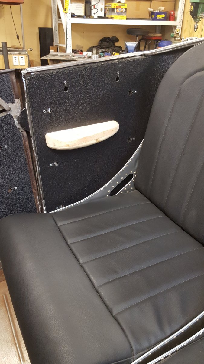

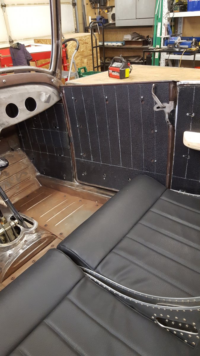

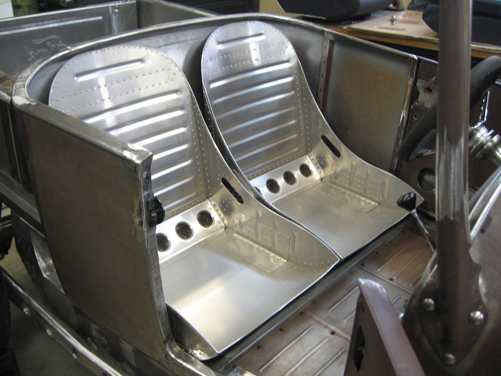

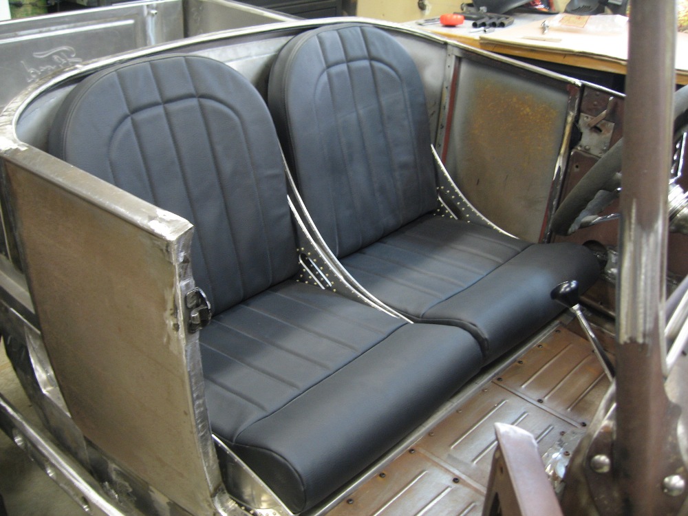

    As you may already know I have Frank Wallic aluminum bomber seats that are mounted right on the floor and then I had 4" thick pads made for the bottom and 2" thick pads for the backs.
    They give me every bit as much seating area as a bench seat in the same space would.
    I know that my steel RPU body is not a T bucket but the space (or lack of it :D ) is similar.

    Blue, the more I look at your set up, the more it pleases me. I got the measurements of where my seats would mount and a couple 22" wide buckets would be a good fit. Like your set up, they'd be close enough together, that they'd be as space effective as a bench.
    If I go with buckets, the p***enger side would be removable, to access the battery, which I plan to mount underneath. I'm still gathering info, but whether it's a bench or buckets, my plan is to have them as close to the floor as possible.
