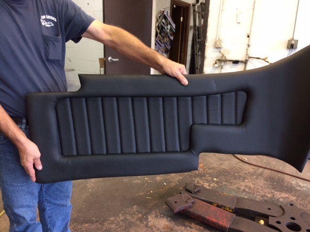

    Yeah, he made it. It's a pretty thick welt cord. You could probably have a thick welt sewn locally pretty low-buck.
    This is another reason I decided not to do my own...for the time & money in equip/materials, I can have a pro job done perfectly for less. I've installed complete Katzkin interiors, etc...but never sewn w/ proper welts, seams, etc.
    Heck, or let me know & I can have him sew up a length of it & I'll mail it out to you!

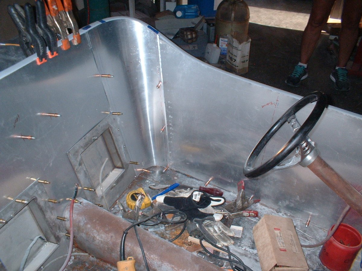

    Here's a photo of the progress I've made through today on my T's aluminum interior. I've only been putting this off for about 12 years. The panels shown still need final t*******. I plan to have the top of the aluminum 1/2" below the "roll" of the top edge of the body. Attachment to the body and framework underneath will be done mostly with rivet nuts and truss head screws so the panels can be taken out for any reason, like if I'd ever get around to actually dis***embling the car for paint. The aluminum is .032" and is just mill finish. It will be scuffed with a scotchbright pad to give it a "softer" look. I also plan to roll a couple beads in the panels to reduce oil-canning and just firm them up a bit. I plan on them being about 4" from the top and bottom, parallel with the floor and following the curve of the body on top.
    I also have photos of what's underneath that I could post if anyone is interested. This whole project has been way to tedious for me. I'd rather be building a frame, or an engine, figuring out suspension, or.....

    WOW! That's some nice work!

    Thanks! BTW...the two boxes on the back panel hold my two jet ski sized batteries. I have a 215 Olds aluminum V8 in the car, and the two small batteries seem to have worked out OK so far. There's just a Moon tank behind the body, lakes-roadster style I suppose, and there wasn't anywhere else to mount a big battery since the car is pretty low. The battery boxes are stainless steel, mostly because I had some stainless sheet, and that is easier to fabricate and weld for me than aluminum.
    I have a pair of dune buggy fibergl*** seats that go in the car. I need to get some covers, or perhaps just pads, that would be held in place by strips of Velcro. I had the seats mounted directly on the floor, but when I re-install them I think I'm going to build some short risers, perhaps 1 1/2" tall or so. I think that will help just a tiny bit with leg room.

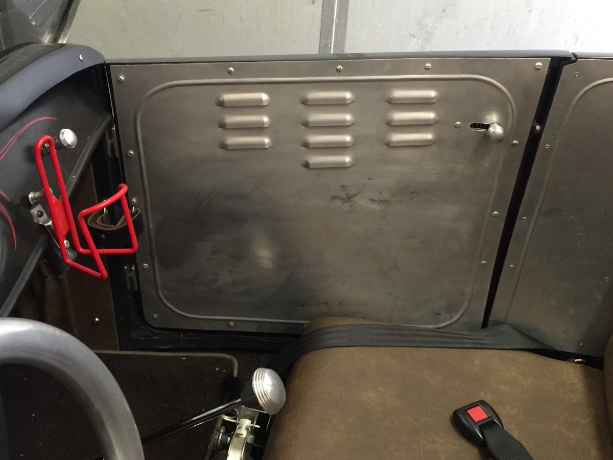

    Here's my aluminum door panels. Not as nice as Lake-Harley's, but they get the job done. image.jpeg

    You've got to be kidding, right? I think the bead rolling really sets the panels off...and louvers too! Great looking work.
