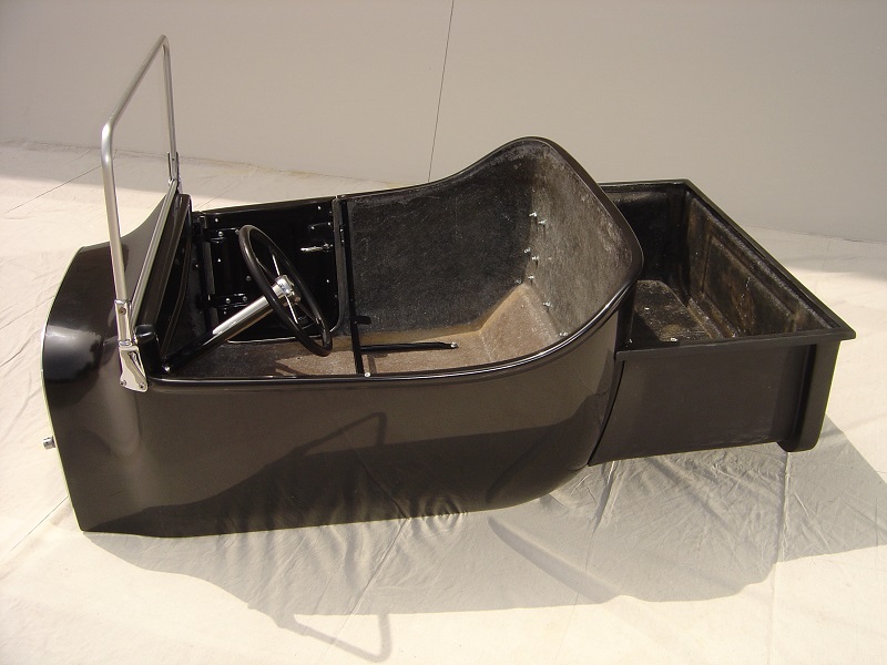

    That long steering column reminds me that, while my body is extended 8", I'll need my seating to give good back support as well as a good angle for my arms. In other words, having my arms fully extended is NOT the way to go. A slight bend at the elbows is needed to provide good leverage for steering.
    In those pics posted, it appears the long column was used to bring the steering wheel closer to the body. What should have been done, would have been to move the seats forward a little. Also, sitting completely on the floor and your legs fully extended, is not a good position for your legs while driving. A slight bend at the knees is needed for comfort. At least that's what I'll attempt. In this pic of me sitting in a stretched body, my back touches the back wall of the body. In reality, I'll probably need to be sitting a few inches forward. I'll either move the back seat panel forward more or make a thicker back seat panel.
    Moving forward a bit, will give me the bend in my knees and arms, and a good, comfortable position for steering leverage. My arms and knees will be bent a bit more than in the pic below.
    Other than that, that car has a nice looking interior. Just not practical. And that column support would make wearing a "jock cup" mandatory! OUCH!:eek:

    dunno know; think moving your seating position forward would negate some of the body stretch. Maybe I'm looking at this differently; but if the body is extended for more leg room; the steering column is going to have be longer and at a lower angle, to get the wheel in the right place. I know a couple of inches are taken up in the longer cowl; but there is still five inches in the p***enger compartment. How does CCR deal with the column position, drop, or support? murpa's column support is a pretty noticeable departure from the norm; but sure did raise some comments.

    They use a small column support under the dash and I'm sure the column is longer than usual, but not much. The column goes through the lower part of the firewall and is supported there with a tube bracket that supports the lower section of the column. One thing in my favor are my long arms. Their website gives the impression that the column for the stretched body is 28" long. The regular column is 25".

    Sure; I was looking at CCR's web sight a little closer and noticed they had a different drag link,steering box mount, column drop, and column length for the longer body;
    but didn't come across the pictures you posted. Inches still don't add up for me; but
    CCR has been doing this for decades, so it should be set-up for comfortable driving. Might be interesting to see a couple of direct side shots of both body styles to compare column angle and wheel placement.

    Some of the pics I have were sent to me from a tech at CCR. I'm surprised he hasn't gotten tired of all my questions and requests for measurements. Yes all the items you mentioned are changed for the longer body and as you stated, CCR's been doing this for a while, so I tend to trust their engineering. I did that when using their parts, I just need to go with it.
    Check out this seat base they're getting ready to come out with. It would have to be trimmed for a door (makes me almost wish I'd not gotten a door), but it's an option.
    This is what he says about it:
    "This is the Seat Base Riser we are going to be using in our new CCR interior. The base allows for under seat storage and to allow strapping to be used on the actual seat board to get more cushion. The steel structure for the door jam support that will attach to it is not quite done but getting close. This will replace the tube support we install in all our door bodies for those that want to go this route. (or with minor t*******, it will fit over it)"
    Rich, here's another angle showing the steering column length and angle.

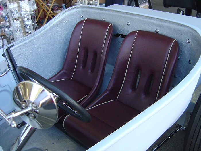

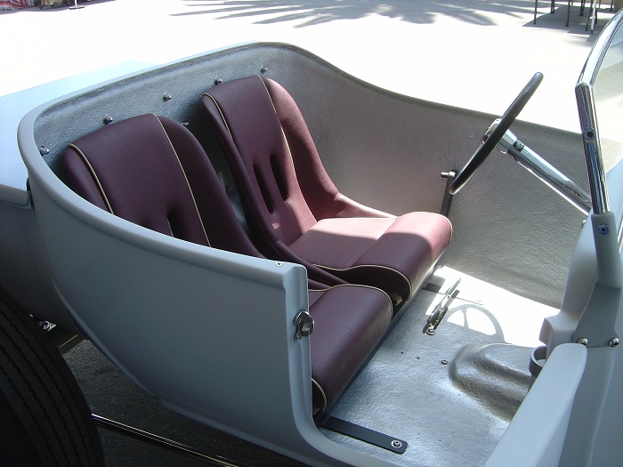

    Now, a bench seat is typical T Bucket fare and it's a design that has long been used because it works and it works very well. But as you and I agree, this isn't a typical T Bucket build. Combining 2 different styles goes against everything I learned in art school. So, for a DIY bench to work, it would have to look like it belonged and what I had in mind is beyond my skill level.:oops: And ALL of this is waiting for the body, which is about 2 weeks away. So, it's theories and subject to change. If ANYONE has a solution for a suitable back panel for a bench seat and it's location.... PLEASE chime in. I'm honestly at my wits end.
    So, I'm back to 2 separate seats. Probably these.
    They're roadster seats and I've always liked the way they look. They're a clean, functional design. They fit my budget and my ***.;) I may use 2" channel to get them off the floor a little or not. They're 5.25" at the front bolster. Will they fit behind that front cross bar? I'm not sure. They're 18" front to back and my math says they should. If need be, they could still be removable. I won't have storage under the seats, but I'll have that space behind them for my fuse panel and a little storage. Importantly, I won't lose any leg room and I'm still going to do my own interior panels.
    Have a look at this pic. These are NOT the seats I'm considering. They are high end leather and priced accordingly.$$$

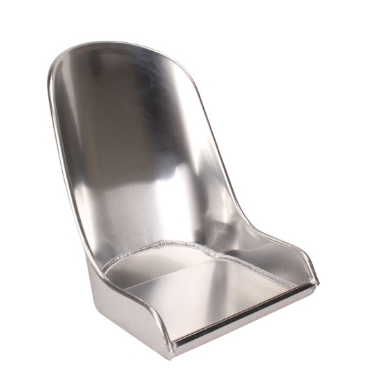

    Truth be told, if I thought they'd fit and I could afford them, this thread wouldn't even exist. As far as Bomber seats go, these are as good as I could afford.
    https://www.speedwaymotors.com/Speedway-Aluminum-Hot-Rod-Bomber-Seat,4043.html
    They're on sale, now. They have a 20* lay back and only weigh 6.08 lbs, which I love. I could mount them on a wood base, secured by the top of that cross bar and call it done. But the seat cushion Speedway offers seems to have mixed reviews and I like to drive my cars a LOT. So, the comfort level is questionable (hmm... maybe thicker foam?). The width inside is only 16". That's enough for me, but would seriously limit my p***engers size. Although, I was usually the only occupant in my old T Bucket. Hmm..... Of course, college girls could......and then I'd..... never mind.:)
    Damn...... now I may have to re-evaluate them! :D
