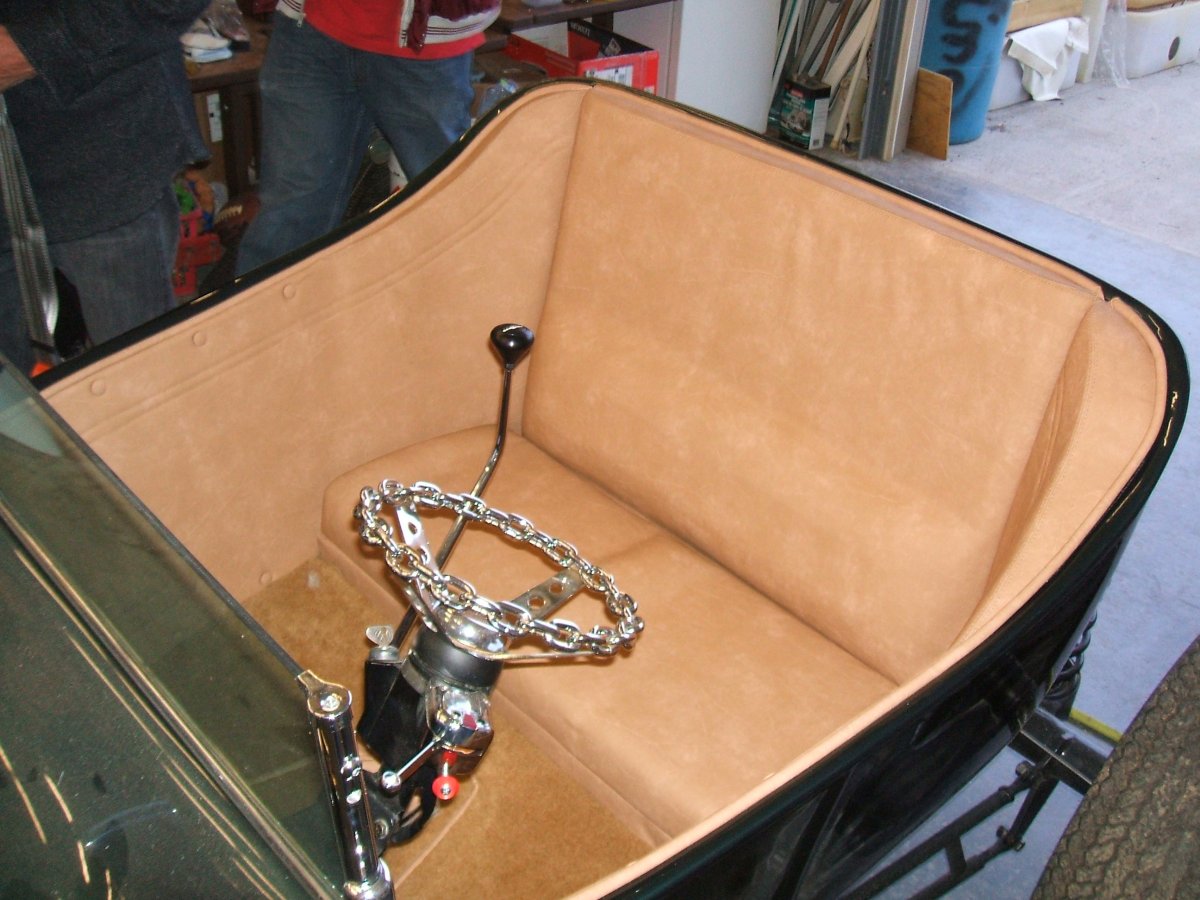

    Okay.... back to interiors. Now, I like this and while it's not what I have planned for my ROADSTER, it's a nice seat set up. Ignore the steering wheel and tilt column. The seats are low and the color is spot on. I also like the rounded rear corners on the side panels. Notice how the panels get thicker in the curve.
    If I was to go back with a bench, I'd try to emulate this arrangement.

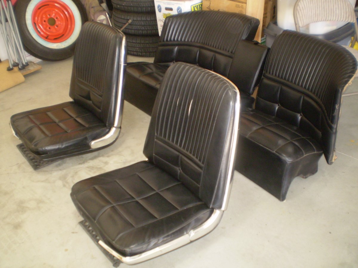

    Pricey, but maybe you could sell off the fronts.
    The rear center looks like it's attached, but if you could use just the rear seats...
    https://www.jalopyjournal.com/forum/threads/t-bird-bucket-seats-with-wrap-around-rear-seat.1015797/ t bird.jpg
    More info
    https://www.jalopyjournal.com/forum/threads/66-t-bird-rear-seat-in-shoebox.778866/
    and cheaper!
    https://www.jalopyjournal.com/forum/threads/t-bird-wrap-around-back-seat.1070553/
    and without the lower that will need to be redone anyway. I really wonder how well these would fit.
    https://www.ebay.com/itm/64-65-thunderbird-t-bird-rear-seat-tops-and-panel-/222513477859

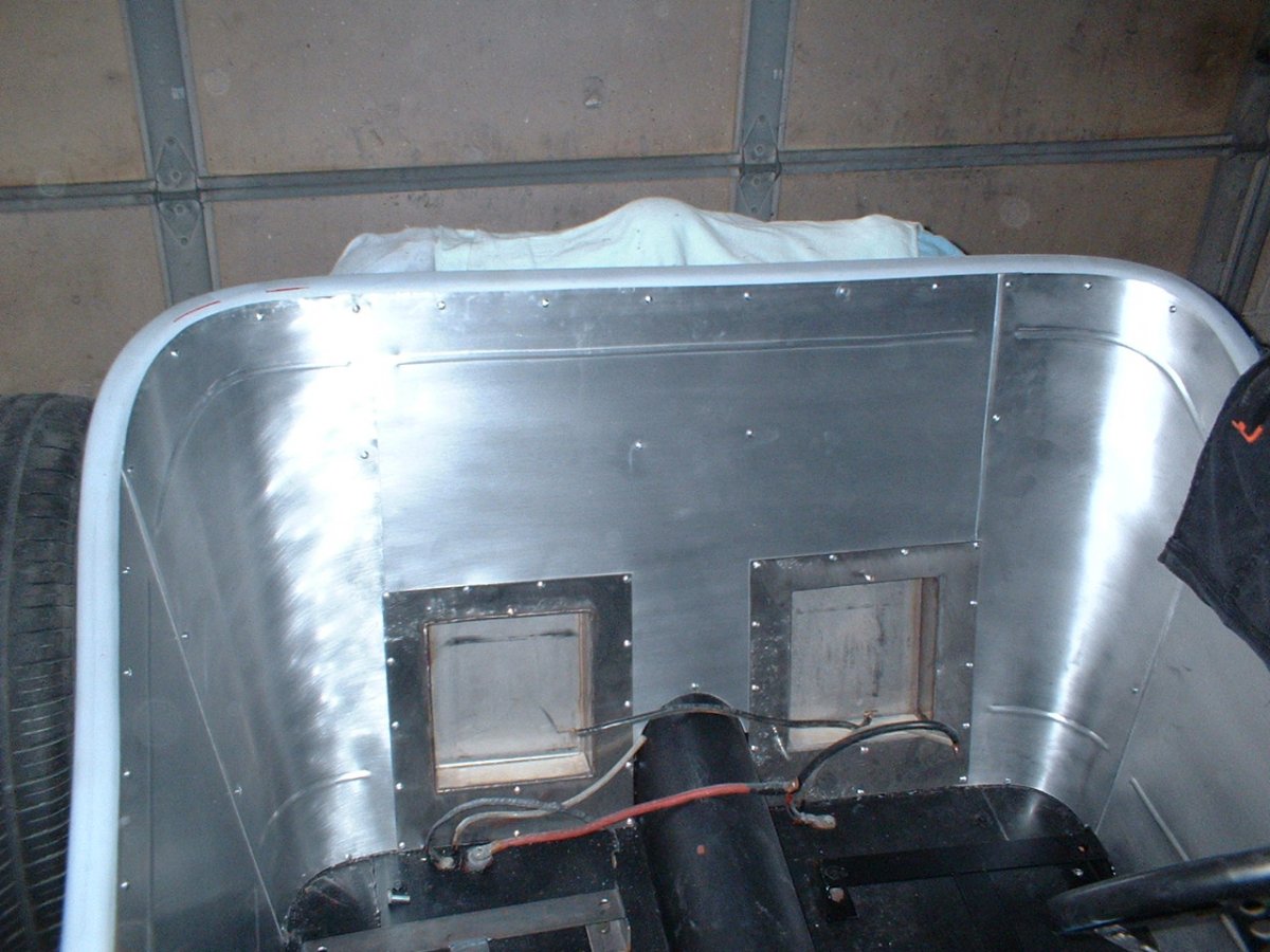

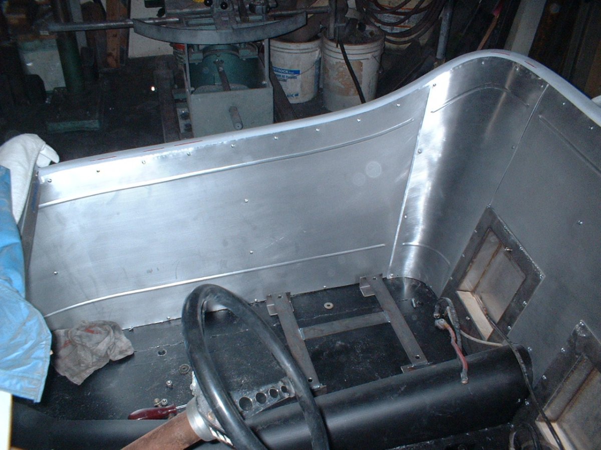

    I posted an "in progress" photo of the aluminum interior going into my T a few pages back. I finally got the aluminum panels finished and fitted, bead rolled for a little character, and installed with rivnuts and #6 truss-head screws (99 of them!). The panels have some "warts" that I don't particularly like, but I don't dislike the results enough to re-do them! I'm kinda lazy that way. My fibergl*** dune buggy type seats went to the upholster a couple days ago for seat and back pads that would just Velcro into place. He said it would be "next year" befor he would have them done, but I guess I wouldn't be driving the car much this time of year anyway. I also built some 1.5" seat risers to mount the seats rather than directly on the floor. I think the slight bit of height will make the seated position a bit more relaxed. Now would probably a good time to blow the whole car apart to clean and paint everything. I grow weary every time someone calls it a rat rod. Gr-r-r-r!
