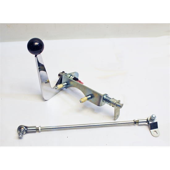

    Well, aside from hanging a Pre '66 Mopar push ****on shifter on the seat riser
    or the very common Mustang t handle shifter,
    what would be a good compact, inexpensive and easily installed shifter?
    Most aftermarket shifters seem to take up a big footprint and stick up from the floor way too much...
  3. tfeverfred
    Joined: Nov 11, 2006
    Posts: 15,788
    tfeverfred

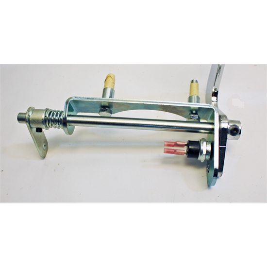

    I was able to find, after a LONG search, the shifter made by Total Performance. I used one in my old T Bucket. What makes it unique, is that it's low to the floor and the handle is on the right side of the transmission. "Mountainman", on the Tbucketeers website found a link on Ebay amd I scooped it up.
    Here it is with a black shift knob in my old T Bucket. It was low and out of the way. Also, no one ever kicked it by accident.

  5. tfeverfred
    Posts: 15,788
    tfeverfred
    Here it is, still in the original TP bag.
    I really love this shifter.
    Atwater Mike likes this.

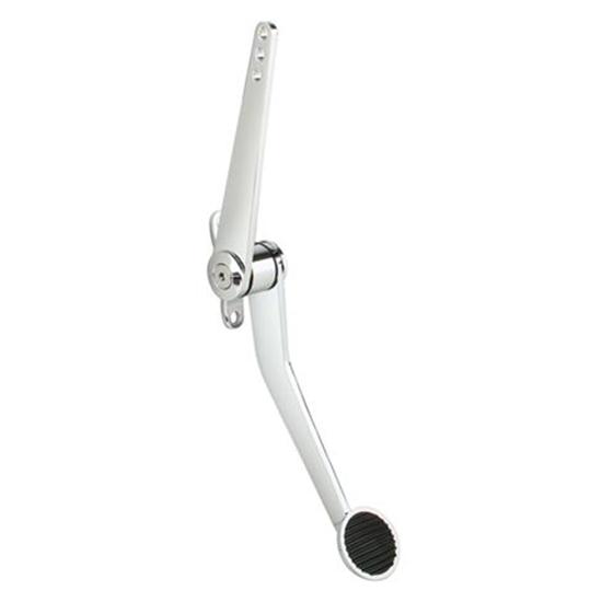

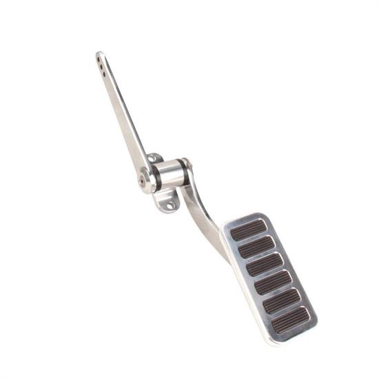

    So to continue the 'interior' theme, what about gas pedals and brake pedals.
    Both need to be sized appropriately (small) and fit the builders theme.
    The 's****' style gas pedal is common, along with the round brake pad.
    Any pics of others that may work as well?
  10. tfeverfred
    Posts: 15,788
    tfeverfred
    I've found that a a s**** for the gas and a slightly larger size pad for the brake works good. In my first T Bucket, the gas peddle was kind of large and round. About 3.5". The brake peddle from TP was about 2"x3" and that's what I used. Now, TP's manual said to bend the brake arm a couple inches to the right, so the arm and peddle would clear the steering column that mounted to the floor. That's what I did and I had to mount the brake peddle long ways. Space between the pedals was small.
    Well, I have big feet. Lke size 12 big. So, I wore sneakers instead of boots and the closeness of the peddles was still a problem. That's when I switched to a s**** gas peddle and all was good.
    CCR's steering column is meant to go through the lower part of the firewall. So, I won't have to bend the brake arm. I have installed this brake peddle pad from Speedway. It's 3" wide and it was $20:
    For the gas peddle set up, I'm going with the adjustable s**** type:
    The pad is 1.5", it matches the brake peddle and the ***embly is only $30. But I think I may have enough room for this gas peddle set up, which I actually prefer. The pad is 2"x4.5" and $60.

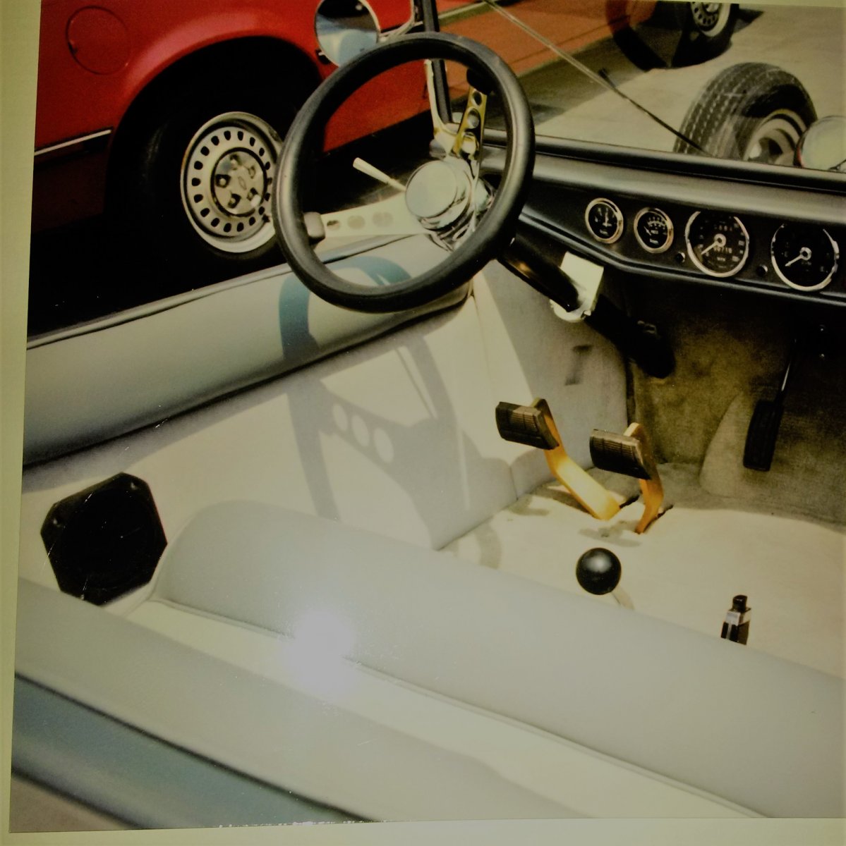

    Fred, it's a shame you couldn't take a couple days off and fly out there and pick their brains on this stuff while looking at the parts. They have "been there, done that' on so many things.
    I agree that sitting flat on the floor is uncomfortable, even with the seat bottom tilted. Try sitting on the ground with your **** the same height as your heels. It gets tired after a short time. Having even an inch or two under your **** makes a difference.
    I went back to that figure I posted on ergonomics on page 9 and the big guy had 4" seat bottom height at the back. Too much for a T, but once you have the body at your place and can try out the seats with some plywood shims to raise as needed, you WILL make it the best compromise possible.

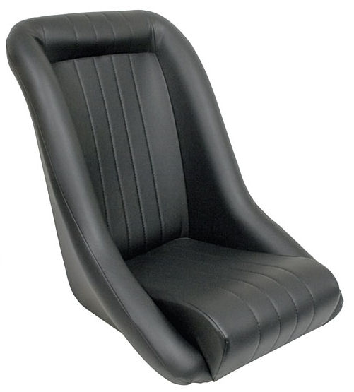

    I've been thinking about that today. I'm just going to let the body show up and go from there. I'm so tired of changing my mind. There are a lot more seat options than I first thought.
    I'm down to these two. I'll either use Rotten Leonards frames to make a bench or buy 2 Empi Low Back bucket seats. My wallet says make a bench seat. I'll see what happens.

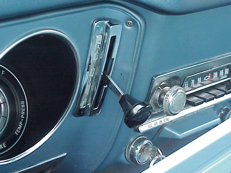

    As for a shifter I always thought I would pick up a used 1/4 stick or short handled aftermarket shifter and mount it on the dash ,to work up to down . Mopar vans and motorhomes used something like this in the old days.Just a thought .
  20. swade41
    Joined: Apr 6, 2004
    Posts: 14,999
    swade41
    from Buffalo,NY
    Corvair post-45-0-37610800-1425956643.jpg 4794687549_350bccbb3a_b.jpg also had a dash mount shifter in various styles through the years.
