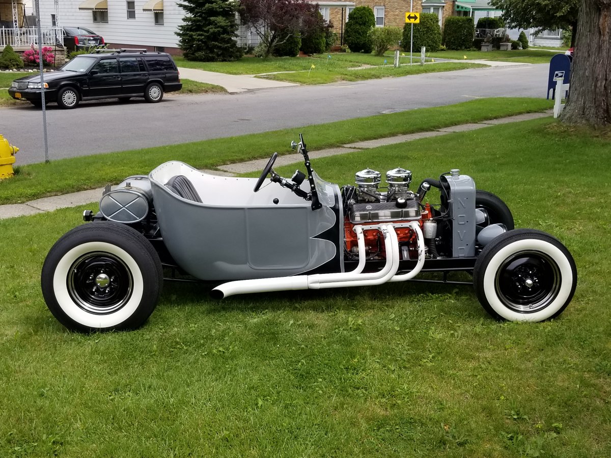

    I redid mine over the summer, once again using the shower stall plastic covering from home depot, it lasted 10 yrs the last time so why not. 20170819_130400.jpg
    AHotRod, brEad, Hackerbilt and 4 others like this.
