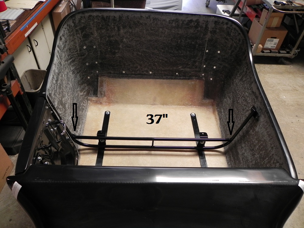

    Fred got another seat and has installed it in his bucket.
    There may be pictures here, I KNOW there are pics in the "Bucket Of Ugly" thread.
    Here is one from there
    If you go back one page in this thread, you can see Fred's seat riser and how much room there is.
    The pic I posted was just something I found. I don't currently have a T bucket, with or without a seat.
    Depending on if your floor is at the bottom of the body (unchanneled) or up inside the body from the bottom (usually the height of the frame i.e., 3 inches channeled), you could have the seat flat on the floor and the fuse box inset into the floor. Just make sure it doesn't run into the frame or any other mechanical bits. Note that the front of the seat is usually up off the floor even if the rear of it is right down on the floor for leg support, so you often can have the fuse box mounted at the front of the seat or on the seat riser, depending on size and it will still clear.
