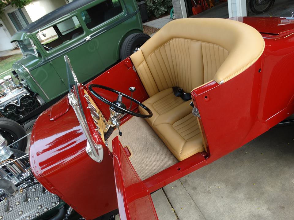

  5. Just got this back from the upholstery shop. Kinda bench/bucket cross. Seat is very comfy, just wish I had a little more leg room. Kick in the *** to drive though. :)

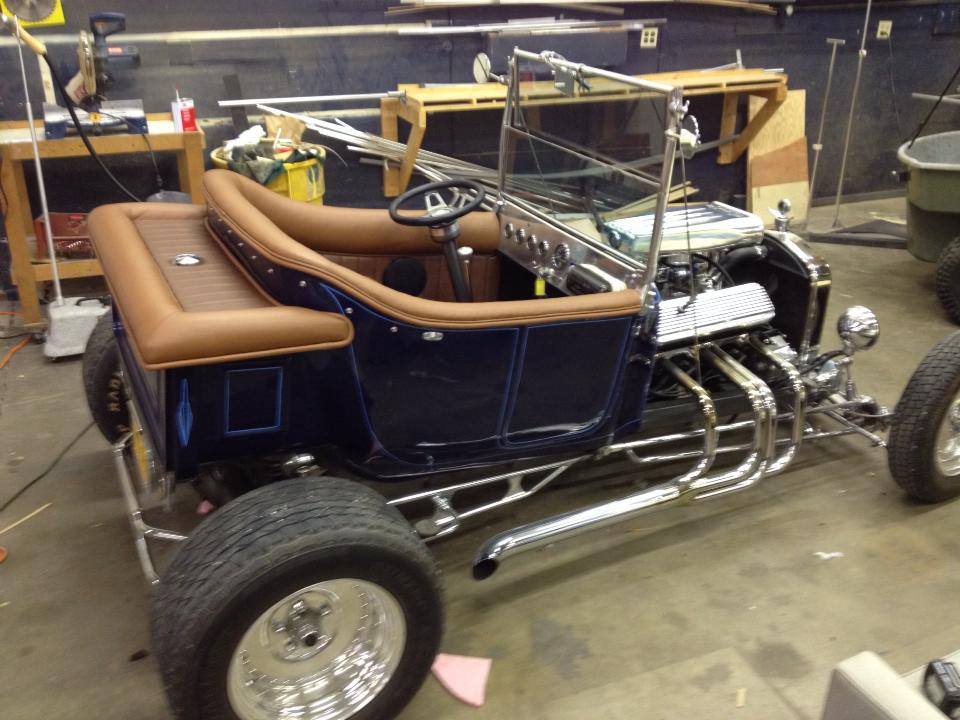

  7. I never been around a t-bucket much but here's an idea.... maybe: could a mounting system be made, that the seat (buckets(mounted together) or bench) tilt for ward at the front & have removable pit pins acting as the hinge pins? - then some simple latching method made with shortened hood release or choke type cable pulls in the rear? You could then tilt seat forward for behind & under storage or quickly remove the whole seat......

    That's not a hi-jack. It's really on point because the underlying reason I really don't like a door in 'gl*** T Buckets is the body flex. Now, the CCR setup does look strong and having had one of their bodies, I can say from experience that the body is very thick and strong, too. But it flexed a little. Not as much as other bodies, but it does flex. Will a gennie tin Model T flex? Yup, I'm sure it would, too. But maybe not as much (guessing here), and the body was probably engineered for that flex. I'm sure ole Henry thought of that.
    IMO, a gl*** T Bucket with a door is akin to flirting with disaster.... UNLESS you build a very heavy steel frame work or structure to support it. Wood? Maybe...... just maybe that would work just as good. But I think it would also have to be heavy duty. So, back to my car and the decision to have a door or not? Unless something REALLY huge happens to my finances, a door just isn't in the cards right now. But if that miracle did happen, I'd REALLY put a lot of thought into it and have to come up with even more bracing than they use. Just for my peace of mind.

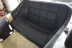

    this one looks quite like the corbeau you have been eyeing.

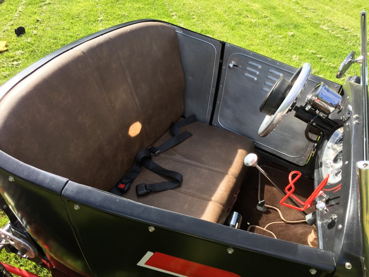

    My wife's T. Currently getting a door installed.

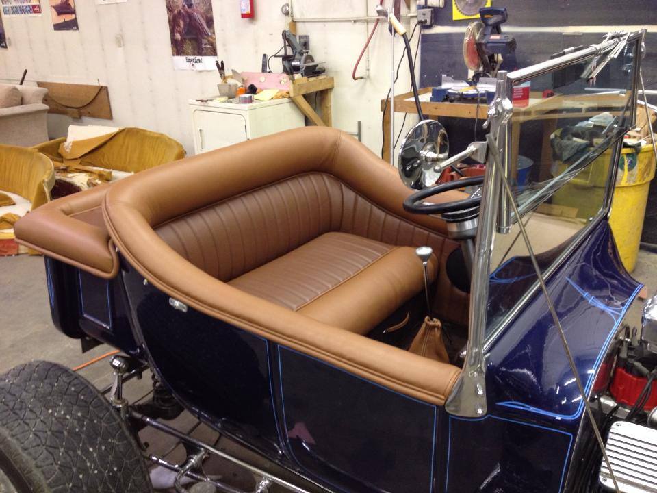

  21. tfeverfred
    Joined: Nov 11, 2006
    Posts: 15,788
    tfeverfred
    saltflats likes this.
  22. tfeverfred
    Posts: 15,788
    tfeverfred
    Is that in a T Bucket? If so, do you know what size they used? Nice fit.
  23. Dick Stevens
    Joined: Aug 7, 2012
    Posts: 4,248
    Dick Stevens
    That looks like a real possible solution for your interior! Without breaking the bank :D
    tfeverfred likes this.

  25. saltflats
    Joined: Aug 14, 2007
    Posts: 14,130
    saltflats
    from Missouri
    Bet you could use a home sewing machine to do it if you didn't get crazy with the material.

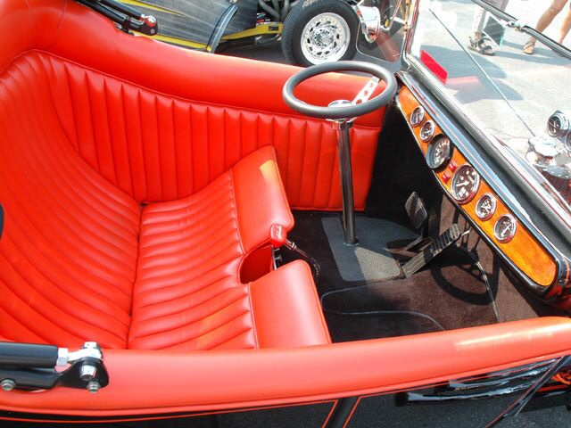

    BTW, I really admired this car in pics and then got to see it at SEMA. It was amazing in person too. I was sad to see it sell at one of the big auctions for what must have been pennies on the dollar.
    However, a thrifty and resourceful guy could use the design elements to create a nice interior of his own.
    http://kustomculture.skynetblogs.be...ly-loaded-in-a-1929-ford-roadster-pickup.html
    A nice job laying out a veneer on the floor with some rub strips, the bomber seats and getting the side panels to fit tight INSIDE the body....
    BTW, it's a '29, so the shapes are not quite T bucket...
