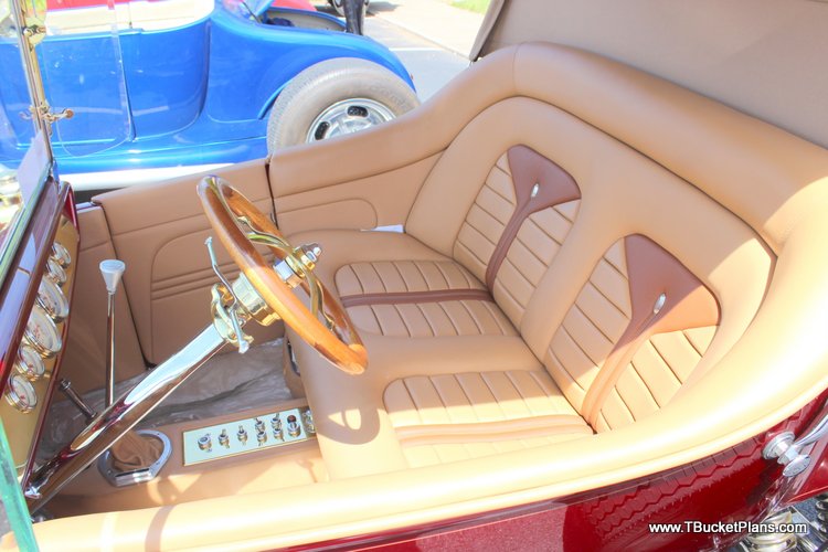

    Here is the tribute T interior with bomber seats
    It's channeled much more than normal, which means a bigger trans and driveshaft tunnel. Note how the side and rear tuck under the body lip.

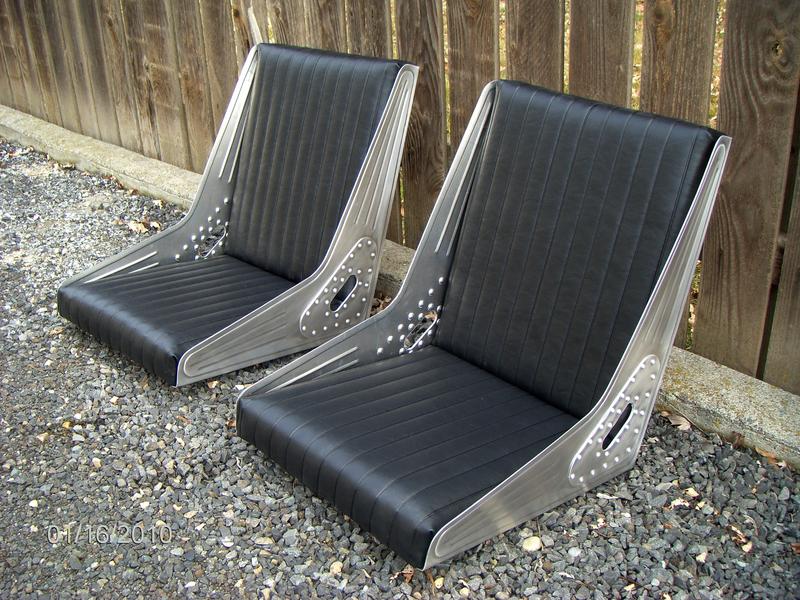

    The big problem I see with the seats from rotten Leonard is the fact that they are basically flat, no curvature to the backs at all.
    Along with that a big part of what can make bomber seats really uncomfortable can be the lack of any bolster for your legs at the front of the bottom cushion.
    Look at any comfortable seat and the bolster will be there in some fashion.

    Rod, I can't believe you posted a link to that "A"! I have pics saved on my computer and look at them every once and a while, just beautiful. And your right about Rotten Leonards seats. Like that Model A, if I don't integrate some of the details of the seat into the rest of the interior, they'll end up like what Rebel eluded to... cool, but out of place. One step away from ugly.
    The CCR tech told me the true width of the body, just behind where the door would be, is 39 7/8" (5" above the floor). Now that's right against the walls. The door jab, in the pics is 1 1/2". Depending on how thick my side panels will be, I could probably end up with about 38-39" to play with. However, a T Bucket body widens as you move to the rear towards the back. so I could get the 3" back. 40" is plenty for 2 regular buckets. At this point, I'm leaning towards buckets and that brings me back to the Empi seats or the Corbeaus. The Empi's are 19 1/4" wide and 18" front to back. So, they would work. The Corbeau buckets (my choice between the two) are 22" wide and 22" front to back. They would be a tight fit, but workable, if raised off the floor an inch or two.
    Both the Empi and Corbeau seats are simple, which would look better in my interior, than Leonards seats. So, with that in mind and other than the width, the deciding factor between the two, would be that the Corbeaus have 3 dedicated slots for the seat belts. A major plus.
    https://www.carid.com/empi/race-tri...lack-vinyl-medium-mpn-62-2880-0.html#features
    https://corbeau.com/fixed-back-seats/baja-low-back.html
    So, I'm hoping that when the body arrives and I can take definite measurements, I can get the Corbeaus to work. Otherwise, it'll be the Empis.

    Sorry Blue I totally disagree. I was going to suggest these Fred. If you have ever sat in a slightly laid back bucket seat you will know how comfortable they are. Why do you think they put them in WWII warbirds and sports/race cars. As far as durability just make sure they are secured to the floor as the seatbelt's bolted to the frame will hold you in. With just the simple padding kit you will be able to drive comfortably from gas station to gas station. They will look perfect in your low, slightly raked Black Beauty and Fred you really wouldn't have to finish the interior right now. Just paint it black or just glue in some simple black vinyl padded upholstery cardboard.

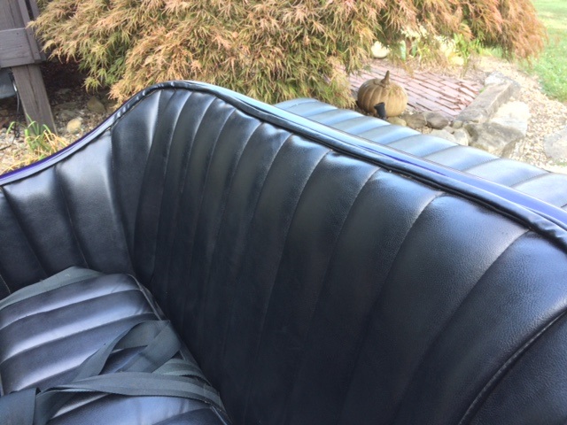

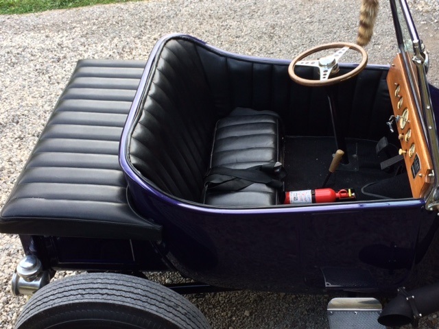

    Here's mine. Seat bottom lifts with P1030874.JPG fuse panel. battery and small tool box underneath

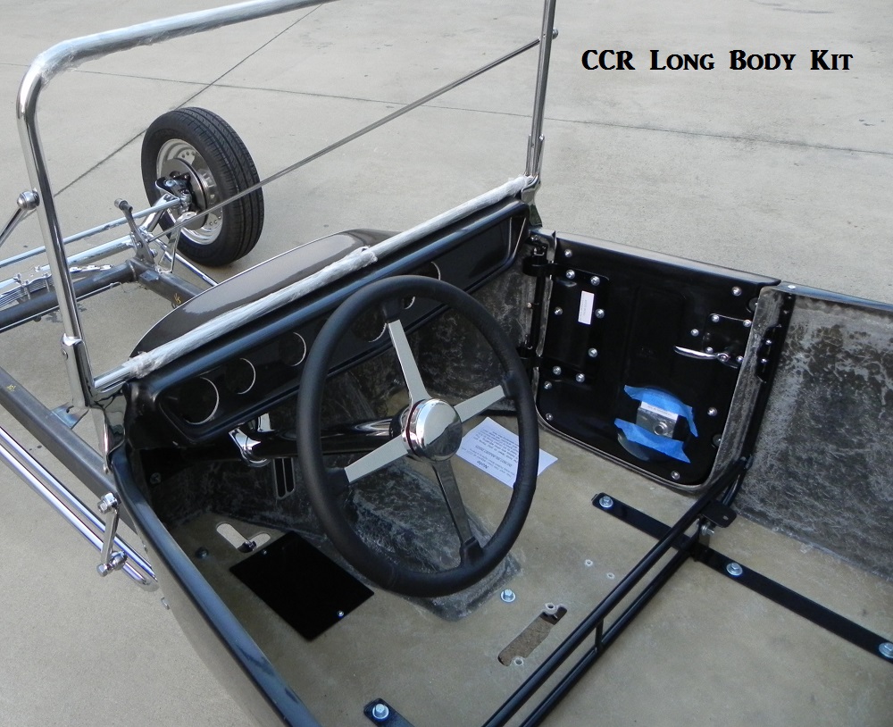

    BTW, here is a CCR long body with full upholstery.
    I don't care for the thickness of the seating, but it shows the stretch and gives you a better idea of the room inside better than the other pics posted before.
