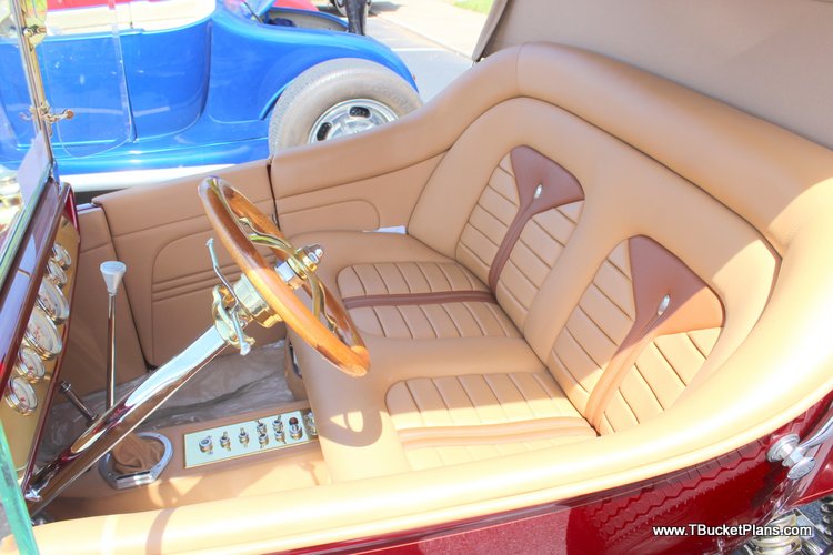

  4. Neat stuff in here. I really like the looks of the cream and maroon with the swan neck shifter but I'm curious about the sharply angled one that Bader2 posted a pic of. Any firsthand reports from a full figured fella? I'm tall and not likely to be mistaken for an anorexic.. wondering if this is the secret to small hot rods? I have an ot 50s car that is only as high as my belly ****on but I can easily wear a hat while driving it and more than enough legroom so I know small is possible.
    Good thread Fred-- can't wait to see how your stretch T comes along.

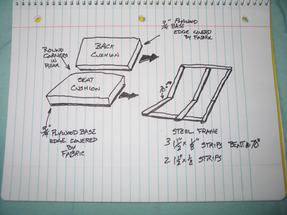

    Okay, here's the quick sketch for my idea on a one piece bench seat ***embly. The inside edges of the upholstered cushions, where the bottom of the back and the rear of the bench meet, could be beveled. Or not, for a tighter fit. The entire ***embly would weigh less that 20 lbs. The cushions are 3" firm foam. Covered in black vinyl. The frame work is made of metal strips, 1 1/2" wide and 1/8" thick. The back and bottom are bent at a 70* angle. Cut to size and welded. The cushions are bolted to the frame work. Not shown are rubber "stops or bumpers", on the upper corners of the back. To keep the frame corners from cutting the rear body lining. Thoughts or input?
    I forgot to add the pins in front. And I'd have a 4" bolster in bottom cushion, but I forgot to include it in the sketch. Hey, it's a QUICK sketch!
  19. Dick Stevens
    Joined: Aug 7, 2012
    Posts: 4,248
    Dick Stevens
    Fred, that will not have any structural integrity to it! You need to use either angle iron or tubing and add some gussets for strength.

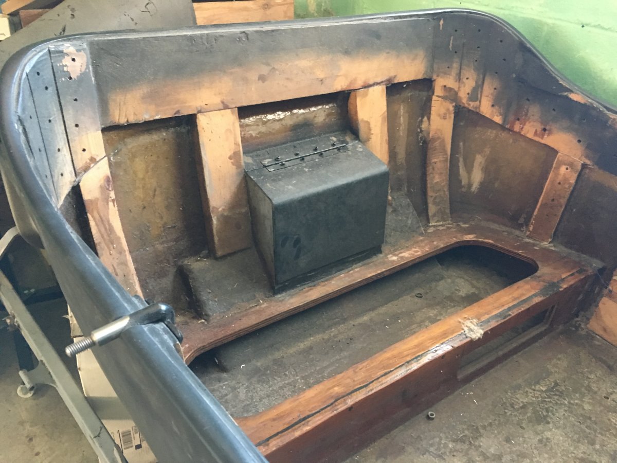

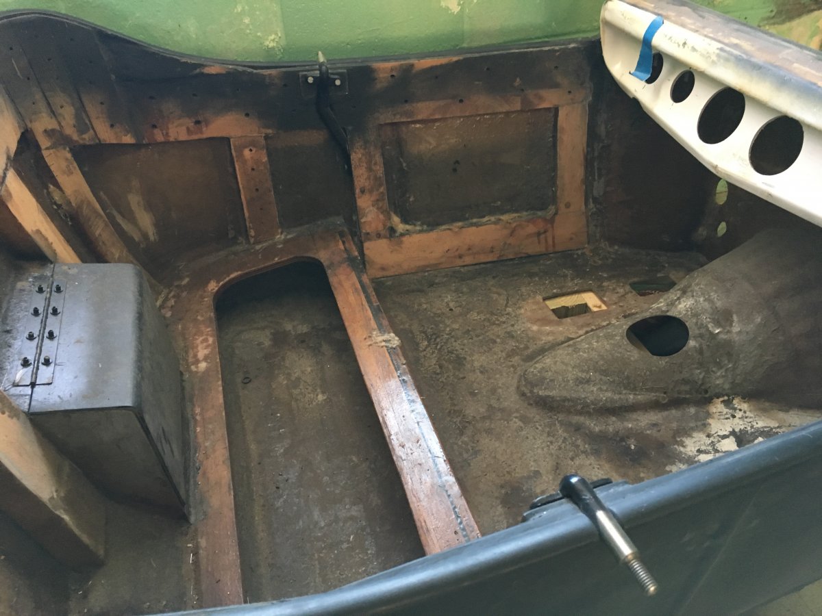

    I've been watching this thread because I am going to have to do my interior in the not so distant future. I was looking at some of the photos with the steel brace on the floor. It looked so much different than my roadster pickup that I took a couple of pictures today while I was at the garage. My RPU was built by Frank Morawski years and years ago. It has a 1917 cowl and looks quite a bit different. The interior was all done with gl***ed in wood. I thought you might see something that would be of help...............the center box with the hinge is the battery box
    brEad, mctim64 and tfeverfred like this.

    Very nice! I like that battery box and it's location. Nice work.
    hrm2k likes this.

    No, the seat base and seat back would have no strength to support your body weight.
  25. tfeverfred
    Joined: Nov 11, 2006
    Posts: 15,788
    tfeverfred
    Okay, I get what you mean. Would a gusset at each corner do the trick?
  26. Dick Stevens
    Joined: Aug 7, 2012
    Posts: 4,248
    Dick Stevens
    It would be best to use either angle iron or tubing as they both would have an inherent gusset in each member and then need proper gusseting between the base and back to make the angle solid.
  27. tfeverfred
    Posts: 15,788
    tfeverfred
    Got it! Thanks.

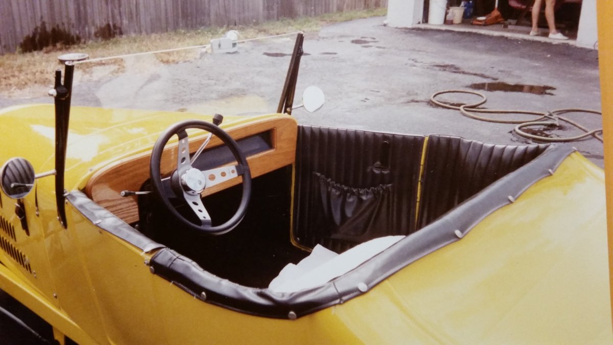

    I had a '27 roadster that had a wood riser across the front maybe 2" high that supported a base cushion of plywood covered with foam with a sewn cover. The back had a piece of ply gl***ed into place from the top of the body to the floor of the body at a comfortable angle. (a '27 I know that area will be different than a bucket) There was a piece of contoured foam from a bench seat back that just set against the upright plywood back support.
    The covering was sewn vinyl that wrapped around from the p*** side door ,across the back, and up to the dash on the drivers side with a matching door panel for the opening door. It had a few snaps in the bottom corners that you snapped first, then the top edge rolled over the top of the body to snaps around the outside top edge.Then dropped the seat bottom in place.The sides came to the seat sides, but actually had a couple of inches to the body sides so your hips could have a little extra room.
    The wrap around sides had a strip across the top that was sewed to roll& pleated center vinyl.The vinyl was not sewn R&P but formed R&P that they use in marine applications, so if it got wet it didn't soak through the seams. There was a little storage under the seat base, and the rear plywood had 2 hinged access doors with a storage area behind the seat under the rear deck.
    Very simple, and I thought it fit the theme of the car very well
    I'll try to see if have any pics of that interior
  29. upspirate
    Joined: Apr 15, 2012
    Posts: 2,303
    upspirate
    ****py phone pics of old pics, but wife wasn't up to show me how to scan!:(Memory was wrong, there was another panel for the driver side separate from the back wrap around.I also had a tonneau cover made that would snap on in place of the upholstery snaps around the top edge and when folded, would fit between the side wrap and the body. good for keeping out the rain , dew, or prying eyes.
    tfeverfred likes this.
