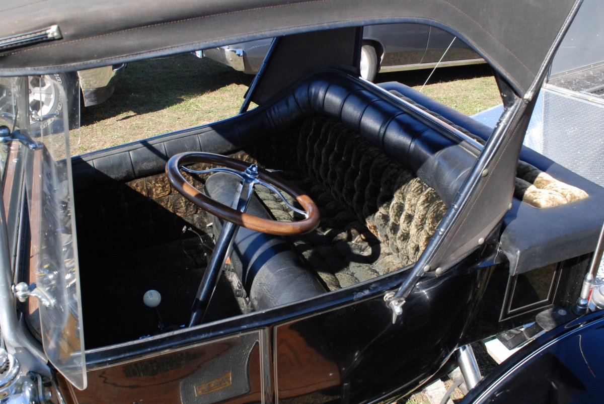

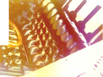

    That overstuffed sofa look was popular and is a throwback to the days of those horribly ugly Fad T's of the 70s Fred and you do NOT want to go that way :D

    When I first got into T Buckets, the "Fad style" T Bucket was awesome. Then, I grew up. Brings back some cool memories of reading "Rod Action" magazine, till the pages wore out.:D If I were building a "traditional" 70's T Bucket, I'd be all over that.

    Been wanting a sofa like that lately, but thinking it would be a ***** to clean...I can only imagine what a pain it would be in a roadster.

    I'm with you Fred I remember the period in the magazines too.
    I'm just old enough that for me I was never able to embrace the fad t phase.
    I don't think too many Ts are being built anymore to recreate that era.

    I didn't like Fad Ts when they were the style! :eek: They make me cringe now! :(

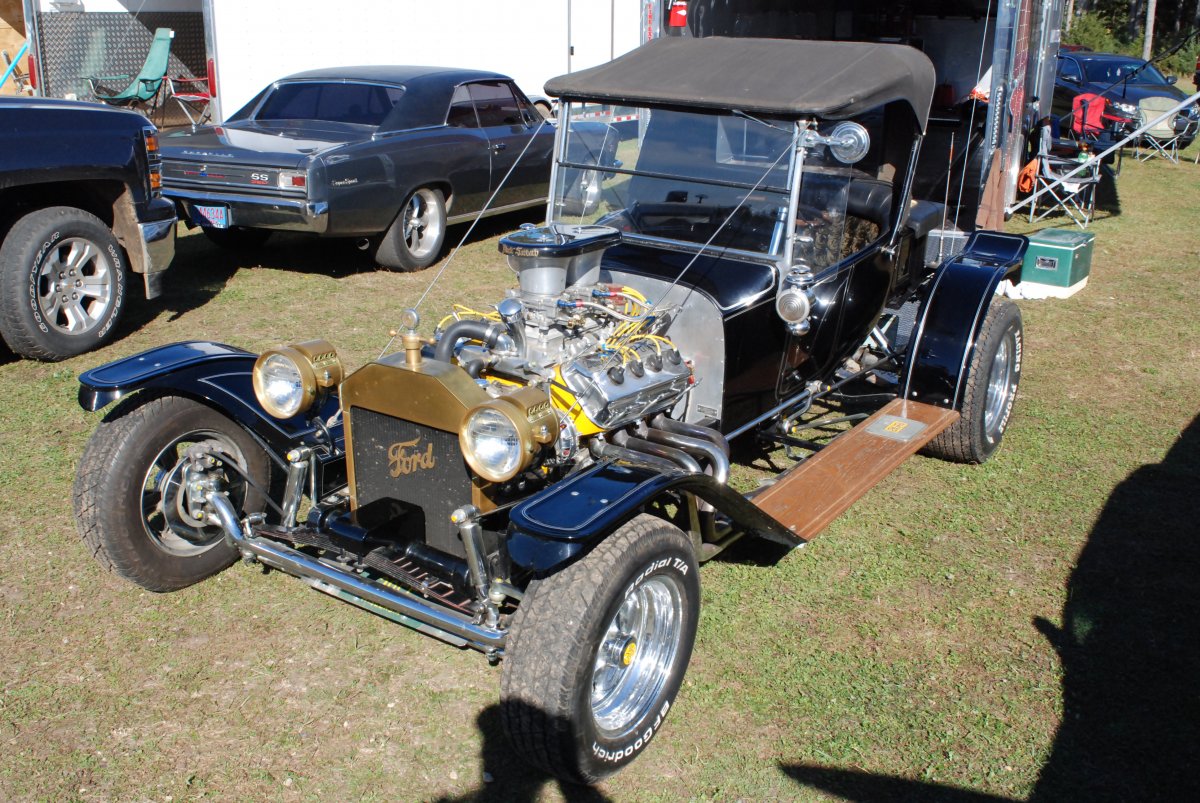

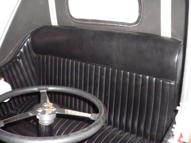

    Whatever you do don't build anything that looks like this if you want any comfort.
    Otherwise I have made my point.

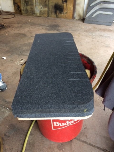

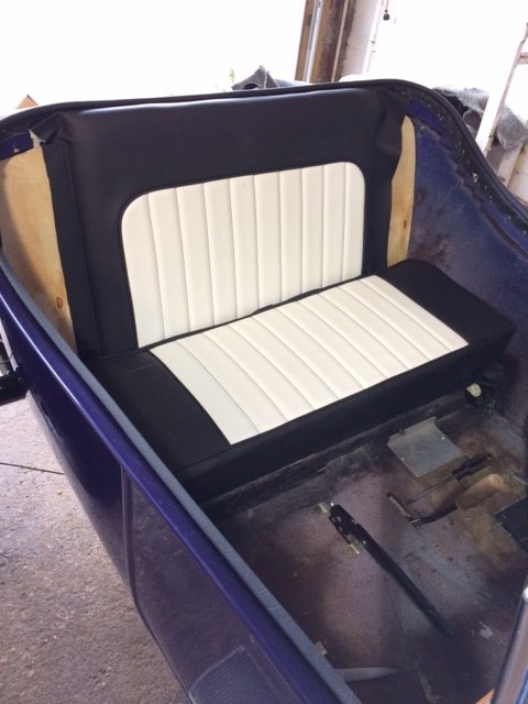

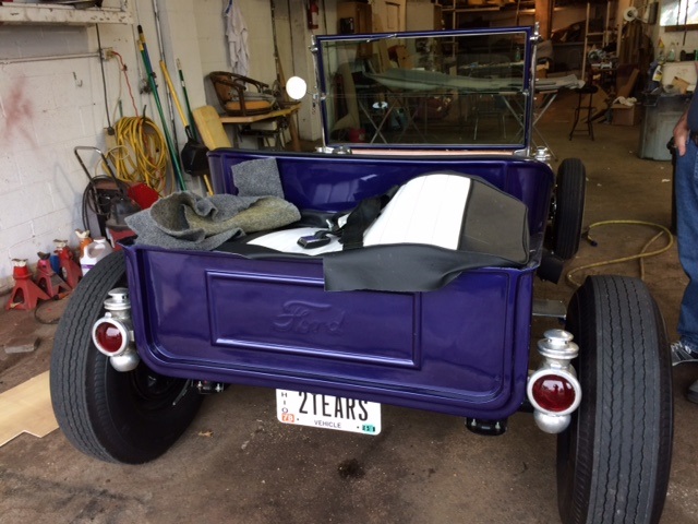

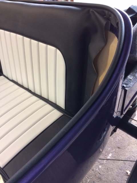

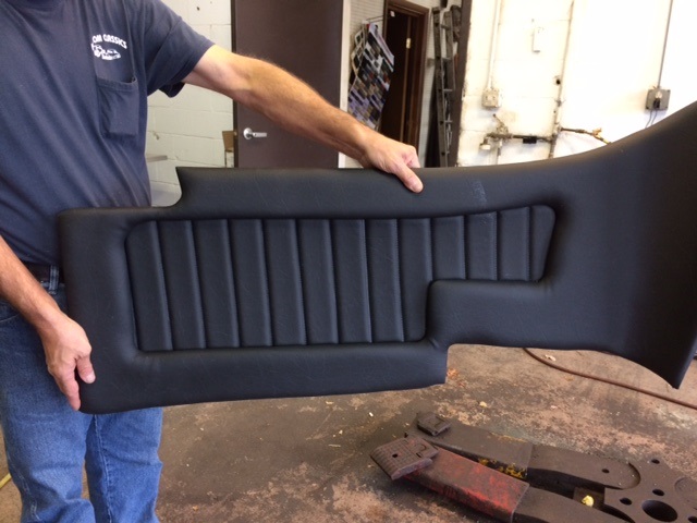

    Ran at lunch for some progress pics. Might be done next Thu, waiting on carpet to come in. Should be more comfortable than what it was, but this will never be a long distance car.
    much better than the crumbling foam I had been sitting on...
    Cover placed loosely on the bottom for pic, everything will match up and be tight when done. Black s***ching between pleats on white.
  22. tfeverfred
    Joined: Nov 11, 2006
    Posts: 15,788
    tfeverfred

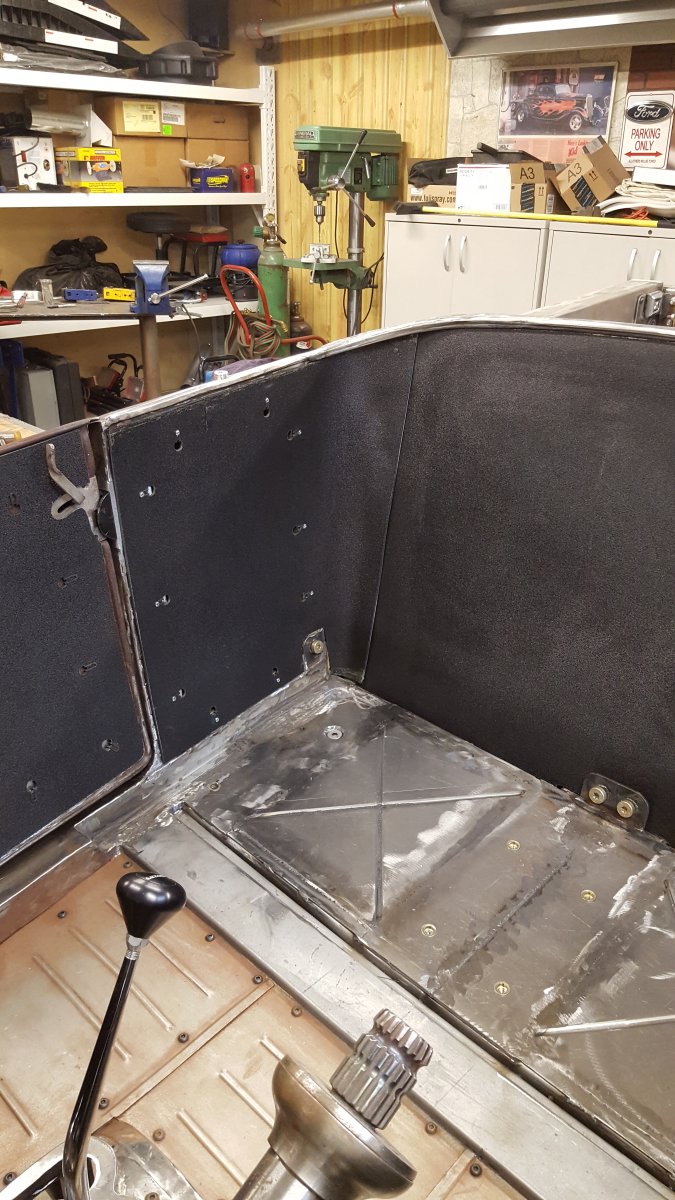

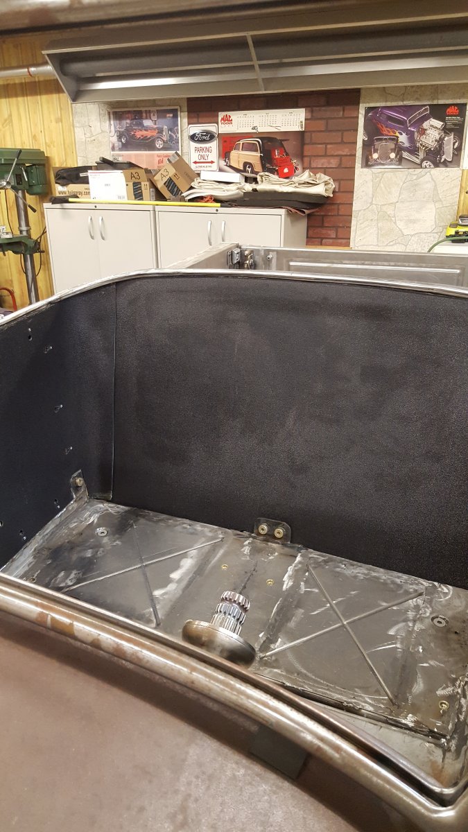

    Very nice. How'd you do the rear curve in the side panels?
  23. DaPeach
    Joined: Apr 22, 2009
    Posts: 260
    DaPeach
    from NE OH
    Thanks. I'm having a shop do it, but I'll ask him the next time I talk to him. Looked like a heat-formed plastic.

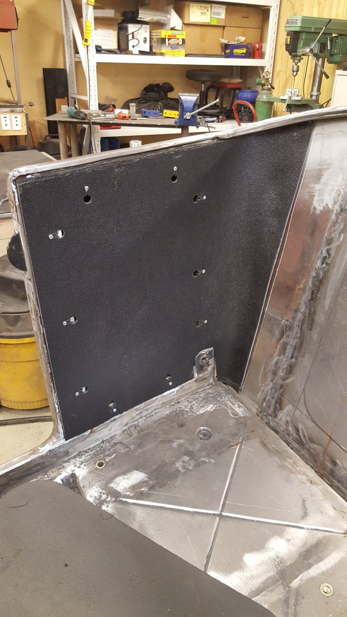

  25. Blue One
    Joined: Feb 6, 2010
    Posts: 11,578
    Blue One
    from Alberta

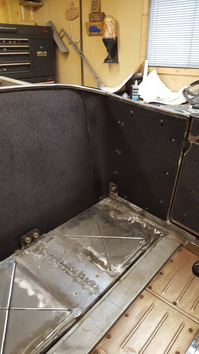

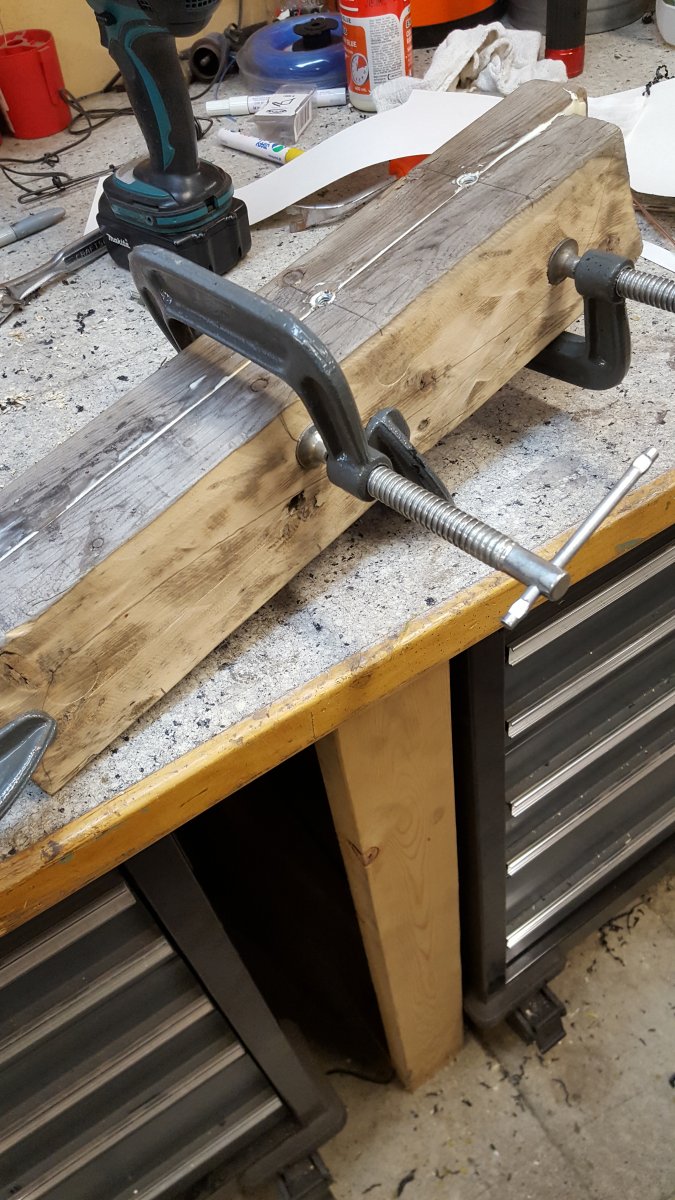

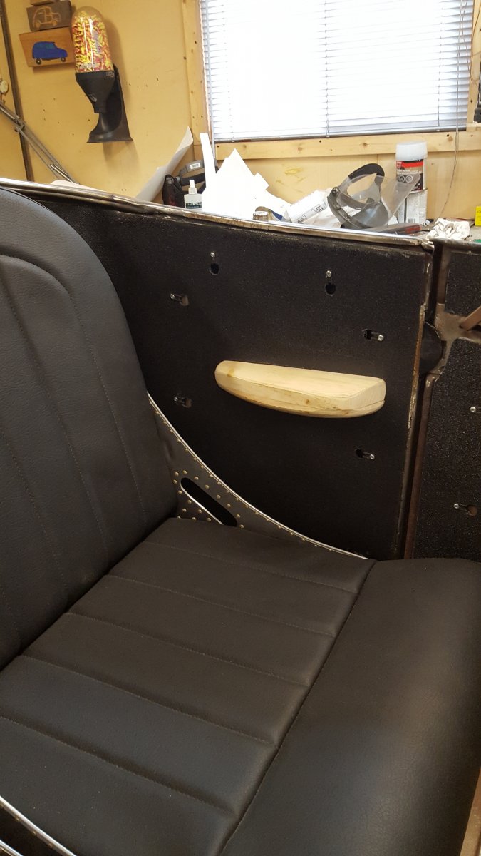

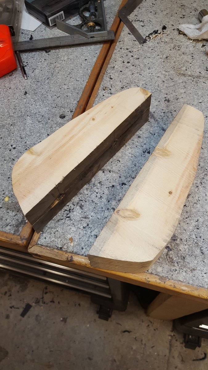

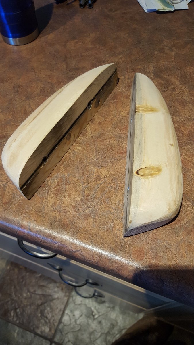

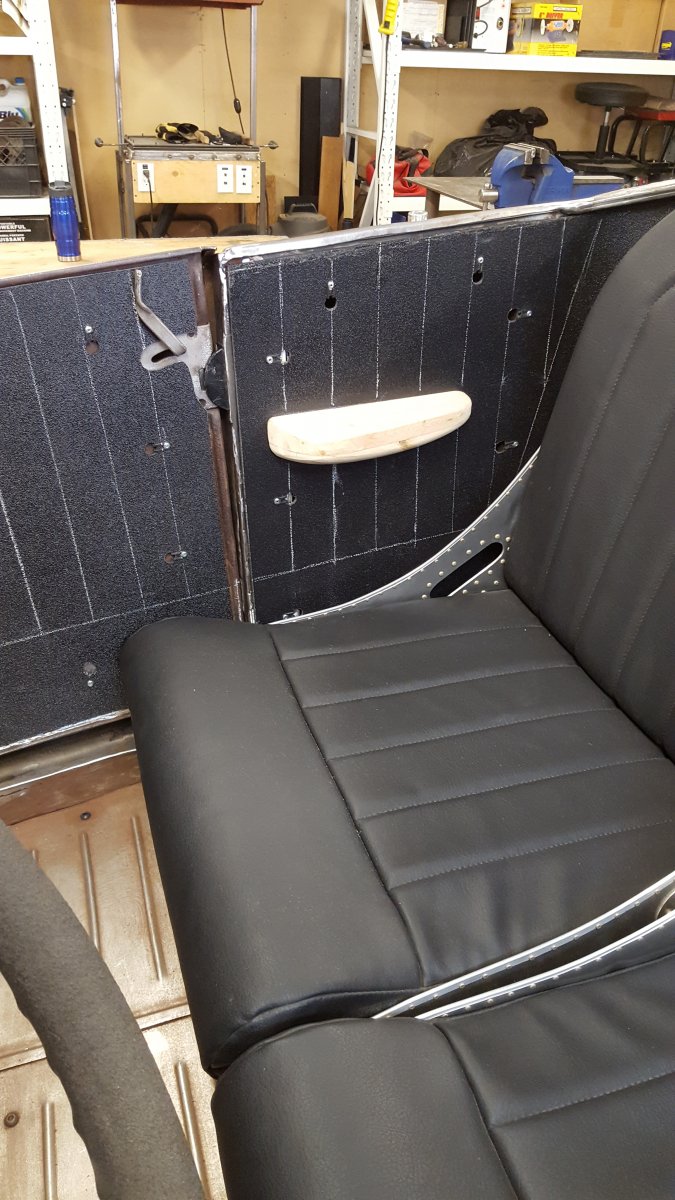

    Probably just like my side panels Fred.
    I heat formed 1/8" ABS.

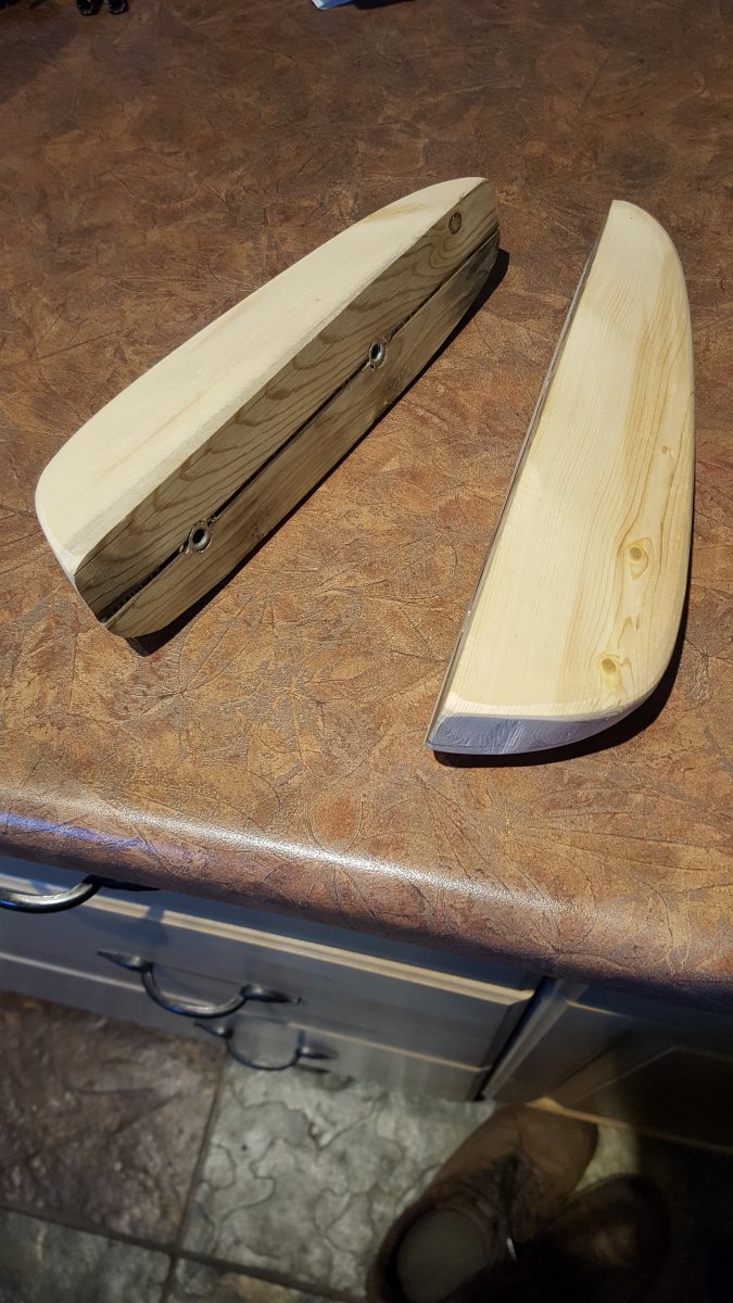

    I then made and mounted arm rests which I'll upholster when I get there.
    IMG_0477.JPG IMG_0478.JPG IMG_0479.JPG IMG_0480.JPG IMG_0482.JPG IMG_0484.JPG IMG_0485.JPG IMG_0486.JPG IMG_0488.JPG IMG_0495.JPG

    I'm coming back to this interior because the flaw I see is what made the seat in my first T Bucket, not as comfortable as it could have been. It appears that the back is straight up or horizontal. My old T Bucket seat was made using 2 side pieces from a folding boat seat. You can see one of the end pieces in the photo. The bottom was webbed and padded, on 3/4" plywood. The back was 3" foam on plywood. The back folded down and the whole thing lifted out. That bottom was great!
    But the flaw in it was that the back didn't lean as far back as it could. In trying to save space, the back of the seat bottom was as close to the back of the body as I could get it. That kept the seat from using the 22 degree lay back that the side pieces had. The result was that I sat straight up. BUT.... since my car had a rake, I was actually sitting slightly forward as well! The rake enhanced the already flawed installation. I would scoot forward a bit, but even that sometimes didn't feel good. Basically, while my seat LOOKED comfortable, it ****ed. It's amazing what you get used to and that's what I did for 6-7 years.
    So, in my new build, I'm paying special attention on keeping that 22 degree angle in the seats. Since I'm going with a stretched body, I can afford to lose a few inches by moving the seat forward to keep that angle. But even if I had a standard body, I'd still try to keep that 22 degree angle. It's crucial to comfort.
