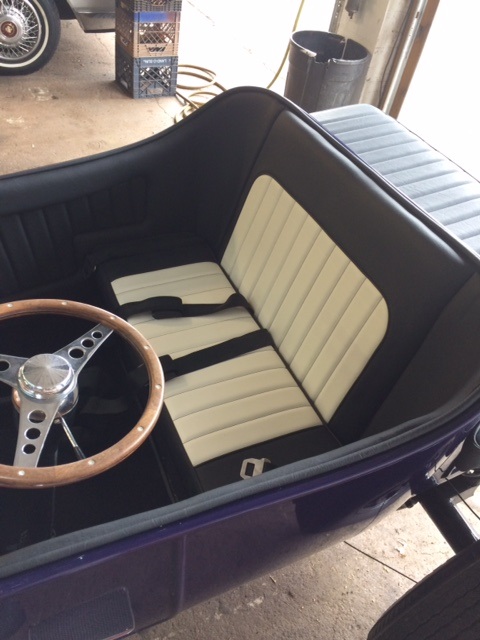

    I was sitting in my car at the laundry mat today and thought about the seating position in my Taurus. Basically what I found was that other than the electric powered options and mount, my vision for a seat follows the Taurus and a lot of what's been posted. The Taurus bucket seat was 18" from front seating edge to the back. Inside seat back was 23" tall, without the head rest. The inside seat width was 22", but only 18" of that was actually used. The base was 7 1/2" tall in the front, which would be too tall for my T and the base inside rear was 5" tall, also too tall.
    So, whether I choose to make a bench or buy the low back Empi buckets, I should be good to go with a lot of whats been posted in this thread. I'm set on incorporating the cross frame work that supports the door frame ***embly and I'm also seriously considering making my own bench. Which, cost wise, would be close to purchasing 2 new buckets. The DIY factor being kind of cool. So, I'm now looking back at the bench seats that have been posted and looking at how the back panels were done and attached. I'm not sure if the back piece should be separate or if the back piece should be built from the body of the car itself.
    Built off the back of the body would save a few inches, but a back built separately would be easier for me to do. Another thing I considered was steering column length and angle, but that will have to wait until the seats are done and installed.

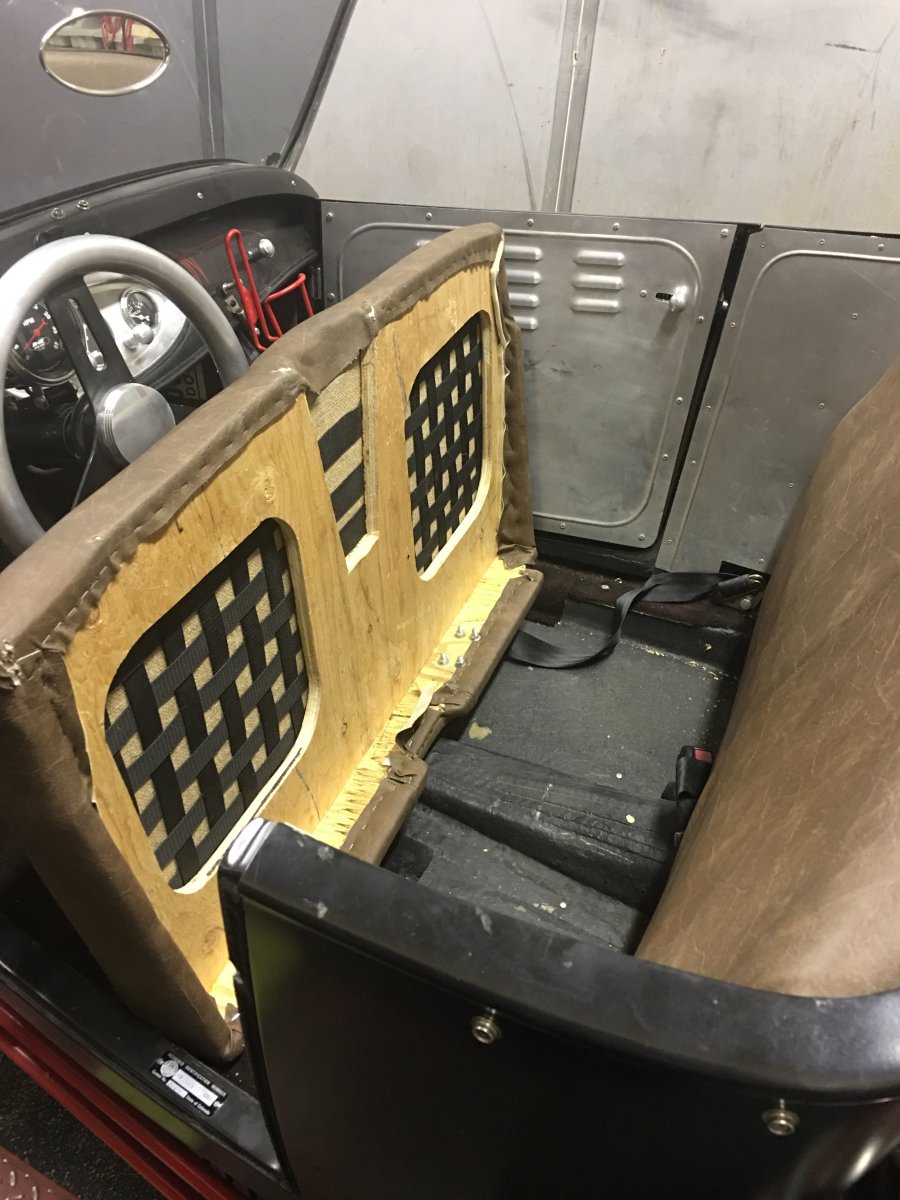

    Dennis, is the seat back permanently installed or can it be removed somehow?

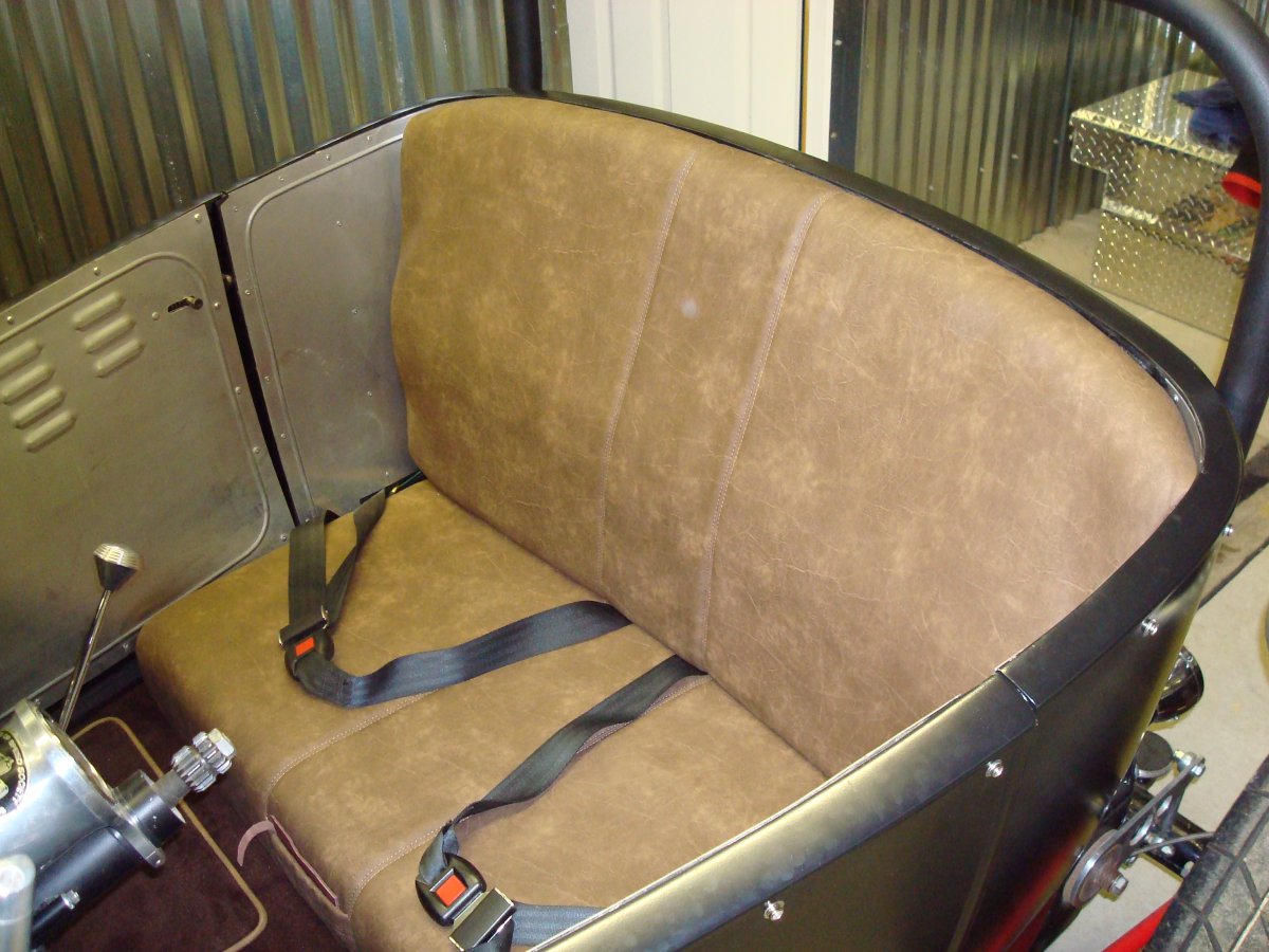

    Bomber seats
    Comfortable on a drive from Bay Area Ca. to Bonn. and then to Vegas.
    Just checking in.
    Don't make your own seats Fred. The time you spend can be put toward some overtime to buy some nice buckets.
    But then it is your choice. Don't let an old guys experience sway you. Forget the ****in math just lay them back a little. Simple.
    Oh yeah don't put the fuse block under the seat. Too much back and forth wiring. Just put a small one under the dash. Simple.

    Yes' it can be removed. The lumbar pad was the real key to making this a comfortable driving car. Here's a shot of the underside of the seat bottom. IMG_0857.JPG

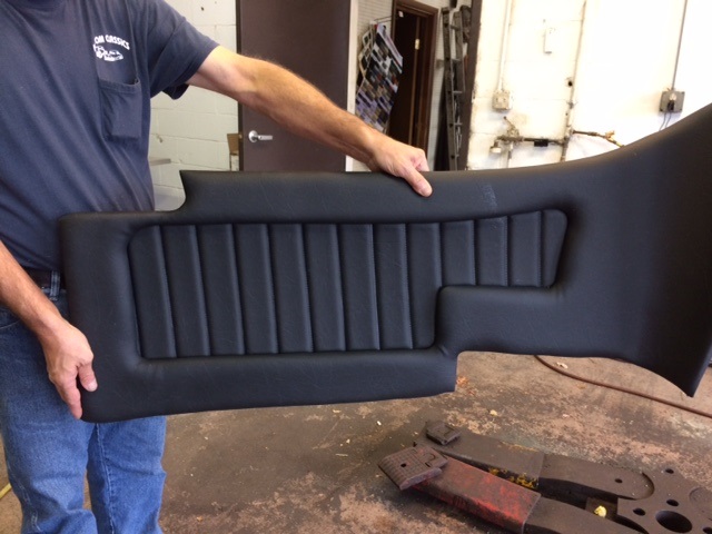

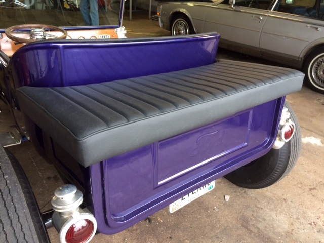

    Fred, I talked to the trimmer yesterday, said he used luan on the side panels with ABS on the rearward curved area. He said he attached them to the sides w/ plastic push pins. I did grab more pics but they ****, should've tucked the ugly belts under for the pics. I'll be picking it up tonight, was done a couple days ago but the weather hasn't cooperated.

    Hey, Peach;
    Any shots of the interior in progress? Backside of the side panels, etc?
    TIA.
    Marcus...

    It was originally built in the late 60's from the CC plans. it's definitely got the turning radius of a greyhound bus...I'm not too quick to pull out into traffic, but it does spin itself straight pretty quickly without much help on my part. I'm only 5' tall, so leg room isn't much issue, my knees are still up & the shifter lands right under my right leg. I think he may have given me another inch or so with the back a bit flatter than it was.
    I don't have any other progress pics than what was posted earlier, sorry 'Wiz..
