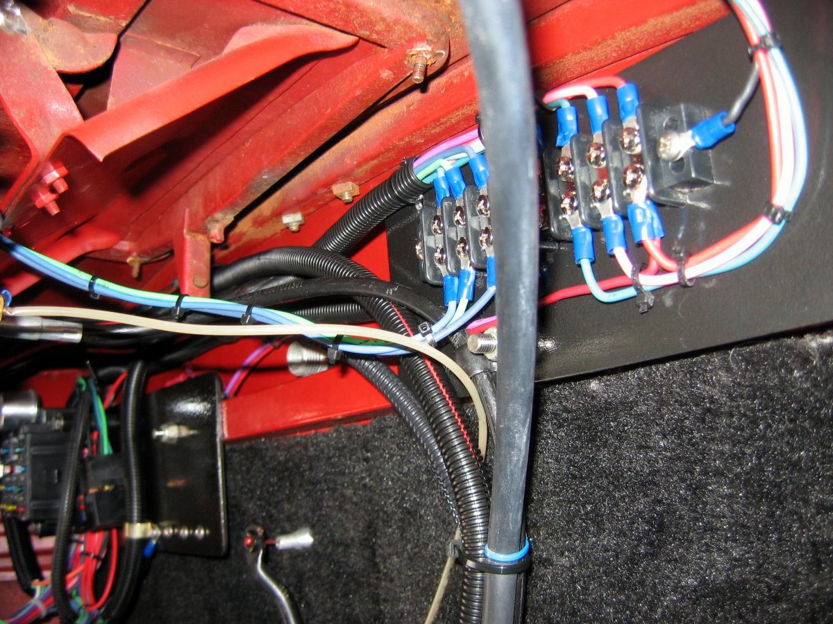

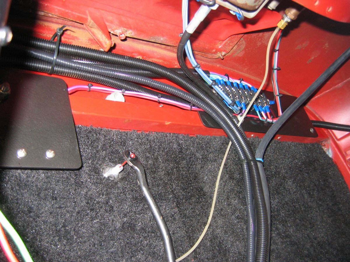

    When I wired my '32 dash, it was so easy to wire on the bench, then with the same color wires I installed a junction block on the firewall and hooked up my dash wires to it after dash was installed. I just left the harness long to the gauges, and when they were installed,terminated them at a junction block.
    More room to install block and run the other wires without the dash in the way too.

    Thanks Dana, The more I do , the more I learn, and try to do projects neatly.

    Thanks, When I did my '32, I used a EZ-wire kit.
    I wired the gauge wires to the junction block, then with the excess, color coded of course, I used that excess wire to make a harness with the dash laying on the bench and of course I had to have music and hydration while doing it!:):D
    I don't see the need to spend the $98 when all you need is a few crimps and wire ties in addition to the wire you cut off the harness. Spend that $$$$ elsewhere!!!
    Chances are that their spacing and run will not fit as well as you custom making it to fit your gauge placement.Also, get the harness made, then install the dash or gauge cluster, then run the wires to the junction block, then terminate so everything runs nice and neat.
    If you notice in my pics, I ran two separate harnesses to the dash, don't remember why now,(don't have truck to look) but there was some reason that way ran cleaner..
    Doing it this way, you have the advantage of removing the dash easily if you need to and re-installing it with out weird gymnastics, and a spaghetti mess of wires

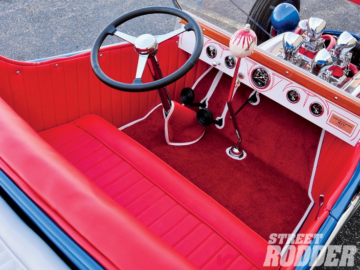

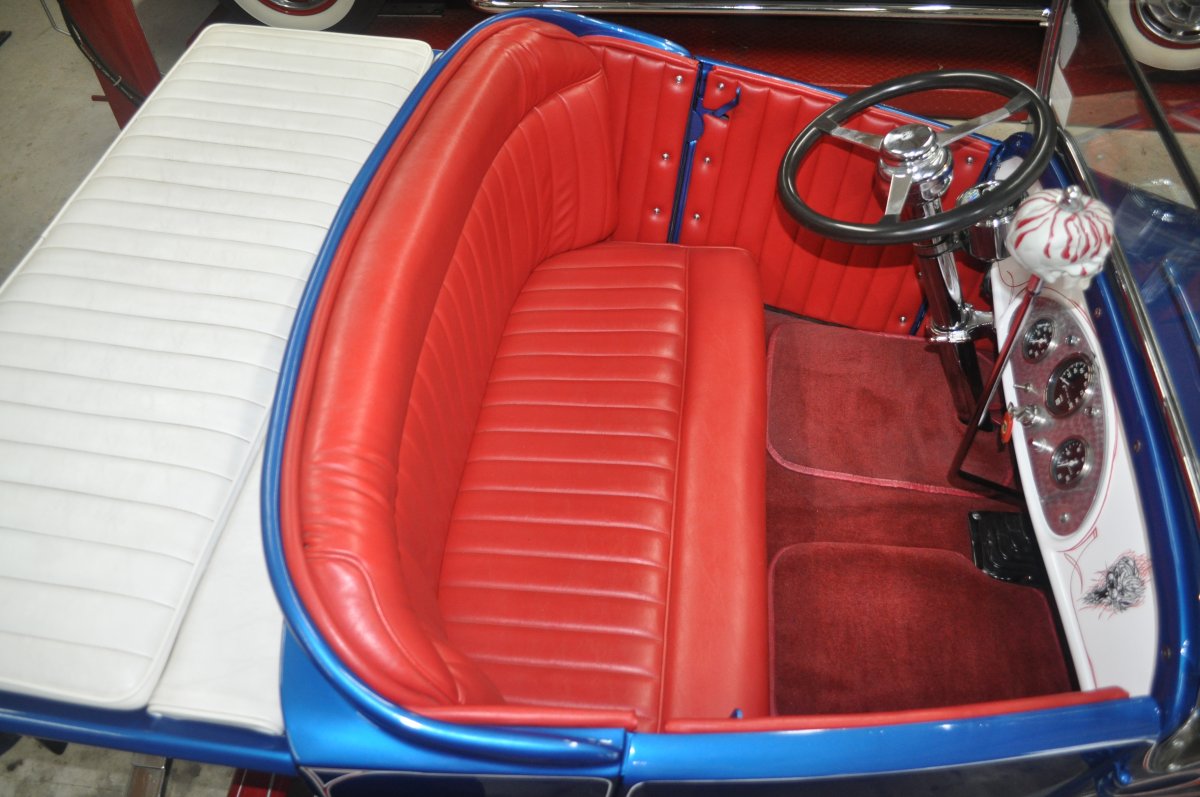

    I've been looking at my Rodder's Journal issue featuring the clones of Norm's T Bucket and I've been studying Mr.Mac's interior shot. The side panel's and door panel look like something I could at least give a try. It looks like the material I found: https://www.marinevinylfabric.com/products/marine-vinyl-fabric?variant=13535168902
    could be attached to 1/8" Luan and attached as per Mr. Mac's interior. The bottom piece will be 3" or 4" foam on 3/4" marine grade plywood with holes and webbing. Back to basics.
    Looking at the Speedway interior kit instructions, https://static.speedwaymotors.com/pdf/tbucket_interior.pdf , I'm considering a 3" foam back piece covered with the same material as above, on Luan and attached to the back of the body with: https://www.itapestore.com/3m-dual-lock-sj3871-by-the-yard.html , instead of velcro.
    Doing my interior this way will take full advantage of the extra interior room I'm paying for in the stretched body. I think if I take my time, which I have plenty of, it'll look pretty good.
    Oh....... all in black.;)

    Just thinking out load but I really like the look of the curved seat back but was thinking with the curve on just your one side do these seats have you always wanting to lean to the inside of the and if you have a p***enger they would be leaning toward you.
    I think a bolster in the center may be something to think about.

    I plan on making my back piece with a very slight curve. The back piece in my old T Bucket was basically straight across and leaning inside wasn't an issue.
    Of course, by limiting my p***engers to females, leaning closer wouldn't be too bad.;)

    I like the look of Mr Mac's interior too! Go for it Fred, you won't be sorry for doing it!

    Note that both of the Red interiors you posted have piping or a bead attached at the top of the panel.
    You could have a local shop sew these up for you to attach to the panel after it's face is done. Maybe your supplier will have it by the yard too.

    Fred save up some $ and have the interior done by professional. I did. You are a welder not an upholster. The upholstery is something that jumps out at you. If it isn't professional looking your bucket is second rate. You can skimp on chrome and custom paint but don't skimp on upholstery.
    I really like the below orange rod interior if you want comfort and a '60s look, but **** me what do I know.

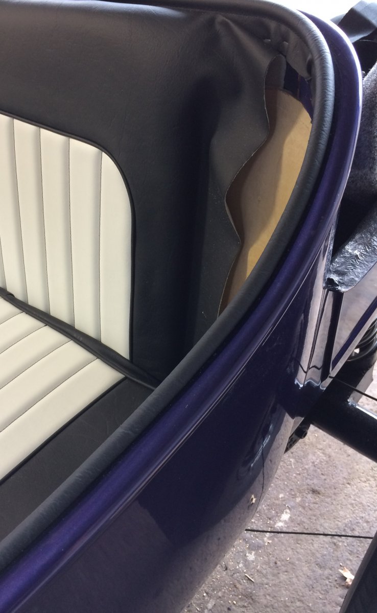

    IMG_5094.JPG IMG_5095.JPG My welt was stapled on independently of the side panels. Makes for a nice uniform top edge w/o struggling to line up separate panels to the edge. Having a functioning door will require a little matching, I wouldn't think it would be too bad this way though.
    Just another way to do it...
