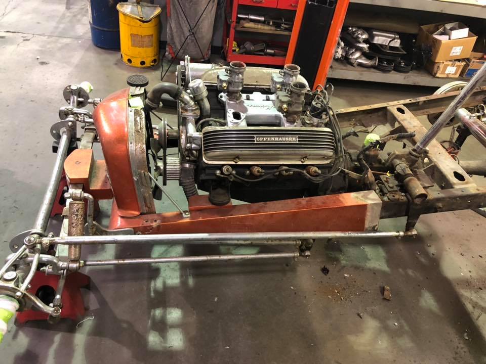

    Posts: 6,624

    It's not just the power rack stuck on the Model A axle and out in front at that. That steering shaft setup looks like it will bind 7 ways from Sunday going down the road,
    Steering arms in front of the axle that make most rigs with an I beam drive like **** to begin with. Some will argue but unless you put a lot of time in reworking the steering arms to correct the Ackerman you are going to be dragging a front tire around every corner.
    It is the spring shackle setup that is pretty suspect and what appears to be a 4-leaf trailer spring itself.
    There are no safety washers on the Heim ends on the 4 bar. That is an absolute safety issue.
    You can cut that mess off the front of the axle and grind the scabs away, swap the spindles back to their correct sides and put a proper tie rod in it by maybe having to heat and bend the steering arms up or down a tad and put either cross or side steering in it and make a half way decent car out of it along with fixing some safety issues.
    OR, and that is a big or, **** can everything in front of the heim ends on the 4 bars except the spindles and brakes, get a dropped front axle with spring on top and proper set of batwings to run the 4 bar and steering box of choice.

    One thing I noticed from the original post is that the owner brought the vehicle in to change a few things. He had the spindles swapped in an attempt to correct a toe issue? But one thing is its never mentioned that the car drove terribly. I wonder how it was to drive. I wouldnt put any of that stuff on a hot rod but someone drove that thing. It doesnt look like a fresh build. Haha Maybe it worked. Crazy man.

    So, exactly like adam401 said. My father-in law bought the car and honestly, we don’t know if he even drove it before buying it. He’s not the most flexible guy, and this car doesn’t even have a tilt column or a door to enter. Yes, I know, believe me, we all roll our eyes but it’s his and now he needs it fixed.
    I know what you are all thinking and I could start an entirely knew thread of the history of bad decisions on his end, but this thread is about a fix to this issue. All the other issues? We’ll, probably a psychiatrist.
    Anyway, the picture showing the steering arms facing forward is one taken at some local shop that swapped them around to see if it was going to correct the issue. It didn’t, and now they are back on the car facing rearward. He drove the car several times and complained of the steering “not being right”. When he showed me the pic of the arms facing rearward at a 45degree angle to the rack, my gut reaction was like everyone’s here: YIKES!!! Enter me and trying to fix this mess for him.
    In addition to fixing it I plan on installing a tilt column for him and at some point, fab up an inner door frame and cut a door out so he doesn’t look like a bowling ball hitting the gutter getting into this thing. Poor guy, he just wants to drive the car and I plan on making it happen for him sometime in the next few months.
