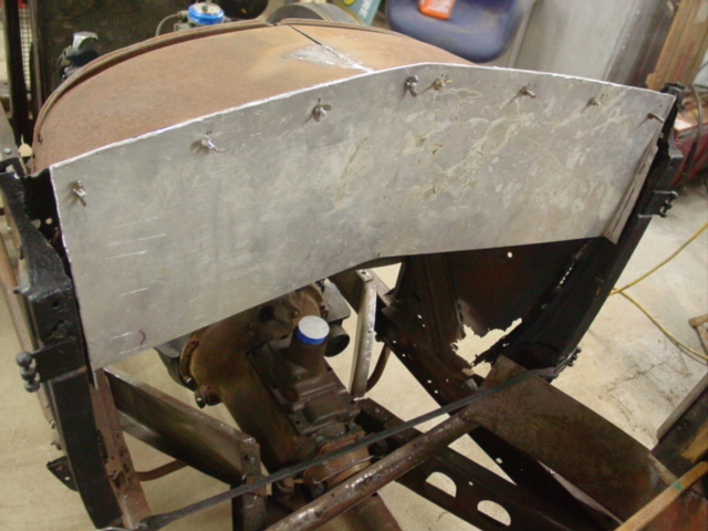

    Built this by cutting 10-inches out of the center of a '78 F-250 hood. Turning them up, and welding some cross pieces in. The body is upside down in the picture. The idea was to mount it to a cowl of some sort. I didn't like how most homebuilt bodies had square and boxy shapes. I got tired of looking at it and rolled it over in the bushes.

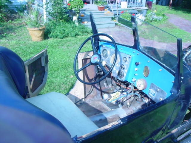

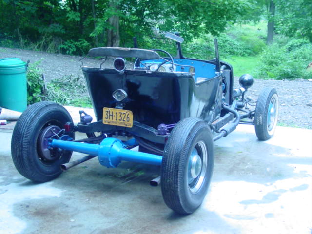

    Hand-built this except for firewall,it's not stretched,though.

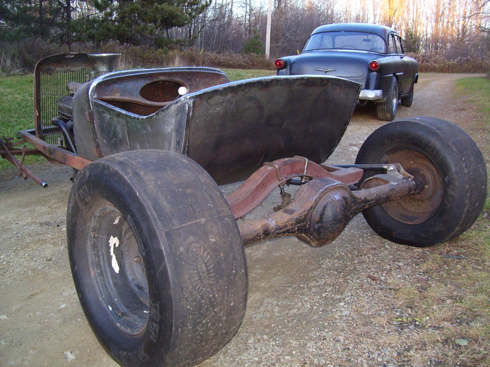

    I wanted a bucket that would follow the frame and not hang over the sides. So I pie cut the cowl & pinched it. It's a cozy 2 seater, may not suit some, but what I wanted. I made sure it was long enough to get both legs straight on the floor boards. And the sides high enough so you sit down inside & not on top of it. I don't have another cowl so the next one may be all scratch built. I have no problem with wood frame body, have lots of locust here hard but lighter than oak. And with the glues & coated deck screws now days, makes a tough frame. Constant mock-up and test fit & no surprises. Backend had to be narrowed & deeper, faster to do from scratch, borrow a bead roller, IMO

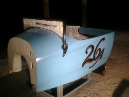

    I built this a few years ago for a friend. I originally built the ch***is for a Jago 'gl*** body which were made in the seventies here in England and were 2" wider 2" longer and an inch taller than standard T bodies I believe. A few years later I built the all steel body below to replace the gl*** one.
    Here it is painted.
