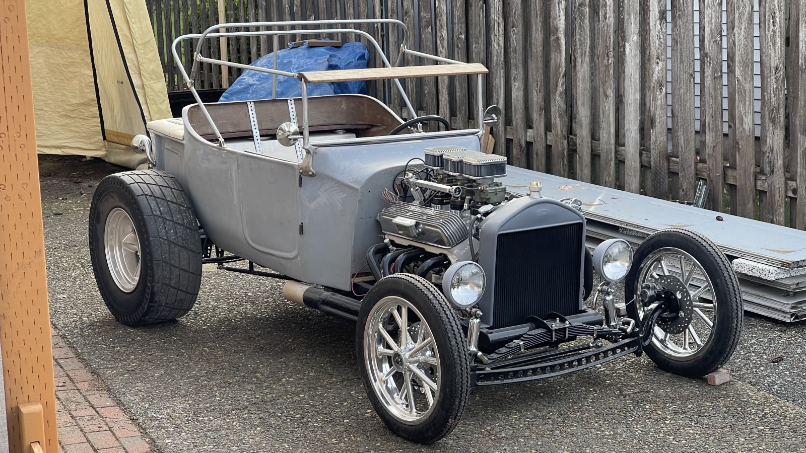

    T Bucket top 1.jpg T Bucket top 2.jpg T Bucket top 3.jpg T Bucket top 4.jpg Well, I have made some progress on the 27 T Bucket top. I am using 3/4 inch conduit and using pre-made 90* angles. Seems to be going together OK. Now I have to figure out how to n\make the piece that connects the top to the windshield. I had to add some height to the windshield because the top would have blocked too much of my forward vision.

    Actually I may raise the seat some. The padding in the original seat is pretty flat. I got some 5 inch heavy foam from an old couch that will fit well into a new seat. The position of the seat as it stands now is fairly low. One thing I need to do is to extend the brake pedal over to the left. Right now it hides behind the steering column.

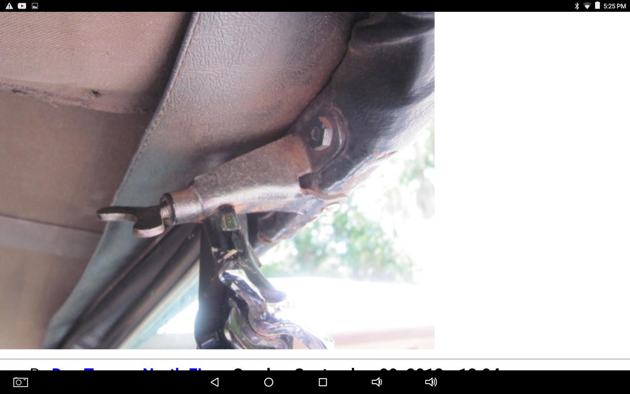

    Get a cheap blue tarp & some tarp tape to make your pattern the headboard normally attaches to the top of the windshield posts with a set screw built in to the top irons .

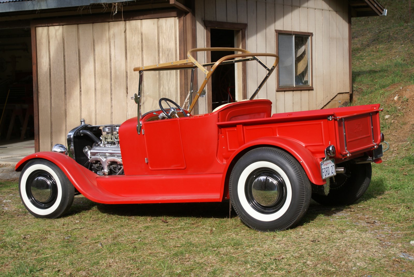

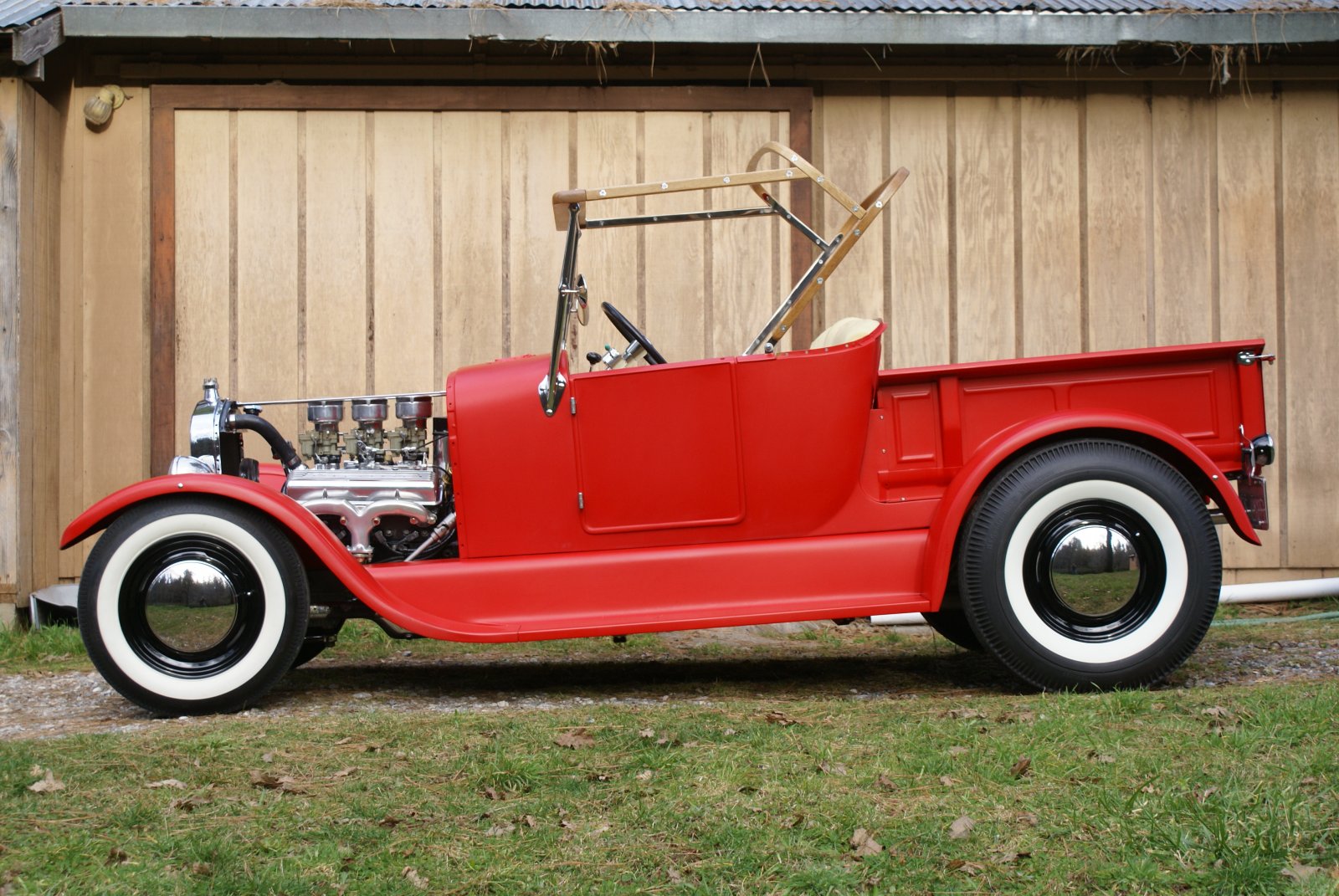

    Blake 27

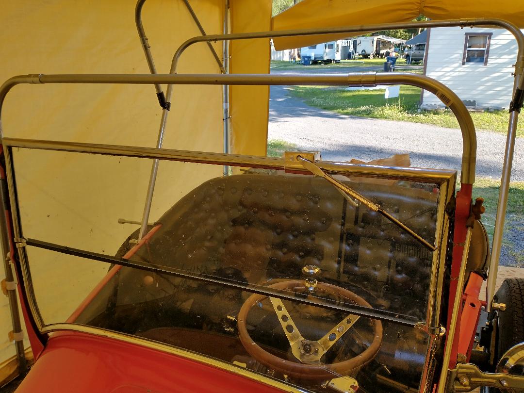

    I don't think you want to sit too high. On my bows , the header and the rear bow are the same height, with the center bow a bit higher. As you can see in the last photo we have plenty of head room and I can see out the windshield easily.
    The final shape is subjective, but I'm happy with mine. DSC02744.JPG DSC02779.JPG P8091554.JPG
    Atwater Mike, brEad, EVL401 and 4 others like this.

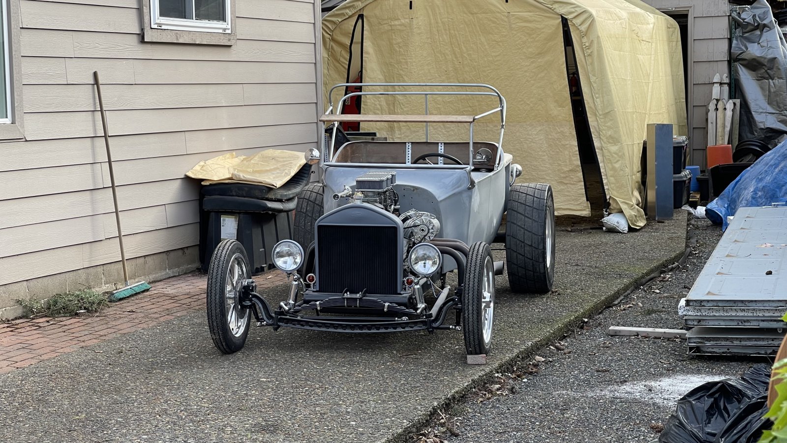

  19. I took 2 inches out of the bow above the drivers head to flatten out the top some ,still lots of room , original model T top bows 20220105_055644.jpg
    Jet96, Jim Hewitt and 2Blue2 like this.
  20. HOTRODPRIMER
    Joined: Jan 3, 2003
    Posts: 65,329
    HOTRODPRIMER
    That is one sweet ride my friend! HRP

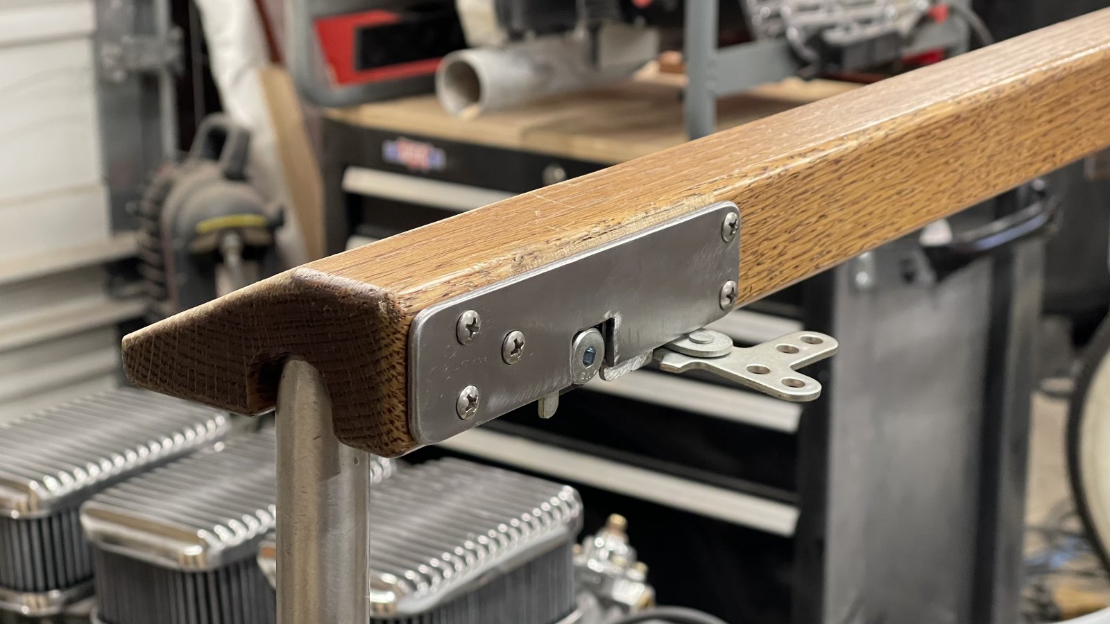

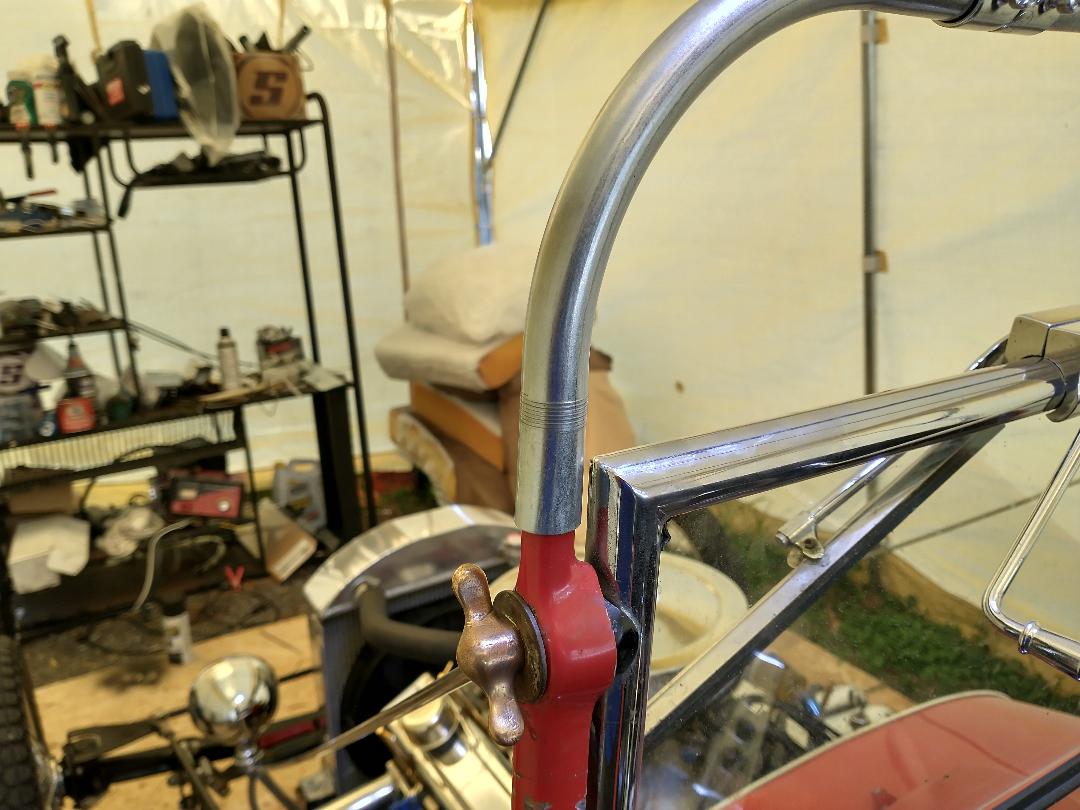

    For mine I bent up some conduit and used boat top fittings. My dad made the header out of 1x4 ash, with a radiused channel routed in the bottom to sit over the windshield frame. I drilled/tapped the windshield frame to accept little door strikers then routed pockets in the header for the latches. A steel bracket on each side holds that together, as well as ties the top framework to the header. You can’t see in the first photo, but I welded a tab to that metal plate, and the top framework bolts to that using a boat fitting that slides into the tubing.

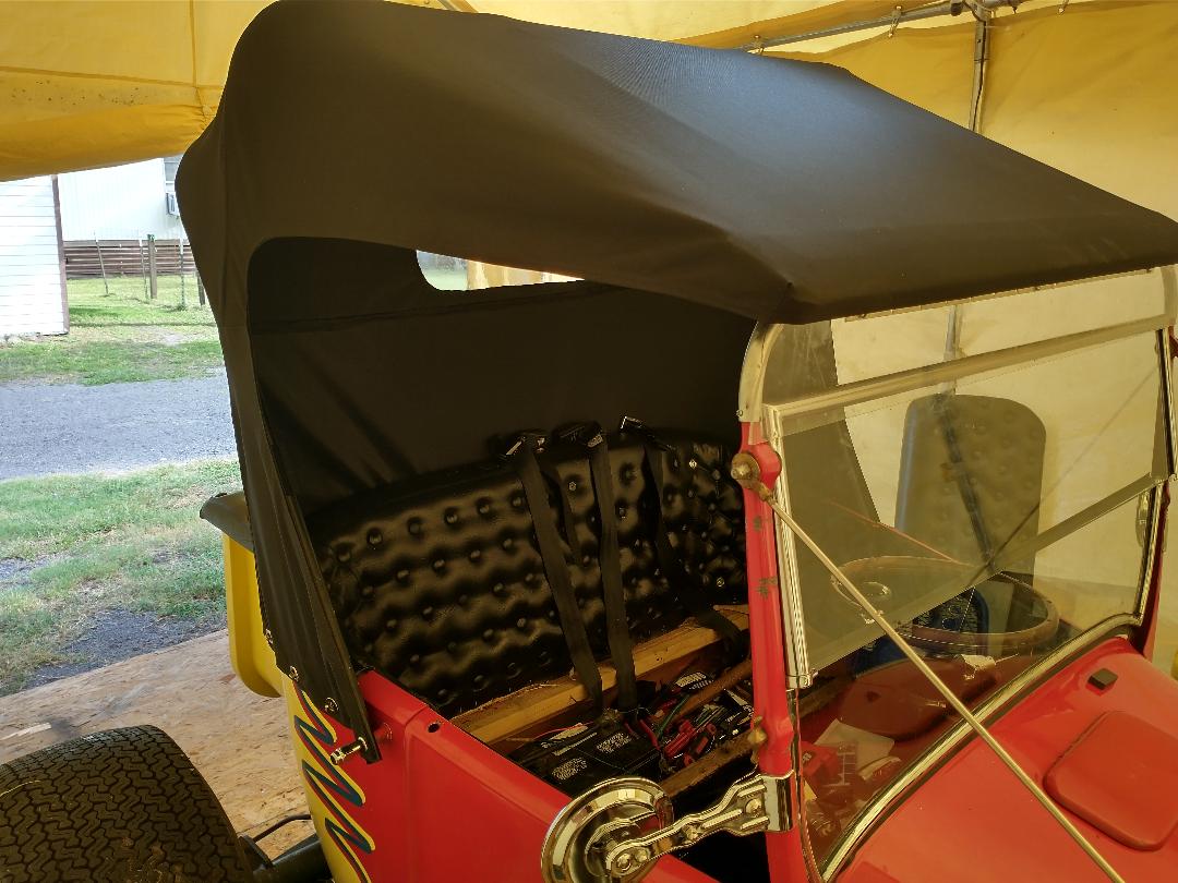

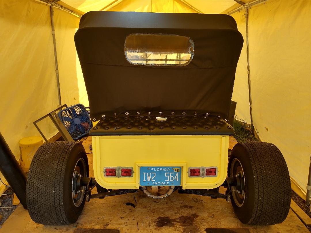

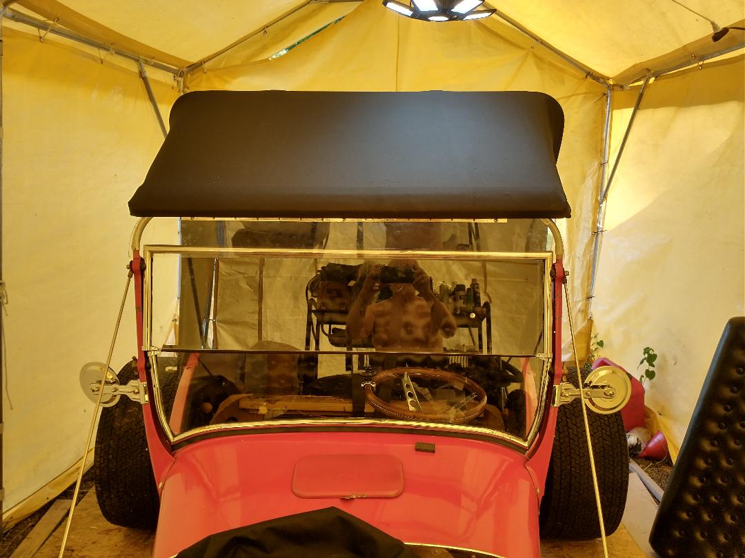

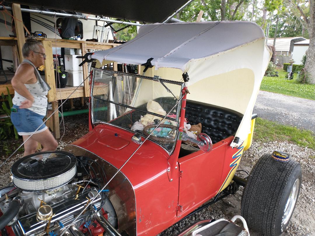

  25. Jim Hewitt
    Joined: Mar 6, 2022
    Posts: 34
    Jim Hewitt
    An update on the top. Got it finished except for a few finishing touches. Check out the pics

  26. Atwater Mike
    Joined: May 31, 2002
    Posts: 11,618
    Atwater Mike
    That's a TALL T!

    Very nice. Thanks for the pictures. What kind of hardware did you use to attach the rear bow to the body?
  28. dmar836
    Joined: Oct 23, 2018
    Posts: 410
    dmar836
    Any pics of the whole car now? Looks a bit radical-70s style.
    Tim, any pics of yours finished?
    D
  29. Jim Hewitt
    Joined: Mar 6, 2022
    Posts: 34
    Jim Hewitt
    The body is an original 27 Ford. It had mounting bolts on the side where the frame originally mounted to.
  30. dmar836
    Posts: 410
    dmar836
    Thanks. It’s not as tall as the last pic would have implied. It is tall though. Matches the styling of T buckets too. My ‘27 also has the full height windshield so wondering how to get a bit lower look. Nice job!
