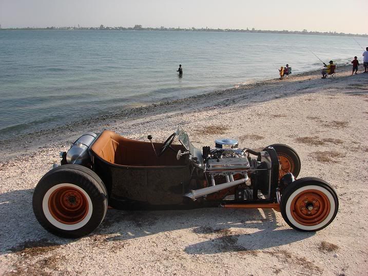

    Here are some pics of the one I built for mine.

    stock 27 lower with cut down stanchions. when the cardboard gets dirty, i replace it.

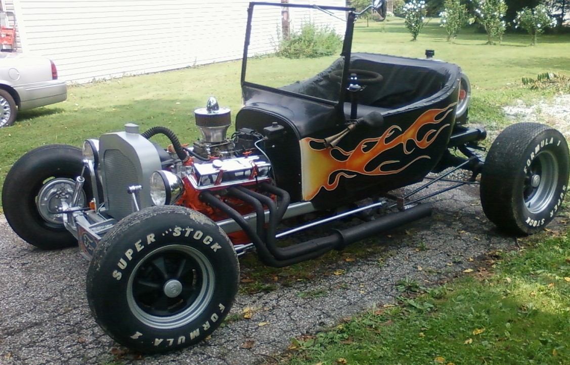

  7. I bought a stock two piece windshield with stanchions (posts), cut the posts down and used the half of windshield that looked the best.
    trying out the two different heights

    I've always liked these, but have never been able to identify them. Are they from a boat?

    Brooklands, English car stuff. Although I have seen the same deal done with wind wing brackets from early cars too.

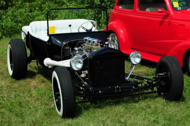

    I like the normal 23 T windshields but when I did my 23 I wanted something different to fit the look of the car a little better. I found some old windshield on Ebay (Buick maybe) and used the top half of it turned upside down.
    Then we cut up the stanctions that came with it and welded them to plates I made out of 3/16 mild steel plate. We painted it all black and had new glass installed, and this is what we ended up with:
    Don
