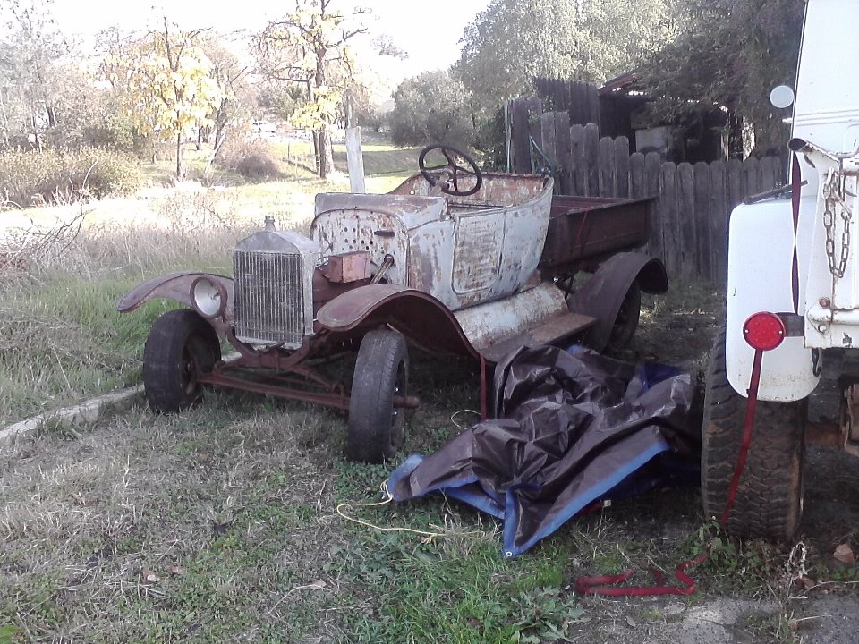

  2. I wouldn't be ashamed to be seen in that even as it sits. and at 5G that a pretty sweet buy in for a pile of smiles

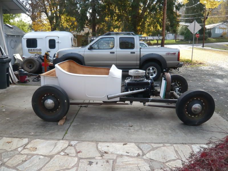

    I nickled and dimed mine together in one year for close to $3k. The only new parts I bought were engine bearings, cam, some other engine vitals, and suspension parts like rod ends, etc. Bought a new carb and gl*** for the windshield.
    I didn't do any machine work on the engine, I scrounged everything from the oil actuated shocks to the wheels.
    The frame, radius arms, floor, firewall, pedals, etc were all fabricated.
    There are ways to pick and choose what is important to buy new, and what you can make or scrounge. I have virtually no chrome on my car, and like it that way. Actually got best of show at a small local car show last weekend.

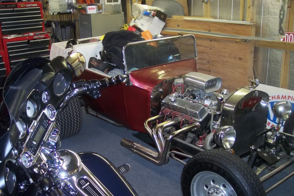

    mine sits off to the side in my shop... but i got 1.. its kind of a catch all.. I have a sbc turbo 350 trans, 12 bolt rear... rear tires are 29x18.5 x15..
