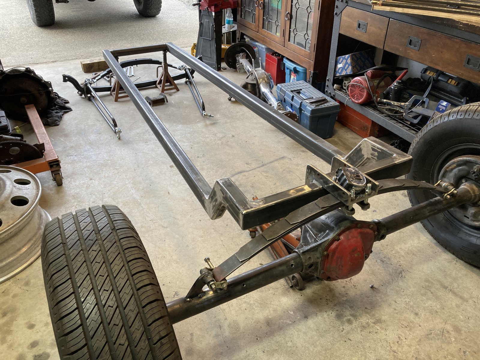

    IMG_1145.JPG Welded in the rear crossmember and the spring perch, then ran out of rod. Boo!
    Picture really doesn't show the taper in the rails.
    I spent the evenings this week fixing wheels and putting tires on. Need to find some brake rotors.
    Outback, brEad, Stogy and 9 others like this.

    After several weekends of "Honey doos " I managed to sneak away and get the rear suspension tubing threaded. The rear axle is all cleaned up and ready to fit up. Maybe tomorrow, in between helping my son with his drift truck. IMG_1160.JPG IMG_1164.JPG
  24. dumprat
    Joined: Dec 27, 2006
    Posts: 3,572
    dumprat
    from b.c.
    68877269960__94A14E66-2784-4EFD-A101-8D0B8061ECB4.JPG Slow progress.
    Seems really high, but I guess it will drop a bit with the body on. Real 60's style stance vs a more modern low.
    Outback, brEad, Tim_with_a_T and 9 others like this.
  25. Tim
    Joined: Mar 2, 2001
    Posts: 20,344
    Tim
    from KCMO
    I think that’s why mock ups are so important in a world where so many cars sit literally on the ground.
    Most traditional cars even threw the 70’s sit like monster trucks compared to something contemporary. But it looks right. Slam a 40’s build 3” off the ground and it looks ridiculous. I see that happen occasionally when someone’s building by tape measure and not looking at what they are doing

  26. RICH B
    Joined: Feb 7, 2007
    Posts: 5,964
    RICH B
    I always located the axle ahead of the crossmember to allow for suspension movement; but maybe I'm looking at things differently.

  28. desotot
    Joined: Jan 29, 2008
    Posts: 2,046
    desotot
    What's your bolt circle ?
  29. dumprat
    Posts: 3,572
    dumprat
    from b.c.
    Jack. The reversed wheels are 5 on 5.5 ford truck. The torque thrusts are 5 on 4.75 Chevy.
  30. dumprat
    Posts: 3,572
    dumprat
    from b.c.
    Exactly the point Tim. These dimensions are carried off the old frame using similar parts and as many old brackets as I can. I want legit old style, not new old style.
