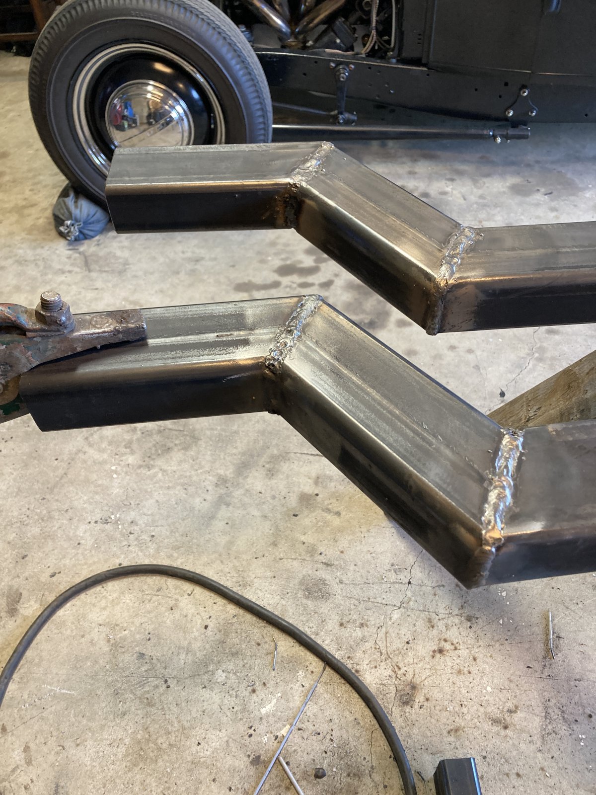

    IMG_1197.JPG Yet another small update from the world of decrepit used hot rod parts! Got all the nastiness filled and ground out of the original front spring mount. Had to make a new center. The old one had lot of torch work done to it.
    tb33anda3rd, brEad, spanners and 8 others like this.
  4. dumprat
    Joined: Dec 27, 2006
    Posts: 3,572
    dumprat
    from b.c.
    IMG_1200.JPG A little closer. That speedway spring needs to down to three leaves I think. Way too stiff now.
