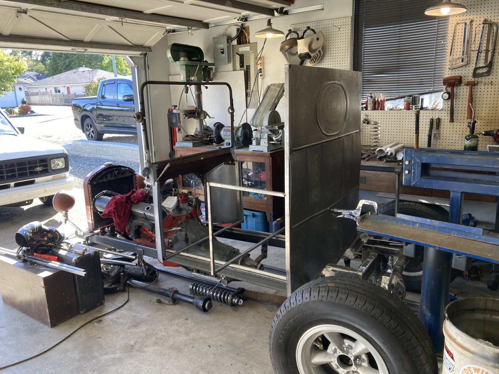

    IMG_1742.JPG IMG_1744.JPG Still suffering with aftermath of my bike crash. But I did manage to get some stuff done yesterday and today. Slow going and had to take. A lot of breaks but I managed to get most of the cab sheet metal cut out and ready to start forming. Copied the SW bosun panel for the rear window shape. I need one of my kids home for a day to help bead roll the parts. Some of the OG parts are not from the same years. Gonna take a little figuring out.

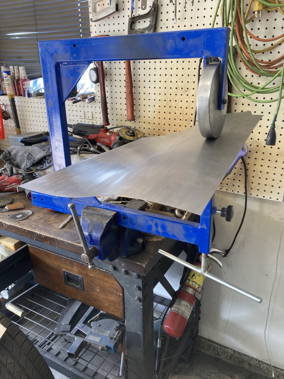

    Physiotherapy for my messed up shoulder. Repeated pushing and pulling actions! The mini English wheel is a piece of **** but for $100 with 8 anvils it works ok. I need to beef up the frame a bit. IMG_1746.JPG IMG_1745.JPG

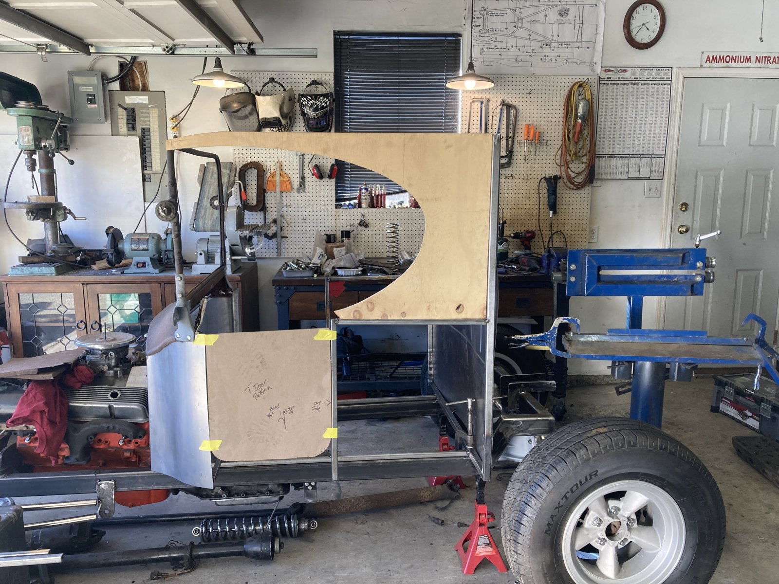

    Started tacking some junk together to see where it sits. I'm going to fit the windshield tomorrow and test fit the down to the frame.
    I had my daughter and 80 year old neighbor help get the beads done on the back panel. Good thing most of them will be covered! My arm is still not in good enough shape for this. It might not be for a few months IMG_1753.JPG IMG_1754.JPG

    I'm wondering if I should lean the back panel backwards, or angle the bottom to match the kick in the frame. Opinions? Not sure if leaning it back will look goofy.
  11. RICH B
    Joined: Feb 7, 2007
    Posts: 5,965
    RICH B
    Thinking the back and the lower corners of C cabs should be square when seen from the side.
    Olcars and dumprat like this.
  12. High test 63
    Joined: May 8, 2020
    Posts: 558
    High test 63
    I also think when viewed from the side , the back looks best straight up and down,
    Like an old original delivery truck.
    I've thought of building one of these and am excited to see how you do it.
    Keep up the good work Dumprat!

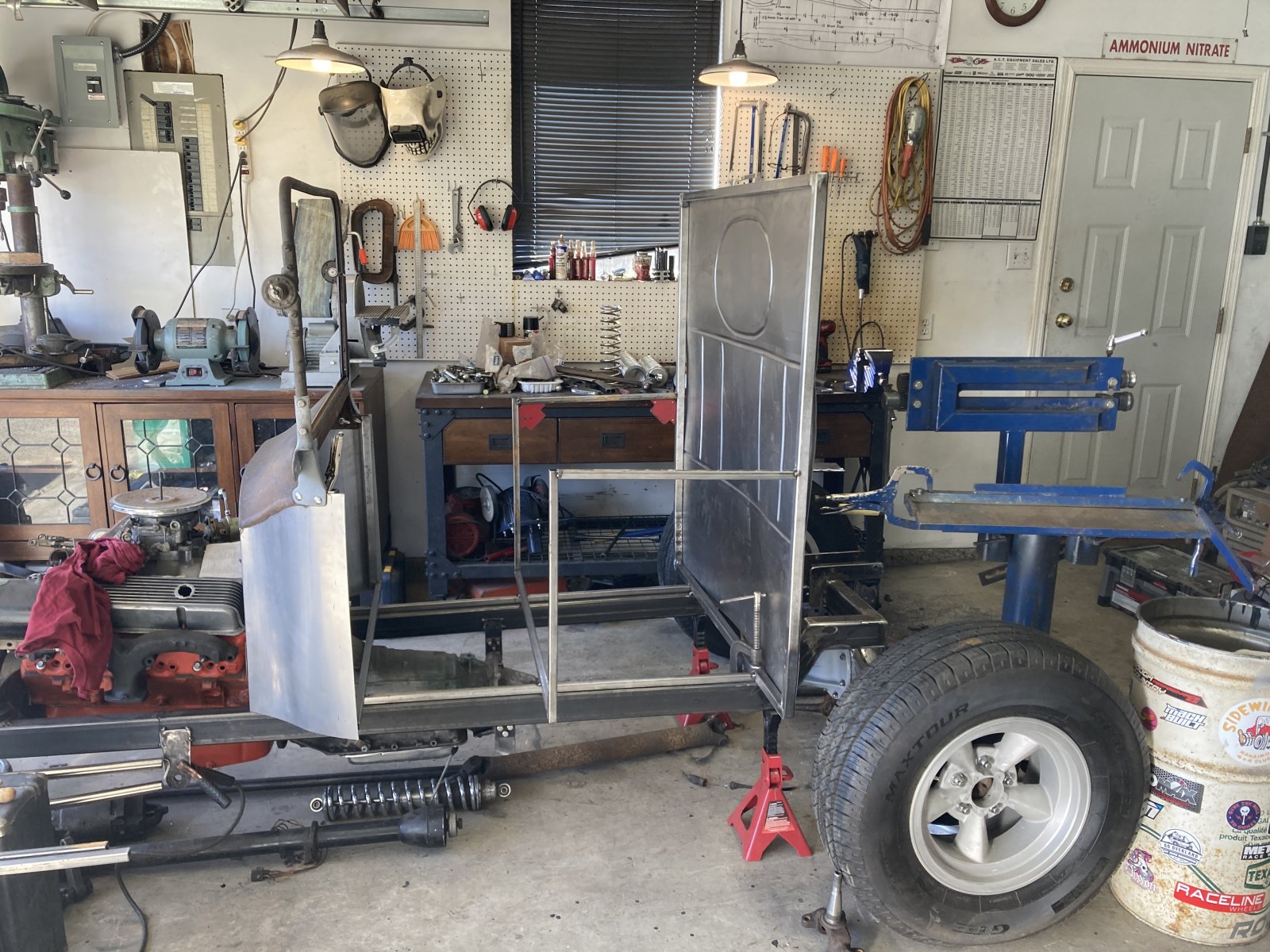

    Big steps today. Started putting together the tube structure for the cab. The back panel is just tacked on at this point. Cowl still needs to go down 1/2" and the windshield is getting chopped another 1-1/4" I think. Motor needs to move ahead 1-1/2" and up at least an inch. Rear axle needs hung and moved back 2" IMG_1763.JPG IMG_1764.JPG IMG_1767.JPG
    Lots of tubing to cut and weld. I need at least another 40' of 3/4x.062 for seat frame, dash rail, and door frames.
    Kinda cool to step back and see what it will sorta look like.
