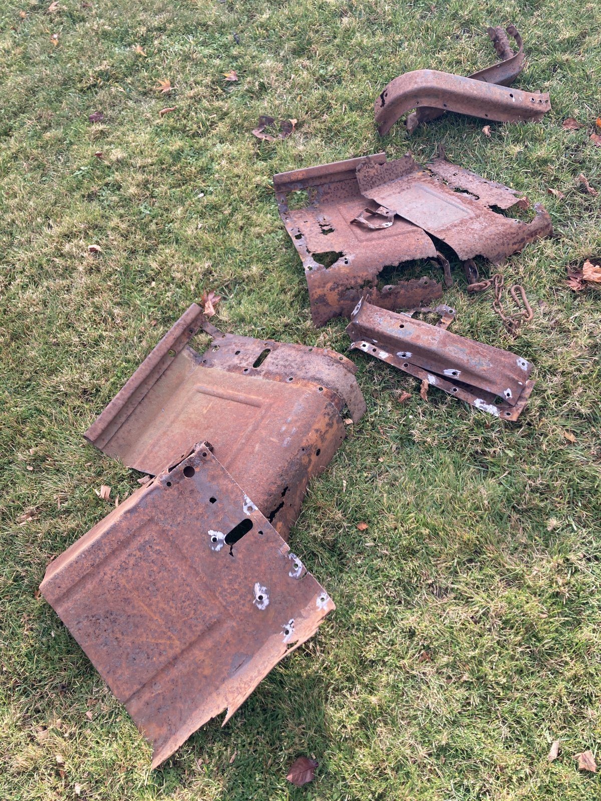

    I've been busy building parts for other people again lately, but today I had a chance to tack some of the rear suspension parts in place and get a look at where they need to be.
    Rear needs to come back about 3/4" and I still need to cut the spring perch off.
    I'm going to build a Watts link for it to reuse the panhard mount on the axle. Should be fun! IMG_1869.JPG
