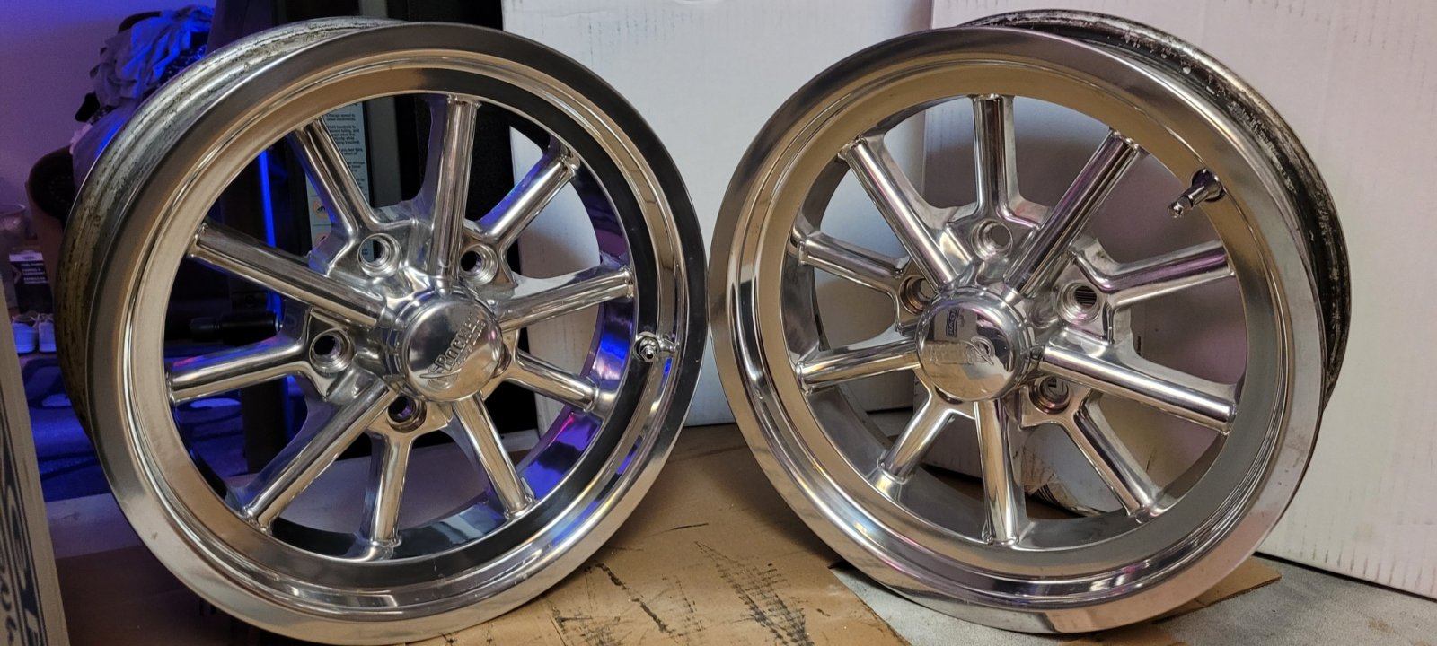

    While I fully admit these are terribly cliche T bucket wheels I kinda like them. They look like spindle mounts but I can run brakes on the front. I finally found a pair I can afford and now I just need to figure out how to get hem across the province.
    I might sand blast the spokes and put some ET two bar spinners on them. Resized_20231214_181217.jpeg

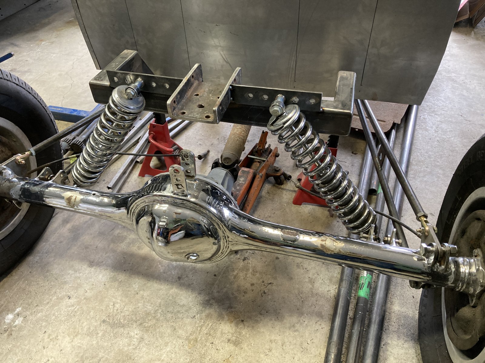

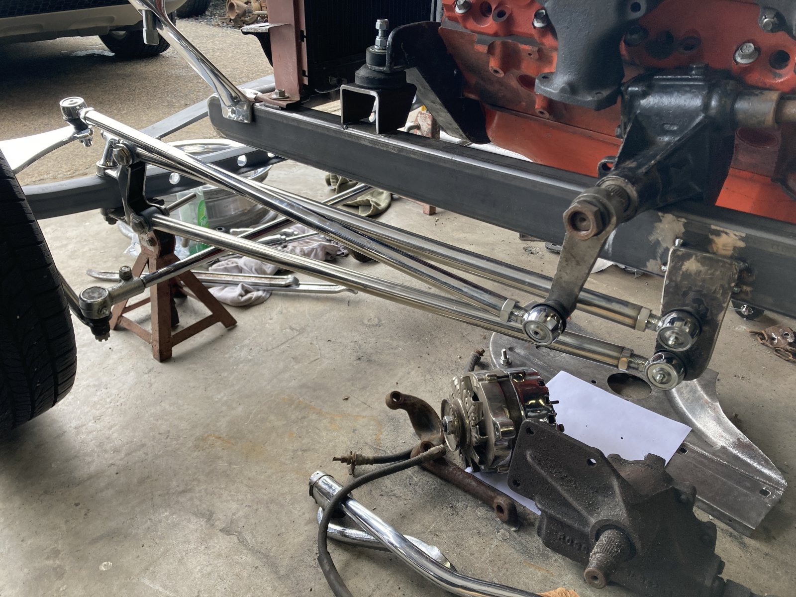

    B441ACC6-8A7C-47B0-9195-A6BA3AC92EE8.jpeg C21F654D-AC7F-4636-ACB1-3A6973A86A95.jpeg D42D01F1-97E3-451C-8D59-526ABB1D891A.jpeg Got my new wheels. Would like them better if they didn’t use dumb proprietary lug nuts. Might machine off the rocket brand logo.
    The steering looks like it’s going to work. Trans needs to go up still, tomorrow.
    Rear coil mounts are tackled in. I’m leaving the traverse spring mount in place. It would make a mess removing it, and it doesn’t effect anything in place.

  24. twenty8
    Joined: Apr 8, 2021
    Posts: 3,697
    twenty8
    Just a thought.....
    Having the top coilover mount holes running horizontal might not work well.
    Example: As you stand the coilover up more towards a verticle position, it will raise the frame up and also make the suspension stiffer. The opposite will happen as you lay the coilovers over more (lower and softer).
    To maintain ride height, the row of holes would need to follow the arc made by the top eye of the coilover, along with some allowance for the spring rate vs angle change.
    I would also make it a 'double shear' deal at both ends of the coilover. It is more than just a shock mount. It will carry the whole rear end m***.
    But, having said that, I still think this is one hell of a cool build.....:cool:
    The steering looks nailed. Can you give us a full side on view?

  25. Stogy
    Joined: Feb 10, 2007
    Posts: 27,207
    Stogy
    So what your saying is one of those holes will likely be the sweet spot the rest not so much...
    It's interesting the typical coil sprung rear end versus these coilovers...way smaller diameter...but weight rating is what it is...

  27. dumprat
    Joined: Dec 27, 2006
    Posts: 3,572
    dumprat
    from b.c.
    @twenty8
    As I have no idea at this point how stiff these coils will be I need the ability to decrease and increase the rate. There are three sets of holes at the bottom to adjust ride height, as well as the adjustment screws on the coils them selves. I can always buy lighter springs.
    There will be a box on this. Probably about 30” long. And I’m building the upper coil mounts double shear, I just haven’t got there yet.

  28. twenty8
    Joined: Apr 8, 2021
    Posts: 3,697
    twenty8
    Maybe..... Maybe not.
    The spring rate required should be calculated first, with allowances made for the angle the coiler will be mounted.
    This will not be spot on exact, but you should be well inside the ballpark.
    The coilovers should then be setup with the rear sitting on the ground, under the cars full m***, and at the desired ride height. Any angle adjustments made afterwards will need to take into account both ride height and stiffness.

    Joined: Apr 8, 2021
    Posts: 3,697
    twenty8
    Excellent!!!
    It sounds like you have the whole ride height / suspension stiffness thing covered. Adjustability is the key.
    Can you post pics of the lower mounts please.
