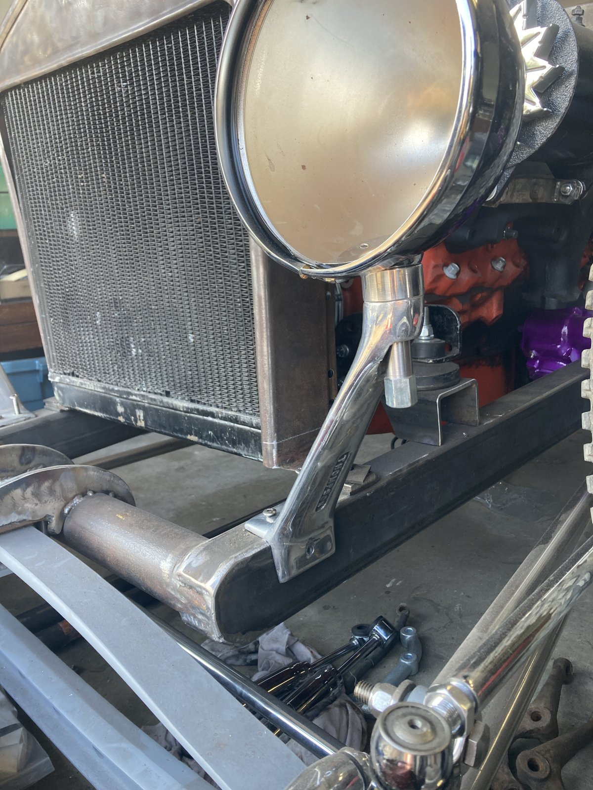

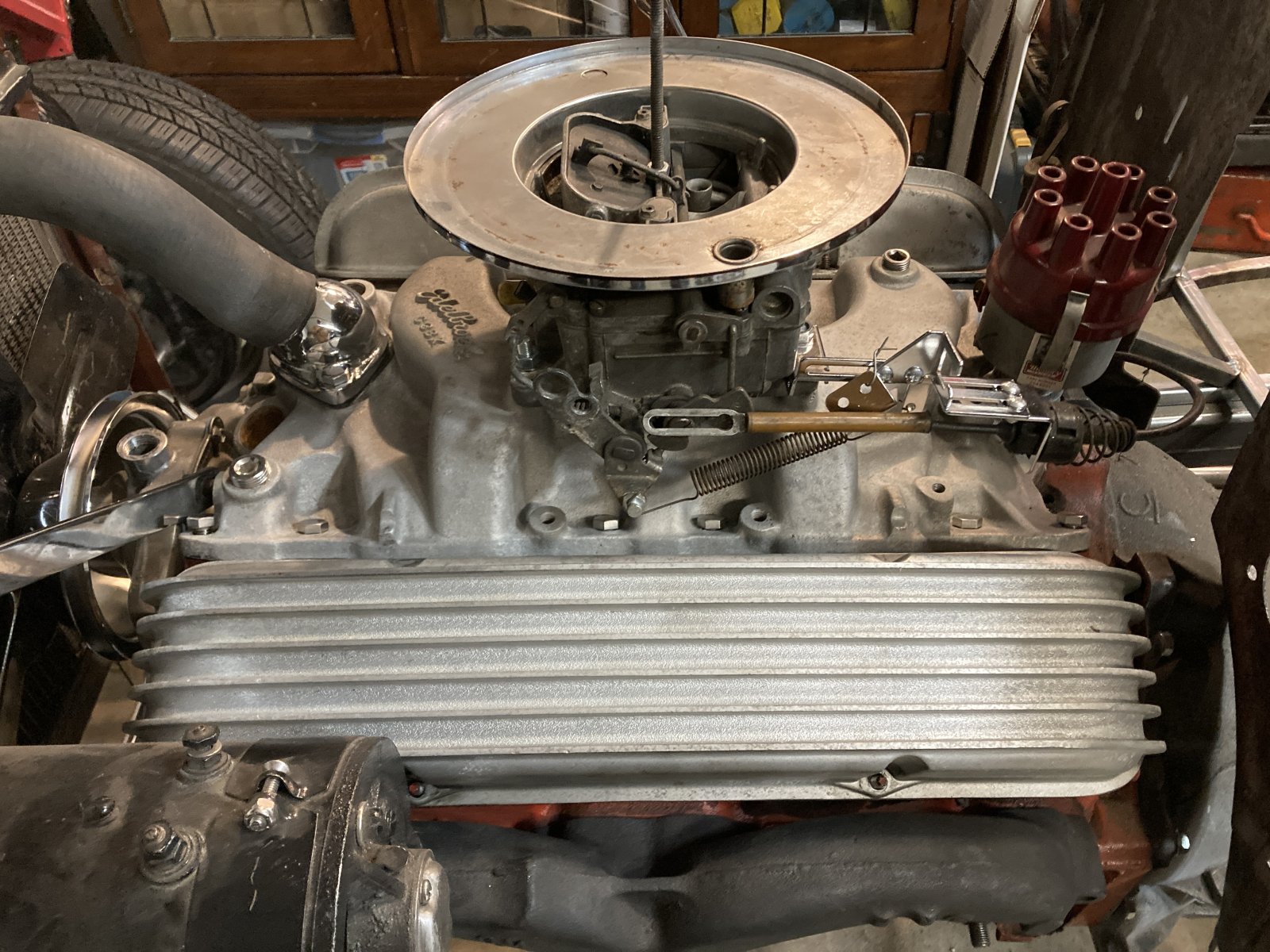

    Picked up some nicer valve covers and a nice vintage Edelbrock C3B dual plane intake. Need to find a chrome oil fill tube. Buddy hooked my up with a beautiful old chrome 57 Chevy cast iron water neck. It’s been on a shelf since the 80’s 4275BFFD-6116-4FAD-B6E5-9209D0CC29E8.jpeg 78B3D6BA-F67E-40F3-B326-1754BAB5A070.jpeg

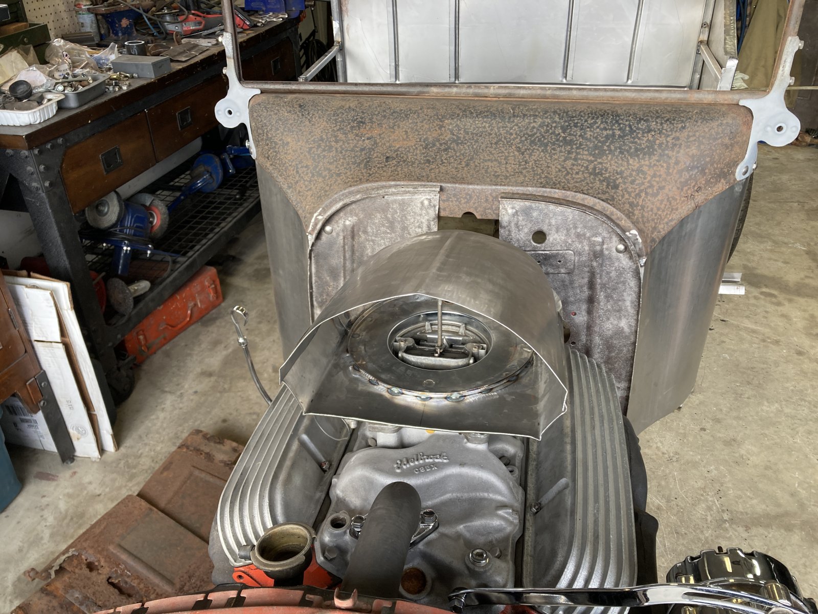

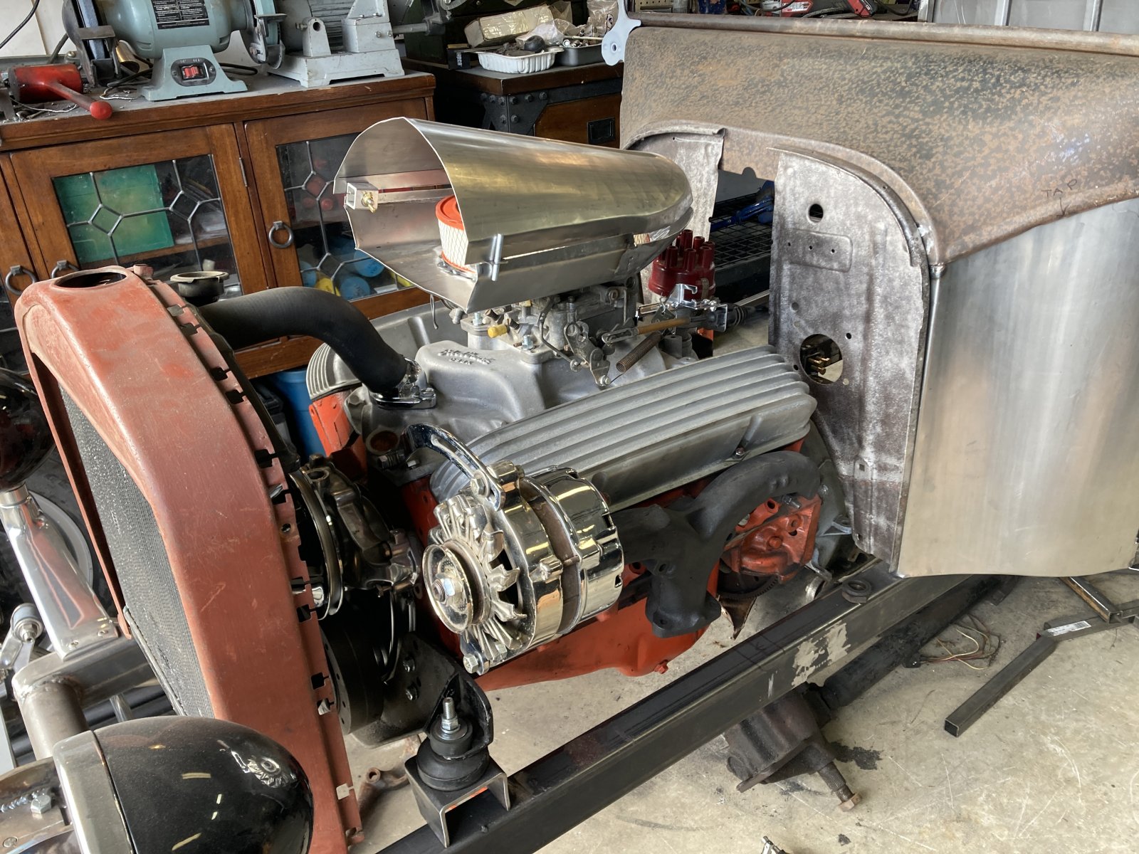

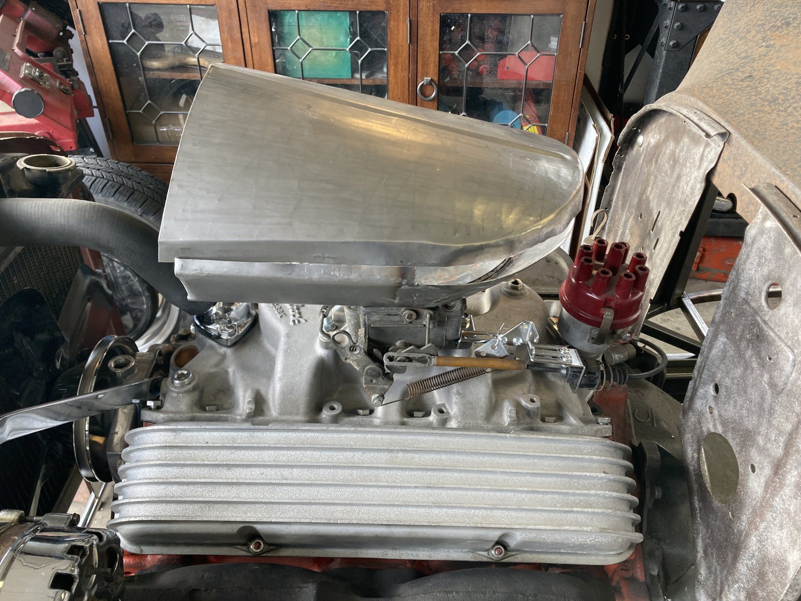

    A little part of this part that has been burning holes in my brain since I cut out the sides of the cab. I used the scrap pieces to build a surfer style scoop. I wanted one with an air filter . This uses a cheap chrome base and a CJ7 filter. Seems my kid used the chunk of 1/4” aluminum that was going to use for a lid.
    Really fun project. Needs several more hours but I’m out of time for today.

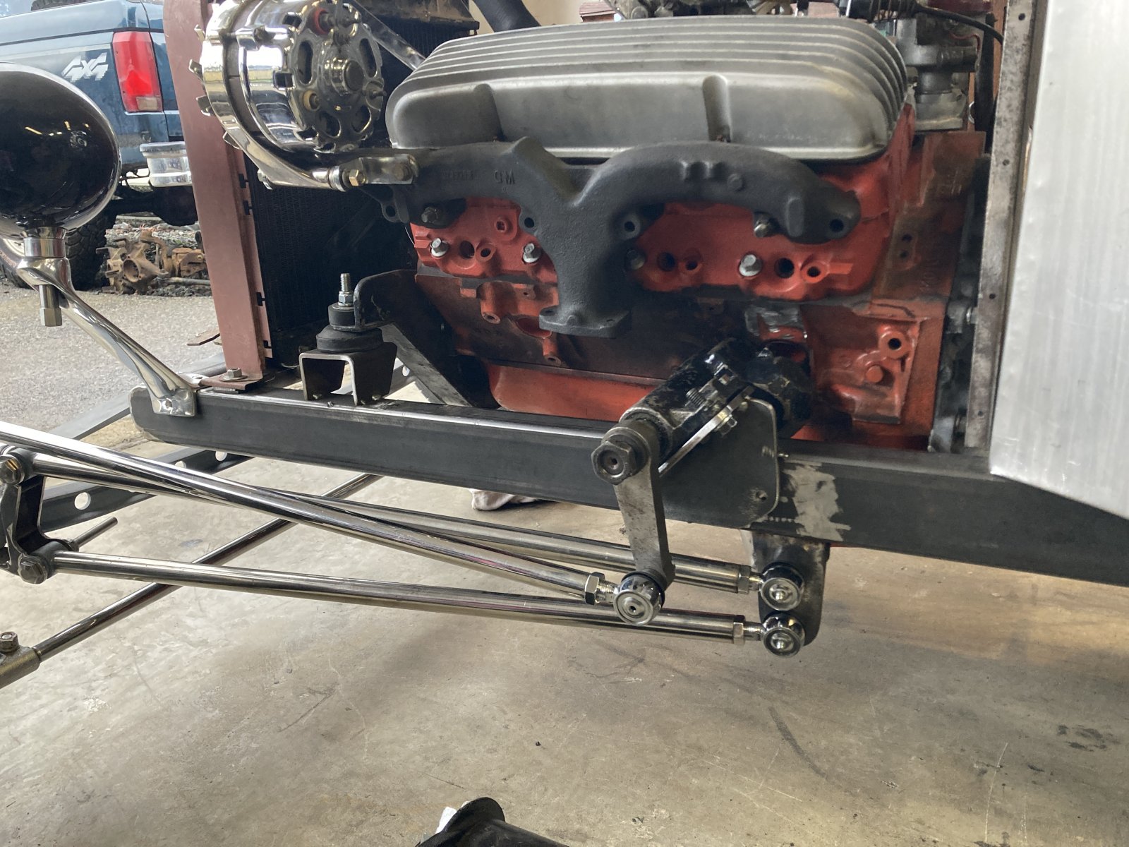

    Well after several different boxes and tries of things I have the steering figured out. I’ve been busy with less than fun family stuff lately and have had lots of time to think but little shop time.
    I’m going to run a reversed mustang box with the pitman pointing down. I mad a bracket today and it will fit. I will hopefully get the front link mounts done tomorrow and double check the geometry and reverse the box. I will need to clearance the block a bit. (You can see the felt pen line)
    I’m going to run through bolts as well as weld on the box bracket, cause I love stainless acorn nuts.

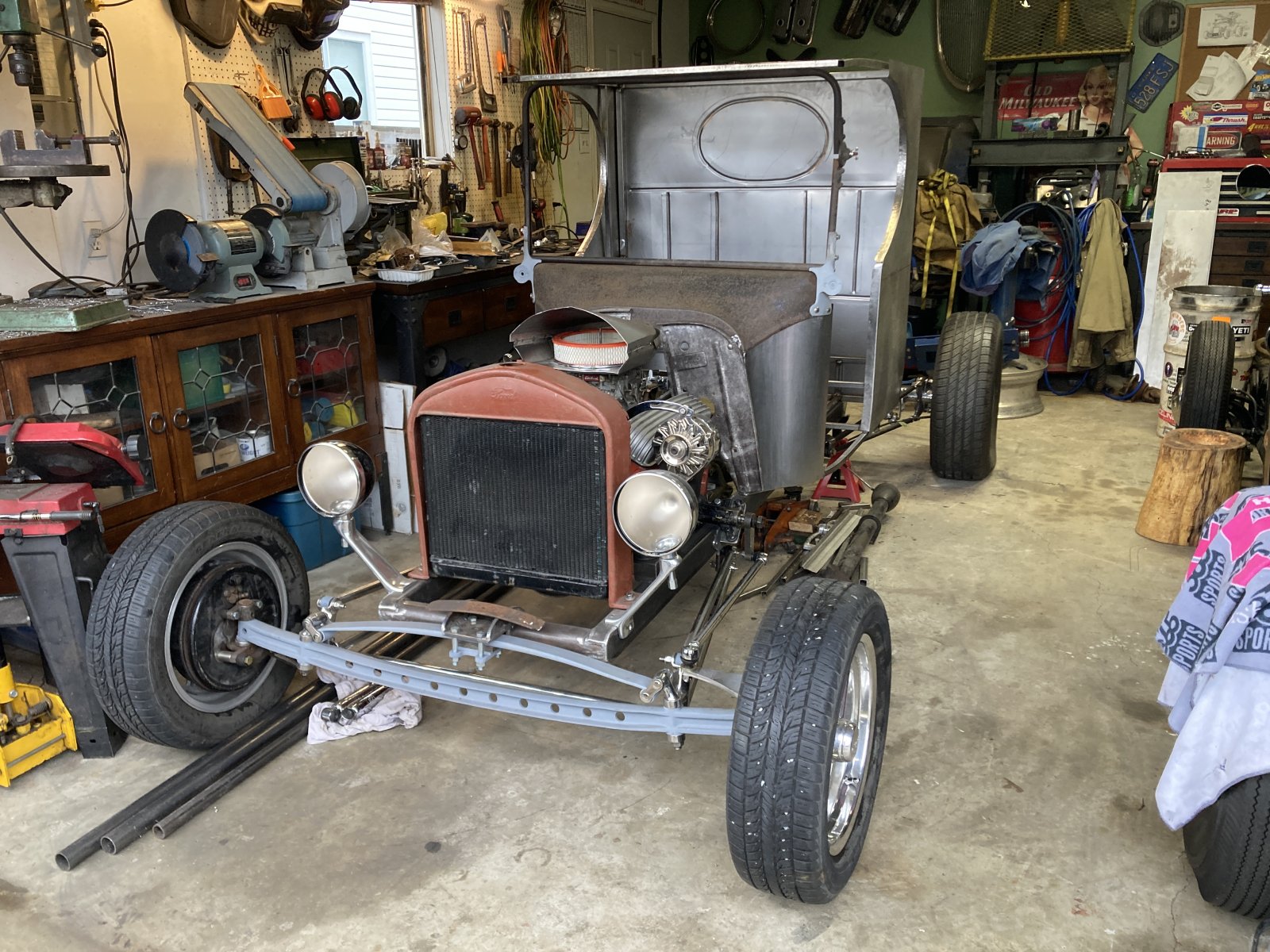

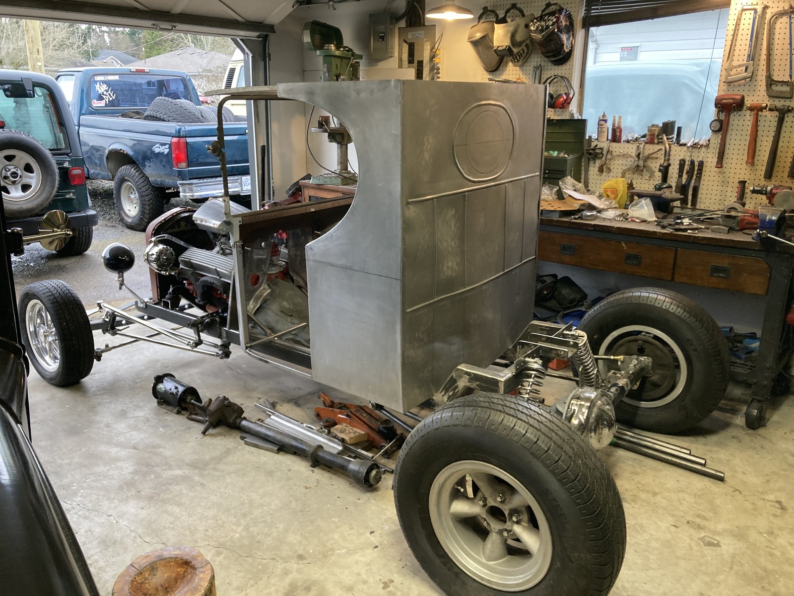

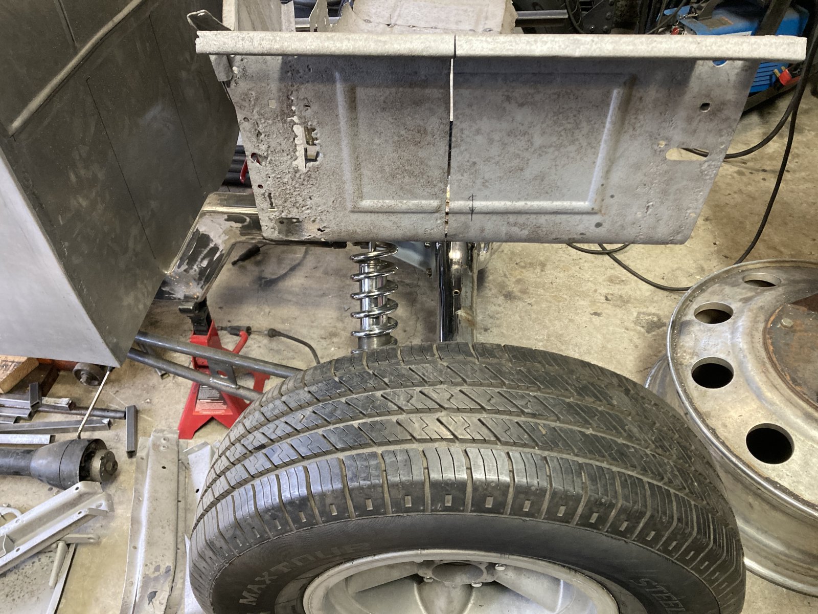

    Got some shop time in today. got the front link mounts tacked on. Got the truck rolling on 4 wheels and spent a bunch more time on the scoop.
    I definitely need different springs in the rear. It’s it’s pretty good but needs a touch more rake and a way softer spring rate. It doesn’t move at all. Not ideal. 02130114-1DEC-43CD-AE86-82E334BDCF46.jpeg 22518AB5-B96C-47D9-9D3D-FD019E76C4FB.jpeg AA7E6127-E054-455F-B663-826DD3F1E654.jpeg 3F3009BF-A9B4-47F3-88AA-EDE4EC496B66.jpeg

    Needs a dropped axle and different fires. Radials suck.

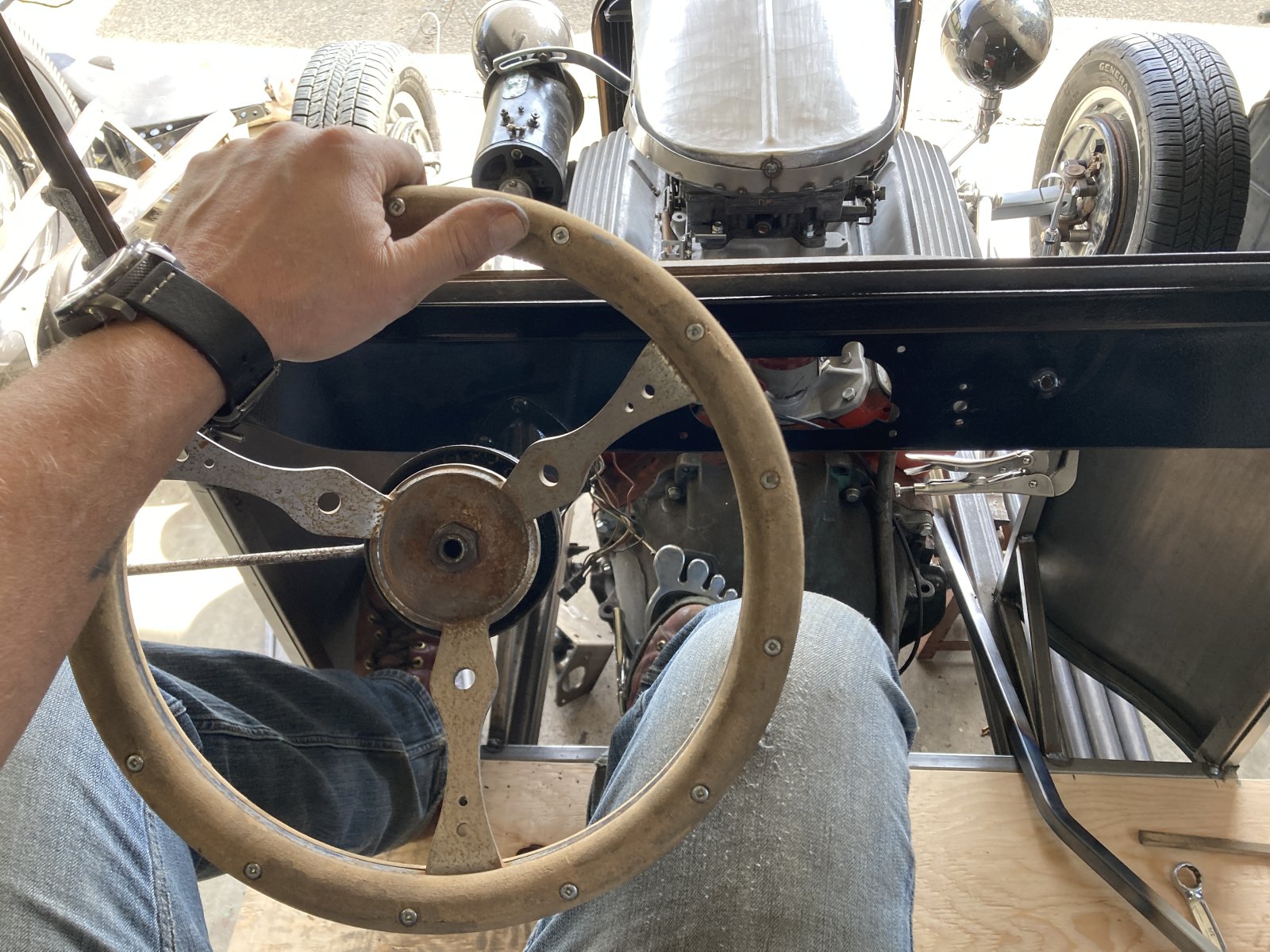

    43BEC402-D293-4BF8-A3E3-5C581C299F1C.jpeg C5BDAA93-4603-4503-ACAA-2E2B1E9C8283.jpeg A4E89E1E-59F2-4D58-A6B2-C2E3F909D29A.jpeg Been a bit.

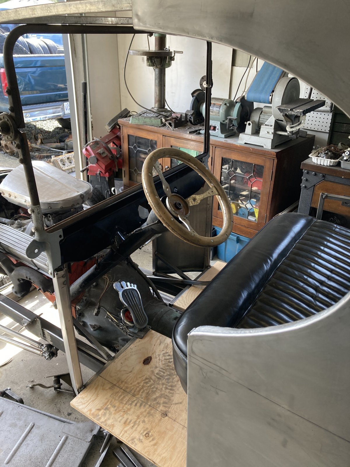

    I made up some plywood floors for mock up. Shoehorned the seat in, it fits so tight I swear I was going to have to lube it up to get it in…
    The column is good angle for a mock up. Ergonomics are very traditional T . Cramped buy not uncomfortable.

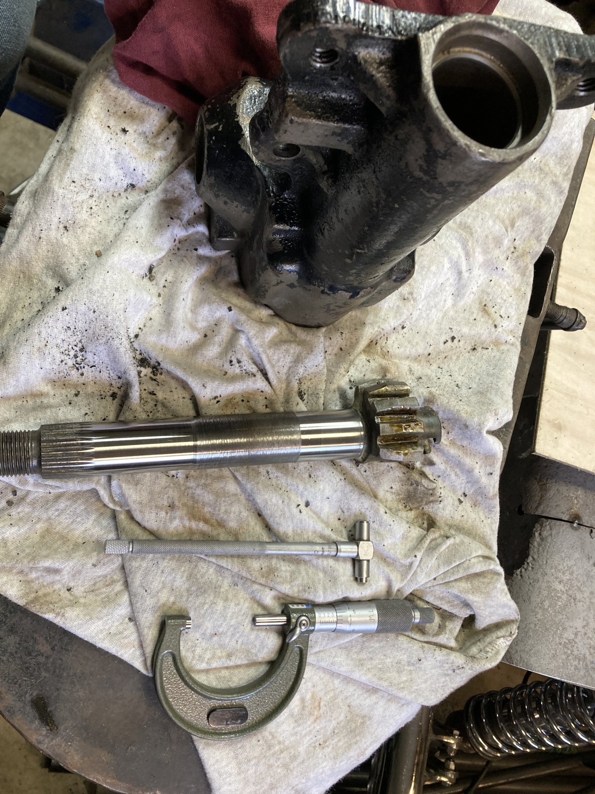

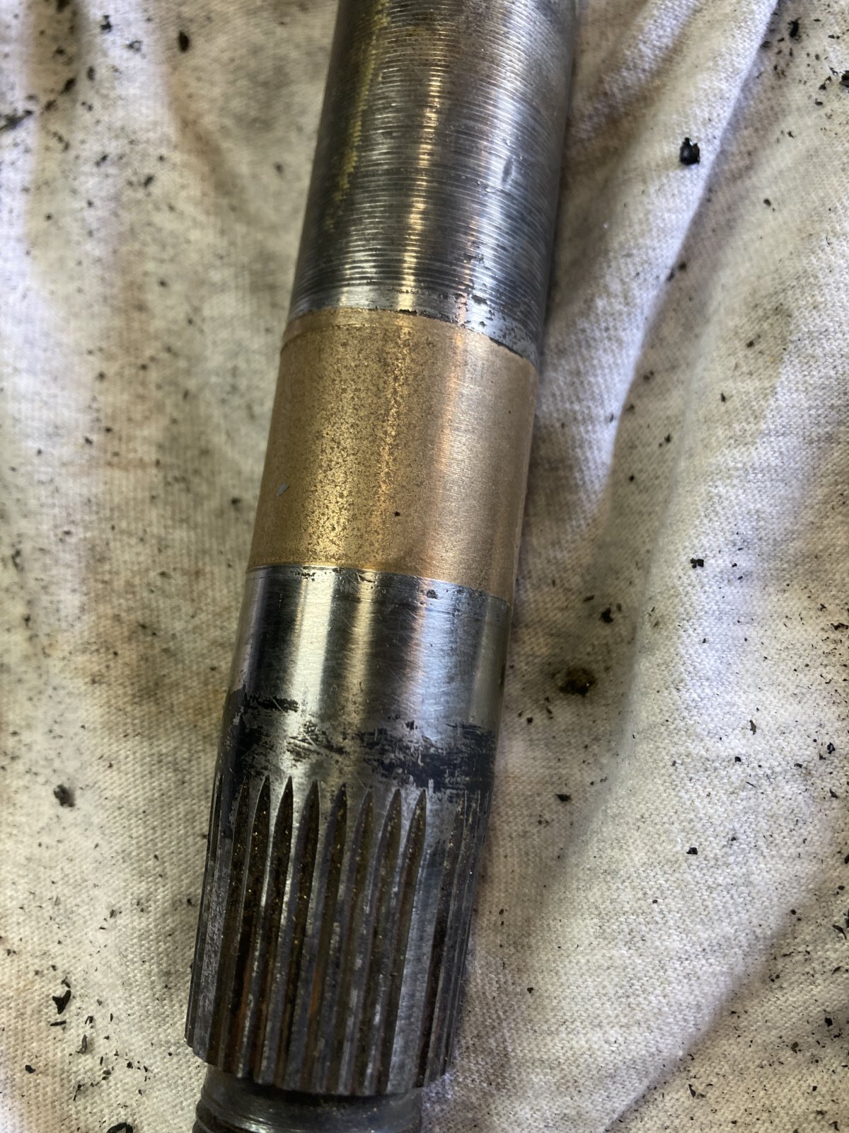

    Well I guess that’s why the steering box was cheap! Some dumbass spray welded the worn area under the needle bearing….
    I turned it down and will replace the bearing with a bronze bushing, probably better as the it will be well above centerline and would have a tough time getting grease in this application. Going to put a zerk up top so filling it’s easier too. A wide grease groove should assist with lube delivery. Fill er up with NLGI 1 5% moly and we are off! 9CFE7A3A-27C7-4CD2-9641-00F74E9A029B.jpeg 3988BCEB-F65D-43E6-BB68-0FDDC1A020A8.jpeg

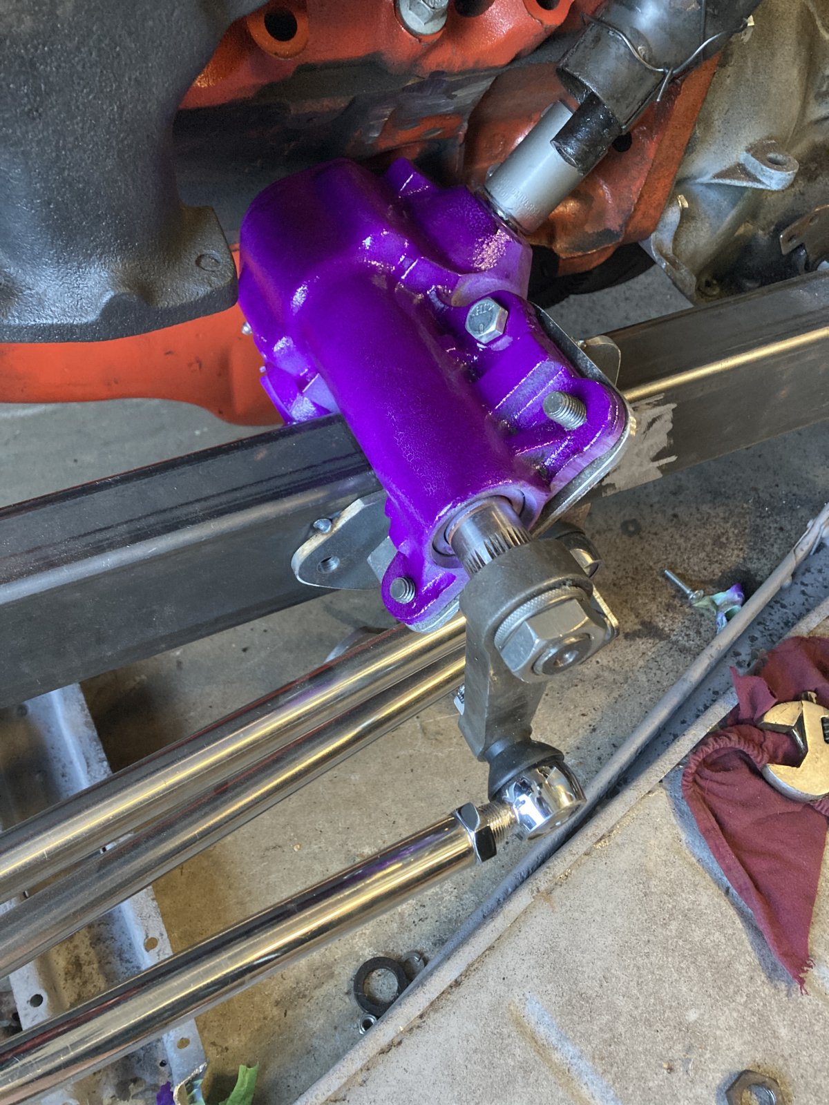

    Steering box reassembled with a new bronze bushing and filled with NLGI 1.5. Couldn’t find and 00. Not a lot of call for corn head grease on an island, found lots of waterproof marking grease though… Digging the purple colour . IMG_2231.jpeg

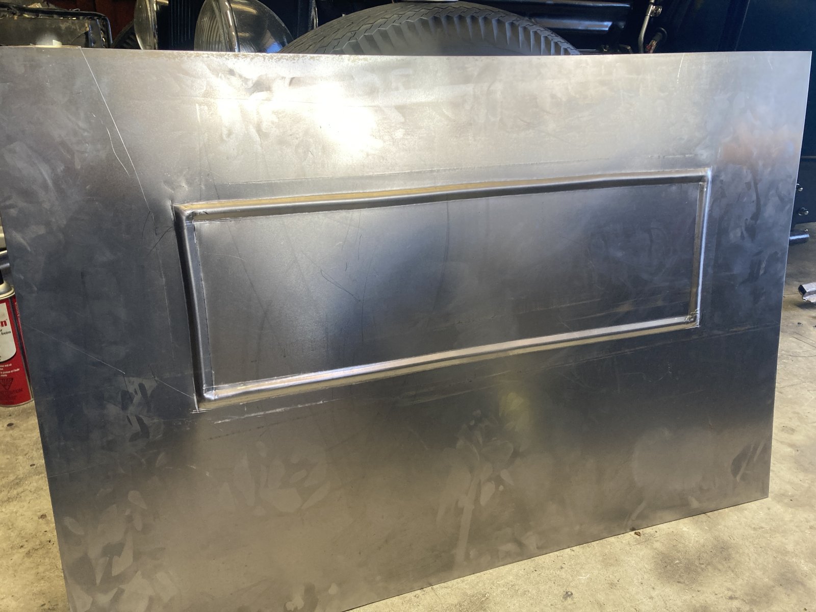

    Go the new box sides bead rolled. The OG ones were too far gone. Hopefully get the tops bent up and bottom rolled today.

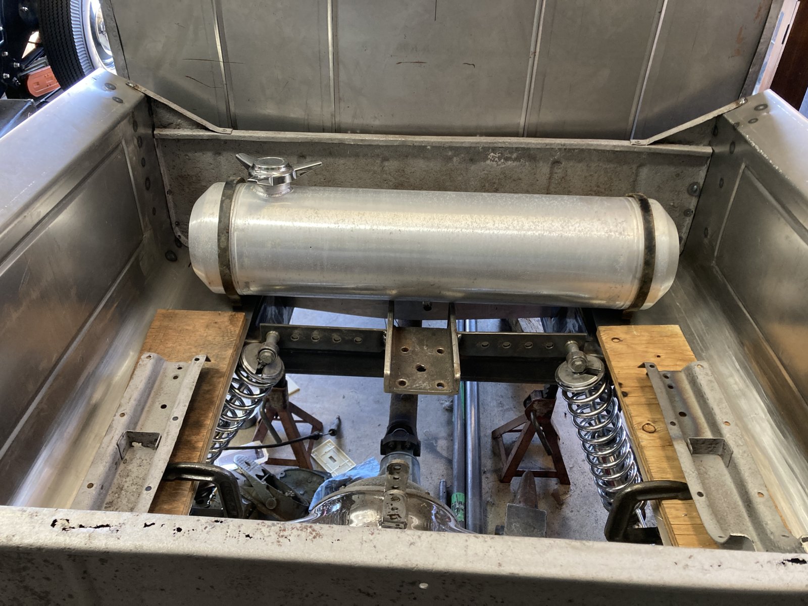

  26. dumprat
    Joined: Dec 27, 2006
    Posts: 3,568
    dumprat
    from b.c.
    Box is kinda scabbed together. Needs the rear stake pockets done yet. And a shit ton more welding. Fuel tank looks tiny in there… IMG_2356.jpeg IMG_2357.jpeg

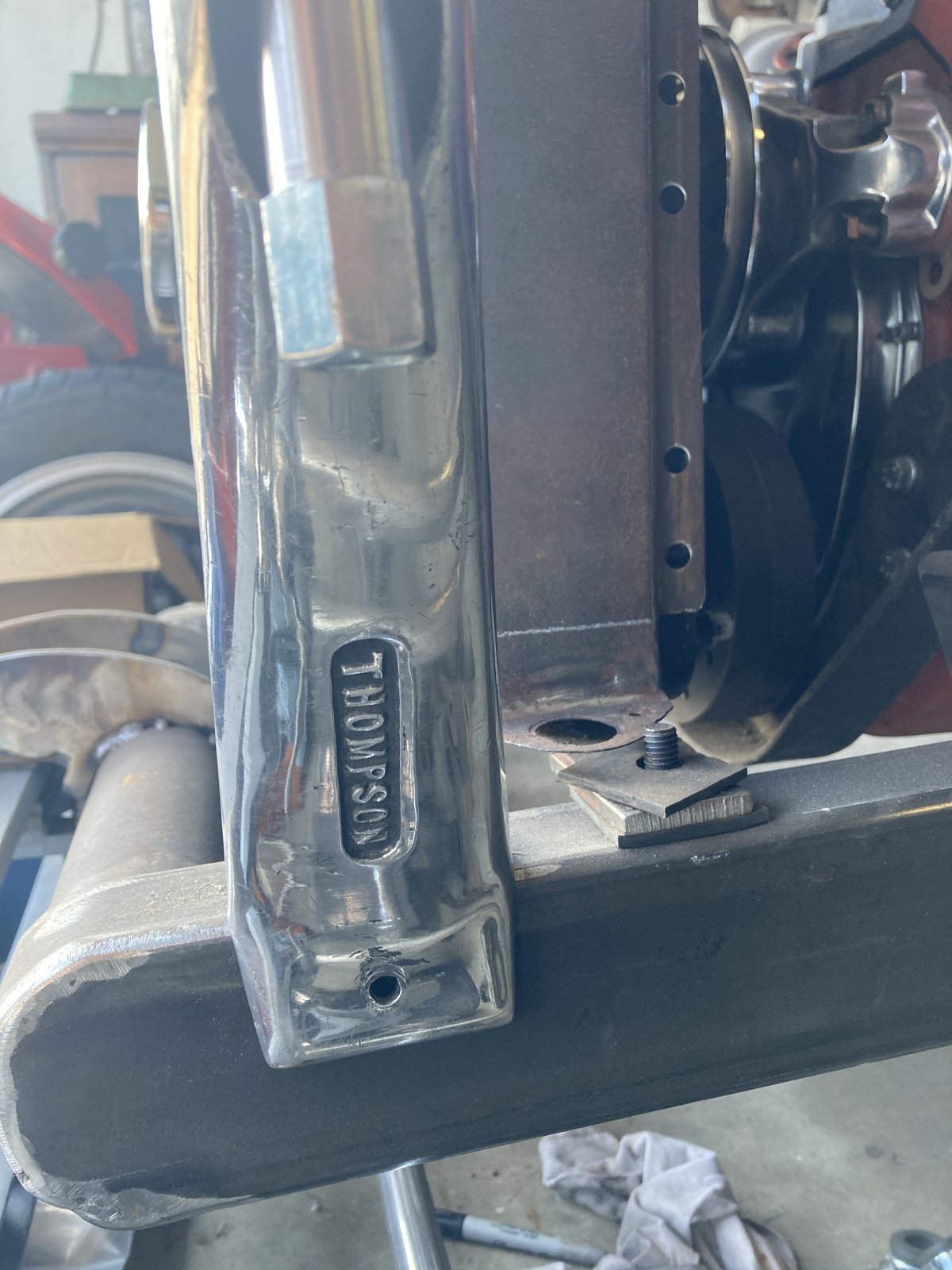

    I did however manage to throw a quick polish on the very vintage Thompson headlight stands I picked last week. A whopping $10!

    NO, LMFAO! The guy thought they were legs off some sort of table. He thought it was neat when I told him what they actually were. He got them in a box of junk at a garage sale.
