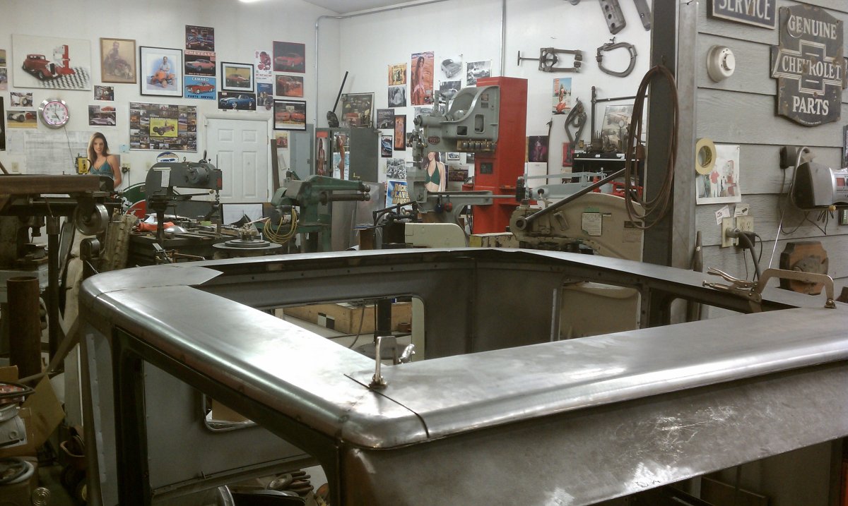

    It seems to me that you either like and want a Model T or you don't, I just don't see how such a drastic roof change will improve a Model T, best go with a different body style altogether.
    The Model T roof is not as simple as it may look.
    It is quite wide and has an unusual edging compared with later models plus the back corners dip down.
    It is definitely not as flat as it looks and first impressions of a T roof can be misleading.
    The rear corner dips IMHO became a part of a bad design fault as the original roof cloth broke down, water would leak in the back corners and the moisture would run down the rear panels straight into the belt line where over the years a lot of rust out would do much damage to a difficult spot to repair as many T coupe owners can attest to.
    To replicate a T coupe roof again IMHO, it is best to copy the wood edge in sheet metal and then fill in the center with a suitably curved sheet metal piece.
    Re-roofing a T coupe is a good opportunity to also add some extra metal bracing in the roof void which helps stabilise
    The whole body structure and reinforce the tops of the door B pillars.
    Nothing wrong with a stock roof either, but also a nice chance to stiffen it up a little with extra bracing.

    This is a great looking roof.
    Its something like this i want for my coupe but bolted and covered with vinyl.
