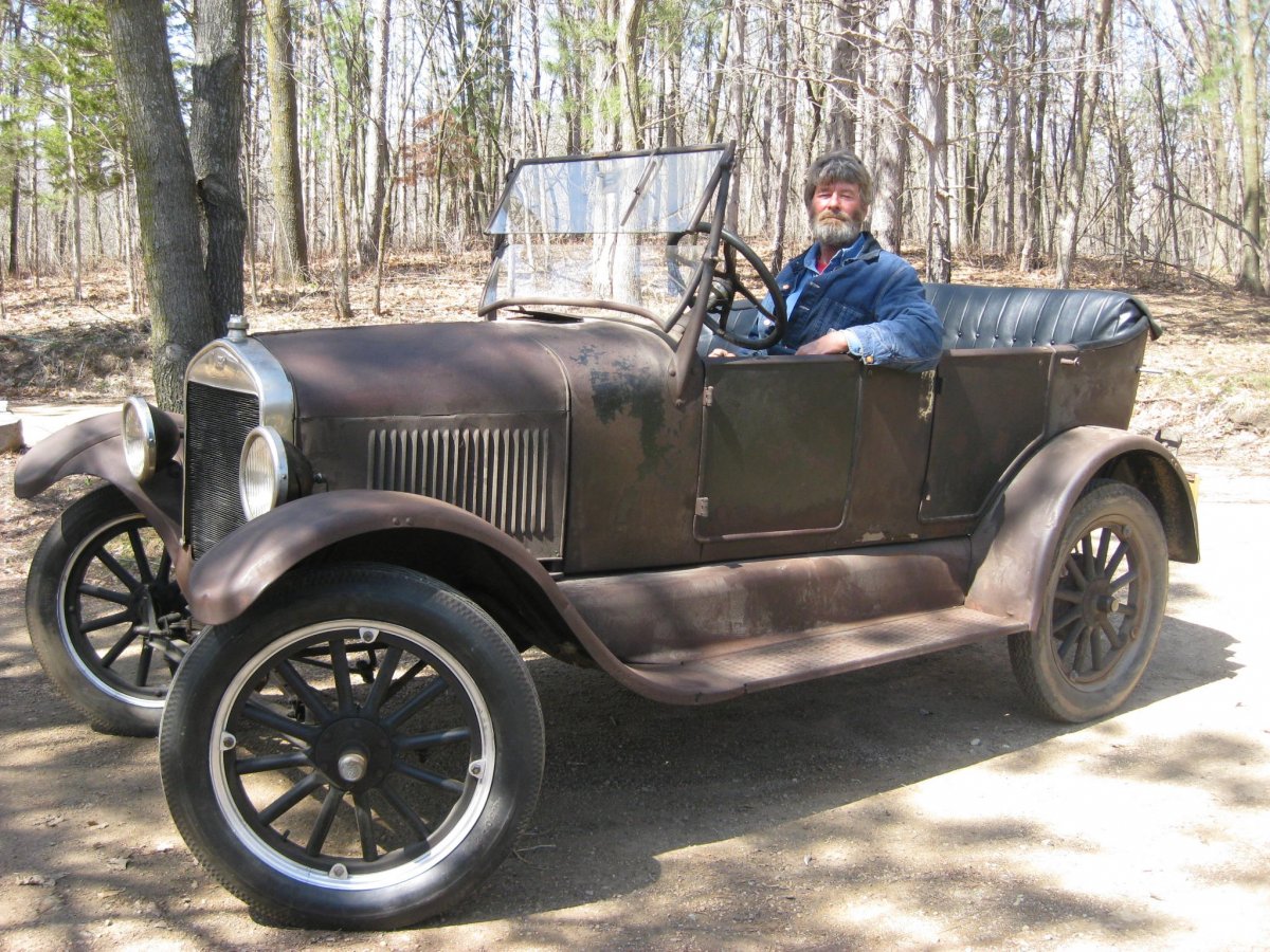

  3. Welcome FJant; I have kind of the same thing, 27 on stock A ch***is. If your looking for help mounting the Body my advice is to get the rear wheels centered on the rear wheelhouse of the Body and square on the frame front to back. You will need to make your own wood blocks and drill some new holes. I used all the stock mount holes in the Body not the Fame. Up front on the Firewall I modified the stock 26-27 Frame mounts with a little modification and a new bolt hole. Here is an old photo before I extended the running boards and splash aprons.

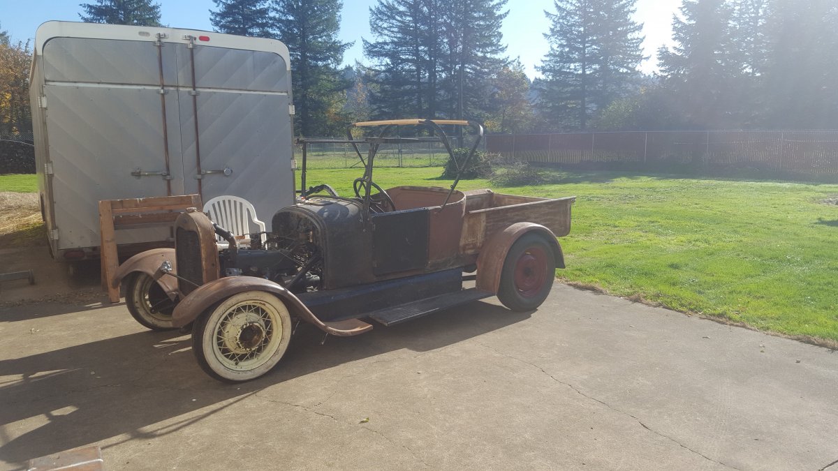

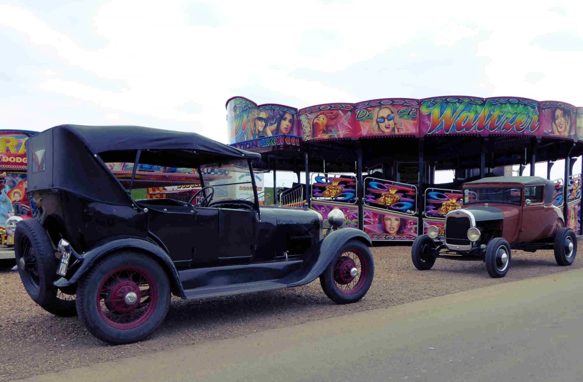

  20. Your Tourer looks in better condition than I started with so I'm sure it'll turn out fine.

    Very cool stance!
