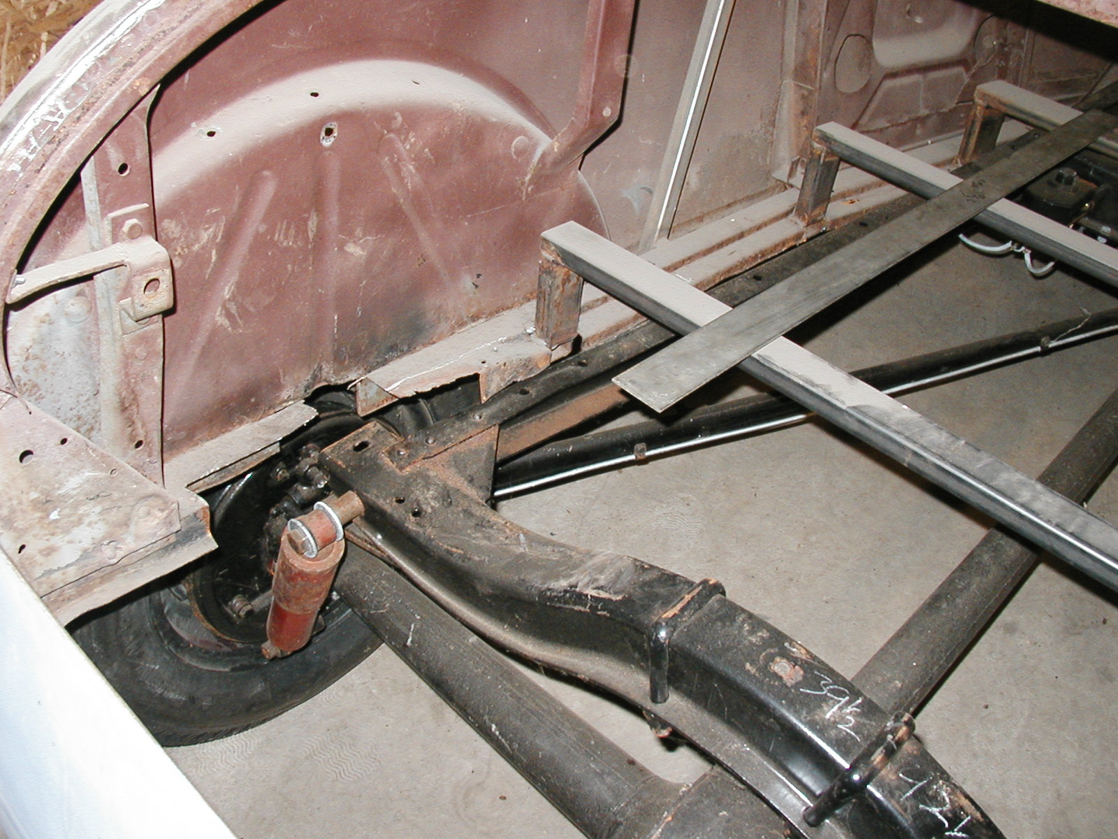

  2. The rear fixings through the subframe in the T body are quite close to the width of the A body. They're close enough that an M8 bolt will fit and that will align the axle in the rear wheel well. Once bolted down you can remove them and redrill for a 3/8". Or not.

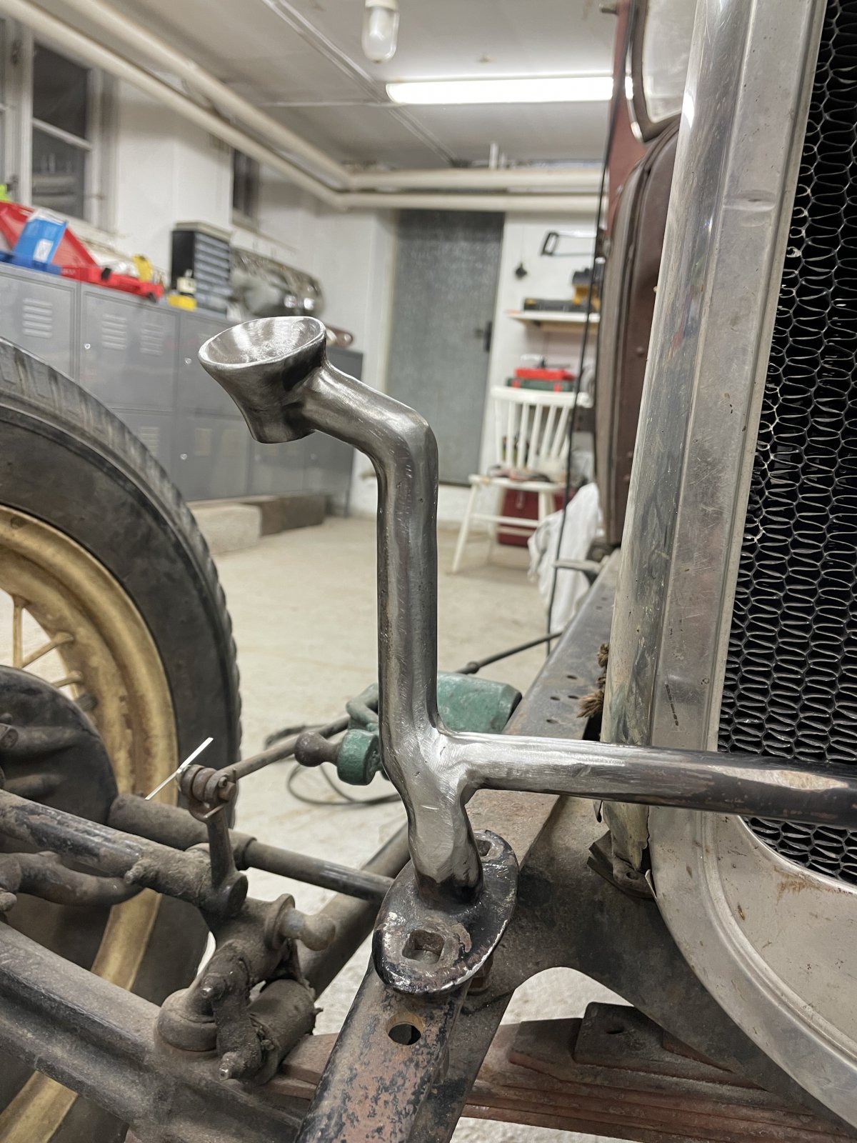

    Hi. Well I had a bit of a pause on the car. I have been rebuilding a vintage corpse of a caravan to a flower-shop for my wifes sidebuisness during spring and summer.

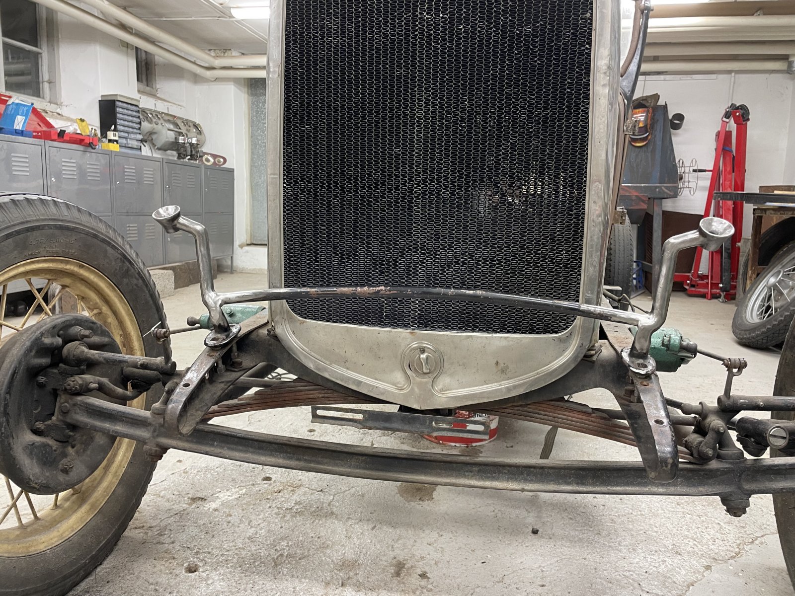

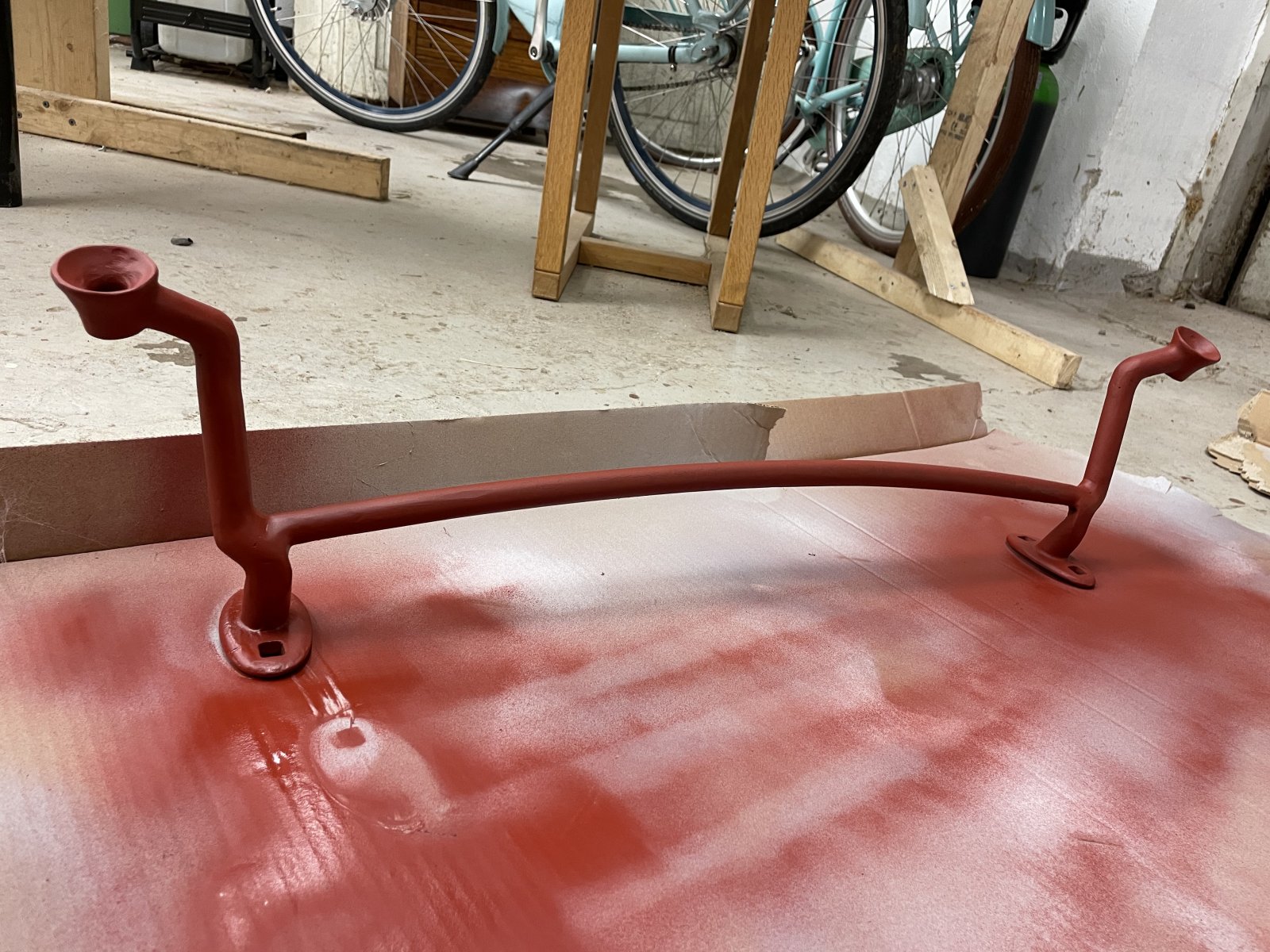

    I have been starting up i the garage with the Ford now again with some small things. Last night I spent grinding and finishing the headlight stand. I’m very happy how it turned out. Specially since the starting point was very crude. the car had a cut down bar when I got it, but just the frame mounts and the bar between. The rest was cut of. I used a steering rod and the headlight holders from an old plymouth 31 project. But it needed A LOT of work to fit the ford lights and look desent. My plan was to do something quick, functional but that could be crude and ugly. But it actually turned out quite nice.
  14. wheeltramp brian
    Joined: Jun 11, 2010
    Posts: 3,360
    wheeltramp brian
    Nice work on the bar
    Fjant likes this.

    I hope you are planning on running that Whippet looking grill !

    yes! I’m planing to ger the car running and to ger it licenced for the street first. After that I will start hot rodding it. And a big part of that is to use the Whippet grill. It have been rebuilt to fit a Ford flathead V8 somtime in the past so grille and engine will be swapped at the same time.

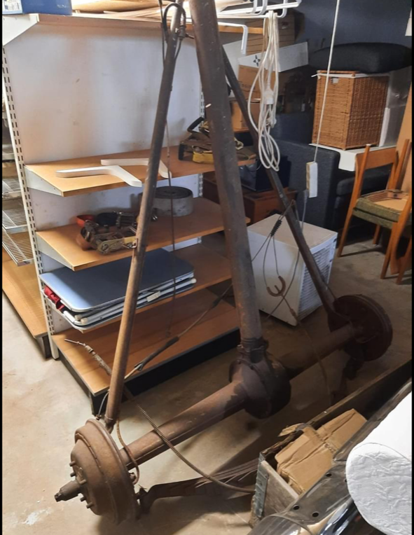

    I also bought a complete 1940 rear end. I did get a very good price on it and it was just a 30 min rid away. this will be a part of the future V8 conversion. 1.png 2.jpg 4.jpg 5.jpg 6.jpg 7.jpg 8.jpg

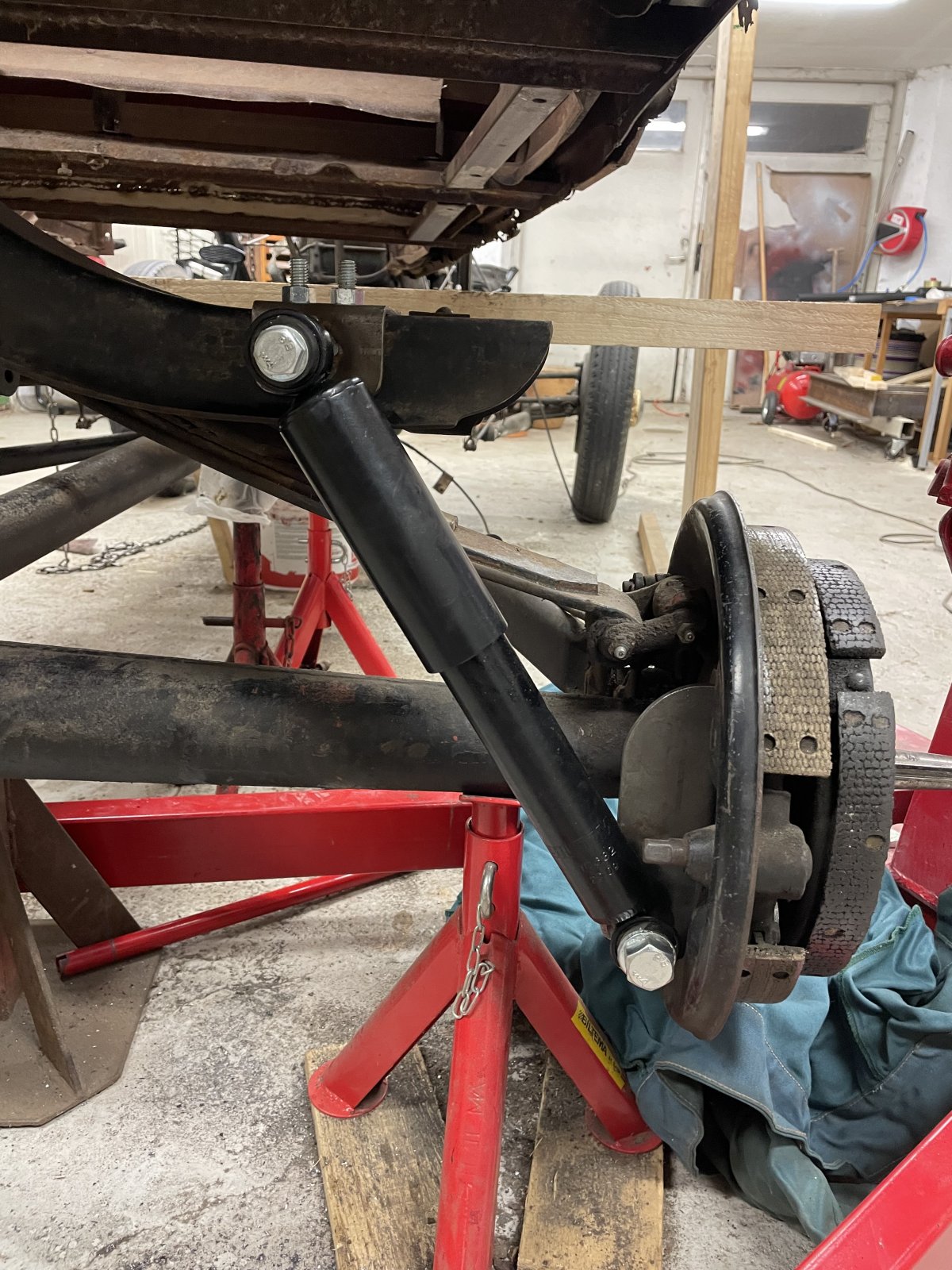

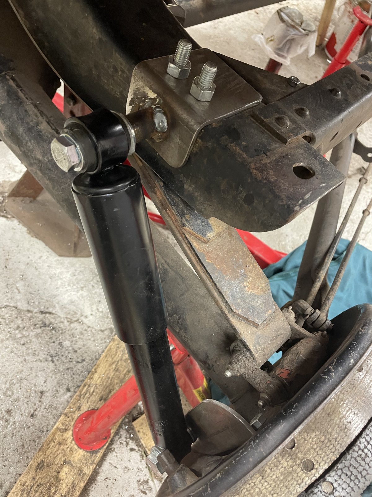

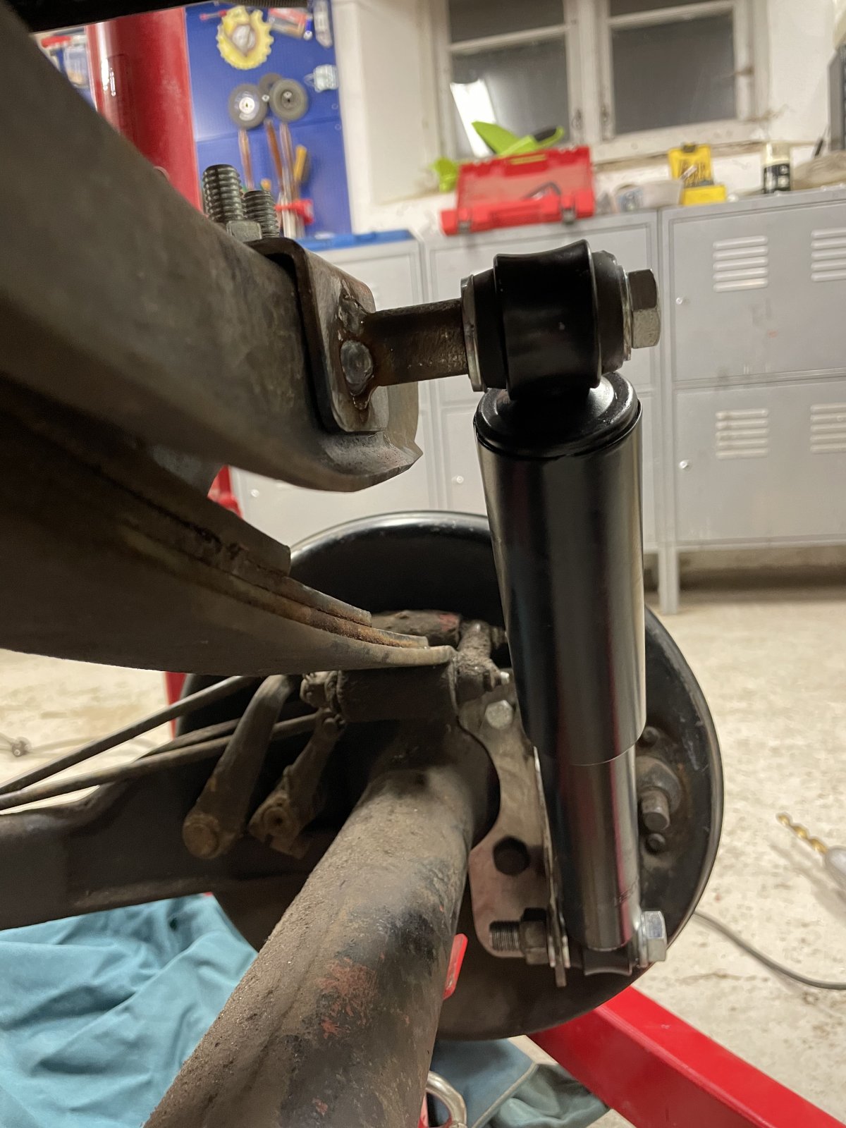

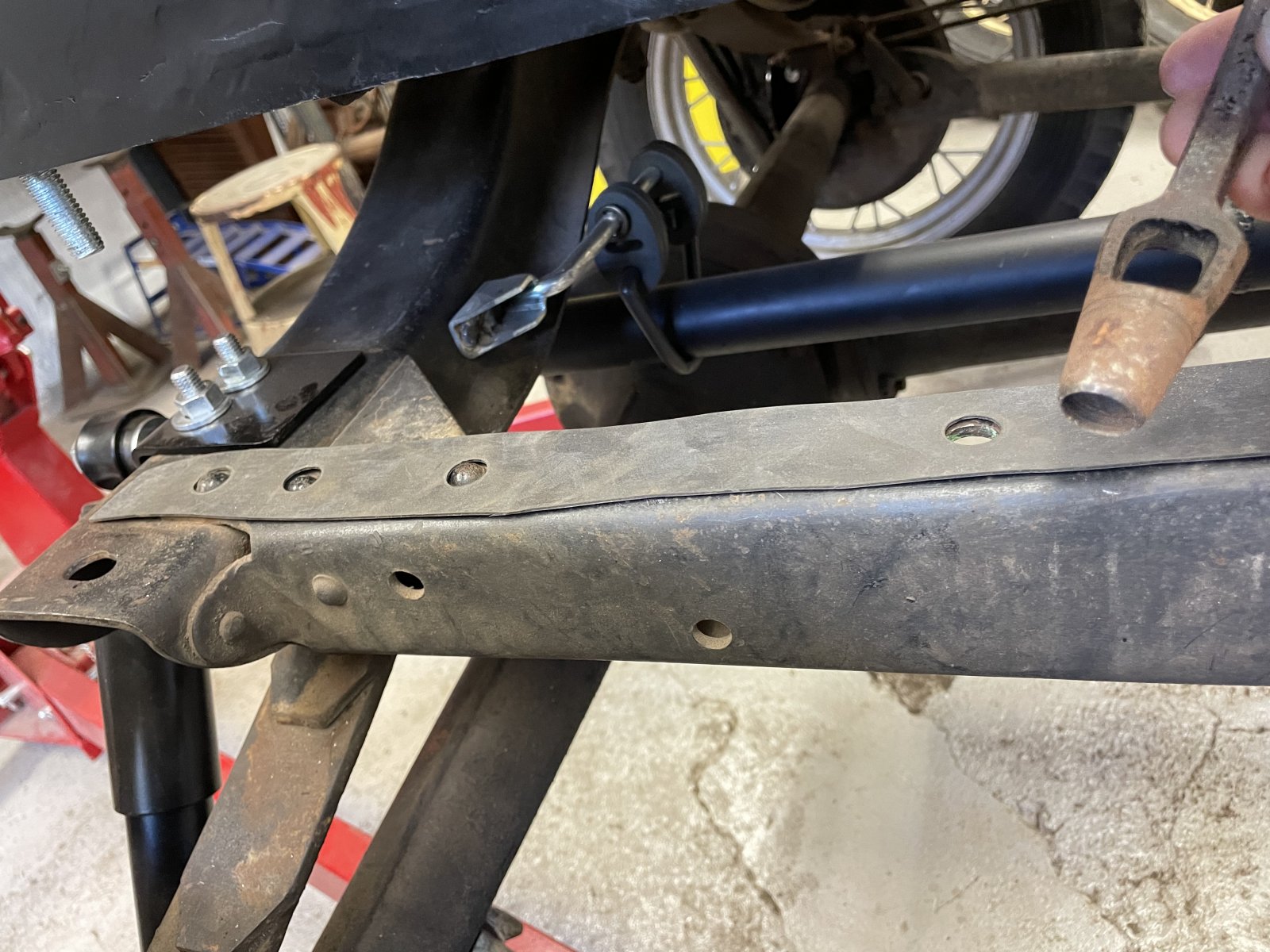

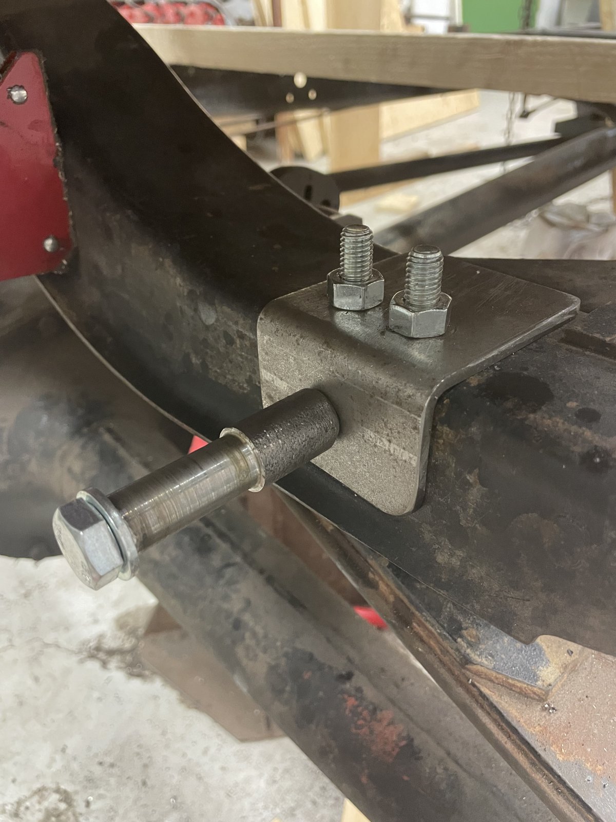

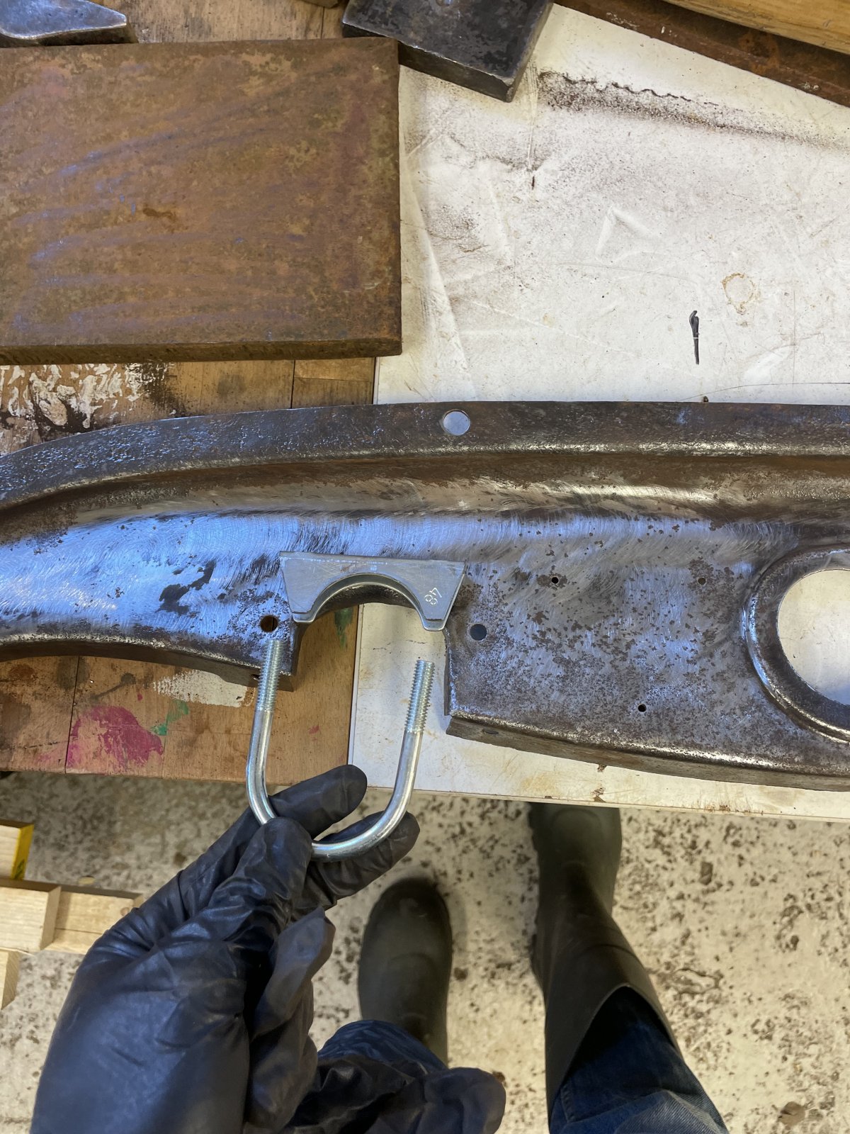

    Spent the evening completing the rear chock mount. Built of a pice of U- profile steel I had and bit of an old steering rod. A600CF14-AF04-4536-9D81-5A7DF8870B39.jpeg 804E31A9-C850-439B-95FC-150DF26C276D.jpeg 1C5EE72C-C9FB-4F1F-9107-40CEA59EFE59.jpeg 38A5BE4F-C6ED-4246-85C1-1BCFBA1BF749.jpeg 0E1EAF72-F3CE-4C9D-A7EE-C1B9F809C643.jpeg
  24. spanners
    Joined: Feb 24, 2009
    Posts: 2,197
    spanners
    Great work so far. That shock bolt will have a lot of stress on it. You may need a small gusset on top if you can fit one.
  25. I don't know Maybe dumb luck but about 20 years ago I drilled a hole in the face of my crossmember, stuck a bolt through with a spacer between it and the shock. Hasn't cracked out or broken off yet. Isn't even welded. I got the idea from another guy that did the same job long before me.

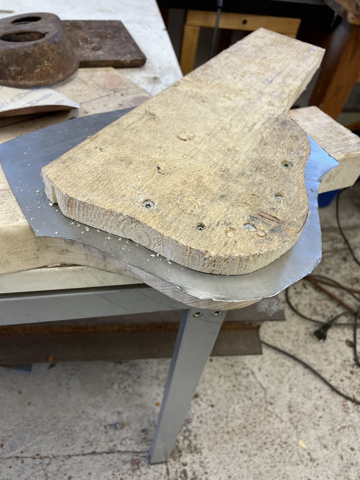

    I like your floor board mods - I may have to rethink mine now.

    yeah. I was thinking about doing that. Made a templet yesterday actually. I might do so.
    Okie Pete and j hansen like this.

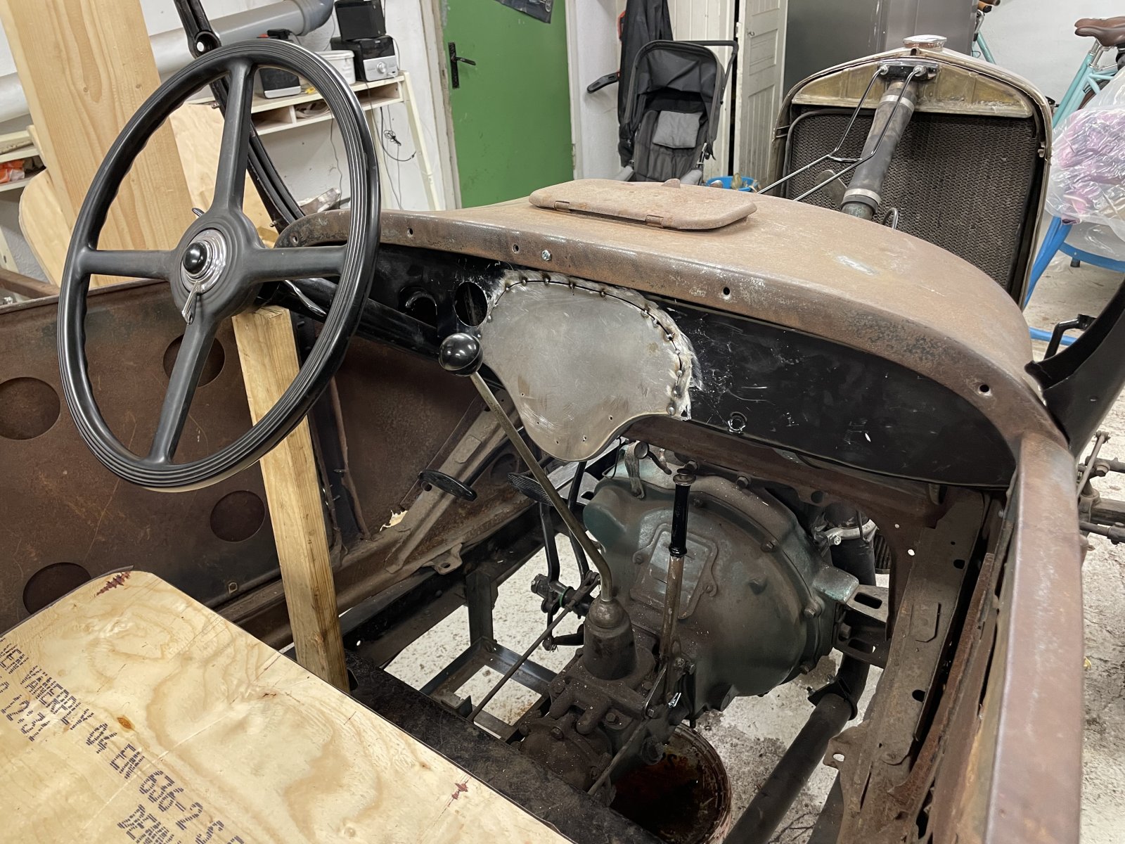

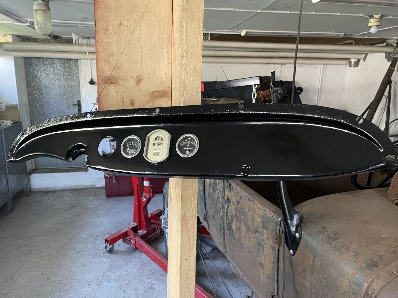

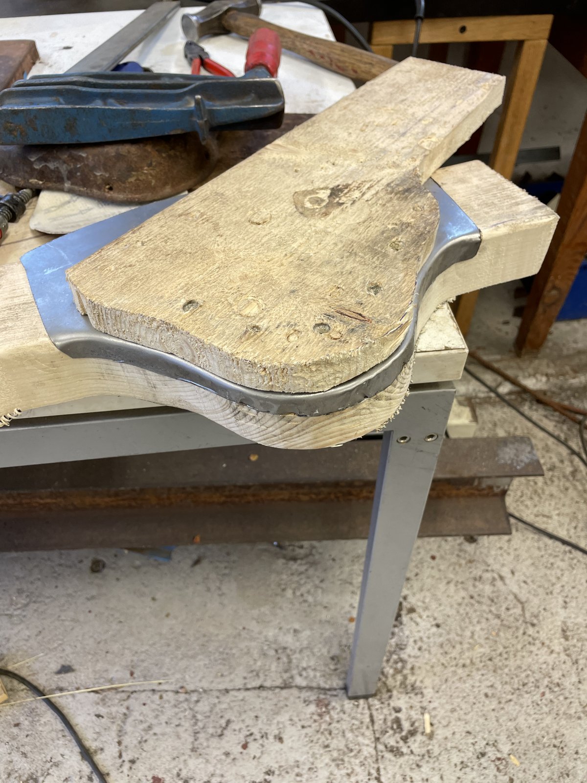

    Hello. I thought I would post some pictures of what I’ve done the last six month. Not a lot of progress but I have been working on and of for the most part. And even if it’s not musch to show for, I guess the post will serve as a diary for my self.
    Got a pice of a rubber matt from my father in msw that was left over from building a pond. Perfect to cut a strip and place between frame and body.

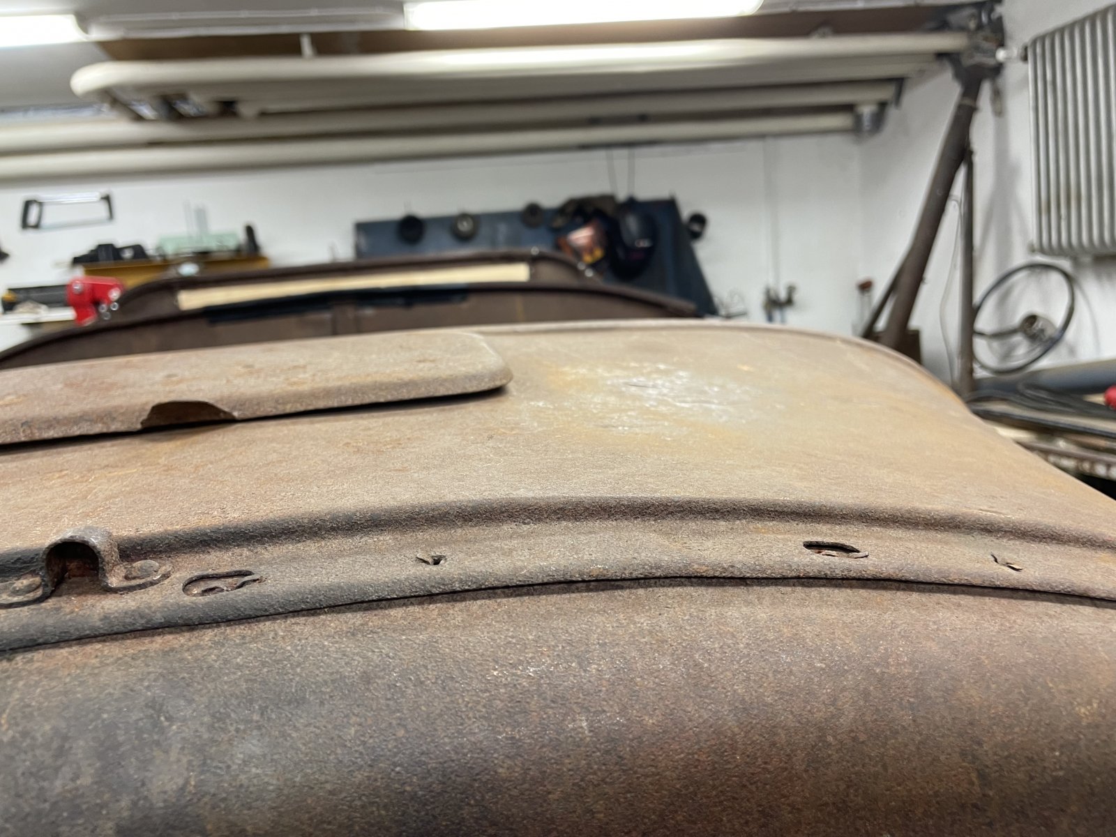

    On the cowl someone had (by the looks of it) smashed a hatchet a bunch of times. After looking on a lot of videos on sheet metal repair I got the guts to try it my self (no previus exerience at all on sheet metal repair or welding). With hammer, dolly and the Mig welder I manage to get the dents and holes to almost dissapere. Wich made me real proud.

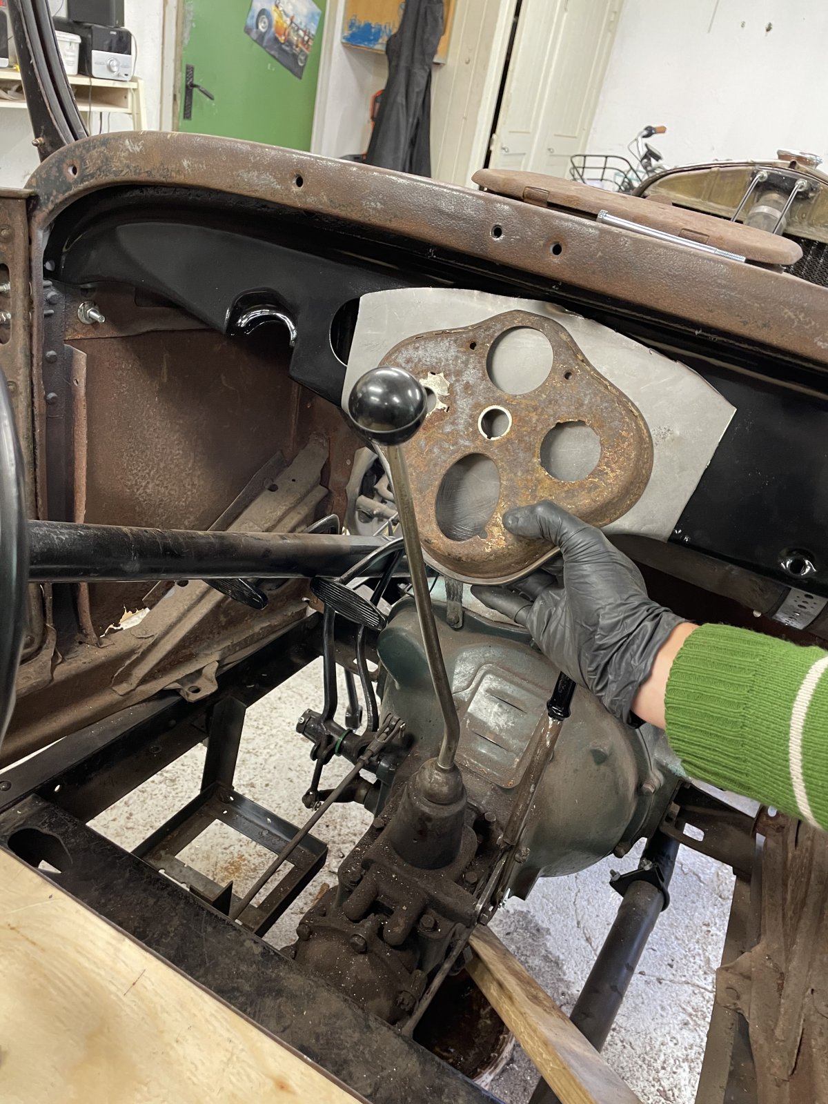

    The dash was in really bad shape. Had dents, rust and the edges had been reshaped with some heavy force and was bent and cracked. My first plan was to just drill some holes for my planed gauge panel, but it did not fit as planed. And with my exitement over the cowl repair I put a lot of time on the panel to make it nice.
    I had a little setback when I mounted the gas tank and realized there are almost no room between the dash and the tank. So the speedometer did not fit at all. (I also had to shorten the hand brake lever about 3 inches to clear the tank).
    So now when I got back on the car after the summer brake I started to reshape the dash to make a model A panel fit. I think I will work fine. And working sheet metal are great fun!
