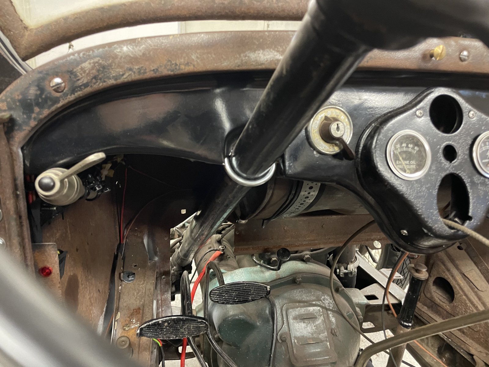

  2. I took the braces out each side on both my T’s and made a steel floor to go right across at about that angle. Bonus is you can use the A pedals unmodified.

    that sounds like a god idea. Well the pedals are adjusted and the floorboard done. But I will save the design idea for the future. I guess it gives a little bit more room for the foot.

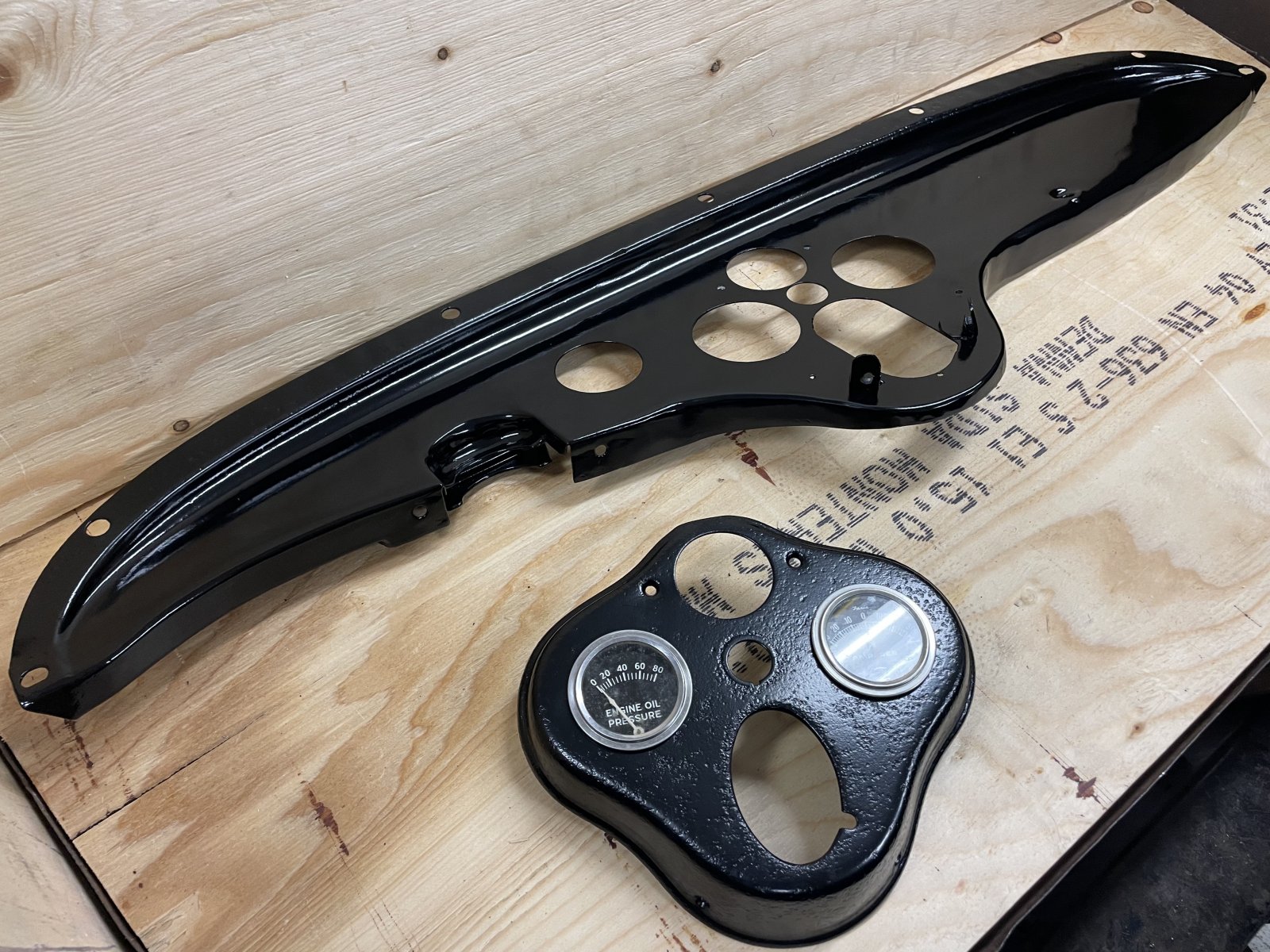

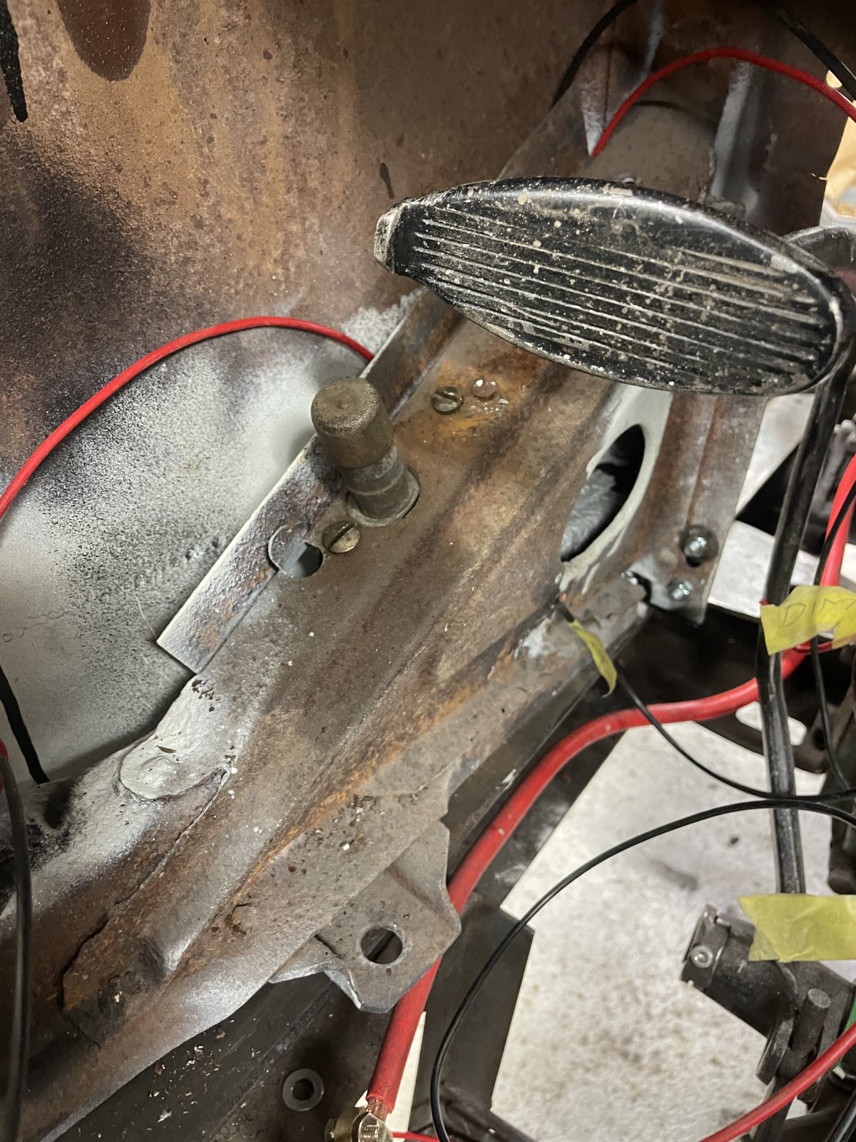

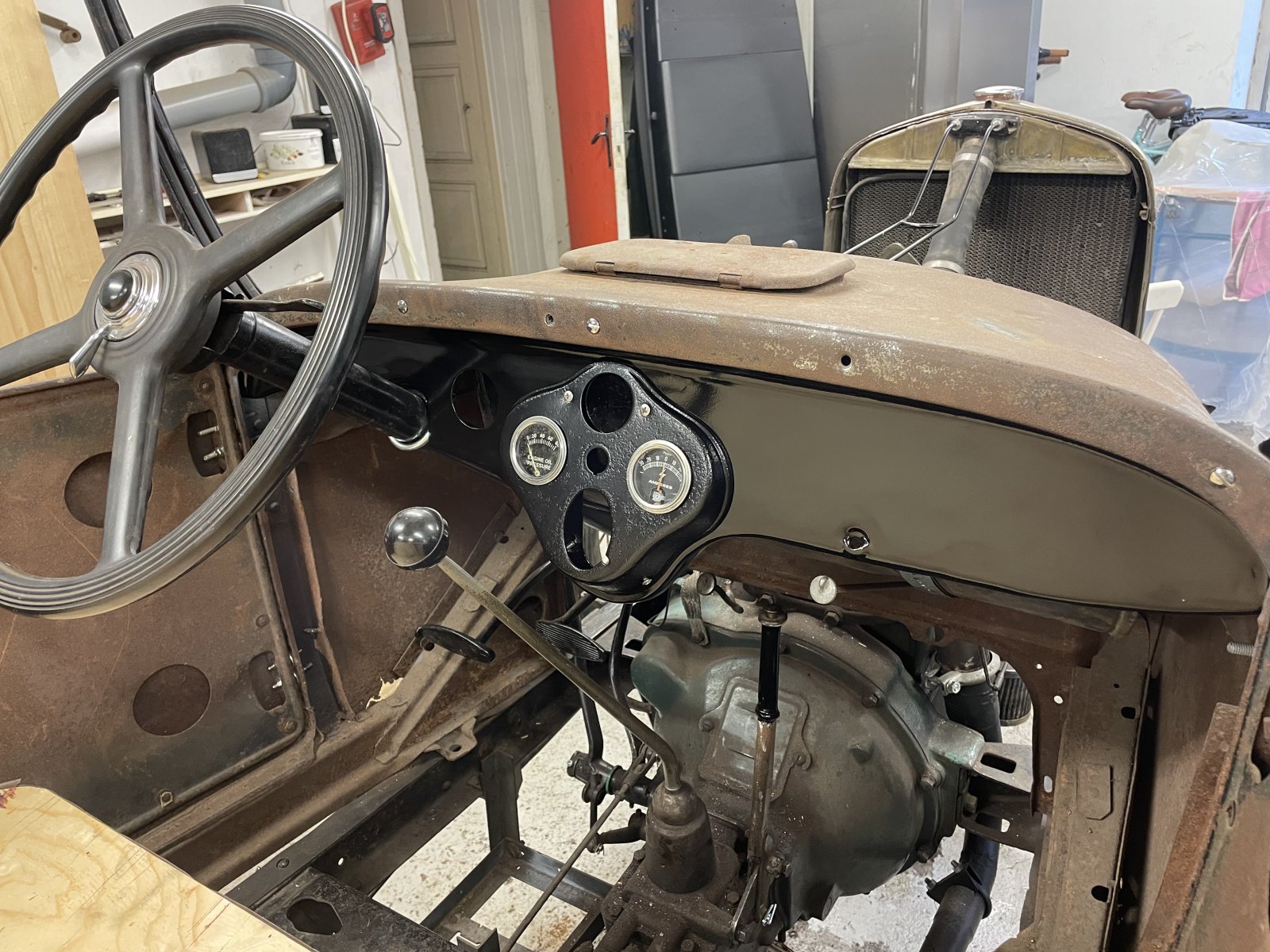

    So got the dash done and kind of mounted. The gaugepanel will be filled when I find a Speedometer. The gaugepanel was very rusty and heavely pitted. I just put it in acid bath and put some paint on. Might look for a better one in the future. 54522BAC-084C-4A0E-8758-645A9043639C.jpeg 7C7FF831-AAA2-4C18-8361-372C5C48A07F.jpeg

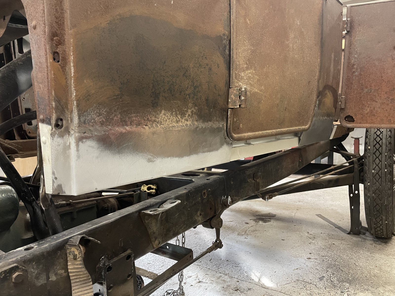

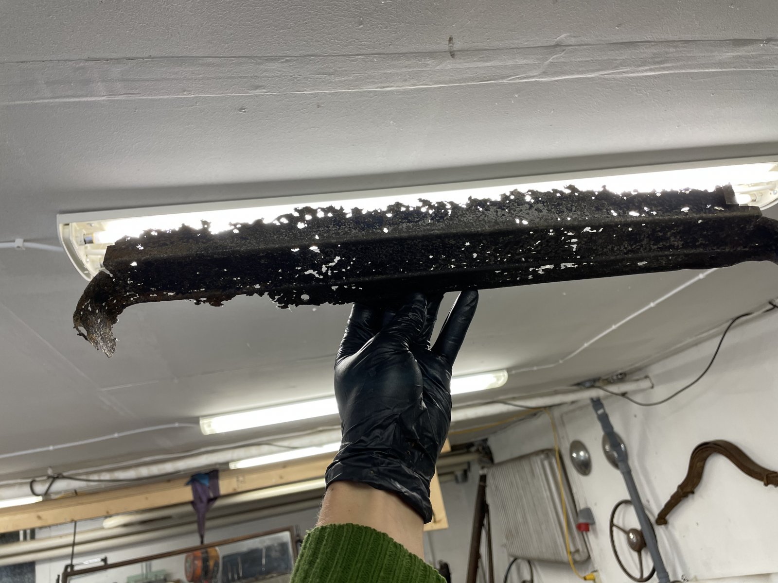

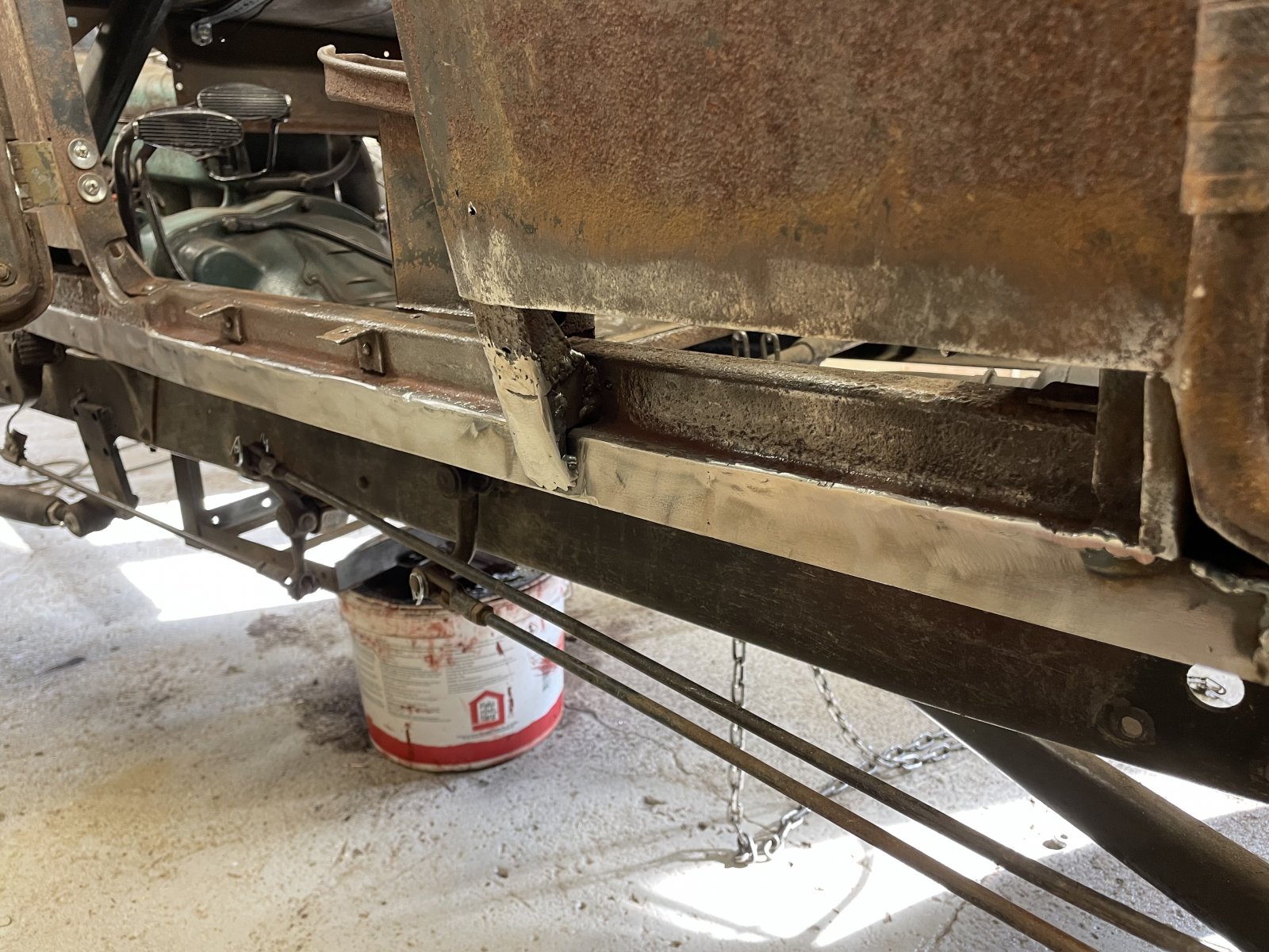

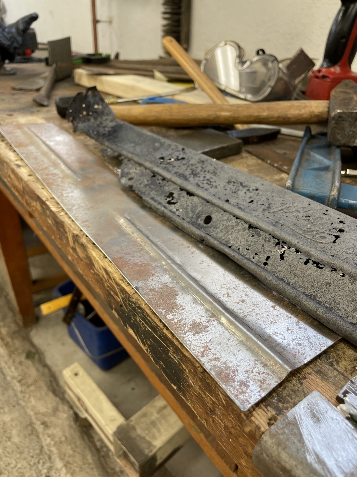

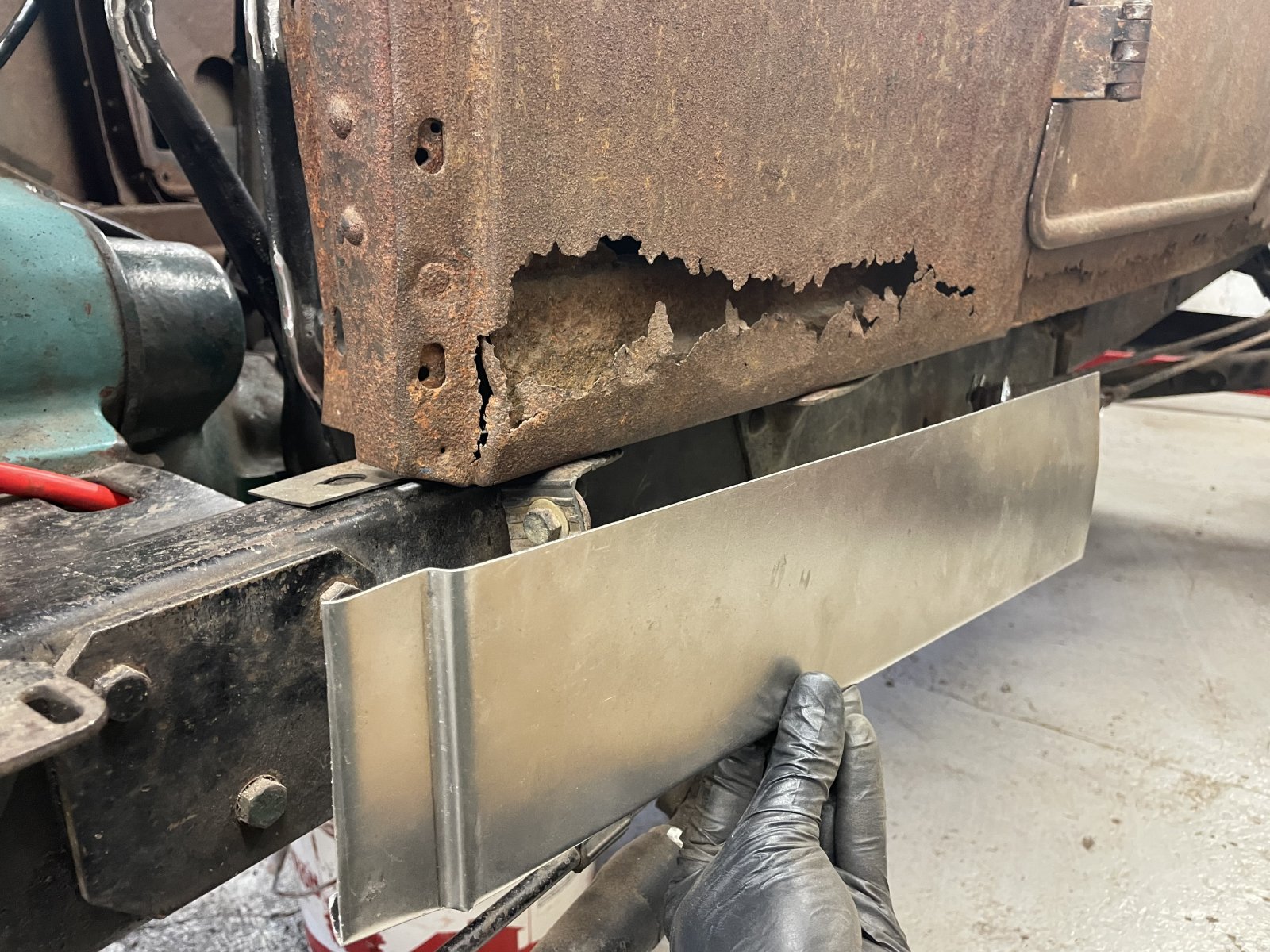

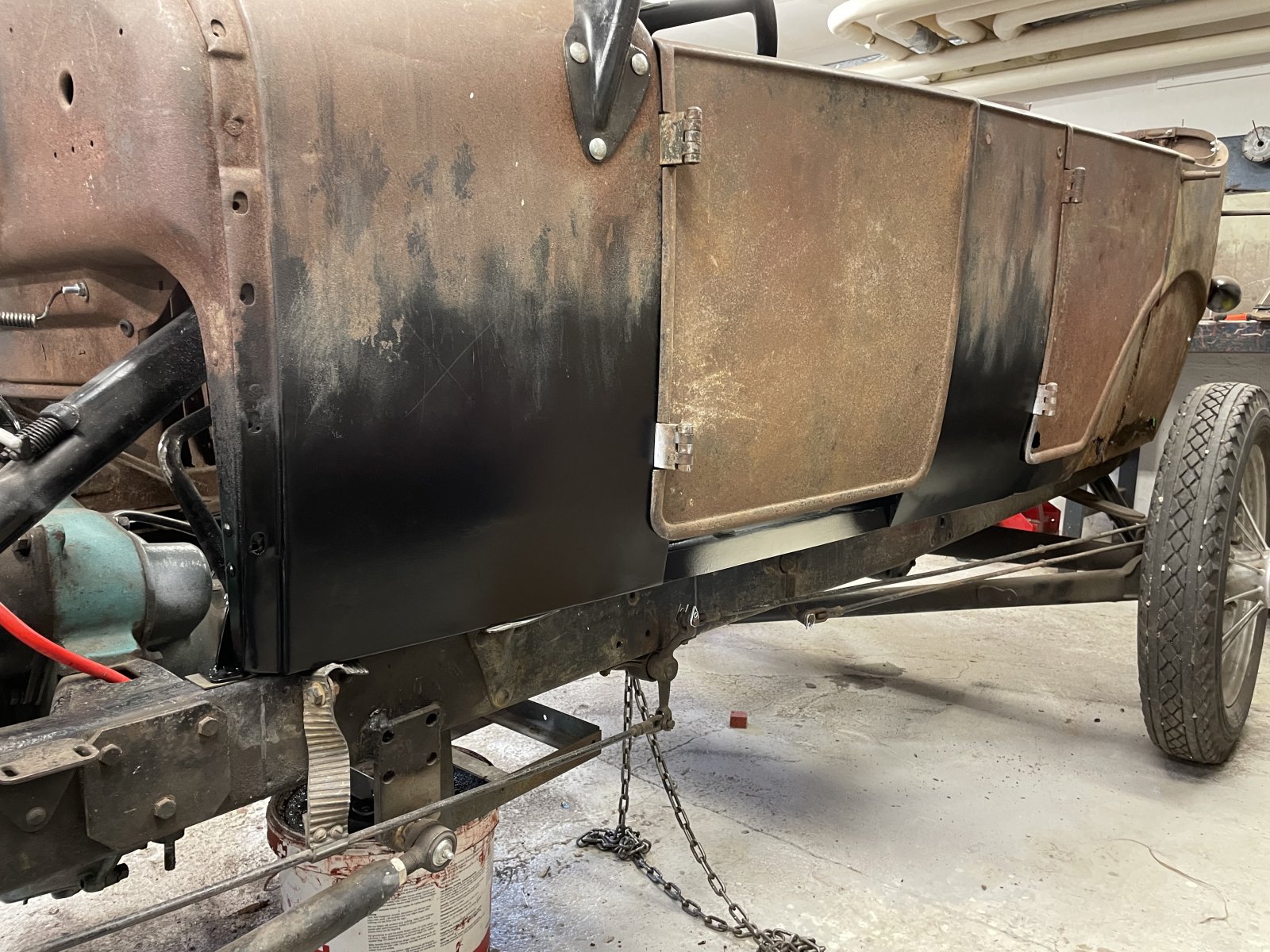

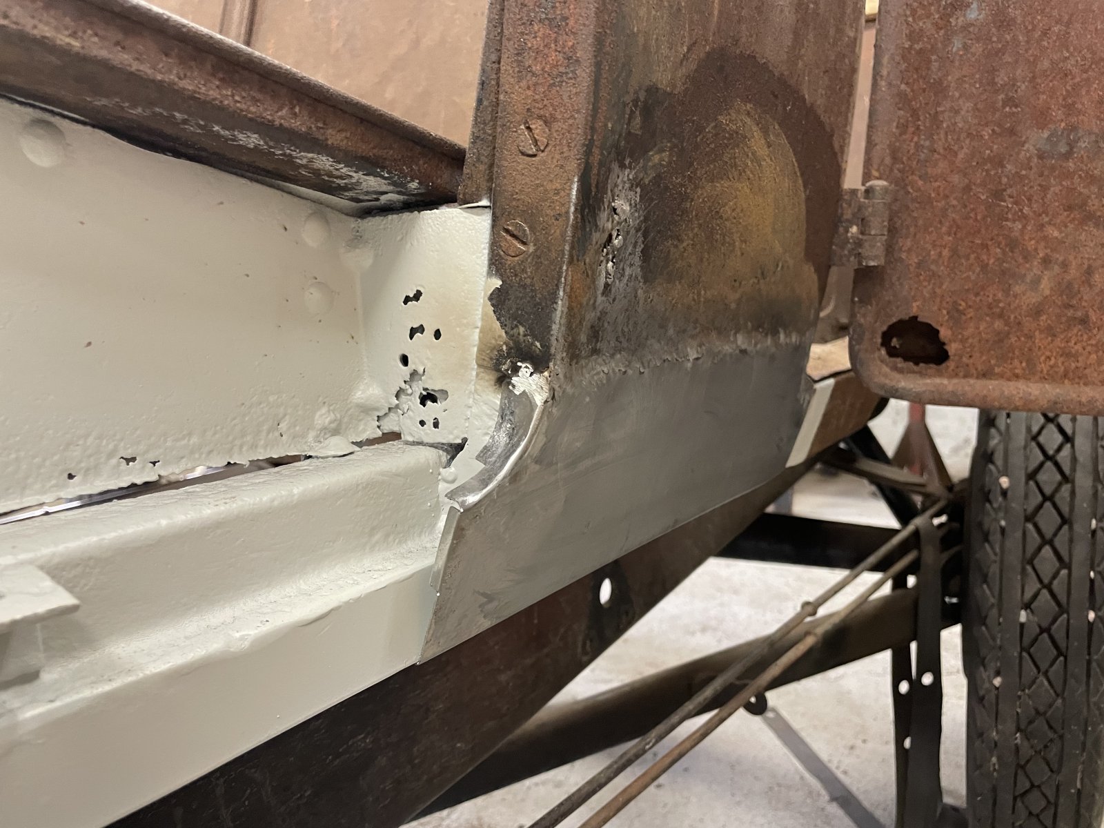

    Well, I have told my self not to do ”unnessesery”stuff on the car until I get it running. But when I lifted the body the other week to do front body mounts I kind of got an urge to do some body work. Since the lower panels are just bent and dont have any shape (that need an english wheel) I was able to do these patches with an hammer as only tool. For beeing my first body work ever I think i went pretty okej. Still need some finishing touches thu. I also replaced the bottom 1,5 inch of the subframe.
    I do need to make a new panel that sits at the door. Seen in the picture you can see that it will be hard to repair. 22A9144C-89F4-4093-9334-26DC8435A149.jpeg 4CEFFC30-4BEA-4071-929F-9A2B902DCA2B.jpeg 168EF5C3-04CE-4048-B995-D0DB2910A0A1.jpeg 3AEA9414-C729-43D6-B032-5B1F6BEA5699.jpeg 8C55C12B-7C37-4CAC-96F1-2F1395C2FEAA.jpeg C334138A-3702-49E4-8217-73E98A6FAD2C.jpeg

    nice work there bud.that panels a sieve if i ever saw one chris

    a couple of coats of high build primer and a sanding would have it looking like new.

    Yeah. Thats the plan. I will paint it att the bottom for now, and hope I can make it look as it is kind of the faded original colour.

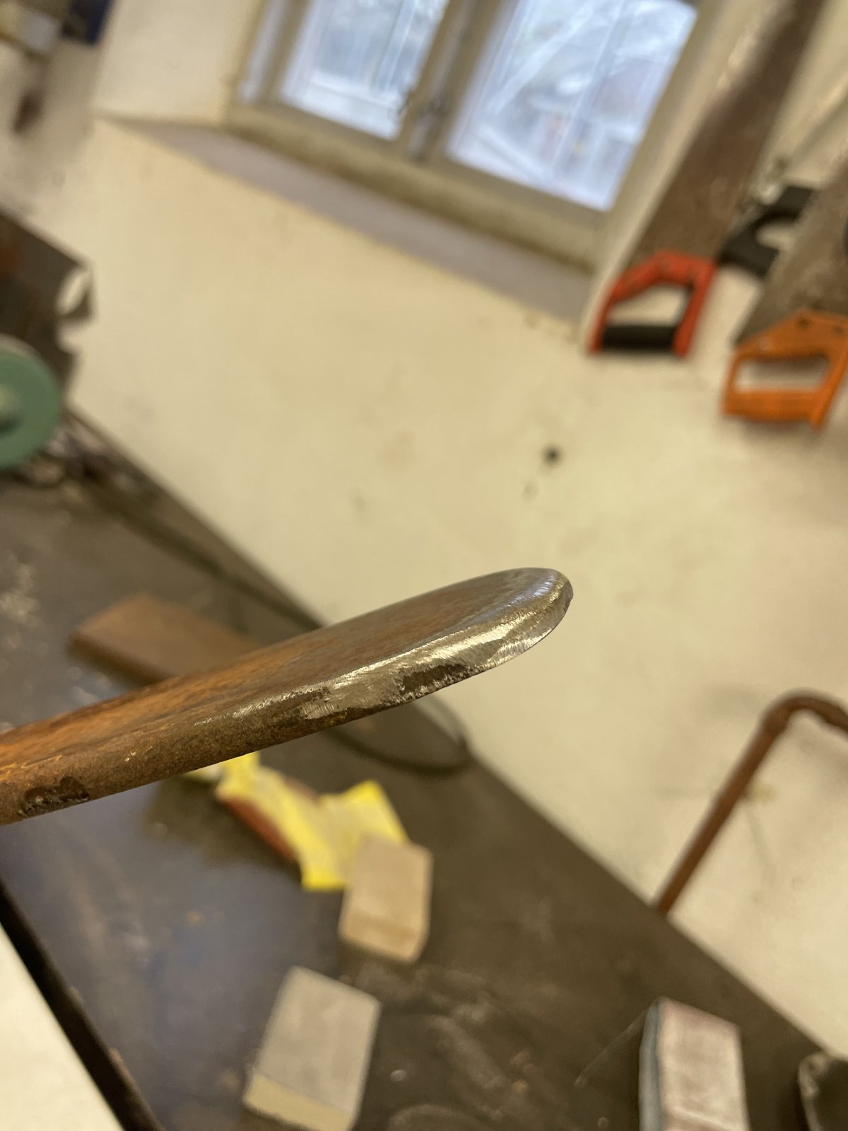

    Spent a little time trying to do beads without a beadroller. Hard to make it really good. But I think I’m on to something. 980D7E59-EBD6-4EDF-AD9E-E8D0C049F121.jpeg

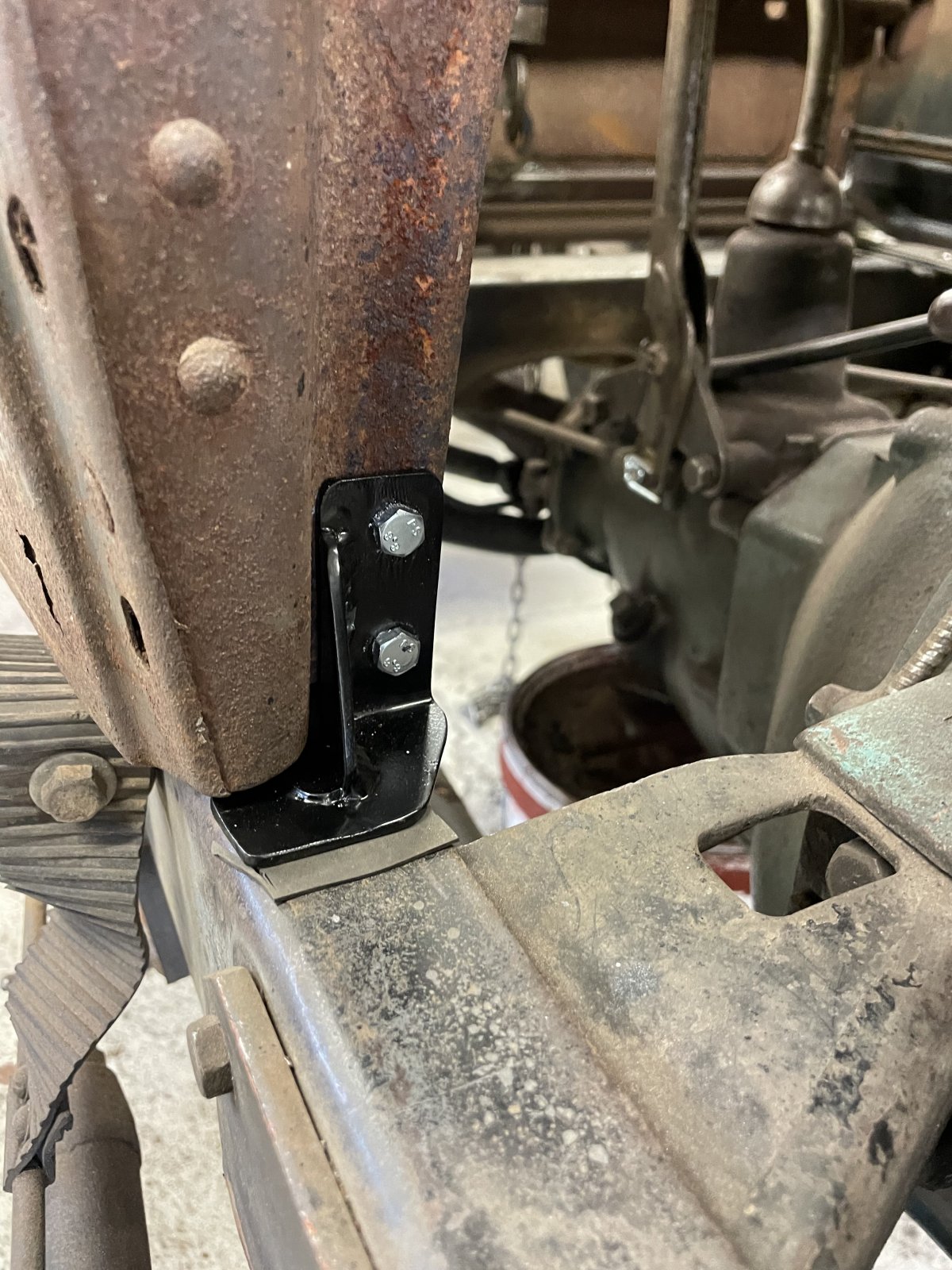

    Put some rattle can paint on the repair and mounted with the front body mounts I made looks better than before i any way. 842BD318-F935-4419-BF6D-315EB2E9C25B.jpeg 74C9FEF7-23B9-4640-9775-B2073A222A4D.jpeg 9509469A-563D-4DFA-AFD4-B8A733A55F6F.jpeg

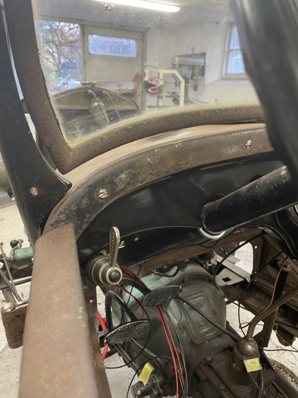

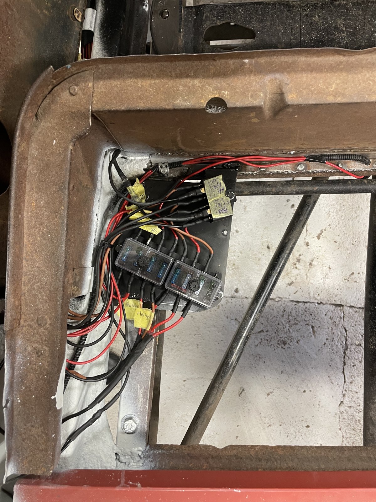

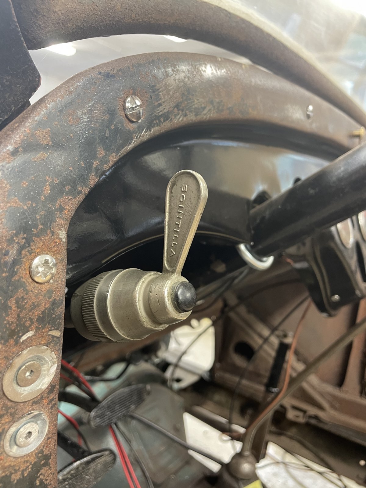

    9E34D614-55D4-453B-B0F0-38E6430CA0D4.jpeg 0F5F878B-BFBF-40EE-8640-CD7297DF9C3D.jpeg 536DB684-F066-431D-92A1-9C062D851630.jpeg 4C3216D3-B482-4663-9A5D-4877E0EF287A.jpeg So I started doing some eletrical wiering. Not my strong side att all. I really have to work hard to understand it. But I do think it’s kind of fun anyhow.
    I have just taken apart and renovated this old power switch. I think it looks really good. Earlier today I installed A headlight switch in the floor. I belive it comes from my old -32 plymouth.
    Allso, I found i that the pad that puches the stoplight switch was so worn that the botton has gone straight thru it.

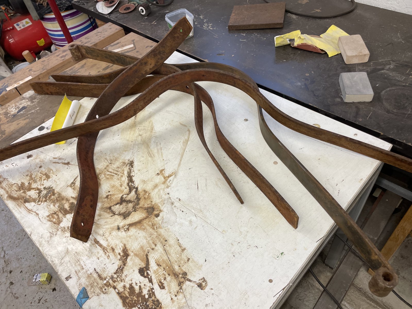

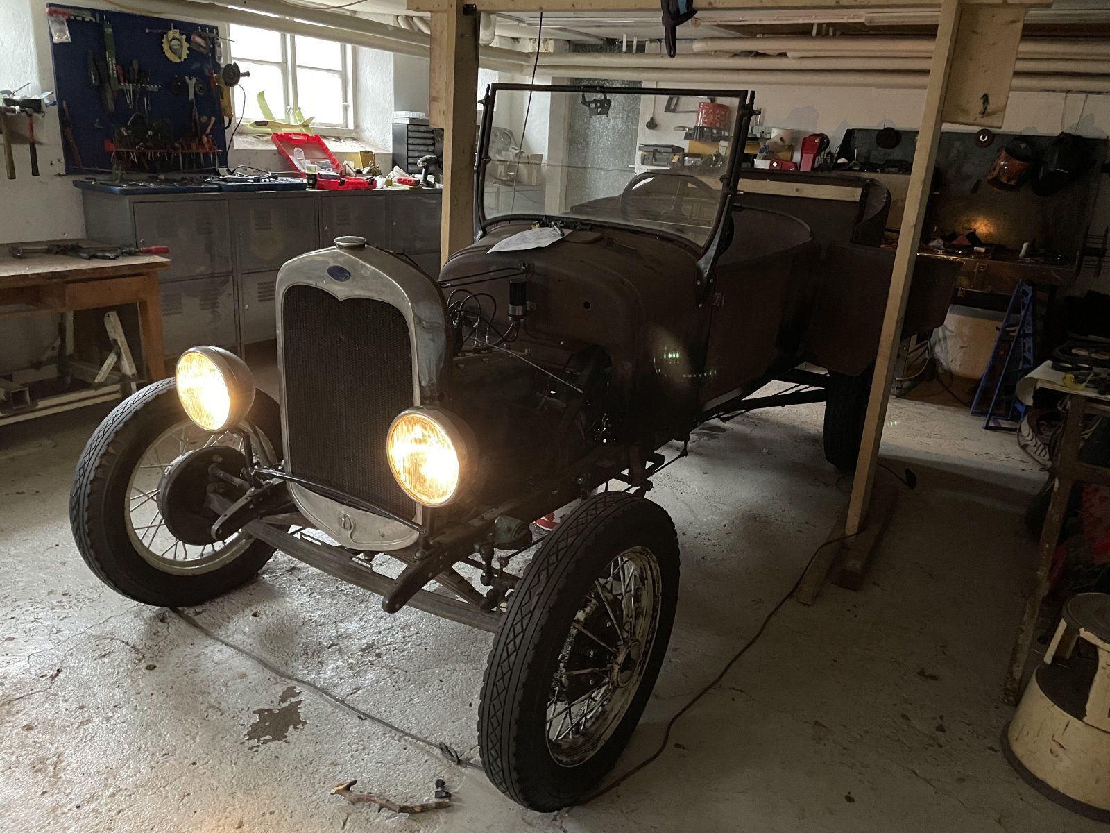

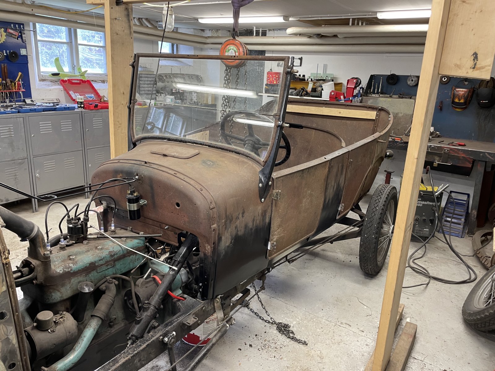

    5DE8A256-92F4-4F52-A907-2232EEC36844.jpeg 6A5833C5-AC0D-4142-A36E-F75464E4C708.jpeg D819E896-E9B2-4361-9BED-D1F51FF2EF0E.jpeg 376C8C39-257B-4F84-AD24-6BED7DDB771B.jpeg F4F31AC4-C439-4A4C-A734-4FD8E9F9E0F8.jpeg 5003F498-011F-42D7-A326-8718614C0307.jpeg 5F658519-9CCE-4DCA-B768-B517E0324308.jpeg 1AA3C809-F009-421F-9285-0B43144F9C06.jpeg 3BD921AB-1059-4969-B576-80F7C0FBA91A.jpeg After many hours fiddeling and researching auto elecricity I finaly got most of it done and working. I have some more to do around the engine and generator (i’m looking for an generator to hook up to my 12 v system).

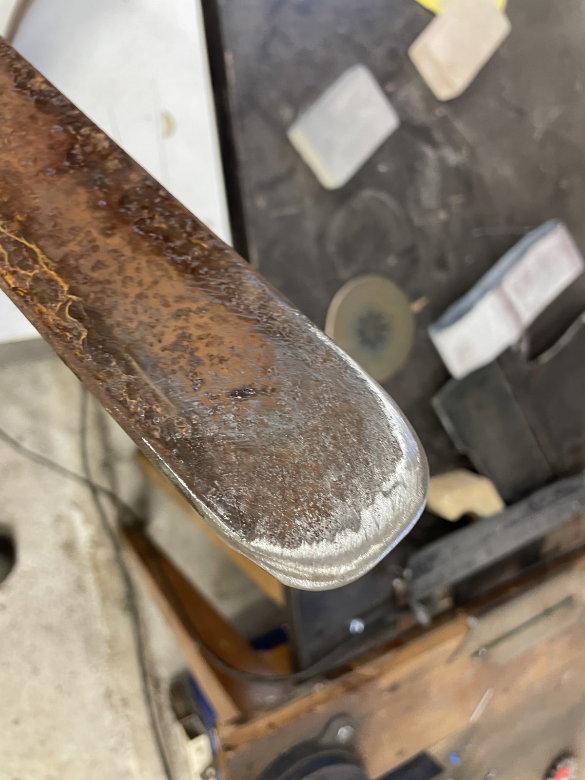

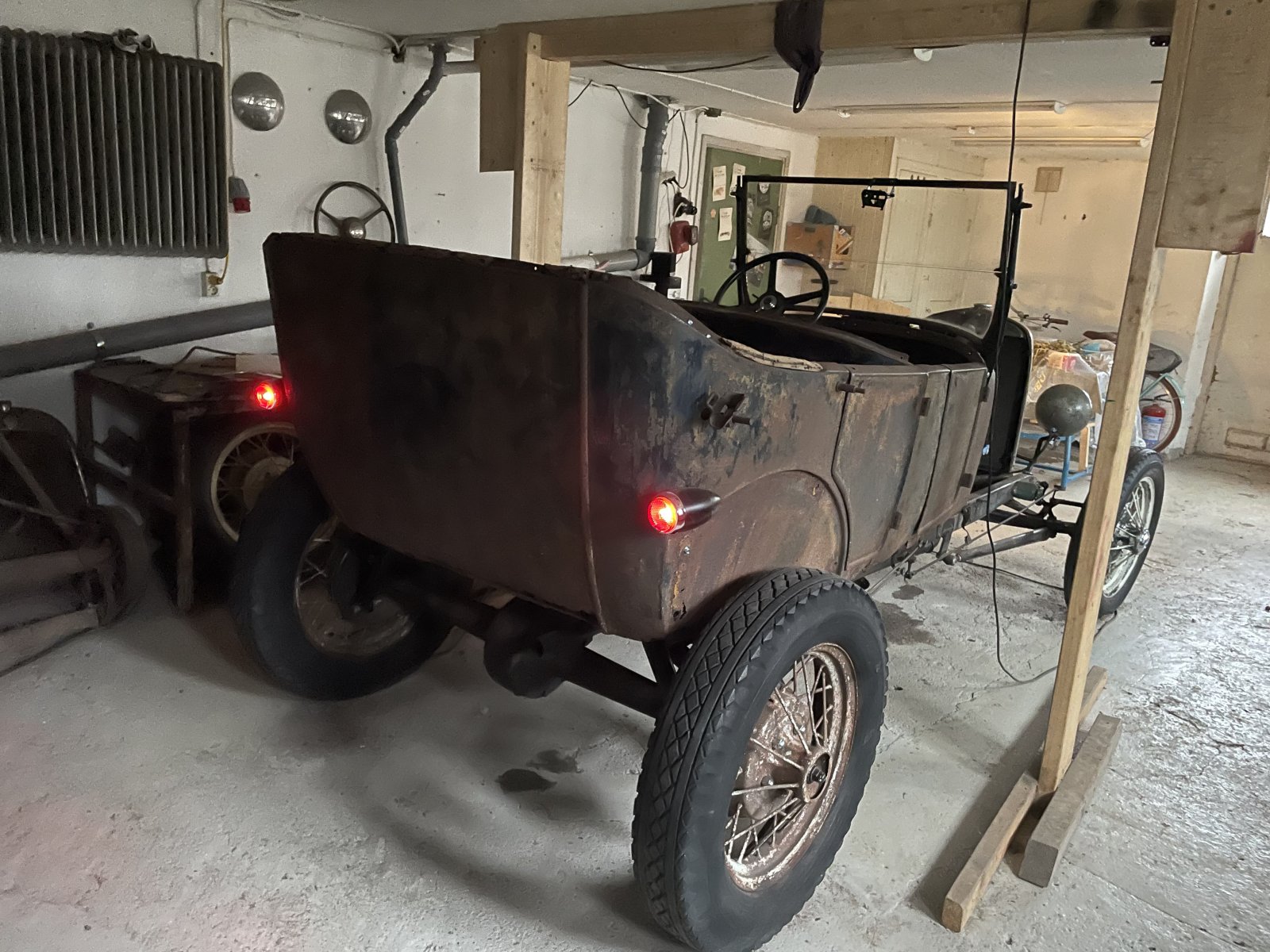

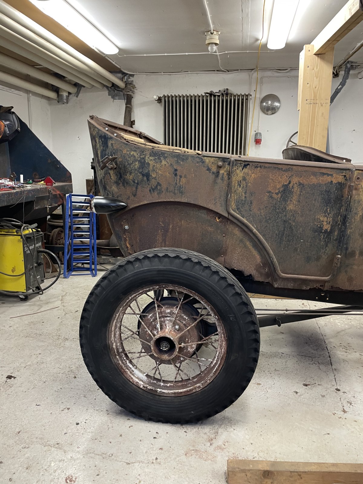

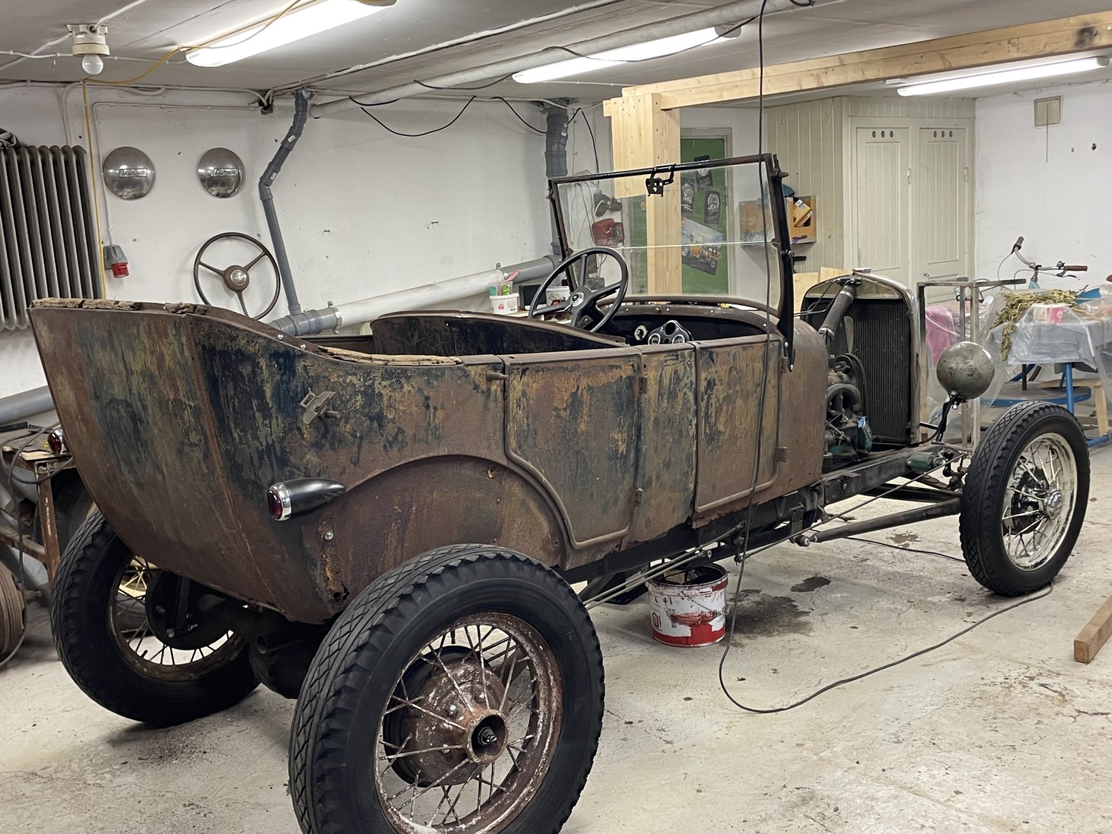

    I also got some new wheels, big and little. These have much better tires and I could sell my old for the same I bought this set for, wish of course always is nice. But the big tires really made the rear look high. So I have started to found and grind of the edges of my model-T spring so I can mount it and get it some what lower.

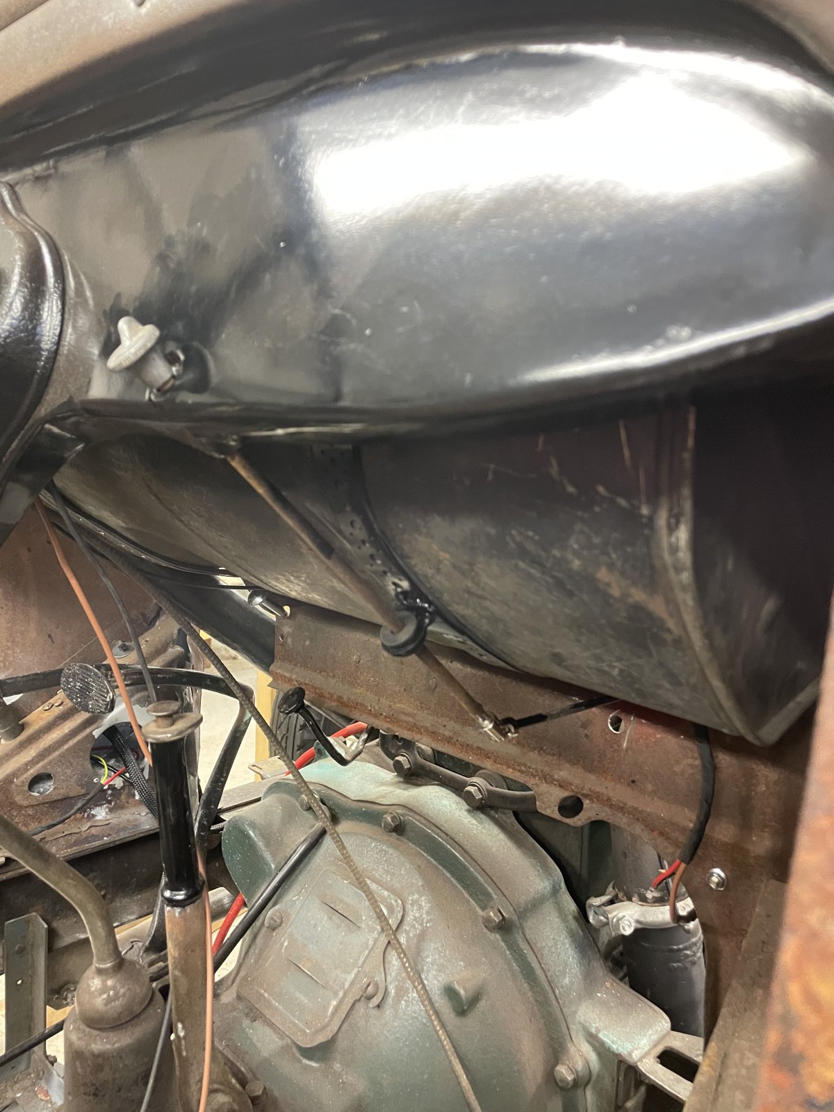

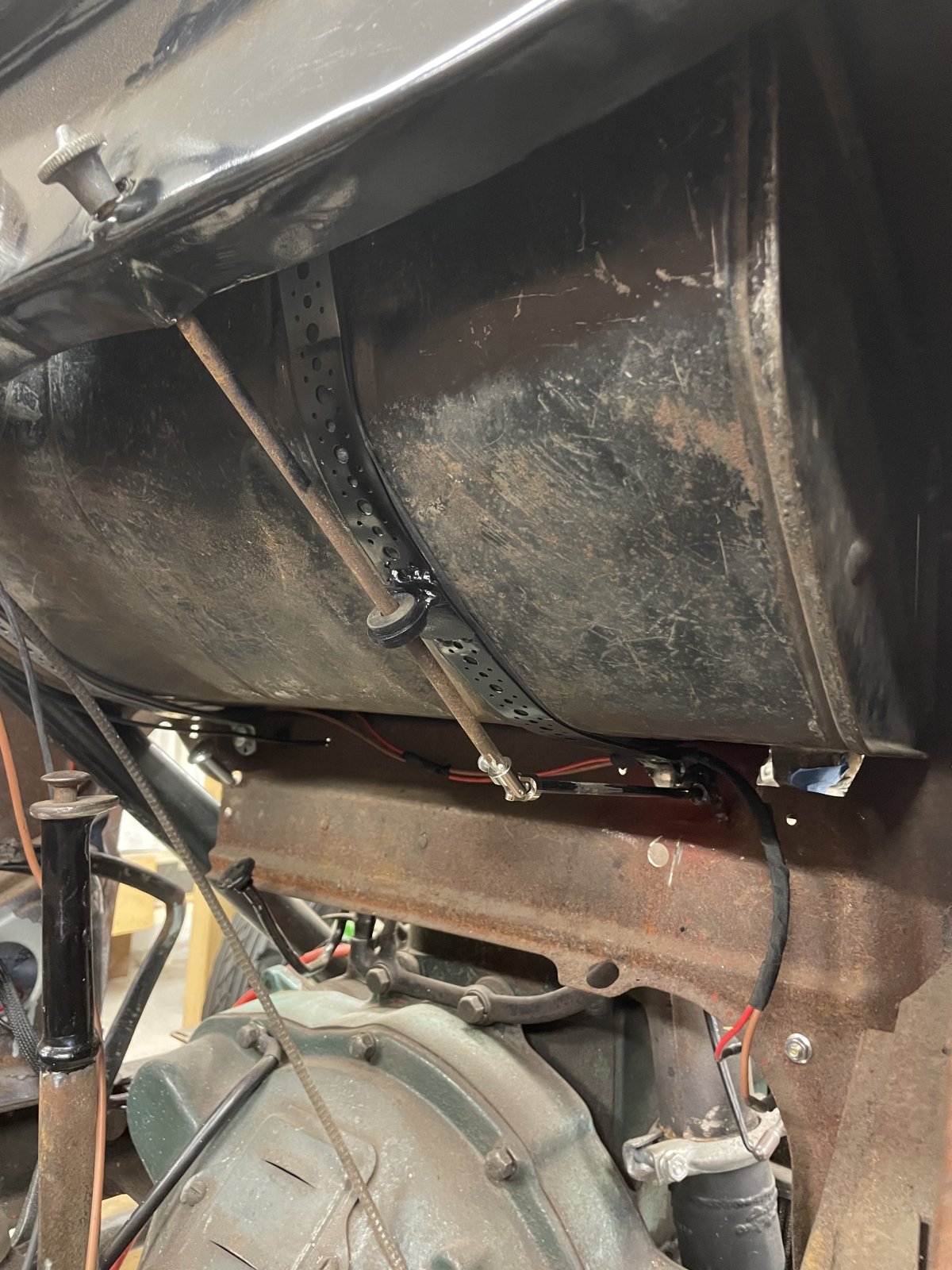

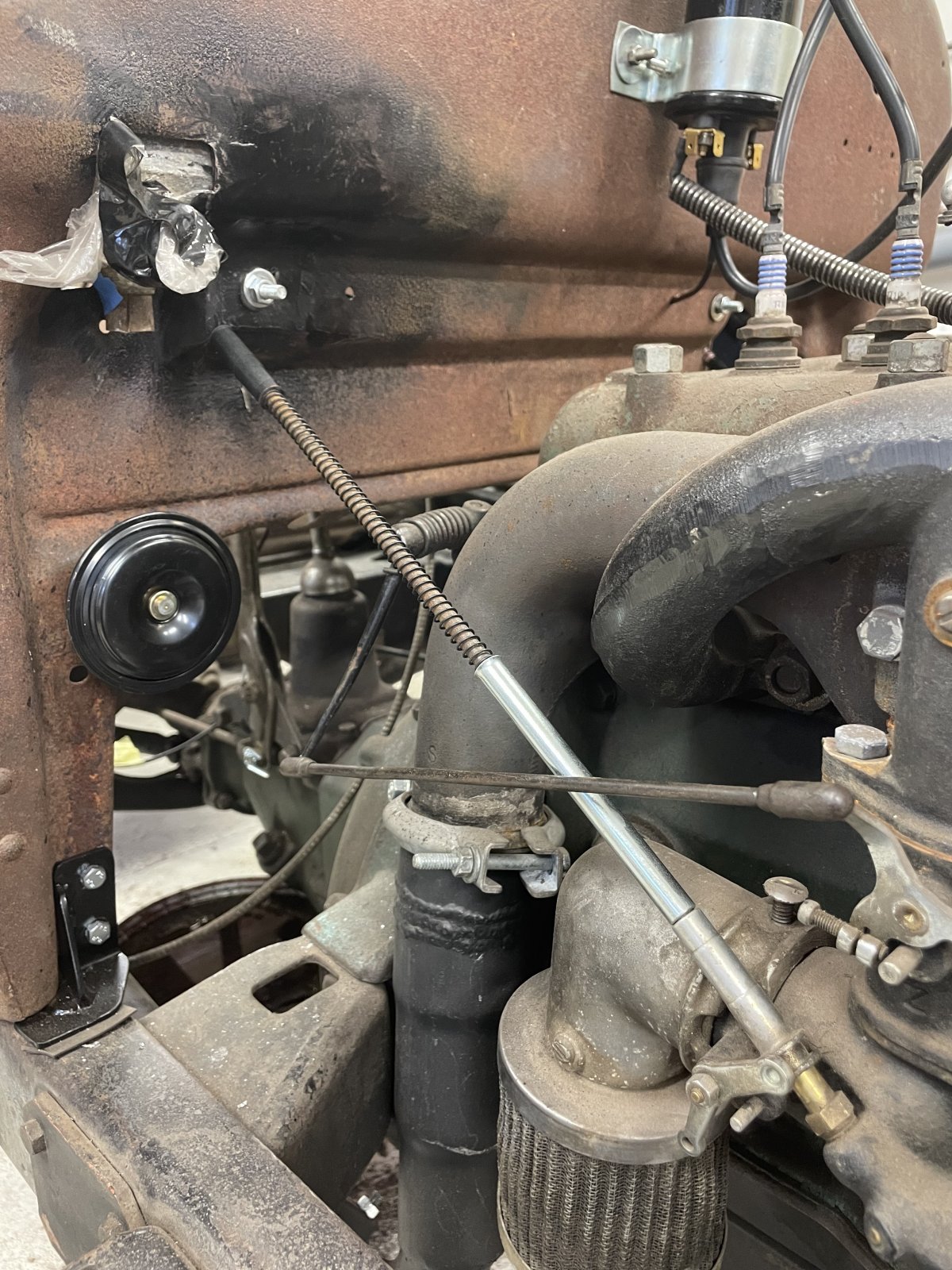

    06346A10-B2E1-431A-9DCD-851CDCC47CF1.jpeg 9B77F97F-4F0D-4AC8-A530-985673AF0202.jpeg 61B0F9C4-3832-4C84-BD3B-80CCDC03F59A.jpeg The choke rod was heavealy interfeared by the T-gastank so I came up with this solution. Still needs just a little fine tuning. But seams to work fine!
