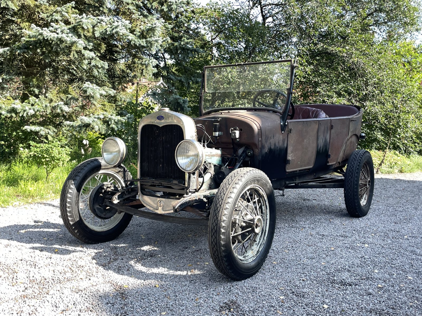

  25. Fjant
    Joined: Mar 17, 2011
    Posts: 220
    Fjant
    from Sweden
    Hi!
    The have not been any big progress on the car this winter. A lot of other stuff that had to be done, less energy than usual and a hard case of phneumonia. but I have done the wiering done. I had to redo some stuff that did not work with the old parts. Still hav not succed in getting all the gauges to work but thats secondary. Got most of the interiot done and have sorted the fuel leaks (renovated the carburator and mounted a fuel preasure regulator).
    Got the car out running two times now. Most of it works as it should. But it seems like fumes from is leaking in to the cooling water. So I have to renovera the top and get it shaved (or get another one that is staight). Hoping to get that done next week.
