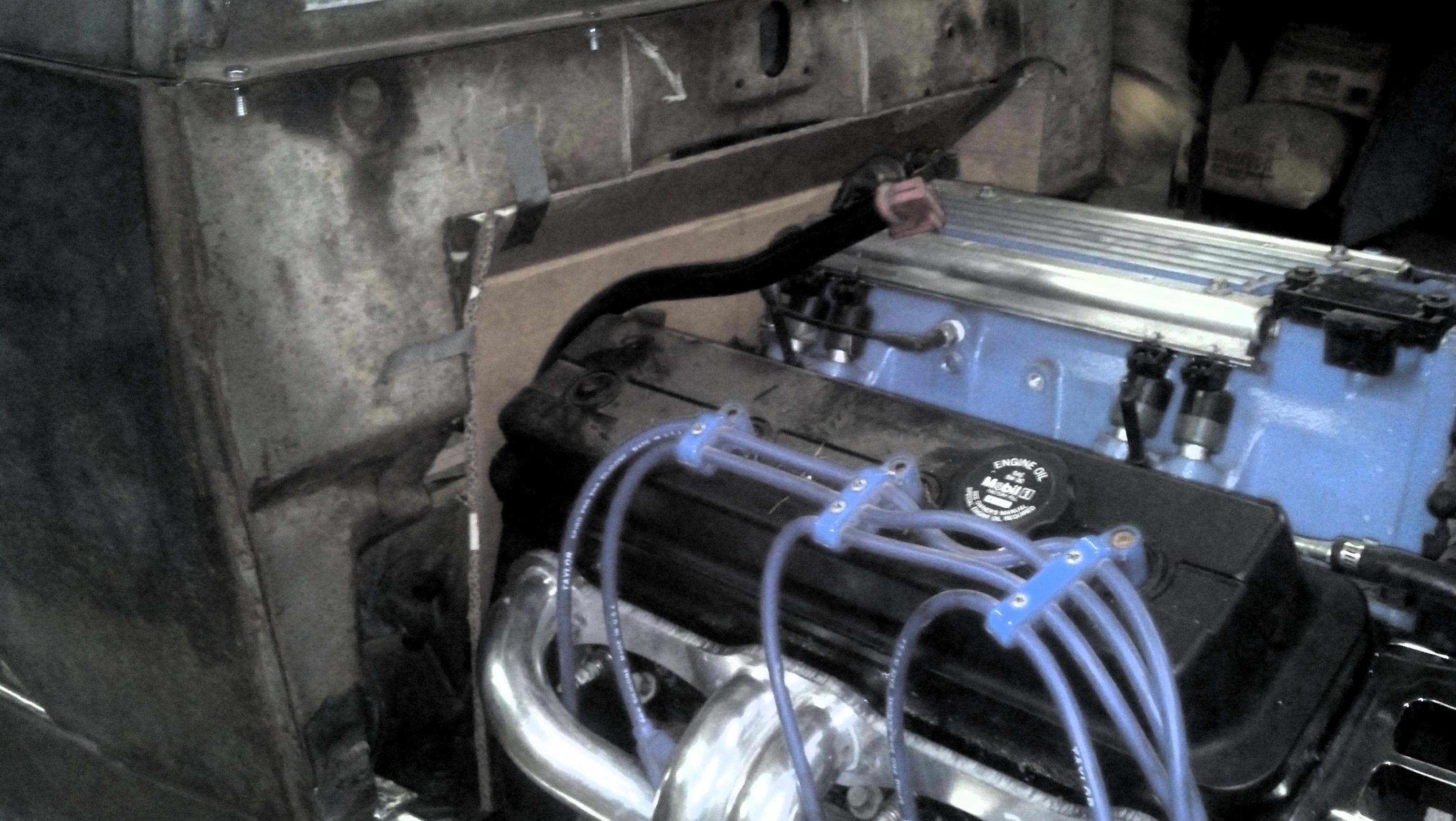

    Got the motor in place and brackets welded in...have about 2 1/4 inch spacing between the motor and fan...should work. Originally set the wheel base at 106" and have now pushed it to 107"..that'll do it.
    Got the hole in the firewall cut out and a cardboard mock-up for the rough planning...this won't be as fancy as some but it'll work out. Firewall set back 1 1/2" - 2"
