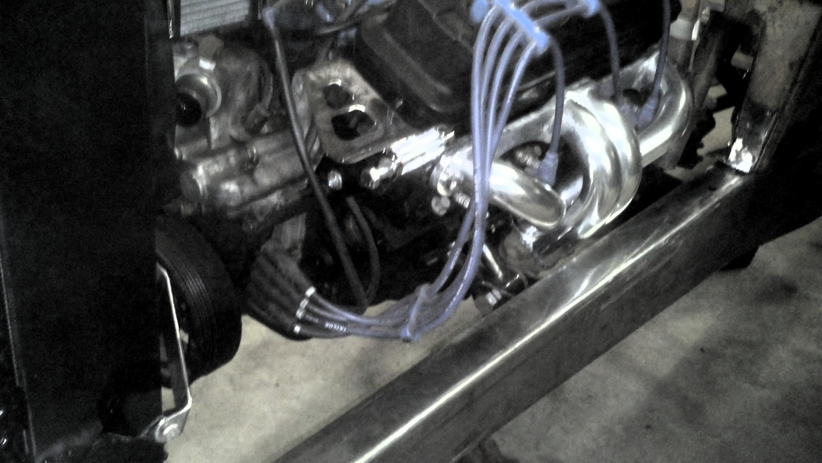

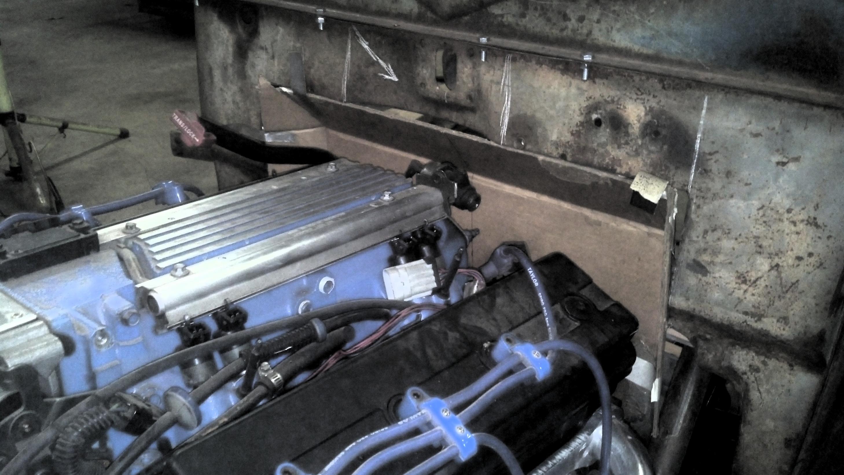

    Tight fit..headers have about 3/4 inch side clearance. Steering is going be another trick...but it'll work out.

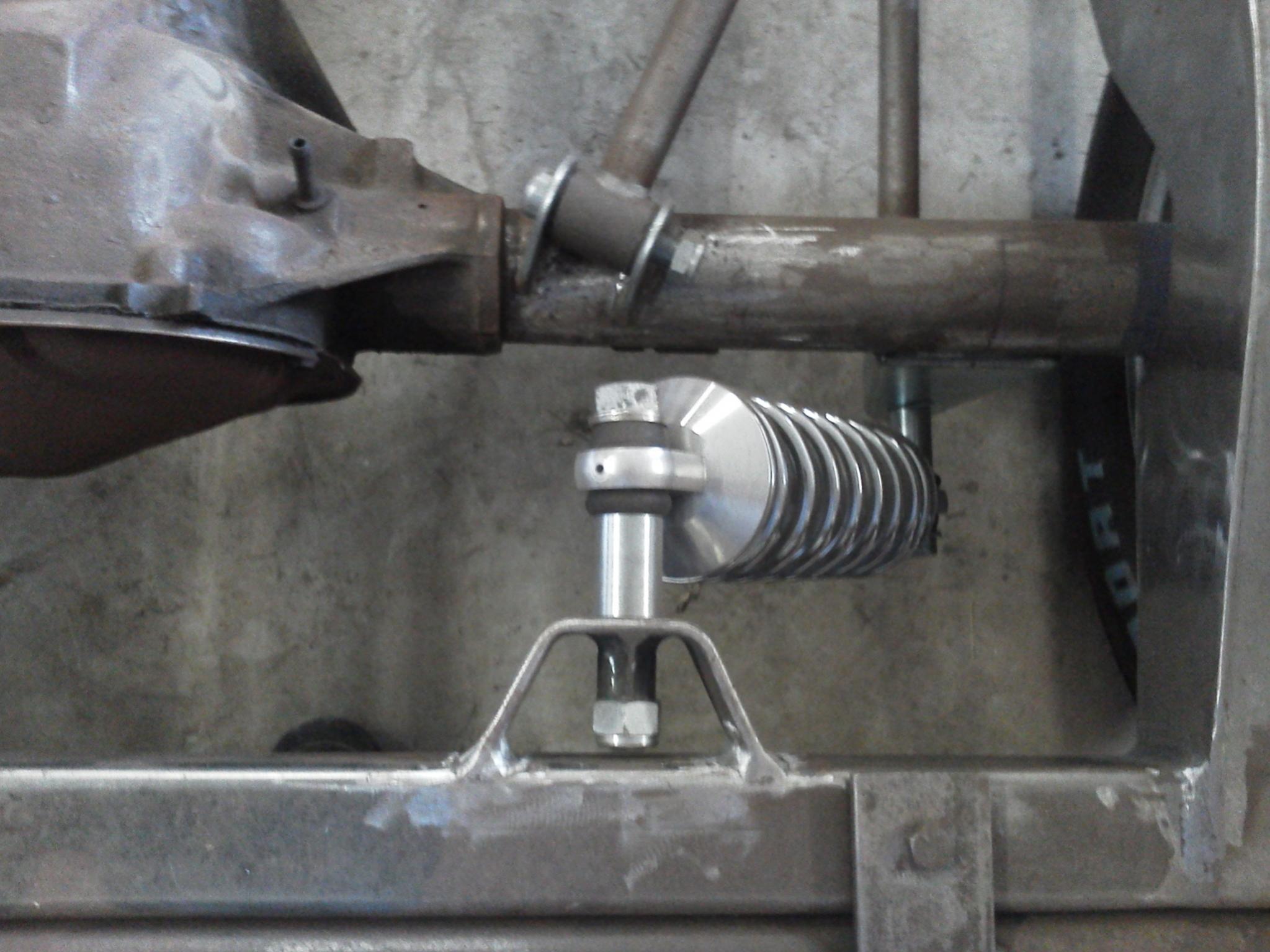

    Here's some new progress.. Drop axle in place, rear and four link, and some nifty homegrown upper c/o shock mounts.
    The c/o mounts ended up as a result of painting ourselves into a corner really... had planned to run a crossmember from right to left..weld in some bungs and hang'em BUT with little room...we thought this would make for a cleaner look. While only one is shown...the two are fabbed from a chunk of 2in 1/4 wall tube with nut welded up inside. Some wrap up remaining with the hairpins...pictured, they are still hainging.

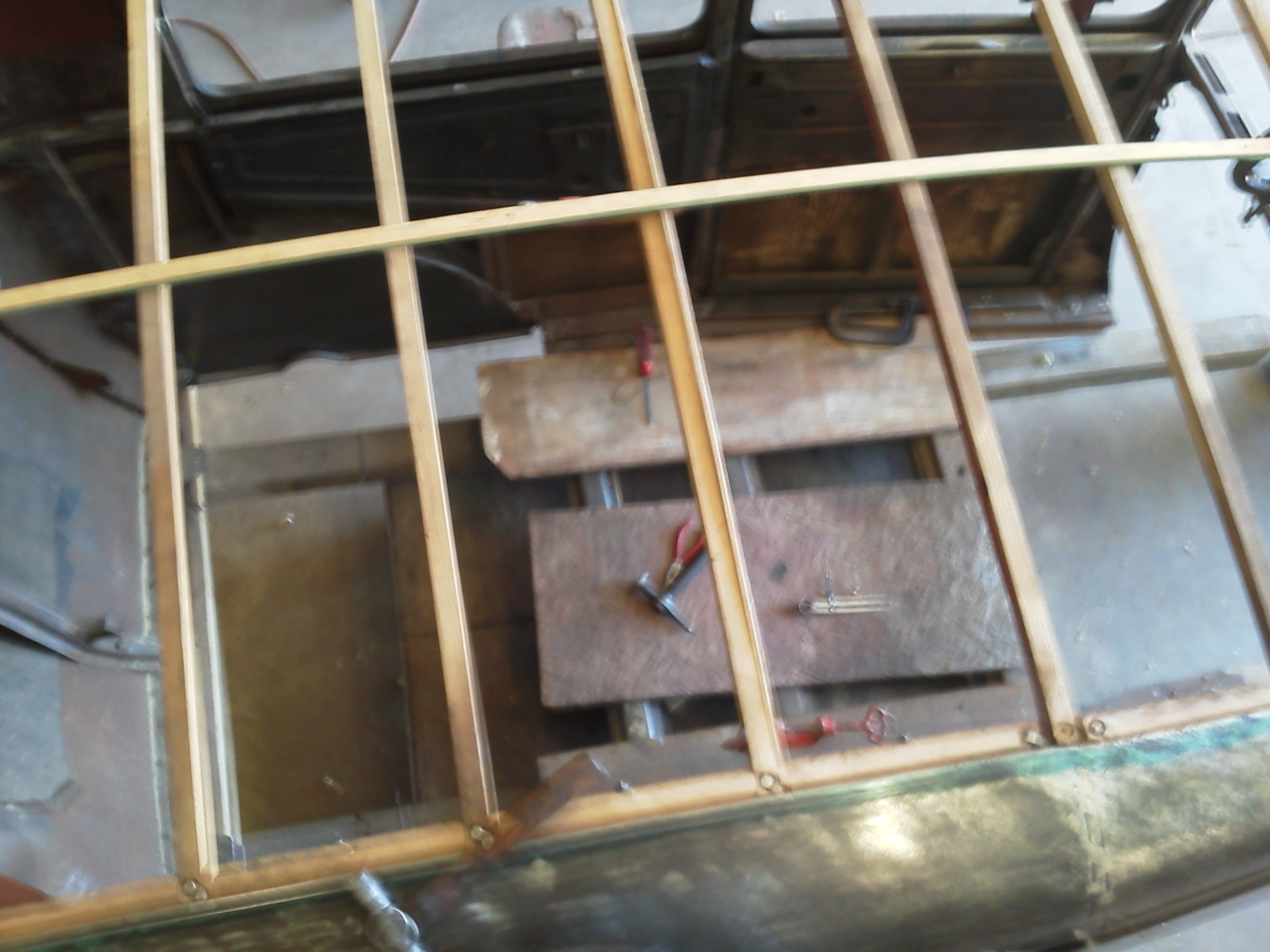

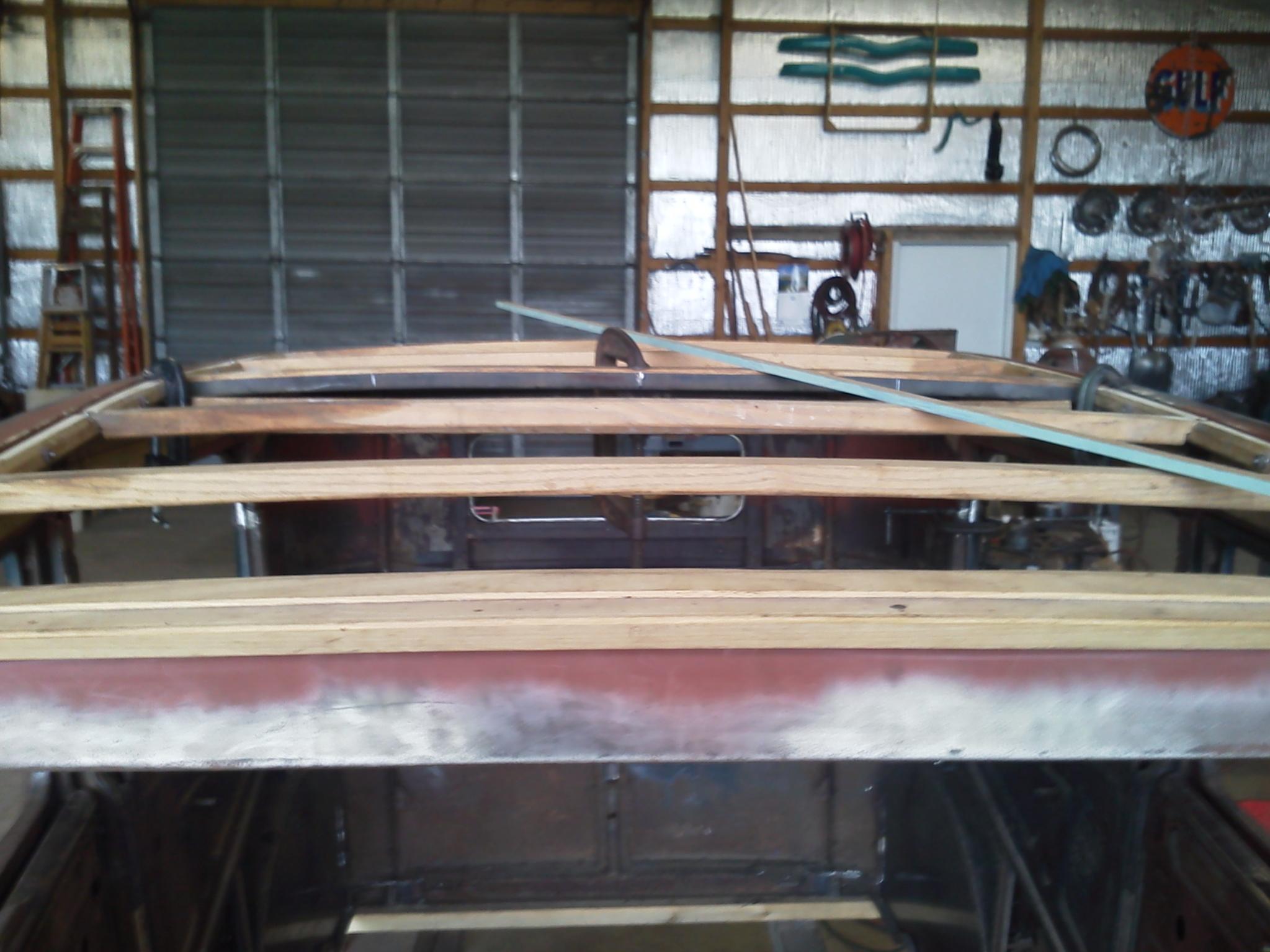

    Some recent progress. Donor top install and misc. details. I believe I'll open up a thread for the donor top prep and install so it's not buried in a deep thread. But here's the pics.
    Pictured you can see we changed up the upper bracket mount for the coil over and left it open so we could access the nut...previously is was a more of a closed block that had a nut welded into it...we worried that it could be more likely to go unnoticed if was backing off. So we changed it. I'm still not sure if I like it...looks much lighter than the previous.
    There was a day of tweaking the wood bows. We took a no brainer approach of holding a strip of wood from front to back to see which was high and low. The biggest offender was the center that lies in the metal bow. Turned out we had to make some reliefe cuts to pull the metal down a bit and then shaved off the top of the bow. Another was about 3/4 low and had to be built up and smoothed up.

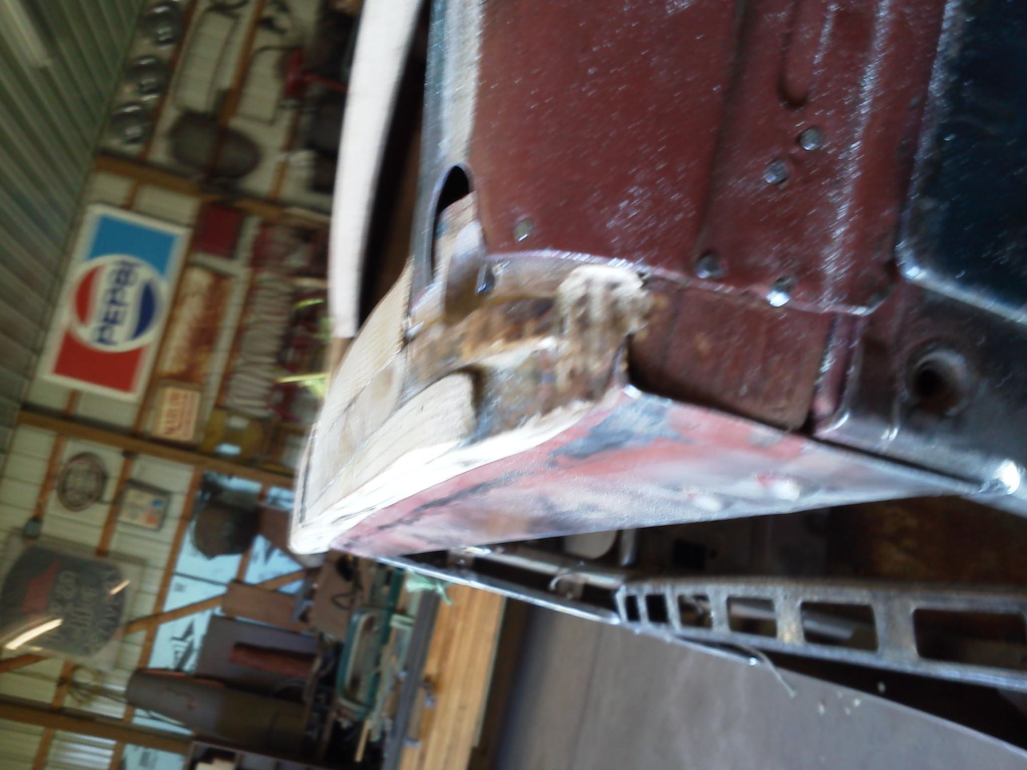

    Next, as we're pulling the visor to the top...I needed to trim the leading edge of the front oak header back so the visor was not obstructed and could sit in it's new location. Makeing the cut while keeping the header in place was a pain in the ***....but was doable. Doing the best we could with what we had on-hand...we got it cut. A big *** grinder with a saw blade...what else could a guy ask for??? Some tweaking with a block plane helped me to finish it out nice and I did keep the angle that it had when it was stock.

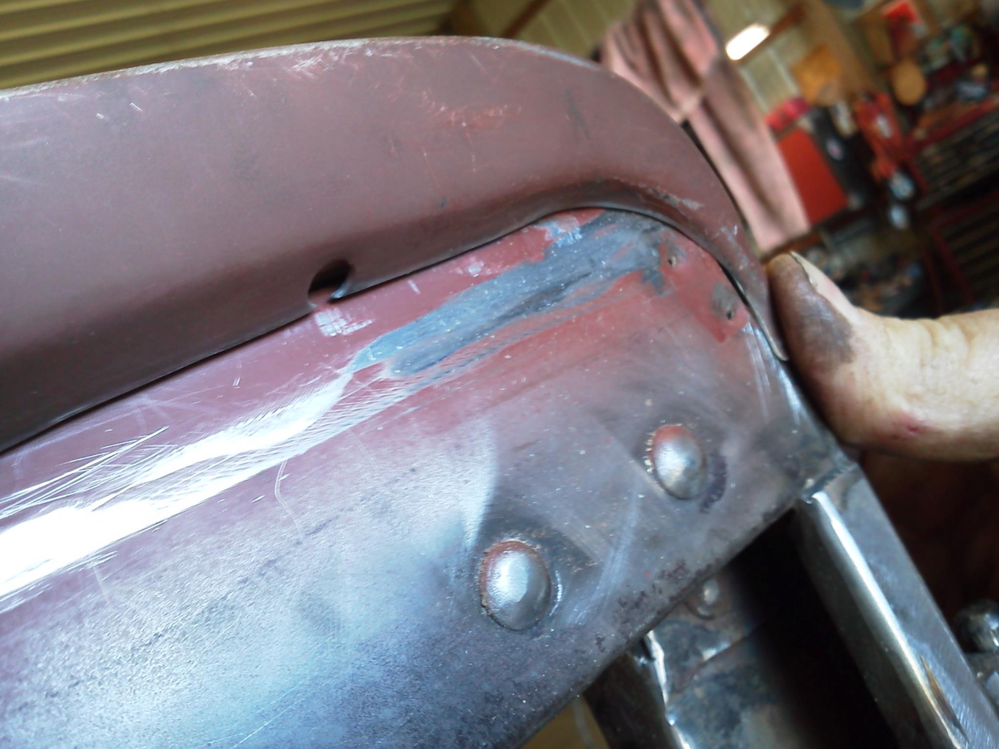

    Was scratching my head figuring how I'd cover that oak header. While it will be under the visor..it needed to be capped off to the elements. The original metal cap for it can still be used with some modifications. Shown is how I cut away the unnessary section (previously used to tack to the oak header)
    If your planning on raising the Visor up to the top of your 28/29 A..... I had to remove around 3/4 of material off the leading edge of the oak header to allow the Visor to haing correctly from the top...left as it was (as was in the kit) it would have been held out to far. As I cut it back I did maintain the degree of slant that corresponds with the metal cap? that is made to cover it. The cap had to get cut up to fit the face. I trimmed off the entire top edge with those nailing tabs AND had to cut out the inside bottom corners (shown) and taper some of the inside bottom flat out so the unit fit flush...this will be tigged up later.

    T******* the top away and the inside lower corner will allow me to use this piece to cover that oak header. The old holes originally used to screw the visor to will get filled up as they are of no use to me in our application.

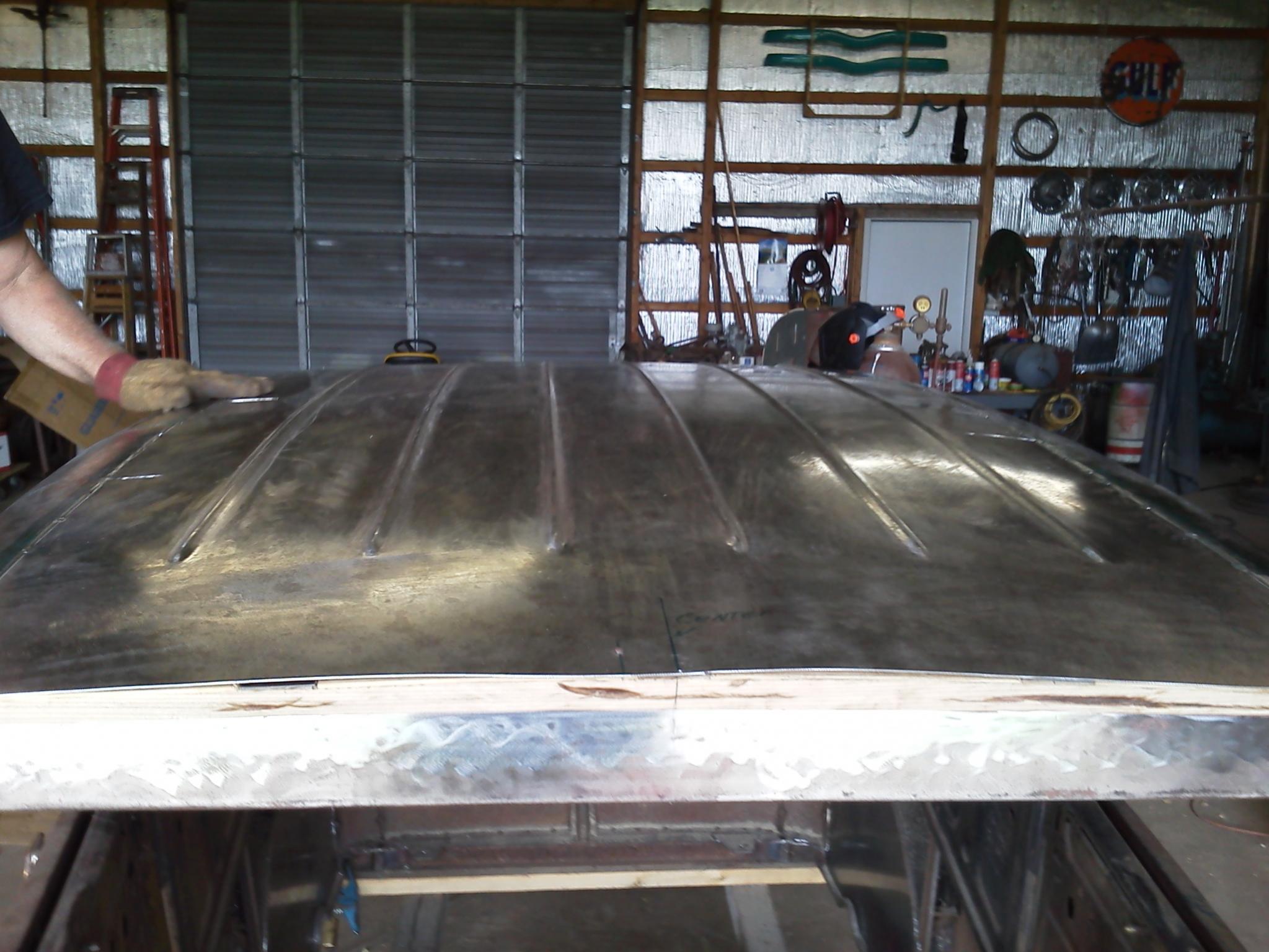

    Got the donor roof prepped, cut, trimmed, and tacked in. I'll link an expanded review in an independent thread as soon as I can. The top will get Tigged-up pretty soon.
    Unsure if it's common but we did put some weights on the top to hold it down in addition we drilled and placed a screw...one centered at the rear and at the front to make sure all was held secured while we cut and trimmed to fit the opening. Our donor was fitted to the hole in the top...as compared to a lap weld. Unsure if it's technically a **** weld as we welded it to the edge of the opening...Hopefully the pictures clear up what I'm trying to describe.
    I decided that making a gage consisting of two pieces of s**** metal could help maintain a consistent 1/16 low donor panel as compared to the outside. Should allow for a very light skim and finish.
    Had to make a few relief cuts on the sides...kept them to around 2 inches...it did help. suspect the front edge will need them too but we've left that to my buddy that tig the visor up for us.

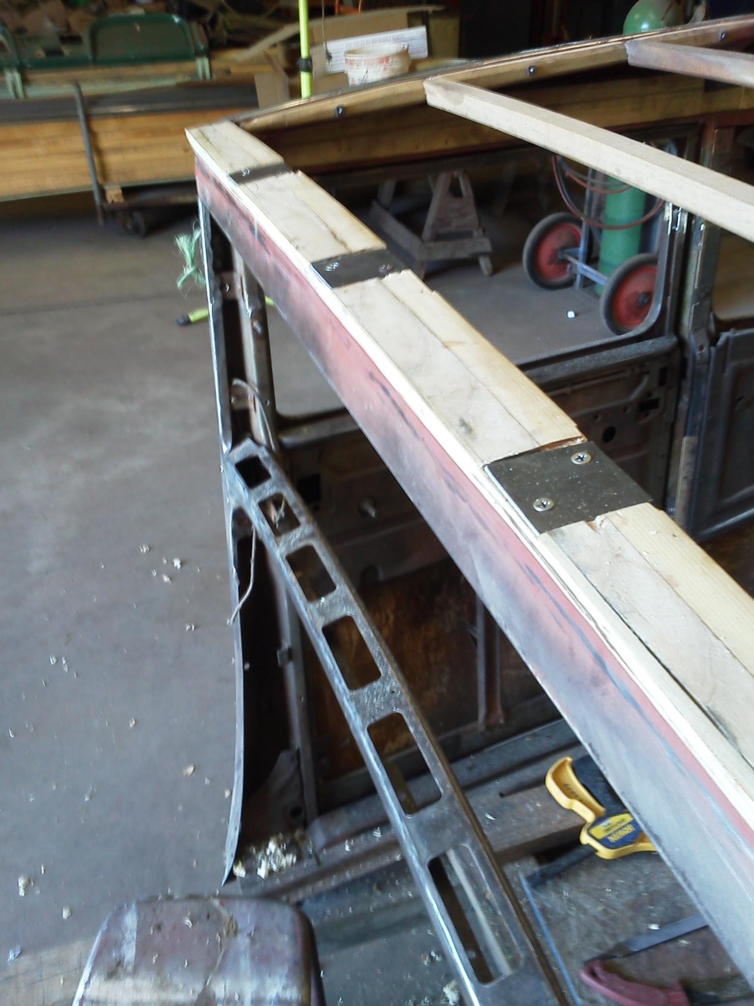

    Here's another first...I think. How were going to keep the leading edge of the roof and visor held down. We morticed in some metal plates along the oak header and screwed them down. Will provide an easy anchor (weld) point for holding it all down. Is guarenteed to handle 180mph speeds without lifting!!
    Interested in comments on this...

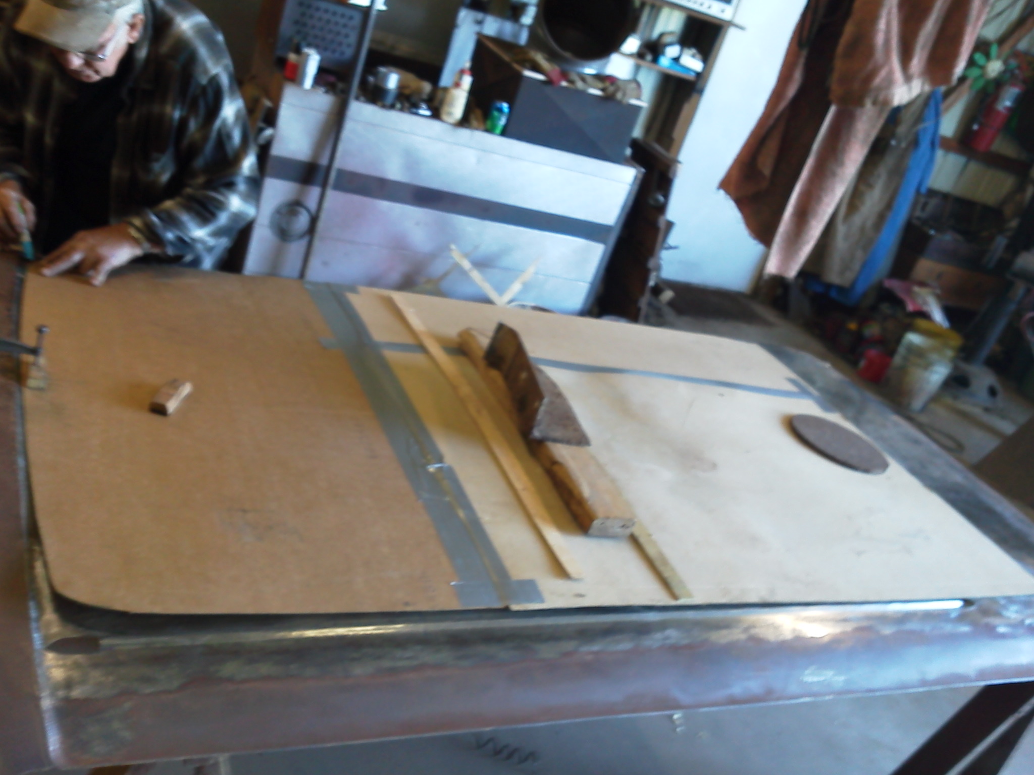

    We kept the donor top secured with screws and some weights (cinder blocks) while we trimmed the top to fit the hole. We left them on for the tack job too...worked great.
    Before we cut the top I ran a scribing comp*** (set at 1/2 inch) around the opening. One edge of the comp*** was hooked over the edge of the hole while the other scratched the outside margen line. This became the line we used to create a cardboard template. The template was used for the initial cut of the donor.
    After the newly cut donor was set on the roof (with that 1/2 excess all around) we centered and added the weights. Next we drilled two holes in the front and back (on centerline) and screwed it down.
    Eventually the rough t******* that left a 1/2 inch margin all around needed to be reduced abit more to allow ourselves the ability to transcribe the outside (on the car) margine BACK to the panel where we needed to cut for the final fit. You see we could not see the scratch on the car when the plug was just sitting over the top of the opening. To save time, NEXT TIME, I'd have undercut the patch (from the template marks) so that it was ready for us to transcribe the body mark back to the trim line... CLEAR AS MUD??? sorry
    The t******* went without a hitch...was able to keep it spot on to the opening. From the start of the t******* to the finished tacking I'd say it took 3 hrs.

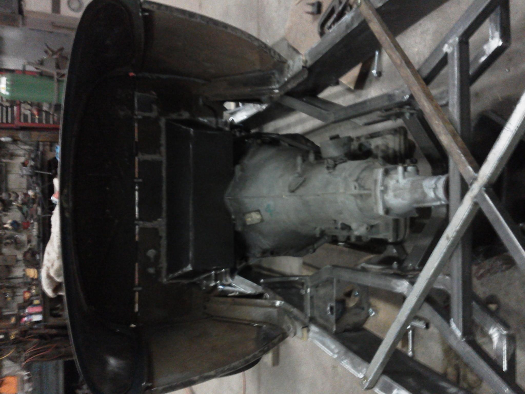

    Some progress today. Test fitted the body on the ch***is.....first time since the chop. Found the wheel wells needed some rework to better fit the tires. The S10 rearend was a little too narrow.... could have used another 4 inches. Will go with a larger rear tire and a smaller front before it's over. But I feel we are moving in the right direction. Pictured....I mocked up the visor and shell
