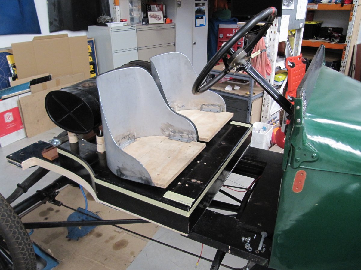

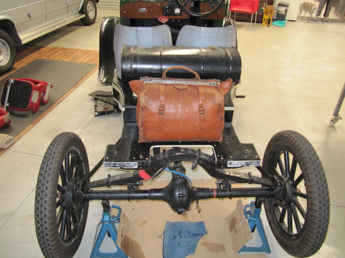

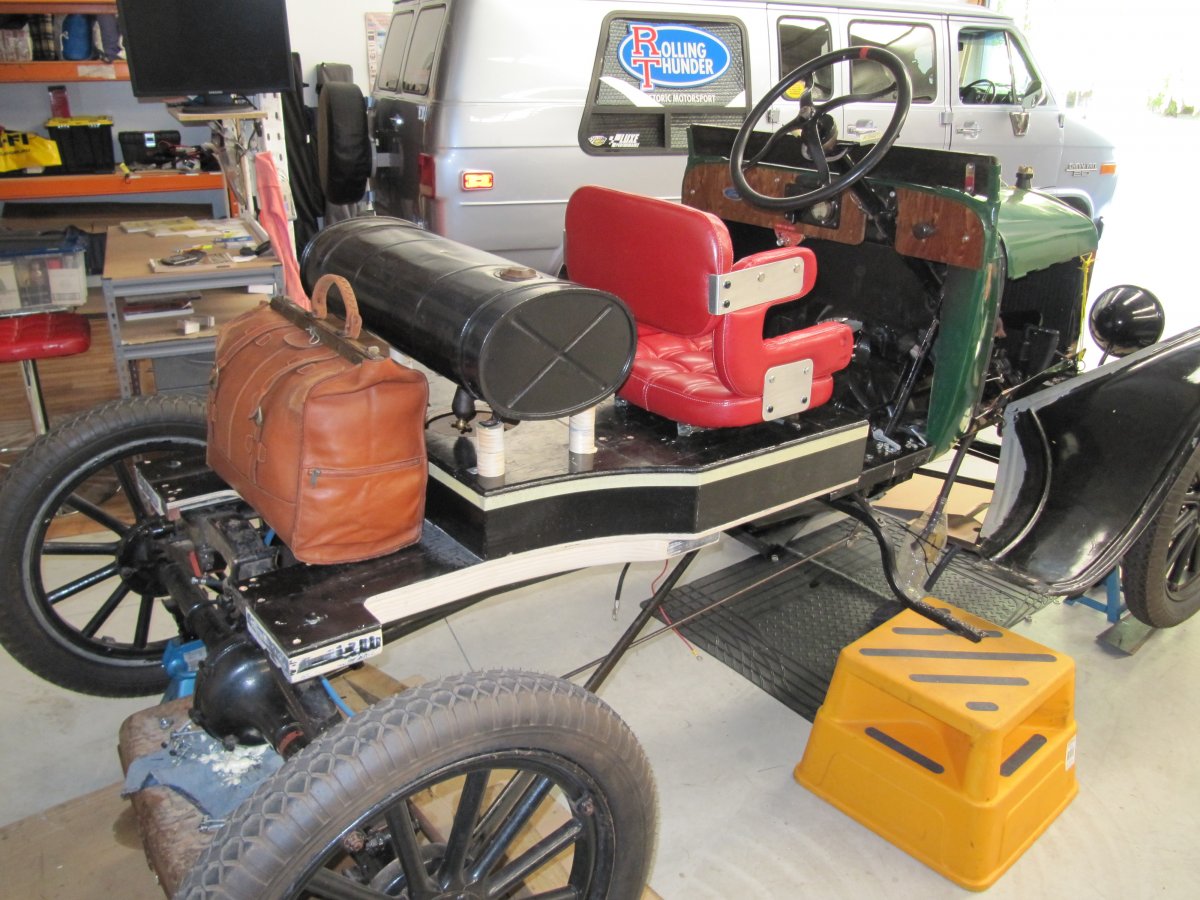

    I've just bought this Aussie T roadster body with the view to build a Gow job, not sure if it'll be on an A or a T ch***is. Will see what parts turn up.
    I'm also surprised that @Greg Stokes T hasn't had a look in yet, it's a great little car!
    Perfect to my eye.
