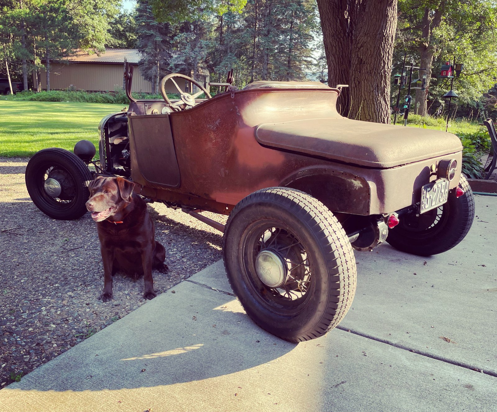

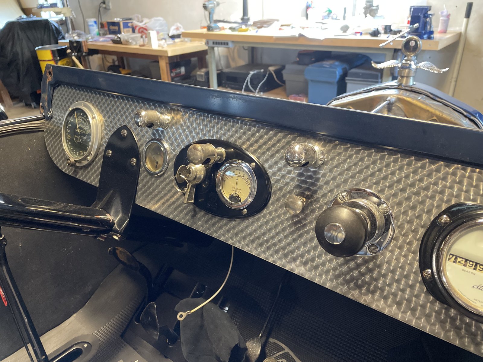

    Best thread on the HAMB. Made some changes on mine over the winter with a new dash. Got out for an enjoyable ride last night.
    Dannerr, Tim, jet996 and 18 others like this.
  16. ALLDONE
    Joined: May 16, 2023
    Posts: 3,938
    ALLDONE
    Damn... thats too cool,... love the patina w/o the grunge

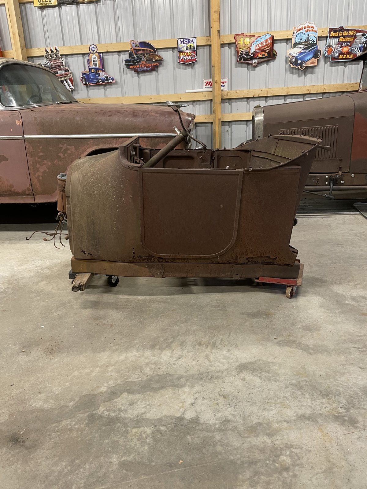

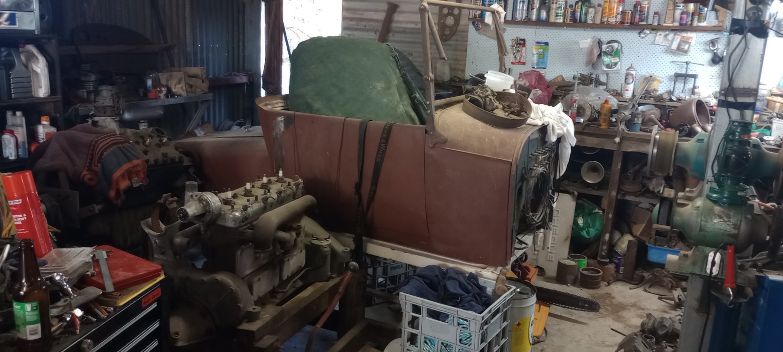

    Deeluxe, Dannerr, burl and 6 others like this.
  22. Lil'Alb
    Joined: Sep 22, 2013
    Posts: 264
    Lil'Alb
    from brier, wa
    That is cool! Looks like an aluminum head. what kind of engine is that?
    Outback likes this.
  23. Outback
    Joined: Mar 4, 2005
    Posts: 3,447
    Outback
    from NE Vic, Oz

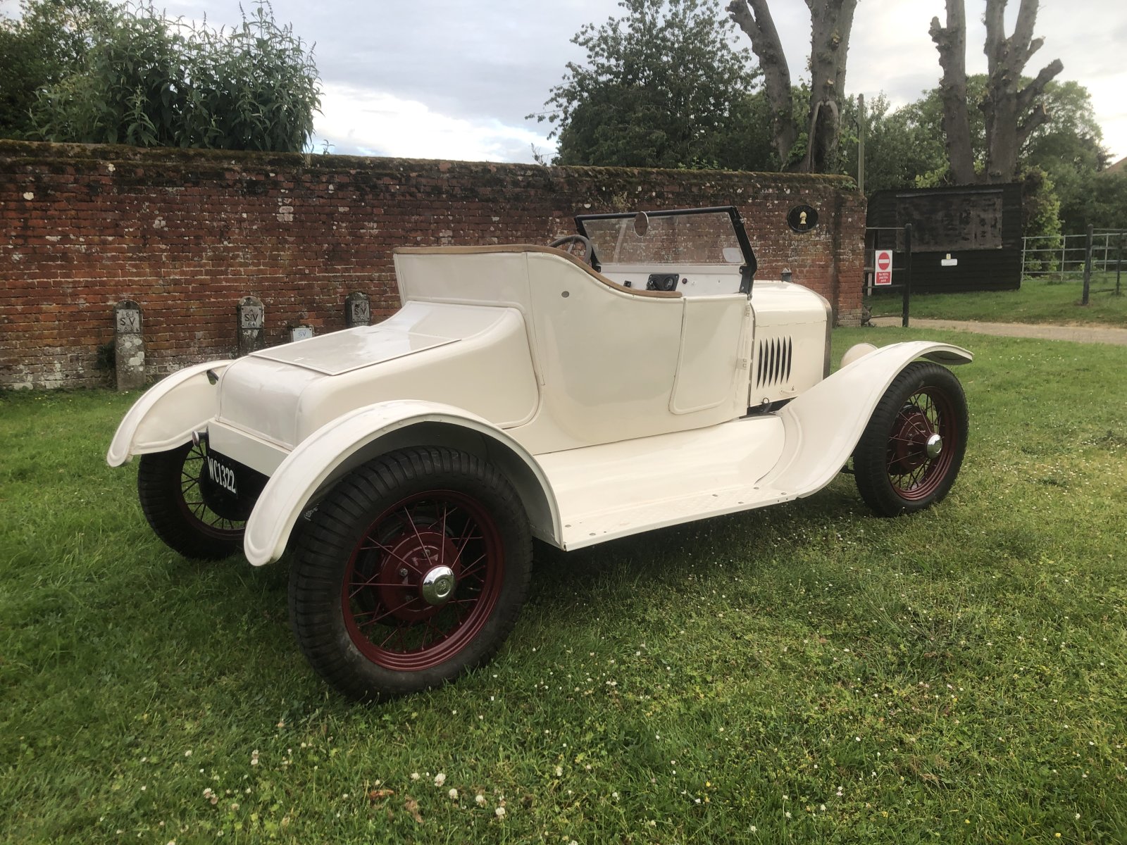

    Thanks, the engine is a 1923 ish 14/40 Vauxhall engine, they have an aluminum head, crankcase & sump, full pressure fed bottom end, oil filter & counter-weighted crank. It also has a 4 spd gearbox. They are 2.3L or about 140ci. Had 40hp & in the original car would do close to 60mph.
    I figure in a T which is significantly smaller/lighter it should be fun little car. Especially with a hotter cam & more carburetion.
    The engine was designed by Harry Ricardo.
    Pictured is a 14/40 Vauxhall

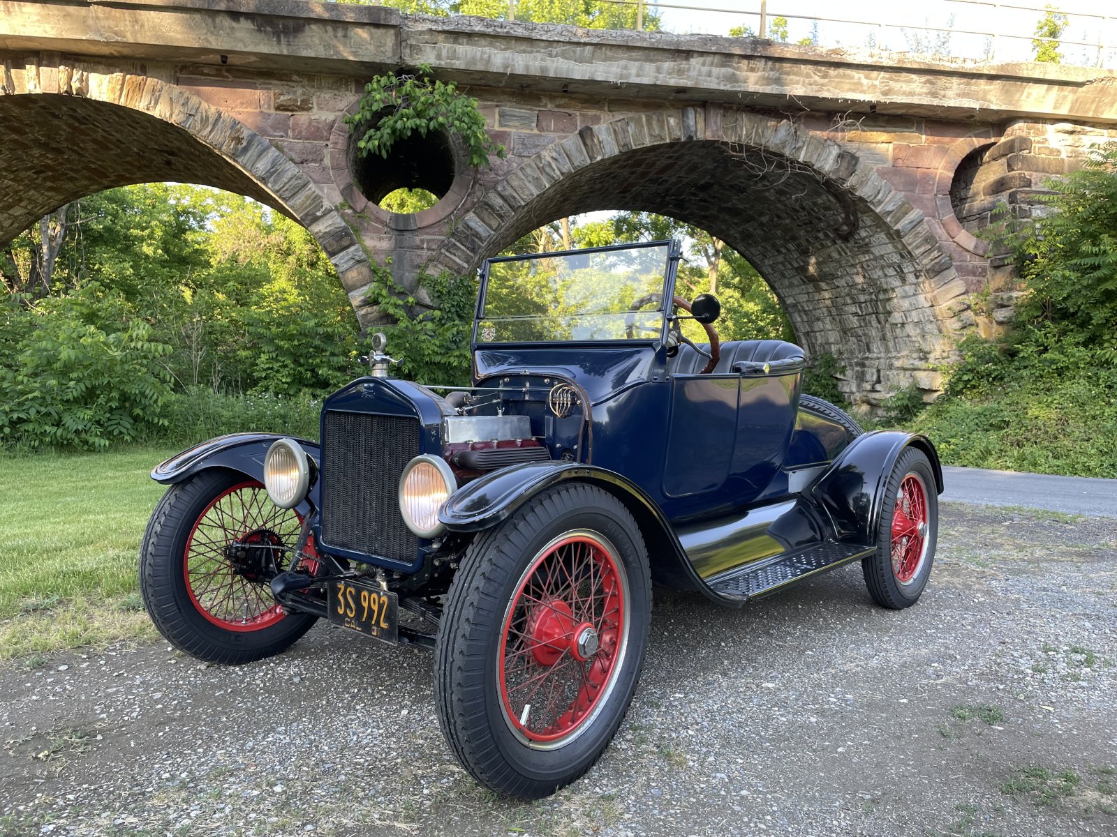

  24. Fitted the wires.

    Wow! Looks awesome!

    19's at a guess? @hotrodfil ?
    hotrodfil likes this.
  29. Yup, skinny old 19’s.

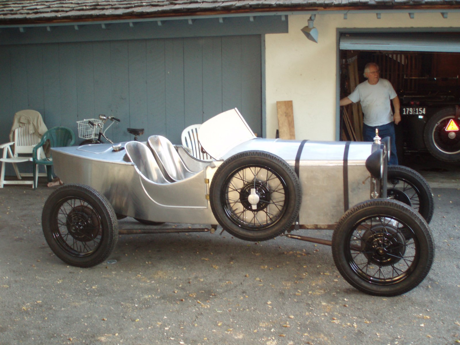

    My favorite. It started as a bunch of parts my dad and I began collecting when I was a kid of 8 or 9. Our intention was to build a gow job (aka speedster) like the ones he built during the depression. Time p***ed, dad died in 2005, and I was about to sell all the stuff. I didn’t have much of a shop at the time. Over a beer I told my late, great friend, Gary Byrd. about the situation, and without hesitating he said bring it all over here and we’ll build you a car. What you see here is the result.
