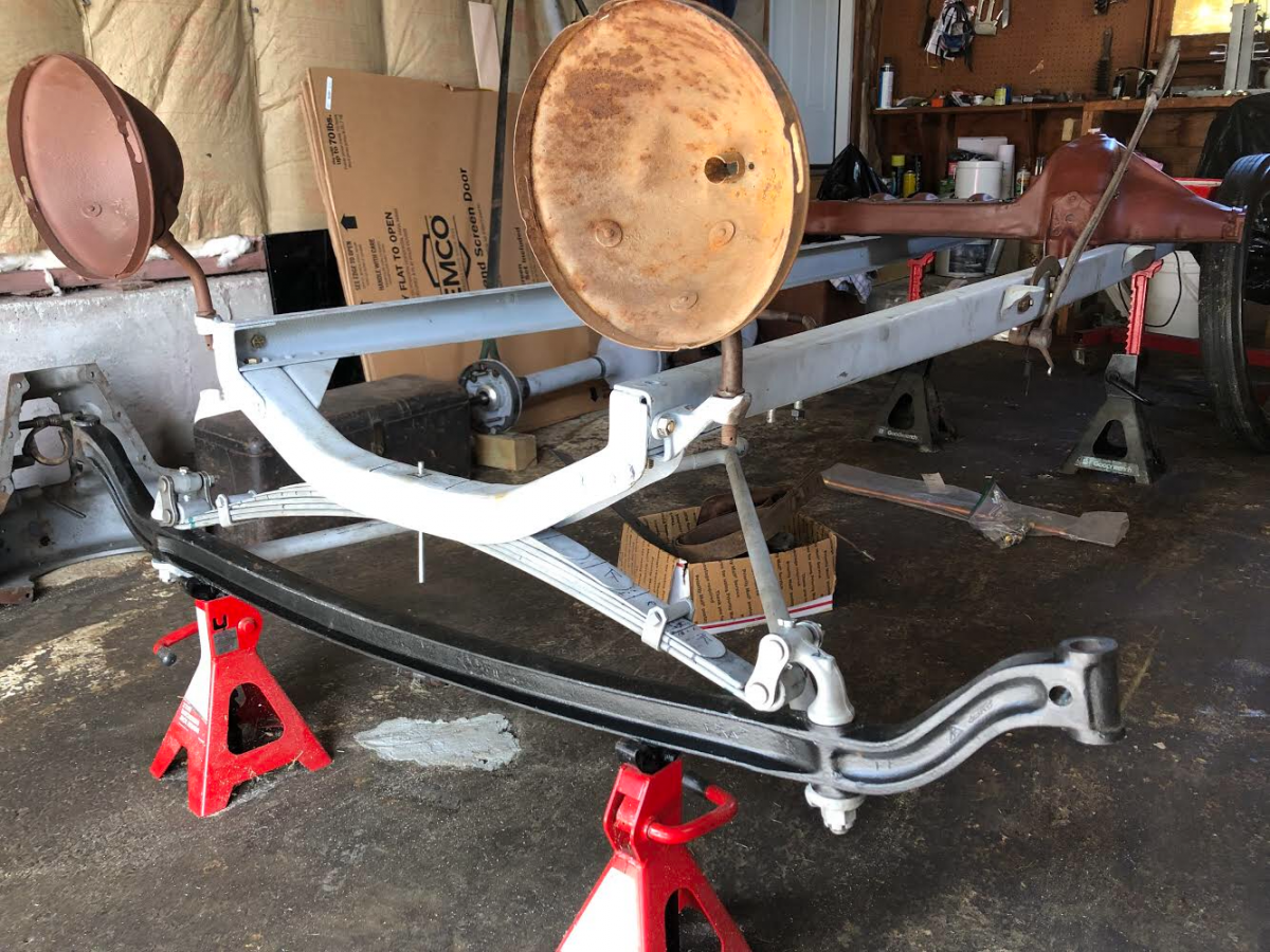

    I used the difference in the perch area of the t axle vrs the a axle. I came up with needing a space .263 thick and .685 Id. Anything over that is fine as long as the castle nut engages the the cooter pin hole. One could also cut the threads longer as well! Stay tuned when I get my engine to see what happens at the other end of the wishbone!

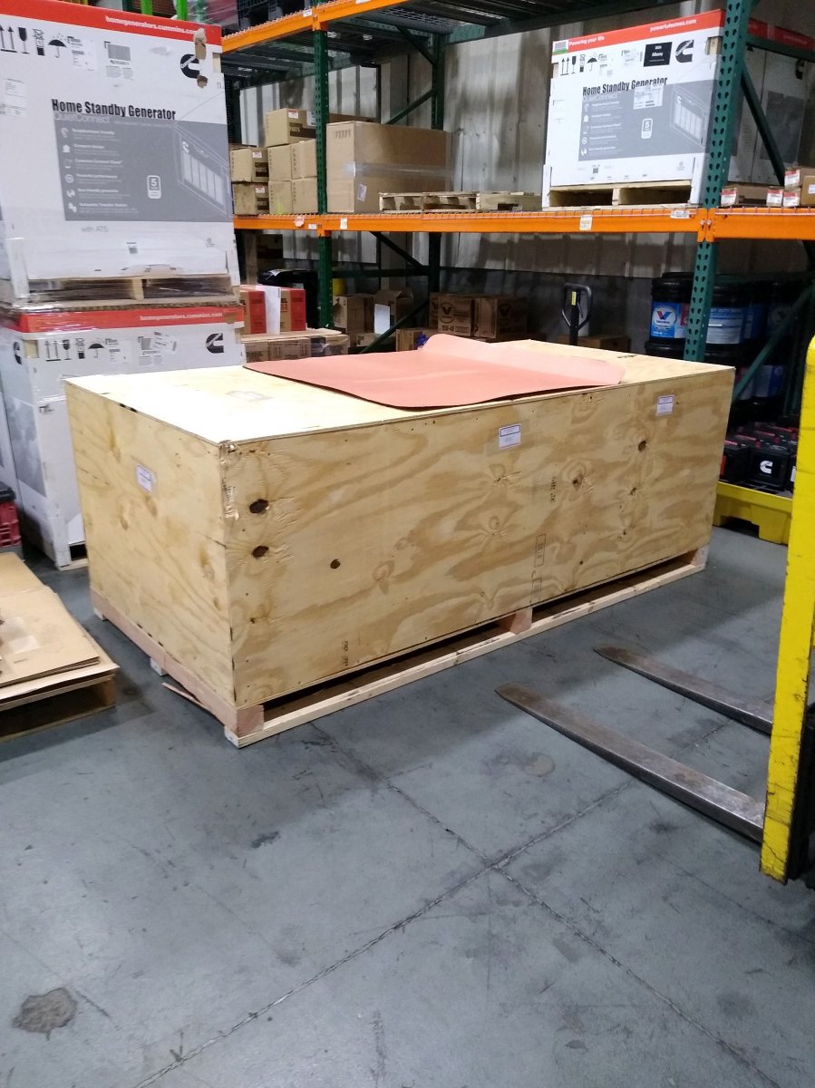

  7. David Mazza
    Joined: Aug 25, 2018
    Posts: 88
    David Mazza

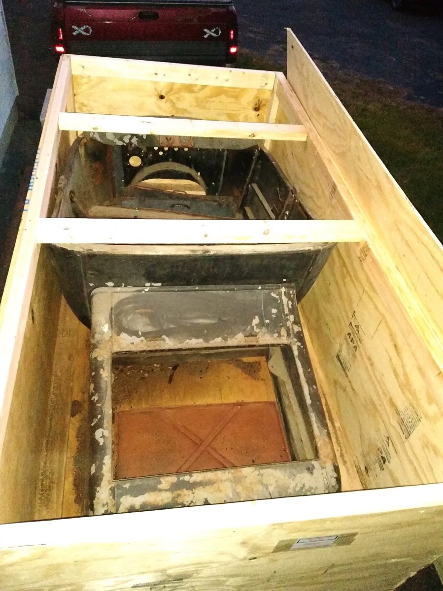

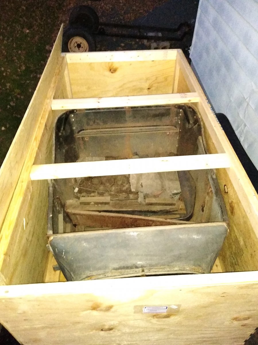

    8192863B-A65D-4DFC-8AB5-F24D4F7A4FEE.jpeg Wonder what could be in this crate sitting at guitarguys work place?
  8. flyin-t
    Joined: Dec 29, 2004
    Posts: 1,617
    flyin-t
    open it, open it!!!!

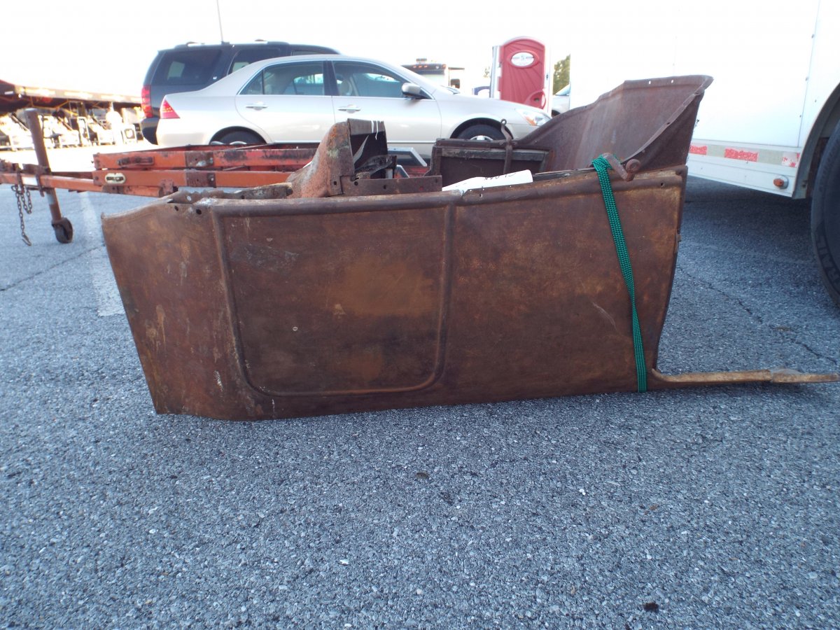

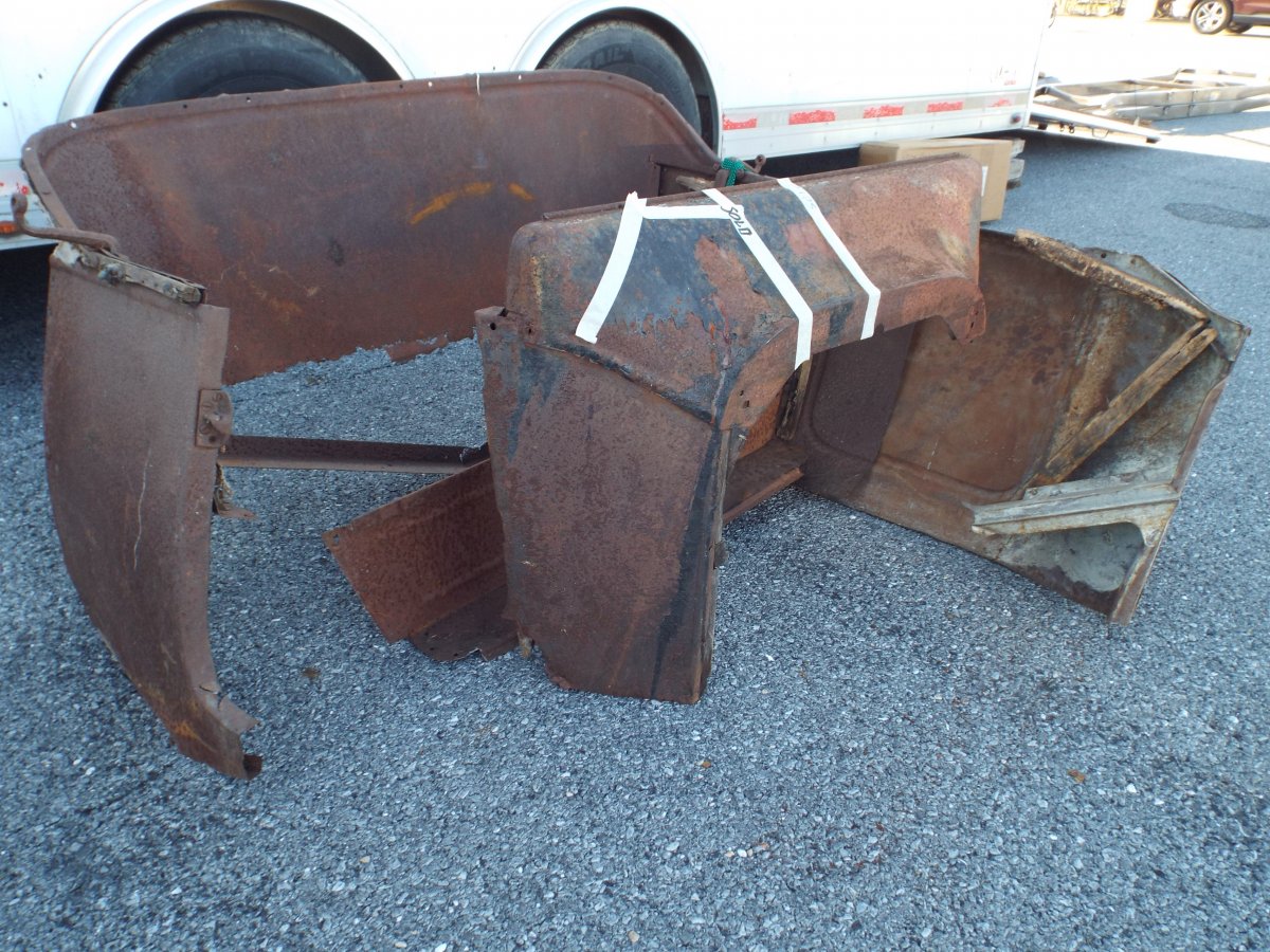

    Bought this 23-25 T Touring front half in two different locations. Rough enough to cut in half and build a Lakes Modified. Fun finding stuff, even better when you can sell it to a friend on the HAMB who will build it a lot quicker than me. Bob DSCF4225.JPG DSCF4226.JPG

  11. David Mazza
    Posts: 88
    David Mazza
    I want to open it so bad but another hamber has it at his place. Hard to believe in this day and age someone will help you the way guitarguy has! I don’t think I will be able to sleep until it gets here, too excited! And even when it gets here I will probably sit in it all night making engine noises.

    That is a really nice T body, is it going through a professional trucking company? Bob
    Outback and David Mazza like this.

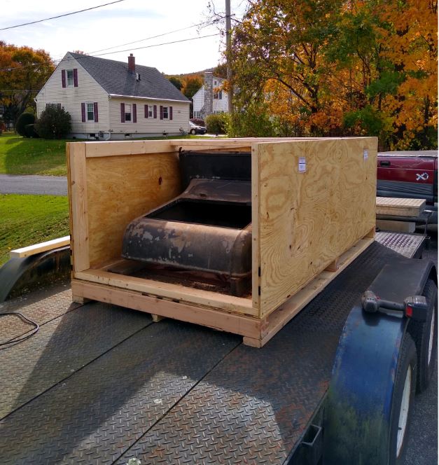

  13. guitarguy
    Joined: May 26, 2008
    Posts: 650
    guitarguy
    Yes, the seller built the crate and shipped it through a trucking company. Being trucking companies kill the pricing on residential deliveries---especially with liftgate service, I had David ship it to my workplace. Its loaded on my car trailer ready for delivery on Sunday. Sunday is going to be a great day!
    I peeked and opened it! :cool:
    It appears to be a nice body that needs some TLC. But that's why they call them projects, right? But it is a real steel Henry Ford body.

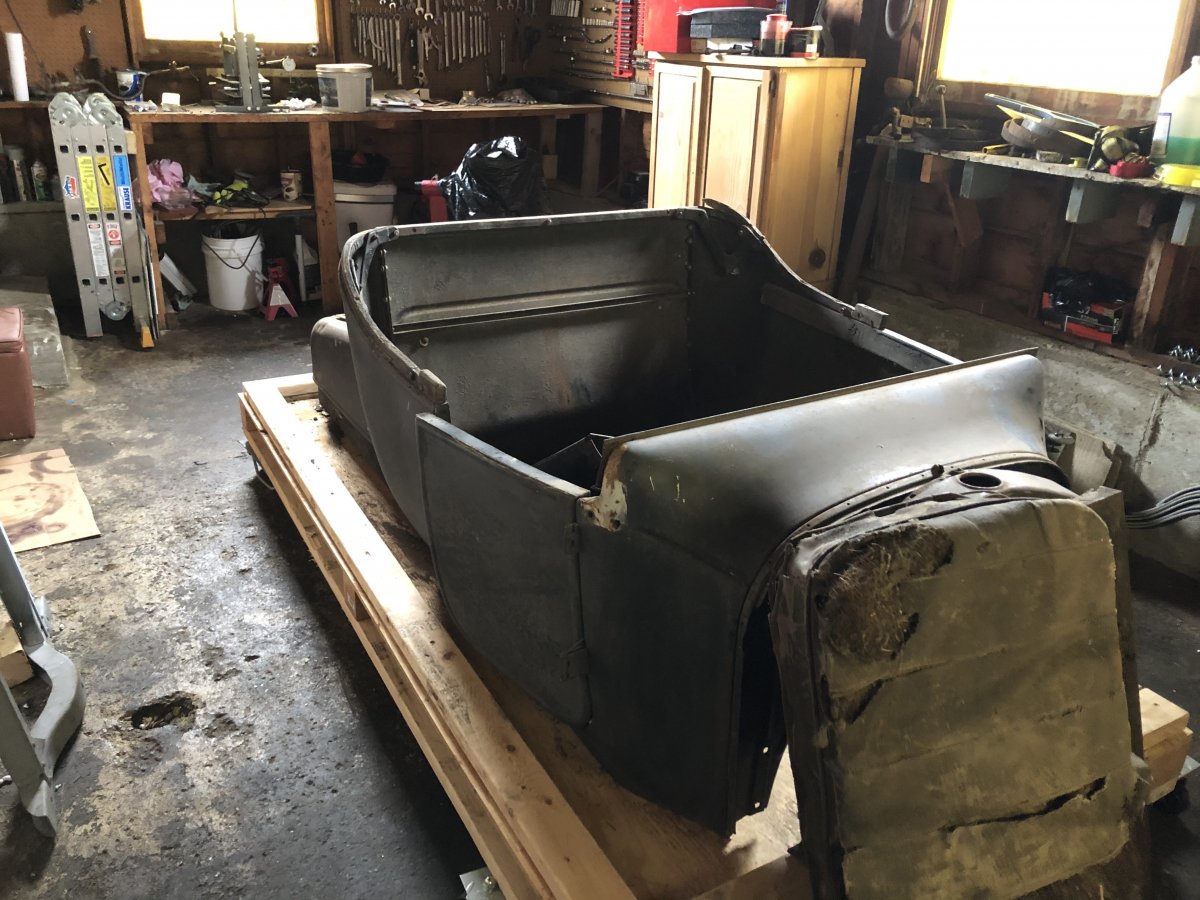

    It’s going to need wood, and some metal work but I can tell you for the number of model t runabouts built from 1917-1925 they are super hard to find in any condition at all! Here’s a sneak peak guitarguy sent me last night. Unfortunately that dark red dust is the shape the wood is in. Like he said it’s a project, but it will be done right and I will keep this car forever so if I get a tad deep into it I won’t feel to bad. If Isky can keep a t roadster forever why can’t I! 4641AC6B-2362-42FD-B3E6-9F8613C5C72B.jpeg E1C56B63-247F-4CC3-BBEF-51CC27D9CA8D.jpeg

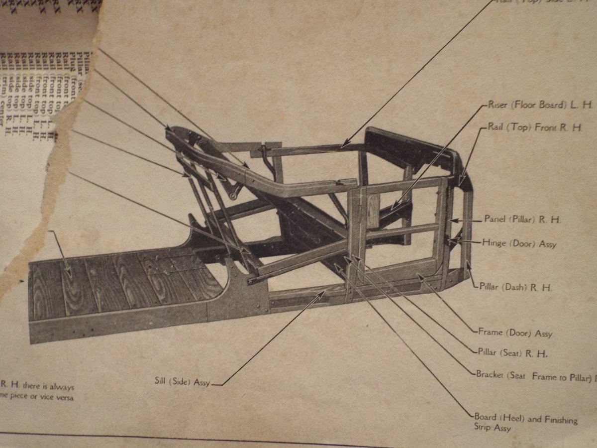

    DSCF4390.JPG Just looked at Don Lang's catalog wood kits are rather costly, but key to having a proper body. Bob

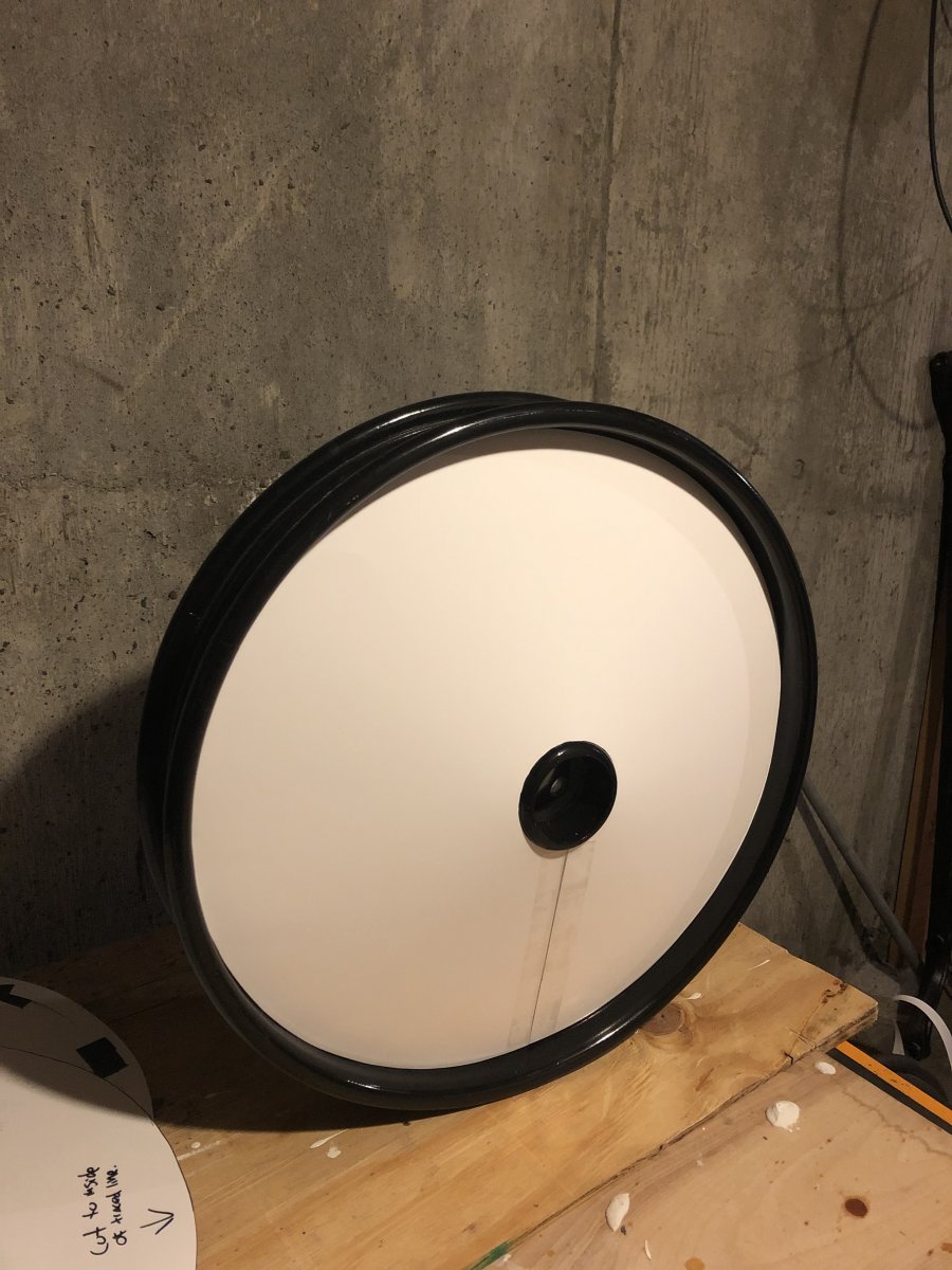

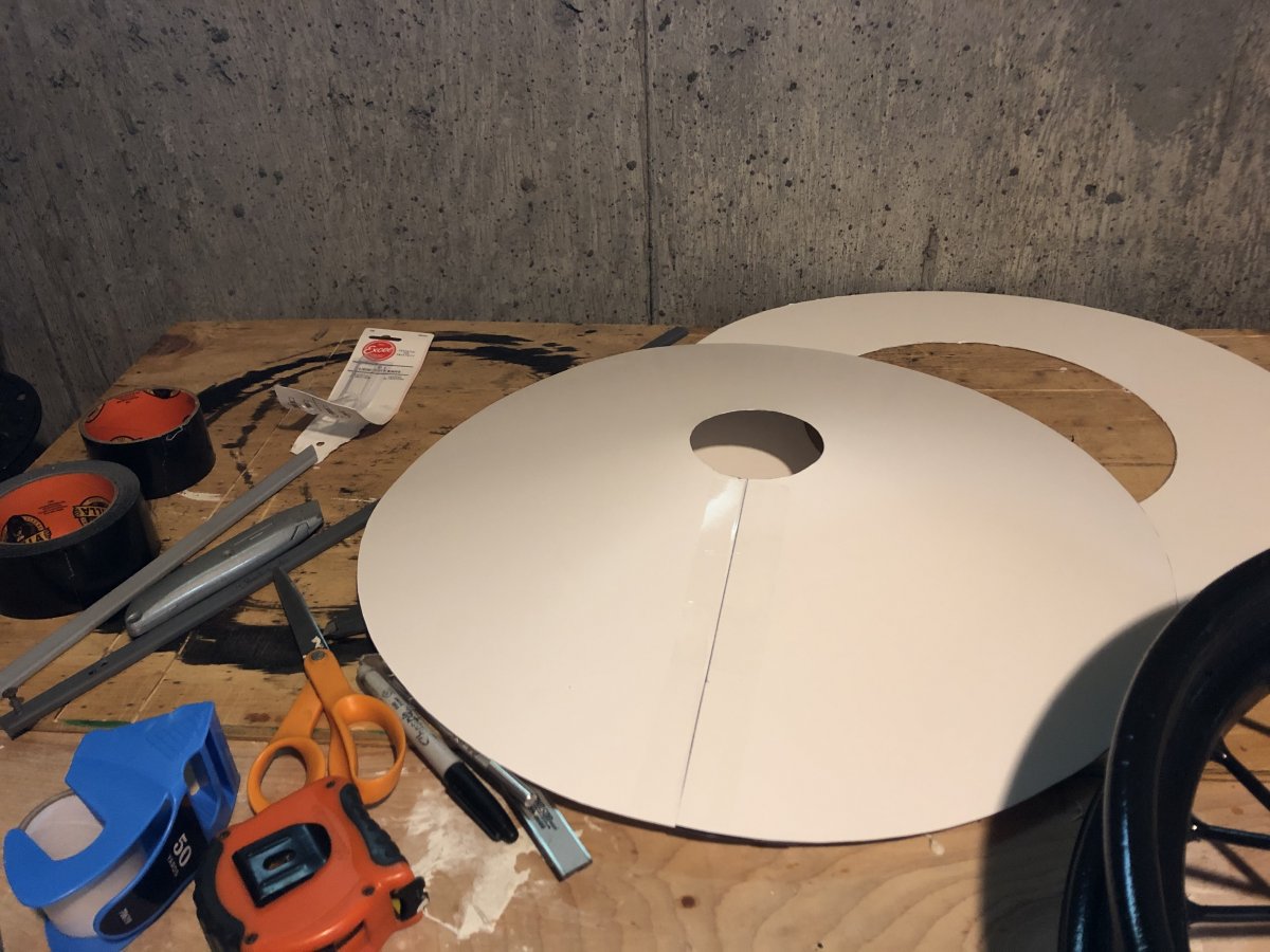

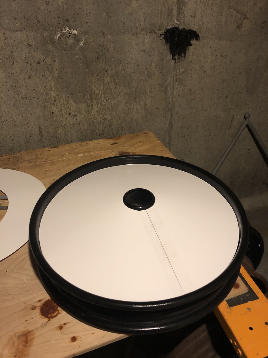

    DDB6C0F6-2E62-4501-89CC-0A577CFAFF52.jpeg 01C602D5-281B-4CA8-96C5-EBA8776225BB.jpeg 63A79898-6195-447A-9FA0-31AB28299B48.jpeg D4CFA1DB-1D56-42E7-A343-4DBE511013BE.jpeg 9ADC9800-F765-4346-A1A0-F001D253B682.jpeg I am going to use 21 inch model a wheels on my car. The front will use a model a axle so easy there. I will just bolt to the model a hubs. I have the rear figured out as well. I am keeping the model t rear axle and will make my own adapter to bolt model a wheels to bolt on model t hubs. More on those latter. But the biggest problem I have is the fact that I don’t like the look of the 21 inch model a wheel! I am using them for there tall size and narrow tire that will look best on a t that is lowered but not lowered a lot like the Aldrich roadster. No way I can afford buffalo or early Dayton or pasco or simplex accessory wheels as they are super expensive these days! My solution is an old one! I will cover the wheels with something done in expensive cars and early racing car from the teens and 20s. I will make aluminum disc covers. Most of the disc from this era were spun like a modern moon disc. A moon disc wouldn’t really fit my application so I’d have to make my own. Unfortunately again I can’t spin large sheet of aluminum and having that done is also out of a model t enthusiasts budget. All until I found a car which they built aluminum cones overlapping on itself and riveted. So I set out to see if it’s possible for myself to make some for a model a wheel. So far I have perfected my templates. It took many many tries as there are three dimensions in which to accommodate in precision but it is possible. Now I can order up some aluminum. I also made a rear disc to hide wheel completely. The rear will just be made of sheet steel to keep costs down and painted semi gloss black. The disc will be held to the wheel with a carriage bolts passing through the front and through to the rear disc. It will be held in place with spring tension and easy to remove nut. Here is the inspiration and the final templates.

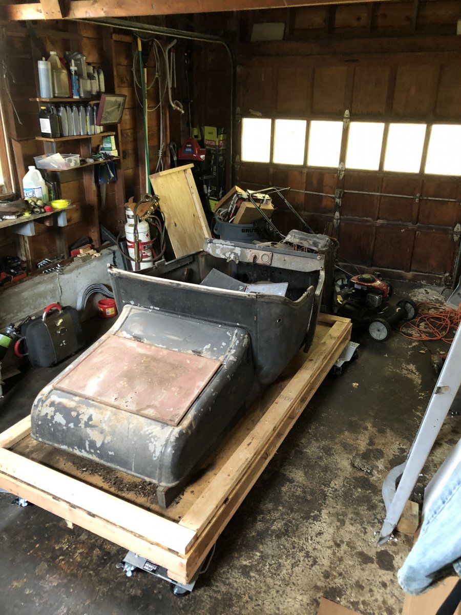

  22. David Mazza
    Posts: 88
    David Mazza

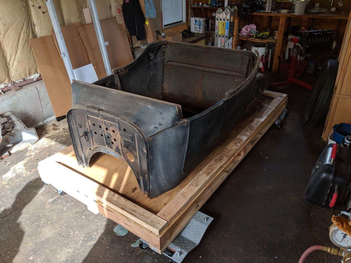

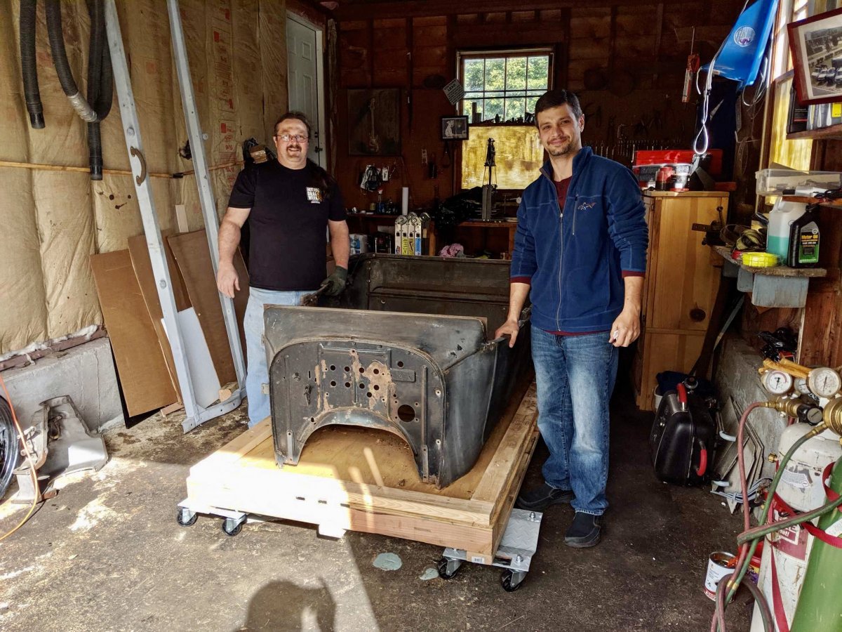

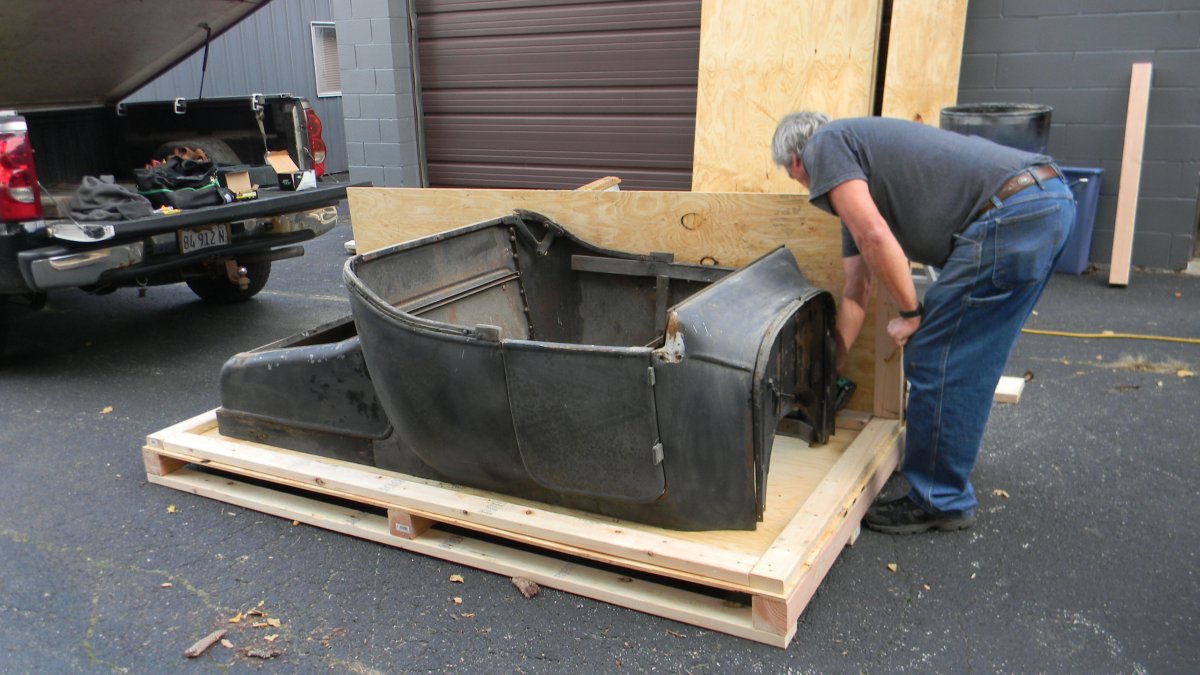

    C7EBFCA1-2EEB-40BB-AE8E-FE45B727BAD2.jpeg A667CC9C-9421-4248-BD96-8DF1511088DF.jpeg I finally own a real steel ford roadster. With guitarguy and bigcheese we unboxed and moved the new roadster into its forever home. It will need more patches than I hoped and all new wood but for a guy in Massachusetts it’s as solid as oak compared to what most model t projects I see around here are! More pics to follow as I break it down make repairs and begin building the wood structure back up once I build a good work height stand for my chassis to attach to.

    Nice! Looks like some insulation will make winter work more comfortable. Bob
