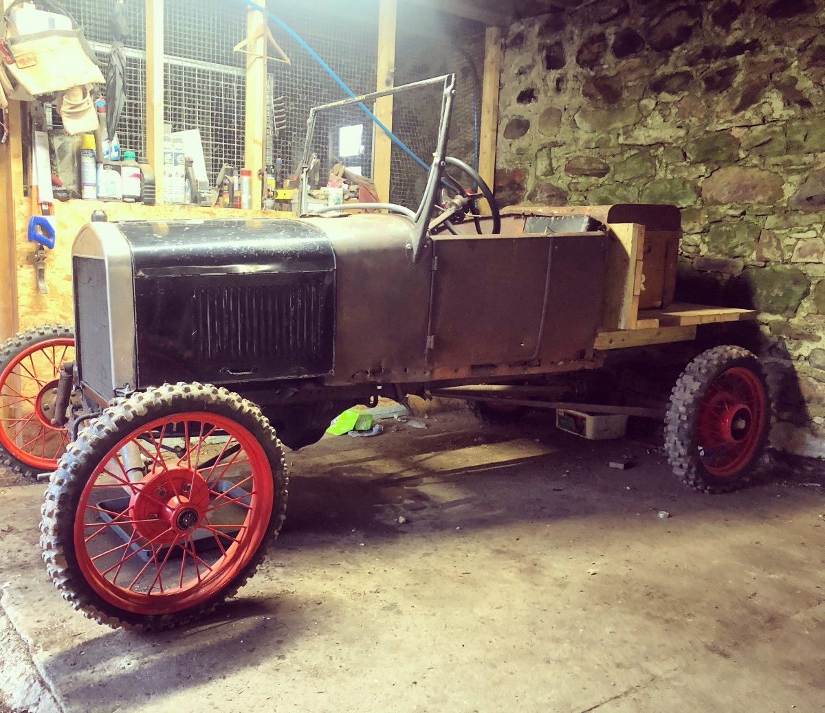

    My 26T "Gin Runner" finally got it running after too long in storage. Ive got a 2 speed Ruckstell to fit and a full set of 21" wires and road tyres to go on. the dirt bike tyres are for playing about on the farm!
    Motor is stock '26 T with A manifolds and a 1.25" SU carb, Texas T dizzy and ally pistons. Plan is to continue to refine and hop up but keep it pre 1930 in looks and main components. Im looking for a brass bodied SU of the same size to replace the 1960's one I'm using just now.

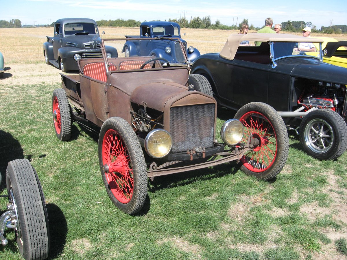

    David, was that at Lindseys farm cruise in Shedd?
    Looks like the T that I saw at Pauls get together at his place near Woodburn, if it is he had an old motorcycle displayed in the bed, a very cool car.

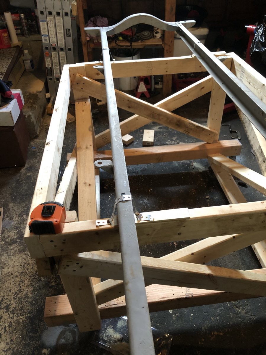

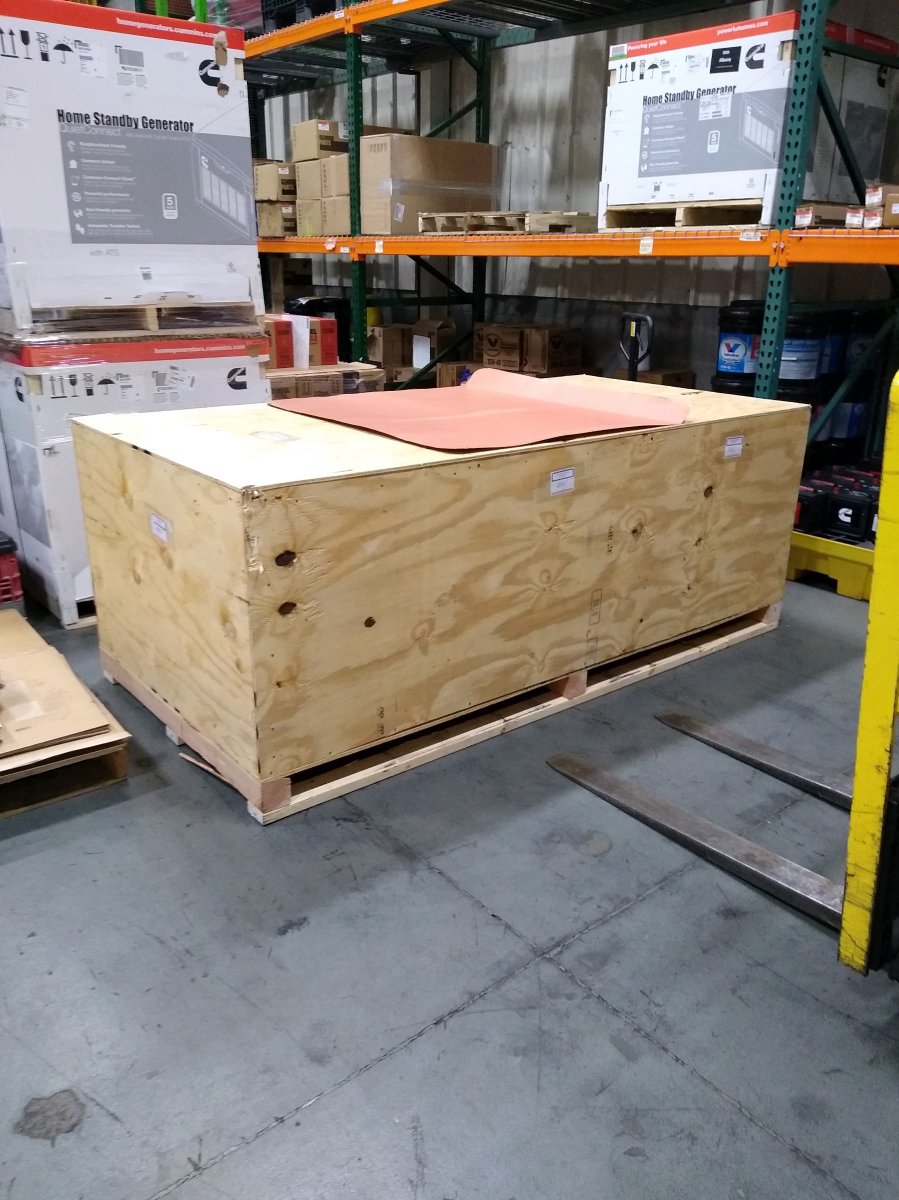

    Turned the giant crate into a thanksgiving table. Thanks because I was able to reuse my lumber and all the screws from the crate! Now to get some main body skills and rear sill from ford wood and start put body back together on my new frame table! Happy thanksgiving everybody!! 914C6E5E-B123-4FCB-9D02-F4F5FC564507.jpeg 5CD203DF-B605-4308-A5F5-91F9201255A0.jpeg

    Nice looking frame, if that is freshly blasted get some primer on it. Happy Thanksgiving! Bob

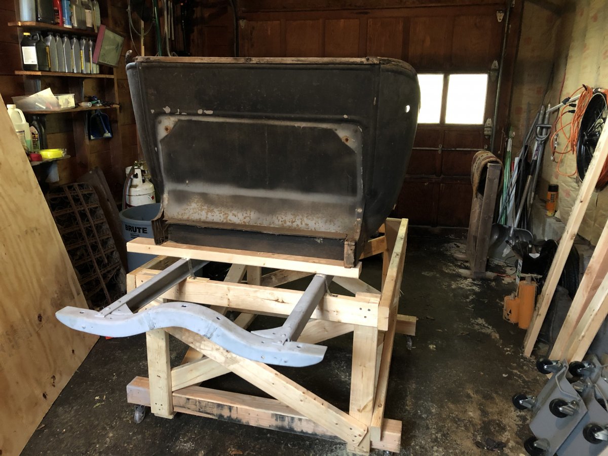

    B9EE2CD5-BCFD-4D2A-AC0F-4EAE413C1A03.jpeg B1ACF5DA-95F7-4F92-AD46-6086BA81B4D1.jpeg 57FF04EC-5925-49D7-9C43-EEAE0A807796.jpeg 9369A770-3CA3-4FBD-B301-B6D73681E785.jpeg The frame is in primer just for protection right now. Got frame level on stand and securely strapped down. Got the body up on chassis for the first time. This way the whole thing is mobile and I can roll it outside for room when needed this winter. Also now able to look at lower section of body better. It’s gonna need up to four inches replaced in some sections. Hopefully just the lower flange in others. B9EE2CD5-BCFD-4D2A-AC0F-4EAE413C1A03.jpeg B1ACF5DA-95F7-4F92-AD46-6086BA81B4D1.jpeg 57FF04EC-5925-49D7-9C43-EEAE0A807796.jpeg
