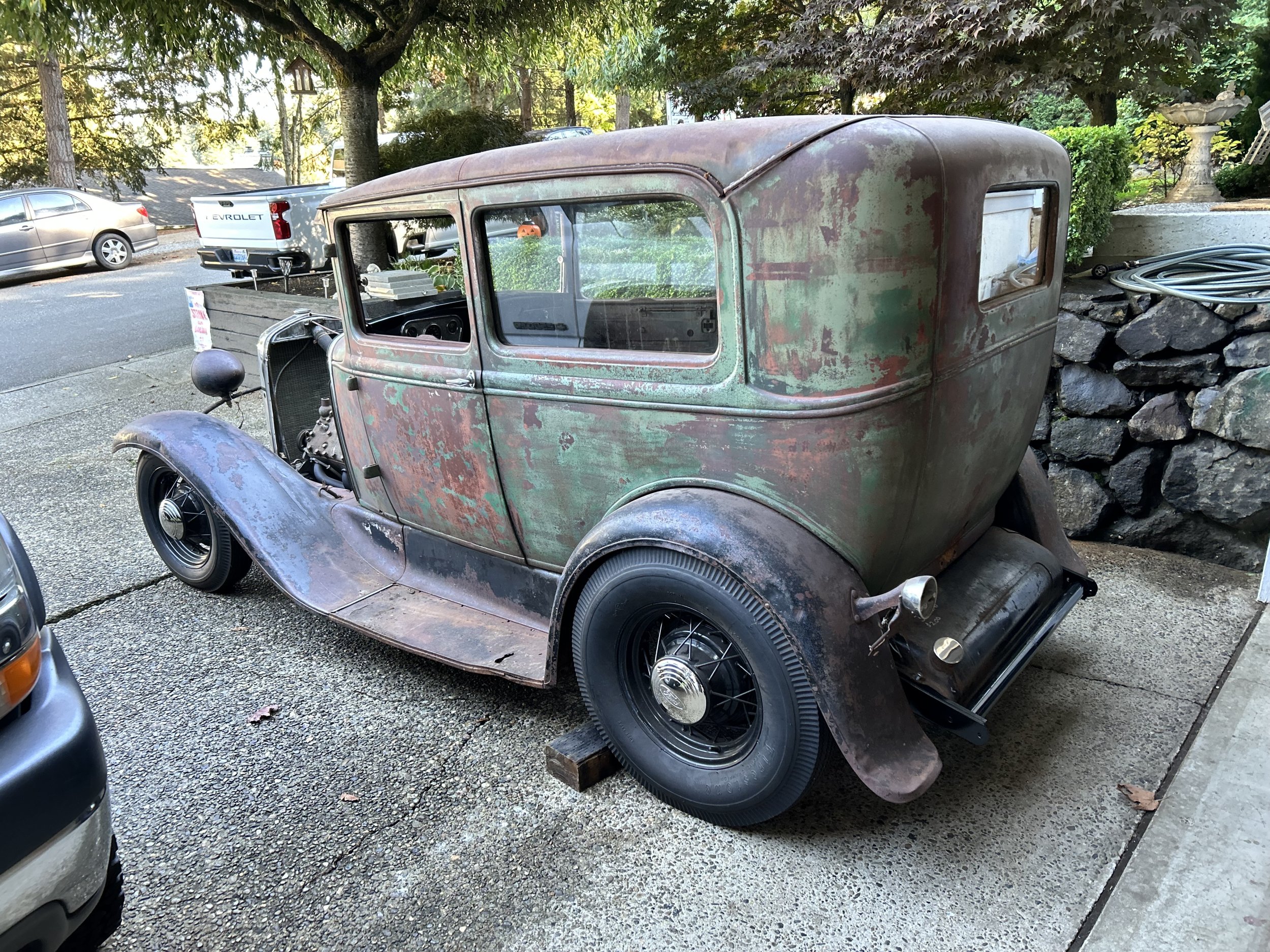

  5. Ottvw
    Joined: Nov 23, 2022
    Posts: 11
    Ottvw
    IMG_6619.jpeg Same spring as you with a stepped frame. I did remove a couple leaves and it’s a little too low
    dana barlow and Olds_Powered_29 like this.

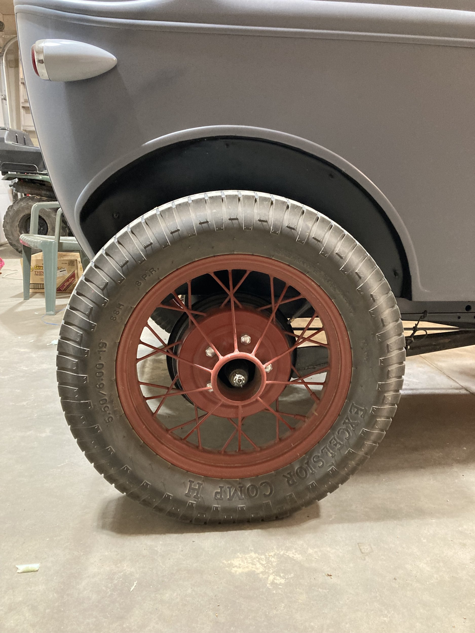

  9. Tim
    Joined: Mar 2, 2001
    Posts: 20,595
    Tim
    from KCMO
    Stock model A banjo rear, model T spring with normal eyes, 750-16 tire IMG_9862.jpeg
    1stGrumpy and Olds_Powered_29 like this.

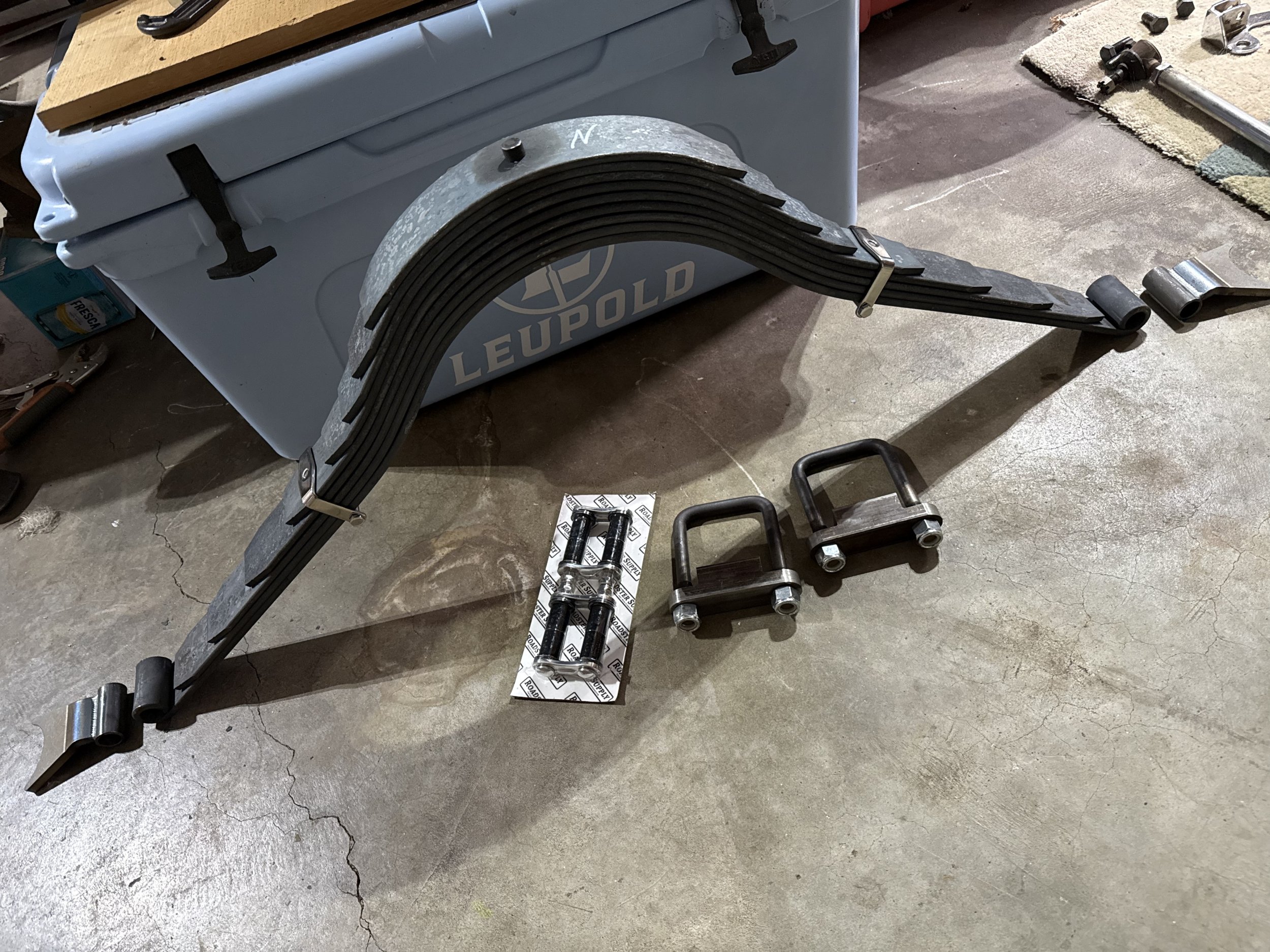

  12. Olds_Powered_29
    Joined: Sep 22, 2020
    Posts: 34
    Olds_Powered_29
    haha no worries! I’m definitely going to test it with just the spring first before pulling the trigger on a step. This is the spring. Still waiting for the rear to arrive and getting the tires, but like Corey above, once I get it I’m going to tack the hangers in and test fit. IMG_0675.jpeg
    Tim likes this.

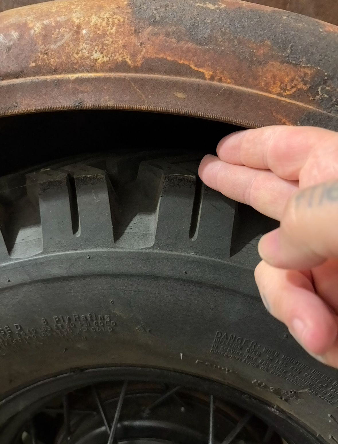

  16. 41blueoval
    Joined: Dec 4, 2009
    Posts: 38
    41blueoval
    This is a Millworks spring with 3 leafs removed 6.00x19 tire stock frame.
    Tim likes this.
