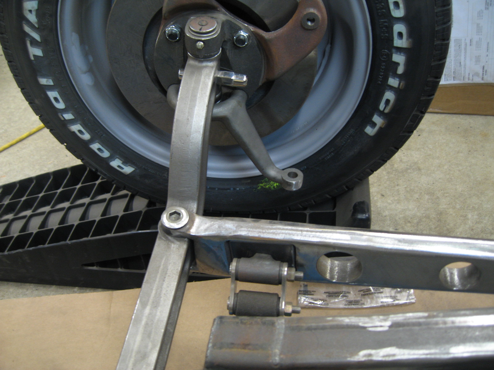

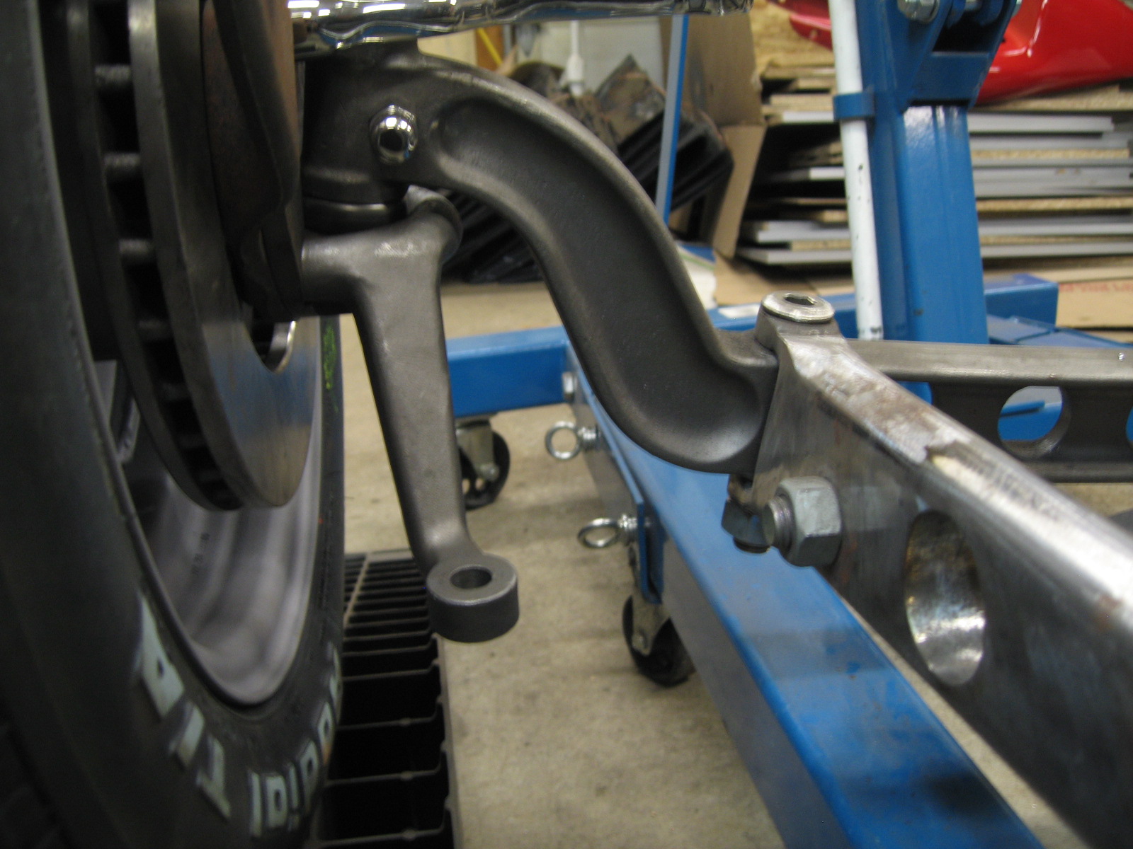

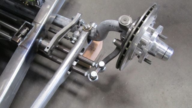

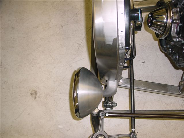

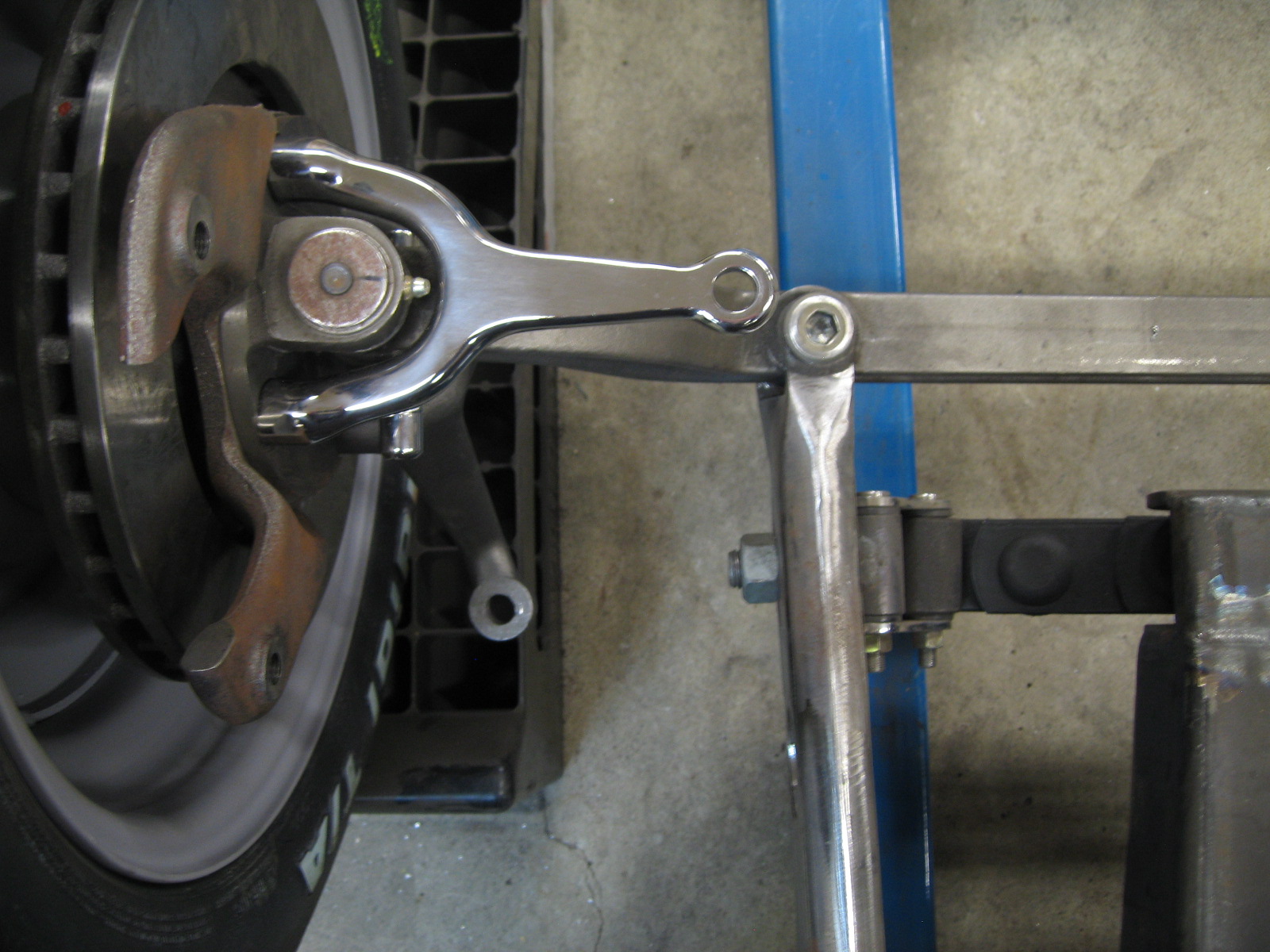

    As you may know from my build thread I have designed and built from scratch my own front suspension locating the axle out in front of the spring and having the spring mounted off the side of the bones I built.
    Using a forged 4" dropped axle I have the deep drop 3 3/4" drop steering arms mounted on my spindles.
    As you can see, the steering arms don't go low enough to let the tie rod cross freely under the bones. As well when you look at the pictures you can see that the tie rod would cross right under the spring shackles which will create some binding as the shackle tries to work.
    What I have in mind is to lower (modify) the steering arm eyes (where the tie rod mounts) by about 3/4 of an inch and also moving the eye back about an inch and a half.
    That would get the tie rod under the bones and clear of the spring.
    Would I encounter any problems in doing this ? Basically I want to know if it will work and be safe.
    The alternative is to run the tie rod across the top of the frame behind the rad, or to go out in front of the axle, neither of which appeals to me.
    Any info ,ideas, or suggestions ?

    From my experience those steering arms are kinda floppy to begin with and extending them would make things worse. Putting the center link out front may be your best bet.

    Based off the pictures, I don't think you will have interference with the shackles. Set it up with a tie rod and just the main leaf with a spacer to take the place of the spring pack to cycle it through a full compression and a left/right turn. I just don't like the tie rod in front, plus it isn't optimal geometry.
    If all you need to do is drop them a bit more, go for it. I don't think I would extend them any longer.

    The pictures may be a bit deceptive. I tried to install the tie rod for a test fit and could not get it in place, the steering arms were not low enough.
    As well there is definite contact with the bottom back lower part of the shackle which hangs down a small bit lower than the bottom of the wishbone.
    I do think I would have to go back a small bit to be clear of the spring.
    How much does a tie rod move front to rear as it cycles through the range of movement side to side ?

    That is never the best bet. It makes for an inverted Ackerman angle, which can produce downright dangerous steering characteristics.
    Re-taper the steering arms so that the tie rod ends mount taper up.
    If they already are, then use dropped tie rod ends.

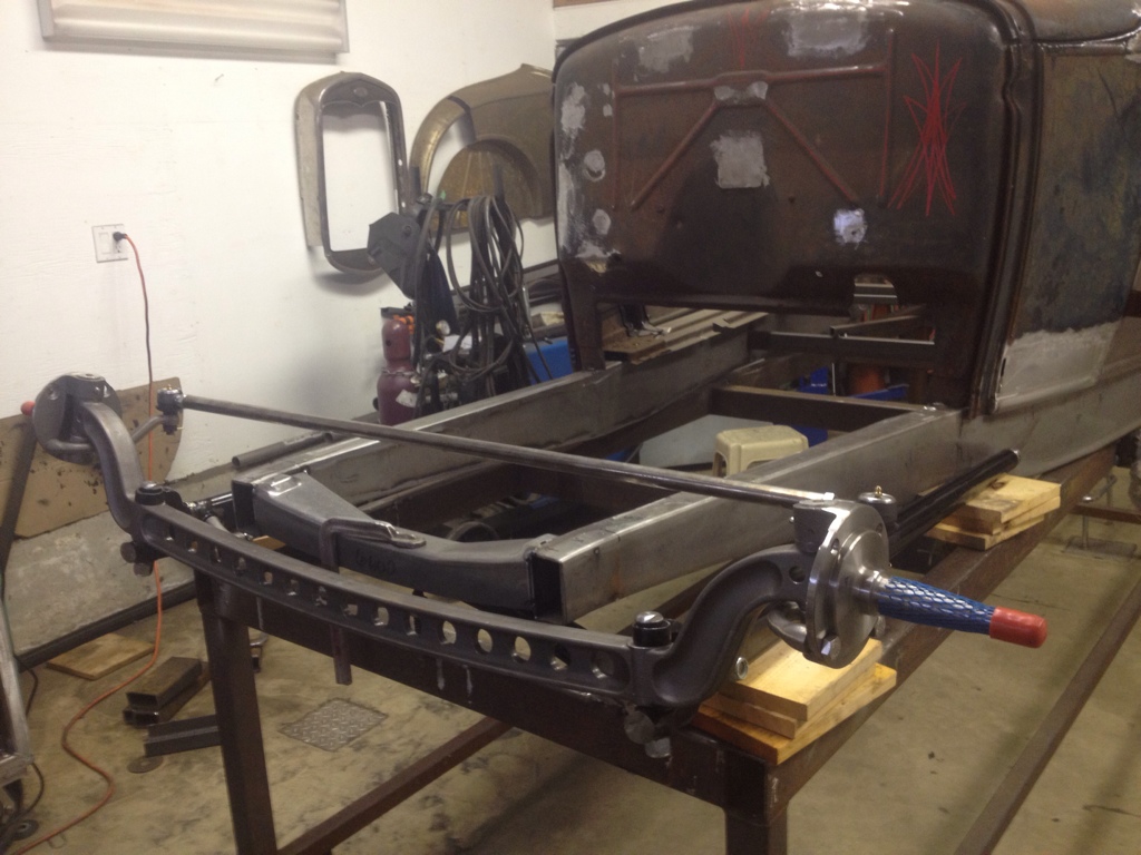

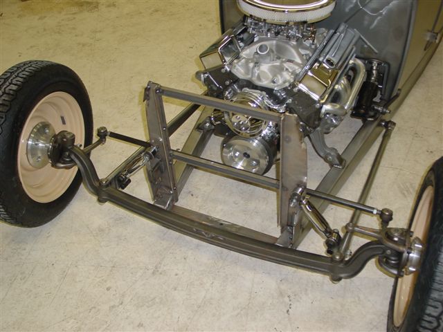

    I think you are right. Here are a couple of examples of the direction I am leaning towards right now, running the tie rod above the frame behind the rad.
    Shadow Rods does it and it has also been done by another HAMB member.
    I'm not sure if this is the way to go but it is interesting.

    I wonder how that would be with the rod over the frame with body roll on cornering.
    I agree with making your own and get the tie rod exactly where you need it, just remember to set them for correct Ackerman. Oh and none of this changes the scrub point. JW

    I have this exact same setup. Like you said everything is fighting for the same space. How much clearance do you need? Mine tie rod was rubbing the bones and really close to the shackles An 1/8" spacer between the rod end and steering arm was enough to make it work. It's really tight but it works.

    Blue one, how much are you missing the wishbones and spring by? I just walked out and looked at my "T", and I have the Speedway copy of those arms and a roughly 3" dropped axle, and hairpins and I'm still comfortably clearing this deal. I'm thinking that if it's just a smidge that your missing, go ahead and bend it say 1/4" more or so. I don't think I'd go too much more than that, but you really don't need any more clearance there than what is needed to turn.
    I also have to second Landseaandair's concerns about these arms being "floppy". I have been fighting just that with my Speedway copies of these. Yours however look quite a bit more robust than mine, so they might not present a problem. I am very seriously considering a small gusset on mine to stiffen them up a bit in the near future. Mine are supposed to be forged as well.
