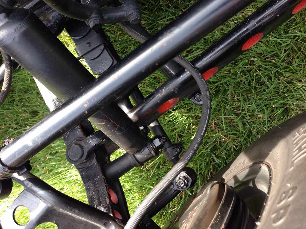

    This is a local car built by the Rolling Bones guys.
    Posted using the Full Custom H.A.M.B. App ****a!!!

    The difference between what the rolling bones guys have done on that car and on others and what I have done is my dropped axle.
    I have a 4" dropped axle which the rolling bones cars do not.
    That is why I need to do something different than they have done.
    Your picture should be in the rolling bones front suspension thread. :)
  15. I don't know if these guys aren't catching and just reading over the fact the your axle is dropped
    or
    If they just don't understand how and why the dropped axle makes it difficult.
    I had a discussion with a big name pro builder and we were discussing the topic of ride height. So I asked him what the relationship or dimension was "in side view "from the top of the frame to center of the spindle. He was confused and never thought about this relationship at all. To me this seems what ride height is all about - that relationship and its all ch***is at that point. It encomp***es everything you might need to measure or fab.
  16. It's just a picture man. If I recall correctly you already had to redo your rear suspension once because it didn't work? Stop trying to reinvent the wheel and go with what's proven to work. Remember, you started a thread asking for help...

  29. I took that picture because you stated concern about running the tie rod under the spring perches. This car has been on the road for many years and it seems to not be an issue. Yes it has an un-dropped axle. I am aware of that. I am also aware that you have a dropped axle.
    It would seem that you would have addressed this in the design phase as the tie rod is a pretty important piece of the puzzle?
    You state that you are not reinventing the wheel yet you opted to make all new parts rather than using proven Ford components?
    Don't let your ego get in the way of the solution.
    And again, my suggestions were only offered as help. Everyone should get to drive a hotrod that they have built.

    Very good, I'm glad we cleared all that up. I do appreciate the help or suggestions. When you first posted the picture it didn't come with much explanation at all.
    I wanted to build all the parts myself for a couple of reasons the main one being that I can ,and I dislike buying something I can build.
    I have broken down and bought a few components simply because the amount of work building everything can get overwhelming at times.
    I did address the tie rod in the design phase, as I said before, I built what I did because I saw what the Shadow Rods guys did and liked it.
    They also fab everything and only use pre made parts such as the steering arms etc.
    They run the tie rod behind the rad above the frame and I thought that possibly I could make it work in a different fashion.
    It seems like I'll end up doing it the way they did.
