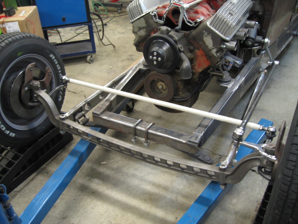

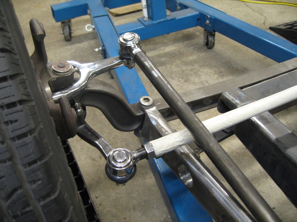

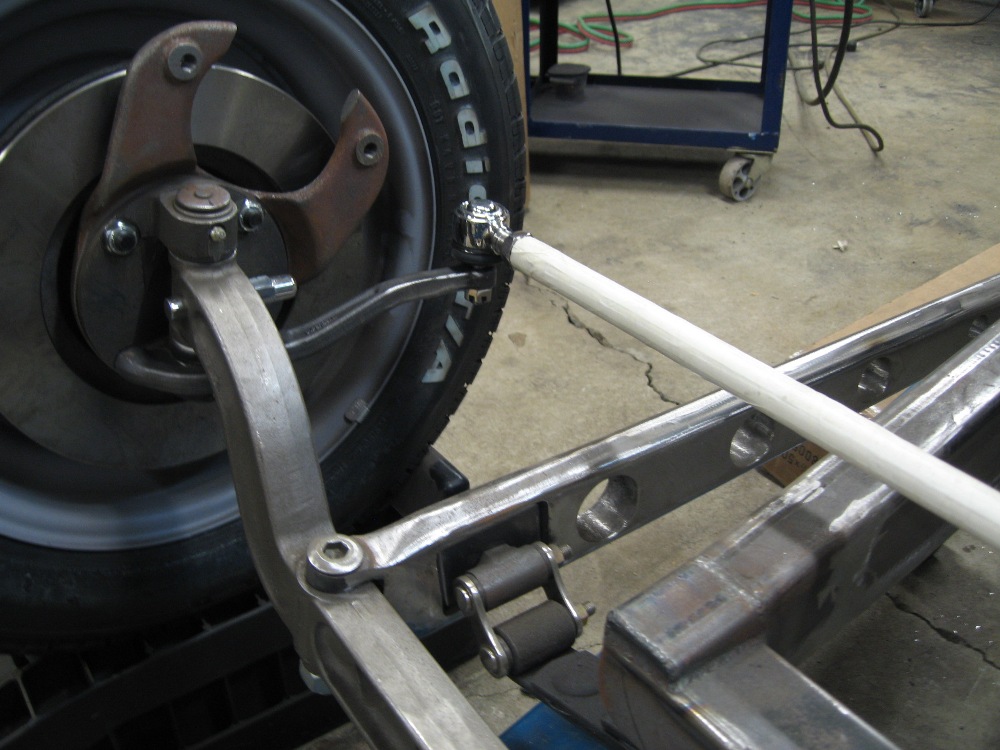

    I received the steering arms, just what the doctor ordered. :)
    I put it all together and I will end up applying some heat to them where they bend slightly down to bring the tie rod up about another 1/2".
    This is going to be needed to clear my lower rad hose.
    I tried the steering lock to lock and it looks very good.
    There will be a little tweaking, and the compromise will probably mean needing an electric fan.
    Seems that everything on this car is that way.
    Want to learn how to put 10 lbs. into a 5 lb. sack ? , build a T :D steering 002 (2).jpg steering 001 (2).jpg steering 003 (2).jpg
