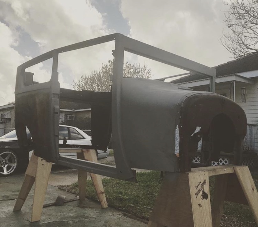

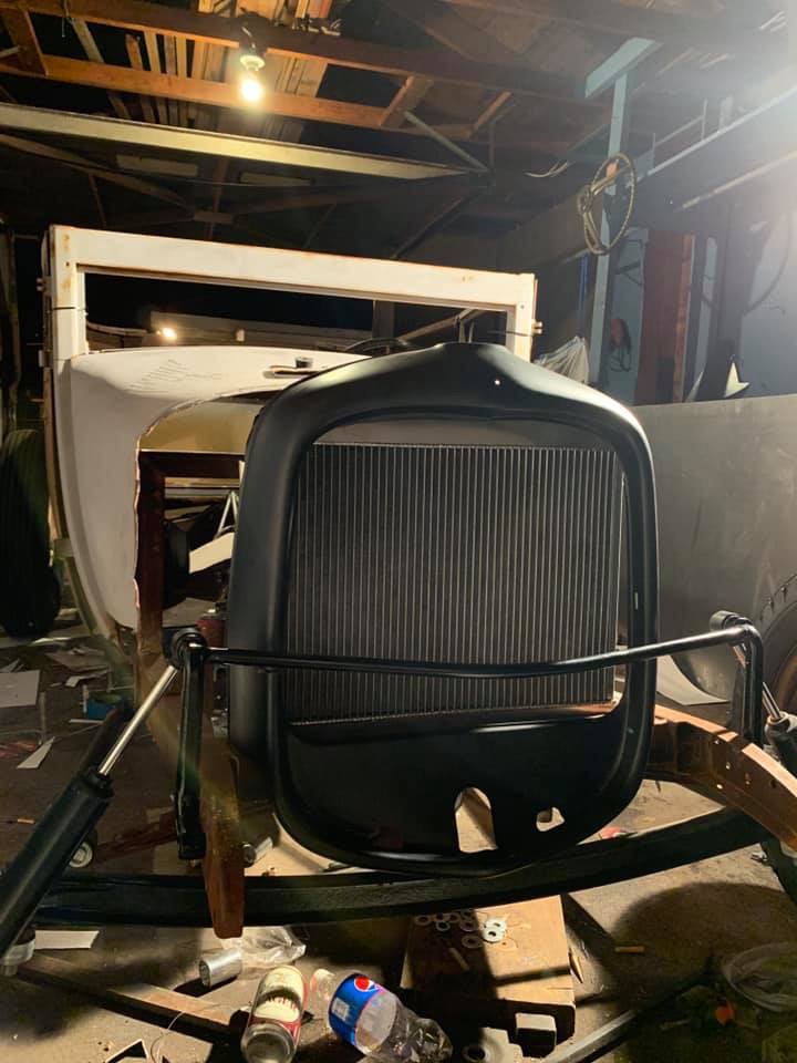

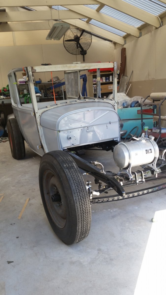

  1. Hey y’all! Haven’t logged in here in a long time but I’ve been lurking! I recently started building my tudor after collecting parts and piddling around the last two years with ideas. Shooting for a late ‘50s styled street/strip car. (Technically I think considered an altered from how much my engine is set back )
    Any who. I see a lot of T’s that are well built, but the proportions are always a mile off and that bums me out. I tried my hardest to nail the proportions on my car..I like it! These are the last few mock-up pictures, it’s getting town down for paint and finishing this week. Thanks and take care

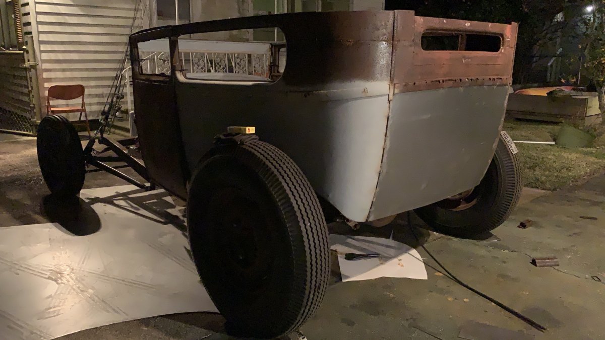

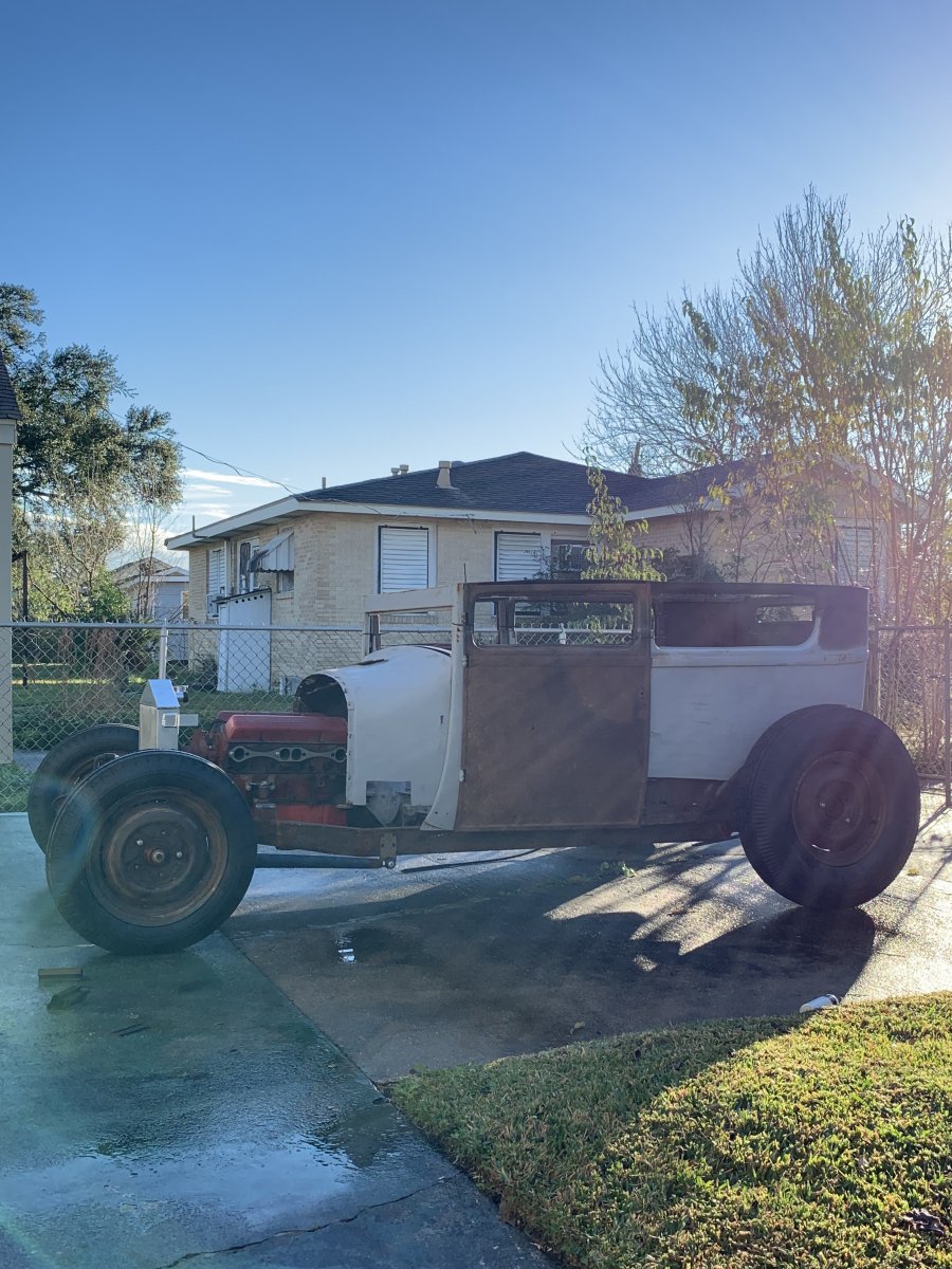

  2. Heres a side profile, and last of my grill I cut down last night for it

    love the profile... but IMO... I think the w/s header should be sectioned 2" to 3" as the windows are considerably taller... oh, and it helps the traffic light thing...

    Looks good except a little to much header.

    ^^^^ Have to agree with the guys above, please trim up into that windshield header!
    Match the windows height in the doors? With the w/s frame, it'll appear lower than it looks 'empty'... Traffic lights are a very real situation. Ask me how I know...

  9. Yeah that header panel is trimmed shorter than stock. I was thinking about t******* it more, but I think I’ll leave it, seeing is overrated anyways.
    I’m making my roll bar brackets tomorrow then the body’s coming off to get worked over with new patch panels and the works. Planning on having the whole car apart by tomorrow night to weld out my frame and get that in paint. Thanks!
    Ps. Still bouncing around header ideas...any ideas fellas? Thinking some staggered drag pipes

    Looks like you're off to a good start. I second A****er Mike's comment about the windshield header. You can take about 3" (if I remember correctly) out of it if you're careful. I did the same on mine and was able to keep the factory top and bottom so the frame would fit right.

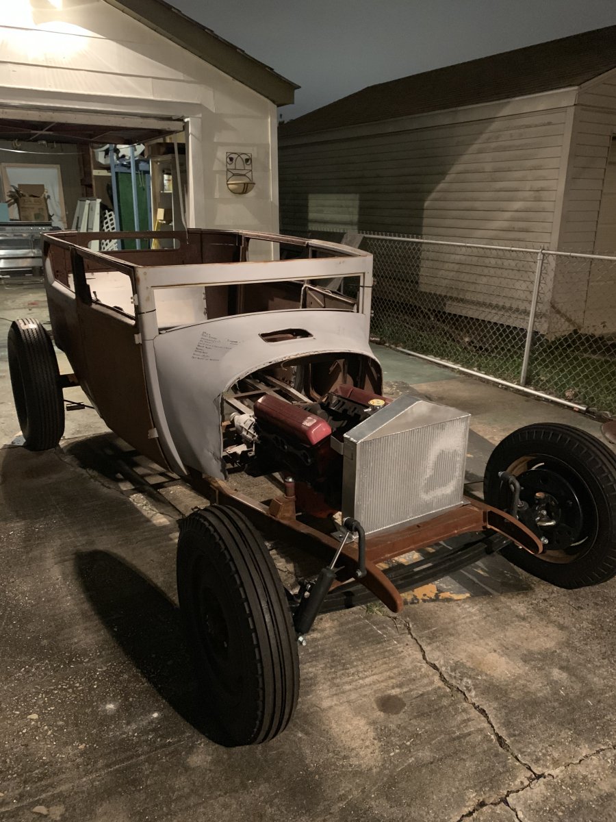

    That looks like it's going to be a great car! Your radiator looks like it's sitting a little high in relation to the cowl in this pic though. Do you have any blocks under the body yet?

  12. Thanks for the input guys! The header is staying, it’s actually not bad sitting in the car, and I like the look of having some “meat” above the windshield. A shallow visor might happen, we’ll see..
    The radiator is actually about an inch below the top of my cowl, my grill shell falls about a 1/2” below, to me that’s money...it might end up getting a three piece hood once it’s done.

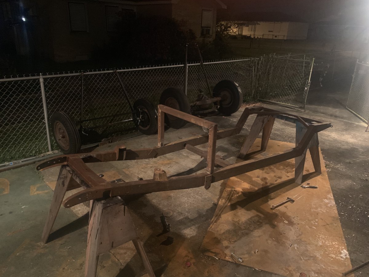

    The frame is in my garage now getting welded out, I have a few small gussets to add around my steering column mount, radiator supports and two legs to add to my cross member. Then it’s time to prime and paint it. During that time I’ll be freshening up my suspension components and getting that prepped to throw under my frame. Then it’ll be time to finish my body. Motors waiting in the wings...

  16. Checking in. Frame is DONE (well almost, I ran out of paint at 3am so it needs another coat.)
    Gonna try to have my suspension and fun **** all ***embled, loc***ed, and in paint by this week and under the frame.
    I’m tired.

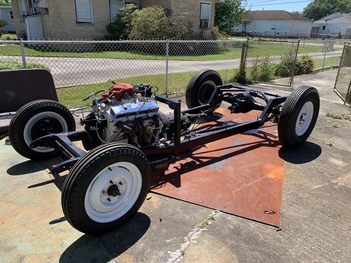

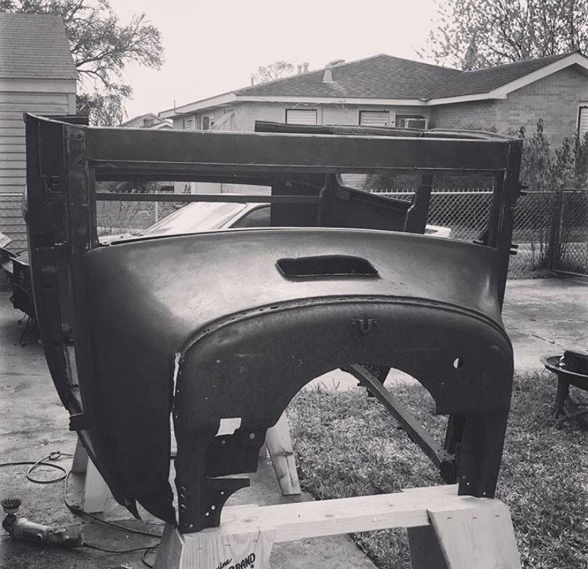

  17. Hey guys hope everyone is staying safe out there. I’m back on it, body’s up on horses getting finished this week; planning on joining the two here soon. Ch***is is back together! This was taken pre shock install. I need header ideas.
    Tim likes this.

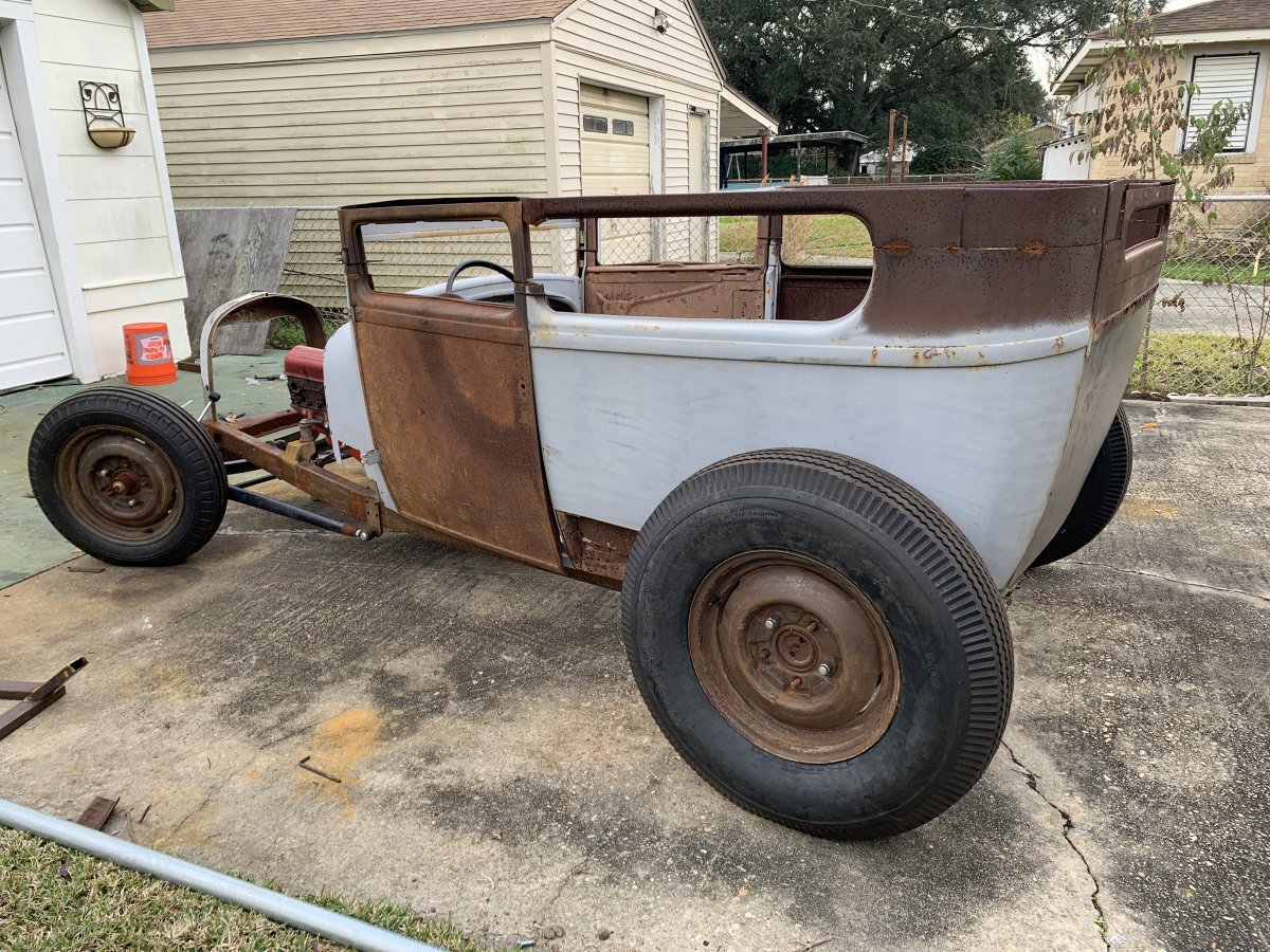

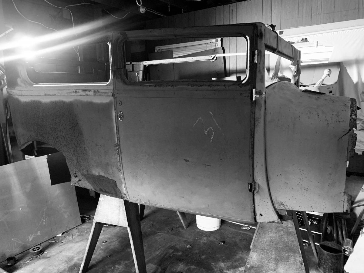

  18. Started lining up window frames and finishing the chop. Doors are hinged and opening (phone died before I got more pictures last night.) Scored the correct latches and modified hinges from an earlier T to work. I’ll be hammering down on it this week
