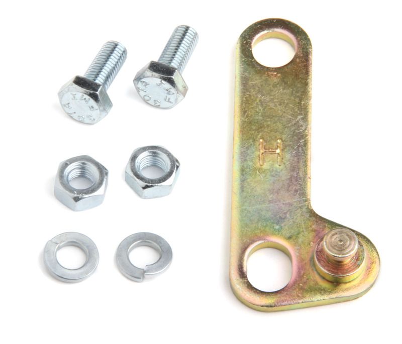

    So its a Holley base plate, and I have the B&M bracket that suits
    this some photos I found off the internet on how it attaches
    I have a TV Cable with this bracket
    This is the set up I have its the Original 1955 Oldsmobile accelerator linkage hooked to a Holley base plate.
    this shows the little bracket I made to space the original set up out to meet the Holley base plate.
    So can anyone tell me if that bracket for the TV cable that came with the TV cable will fit and work? or any way to get it sorted? I'm thinking I might have to make a new accelerator linkage , but I did like keeping the original one to be honest, but I really want this OD trans in the car and working 100%.

    The exact location from the pivot point(carburetor ****erfly shaft) as far as distance and indexed into the same location is what you are after. I happen to have a throttle body with provisions for the 200r factory connections for the cable. The pictures seem to indicate that you are on the right track. It will be interesting to see what others post. I am helping a neighbor of mine set up one of these currently but he is using an Edelbrock carburetor and the factory intake manifold bracket. I am sure you are aware that this is very important.

    The bracket I have seems to have adjustment in it but looks slightly different to those I have seen mostly on the Holley set ups.

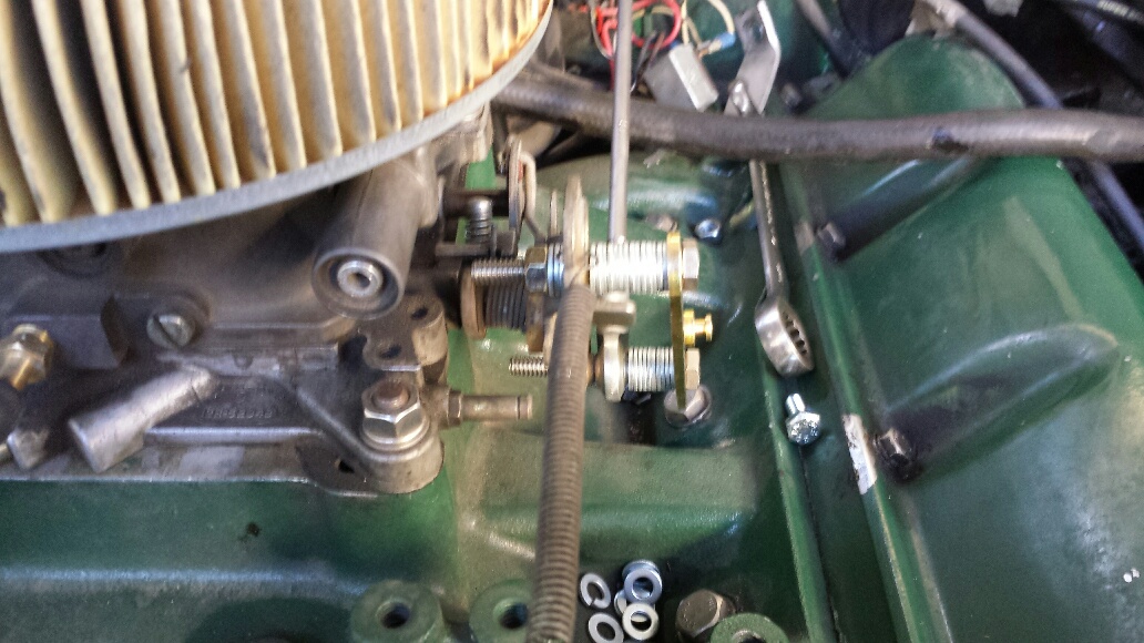

    Looking for some input. I have spent the morning trying to sort this out while I don't have the TV cable in hand, but trying to figure out how the linkage is going to work.
    My first attempt was direct to the carb with a single shaft which while it works when I got the Holley to TV bracket it was blatantly obvious , it wasn't going to work. sorry some images are a little blury
    So when I put the Holley bracket on I could see that the heim joint was going to clash. So I toyed with the idea of making a different bracket off the firewall that dropped the shaft down, but it wasn't going to work easily, I then thought of making a bell crank set up, to pull the carb back from the top up near where the top bolt is, again the bracket to mount the bell crank would be in line with the TV cable I would think.
    So my final thought was basically back to original idea but with the bracket spaced away from the carb, which should keep the right geometry for the carb linkage, not making it on an angle that it might bind, and also if I'm thinking right, I just need to space the TV cable bracket away from the carb too the same amount as the Holley bracket is spaced out from the carb.
    This looks like it works, but as I don't have the TV cable I can't confirm it. excuse the washers I'm just using them to be able to make spacing adjustments easily. I will make some proper spacers for this once the distances are figured out.
    So as it stands this is what I'm going with. looking birds eye view, I have decided that if I put the heim joint up against the throttleshaft linkage and then space the Holley bracket away from that I shouldn't run into any trouble with the TV cable bracket hitting the acclerator shaft the heim joint attaches to, but can anyone see any issues? Sure I know there are easier ways, using a cable throttle, but I don't want to do that. So, yes I'm probably making some trouble for myself, but hey, this is hotrodding.
    So any thoughts greatly welcome, I'd prefer to know things that might cause an issue now. Also does anyone know the width of the bracket at the area the TV cable attaches to it? as it looks like I have about 3/4" to the centreline of the bracket where the cable should exit. Which should mean if the TV cable bracket is less that 1 -1/2" across that it will not interfere with my accelerator linkage.

    I think you are on the right track. The TV cable is supposed to move the exact same amount as the throttle, hooking them in the same place should accomplish that. Only thing about using all those washers and spacing it out that far would be the possibility of flexing at the mounting point on the original carb linkage.

    I guess you aren't interested in changing a lot of stuff; the spacer idea seems workable; but it looks to me, that you would end up with a lot cleaner set up, it you eliminated the stock pedal and mouse trap and went with a later model cable pedal.
  24. Is the Holley bracket supposed to bolt to the corner carb bolt? It's hard to visualize this without seeing it mounted too.
    If you space out the cable nub, how will you space the bracket out?
    I see a lot of modern stuff there, but you're saying you don't want a throttle cable. How about simple Chevelle or Camaro pedal "pull" rod deal? That would solve a bunch of clearance issues. Maybe a Tri-5?

    The throttle linkage should go to the carb as it always has been connected. I don't think you have it connected correctly.
    The geometry corrector only provides the hookup location for the TV cable.

    Phil, the linkage so far will connect to the next hole forward from where it has been since I put the BBO its probably not connected where a Holley normally would be, but its worked for 8 years so I'm hoping it will still be ok with the TV cable too.

    Only way to know for sure is to hook up the TV cable and see if the travel is exactly the same as the gas linkage. I think I would cut the gap down between the rod mount and the cable to about 1/4" or less, just enough to keep the cable from hanging on the heim end.
    Ford did just the opposite on it's AOD transmissions the first few years, they had a cable for the throttle and a rod for the TV. I don't see why you can't use the rod on the throttle and cable on the TV as long as both move the exact same distance at the same time. That's what the geometry corrector bracket is for, there is not a spot on the factory Holley linkage that is exactly the same distance from the center of the ****erfly shaft as the throttle hookup, so you have to have the extra piece to have the same geometry, or pull on the TV as the throttle. They are ***uming a pull on the throttle at the top, and a corresponding pull on the TV at the bottom of the carb linkage. They are also ***uming you are using a stock GM cable and bracket, thus the offset design of the pin on the corrector bracket. Your last set up is pulling both at the same point, so it looks to me to be the same thing and should work fine.
