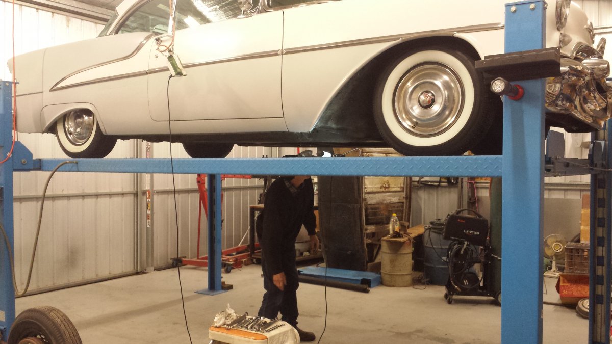

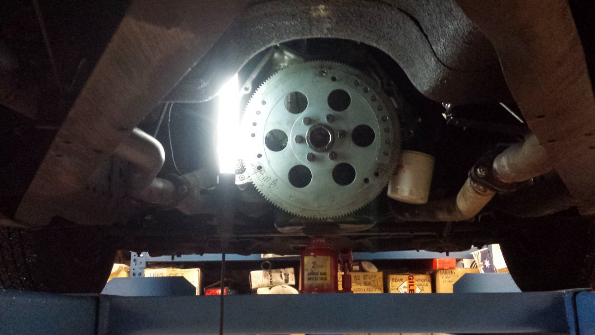

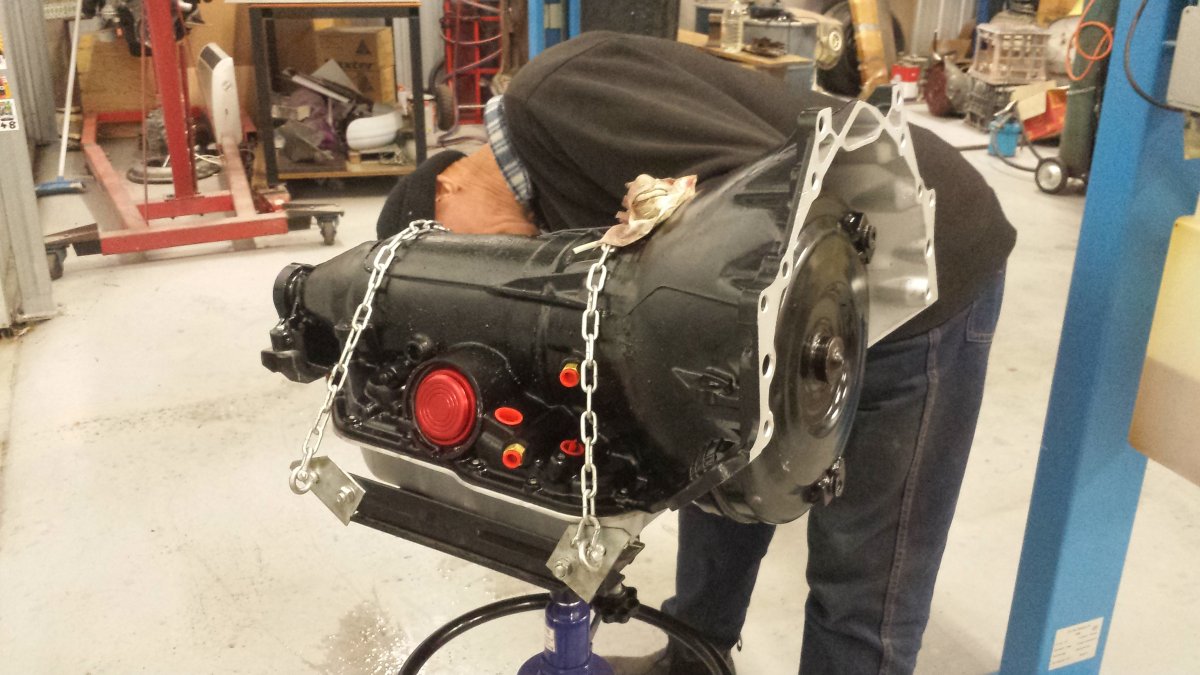

    Making a start in my fathers shed. He has a hoist so makes this stuff easier
    400 out.
    200 ready to go in.
    Its in now. So onto the TV stuff and the other hookups to finish this install.
