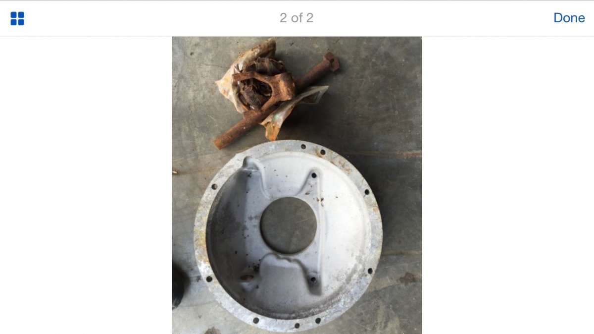

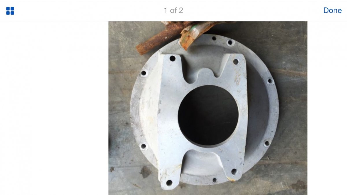

    Is this bell housing for a T5?
    I see the cross shaft hole, just a little confused on the differences..
