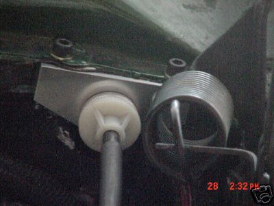

  2. That's what I have in the Ranch Wagon,smooth pedal & works great.
    I used the quadrant and cable from a 84 Mustang but any aftermarket kit would work.HRP

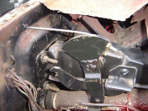

    As promised, :) here are the pics I have for the pedal mod to use a cable. The pedal assembly in this case is early Mustang, but would be a similar mod for other swing pedals.

  11. This is the cable going through the firewall in the wagon. HRP
