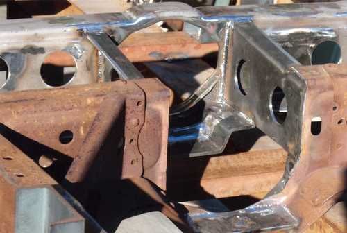

    The frame already had some torch work done when I got it, so it wasn't so bad on the heart to clean it up. It would have been really hard to cut a nice original K member for a T5.
    Pewsplace likes this.

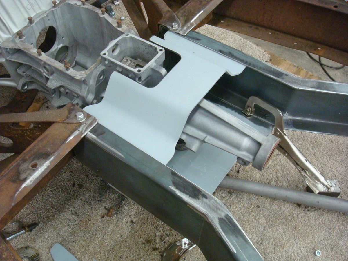

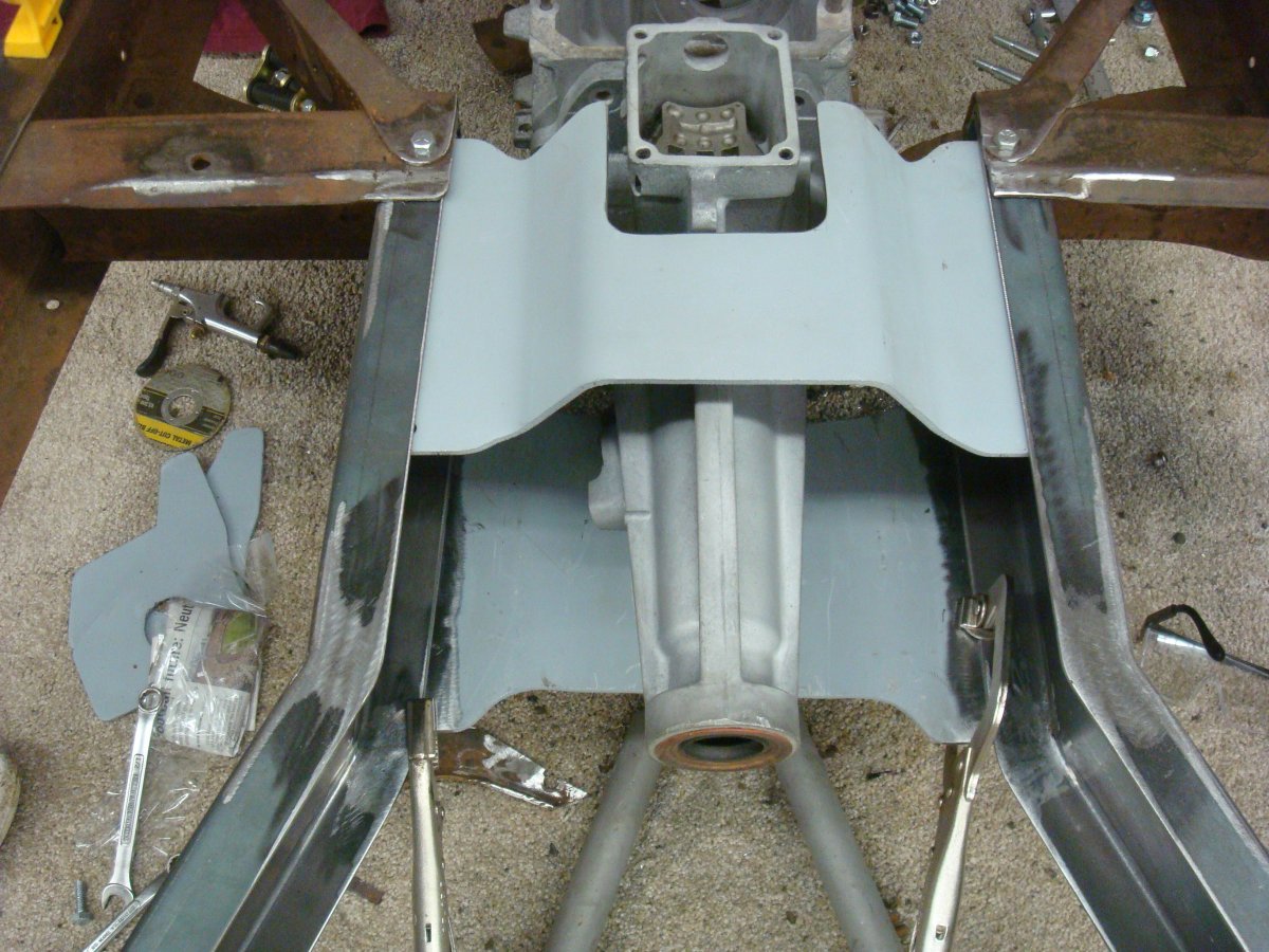

    Ch***is Engineering center mounting kit for '32 ford ES 2132. You will have to cut off the bar on the bottom of the T5 case that the anti chatter rods were fastened to. You will have to cut a fair amount out.

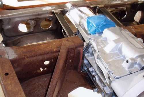

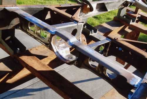

    Here is another way of mounting the T-5 in a stock ch***is. the builder used two K-members.
