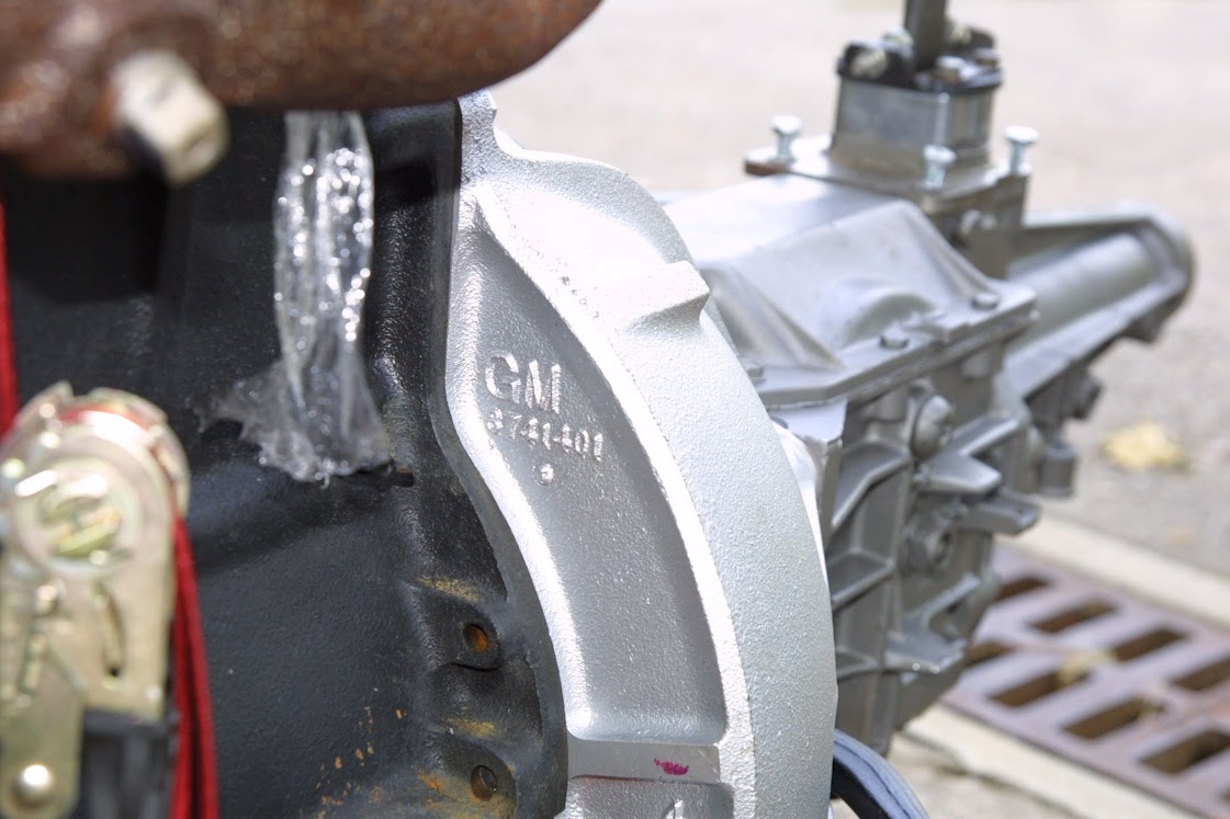

    The simple rear axle swap would be the traditional 55/59 6 lug rear end that will fit with changing the axle seats and I would suggest springing for a pair from cl***ic parts that locate the axle in the wheel well right and also set the ride height the same as it was with the stock torque tube drive. A few bucks to save a lot of h***les.
    Now to totally confuse you, I have an AX-15 out of a 96 V8 Dodge Dakota 2 wheel drive With a Novak adapter to bolt it to my Chevy bellhousing going in my 48. I sold the Dodge V8 Bellhousing on Ebay for most of the cost of the adapter. Not for everyone but it is an option. Screenshot (1519).png

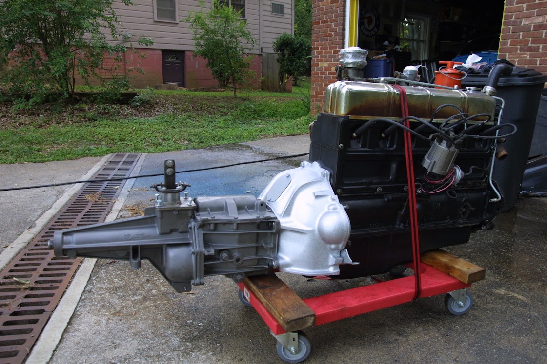

    I haven’t installed one but a friend shortened the input shaft, but think had to shorten the input bearing retainer.
    The trans bolted up to the original bell
    Used a disc for a 5 speed Astro van. Largest stock disc.
    There’s tons of info here and elsewhere

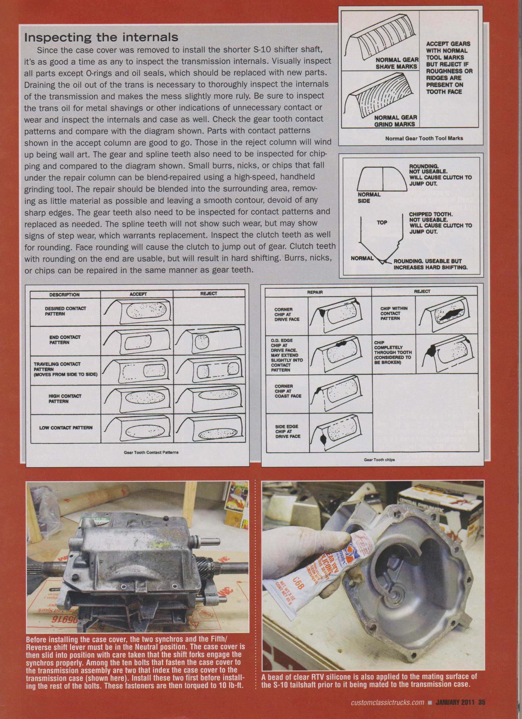

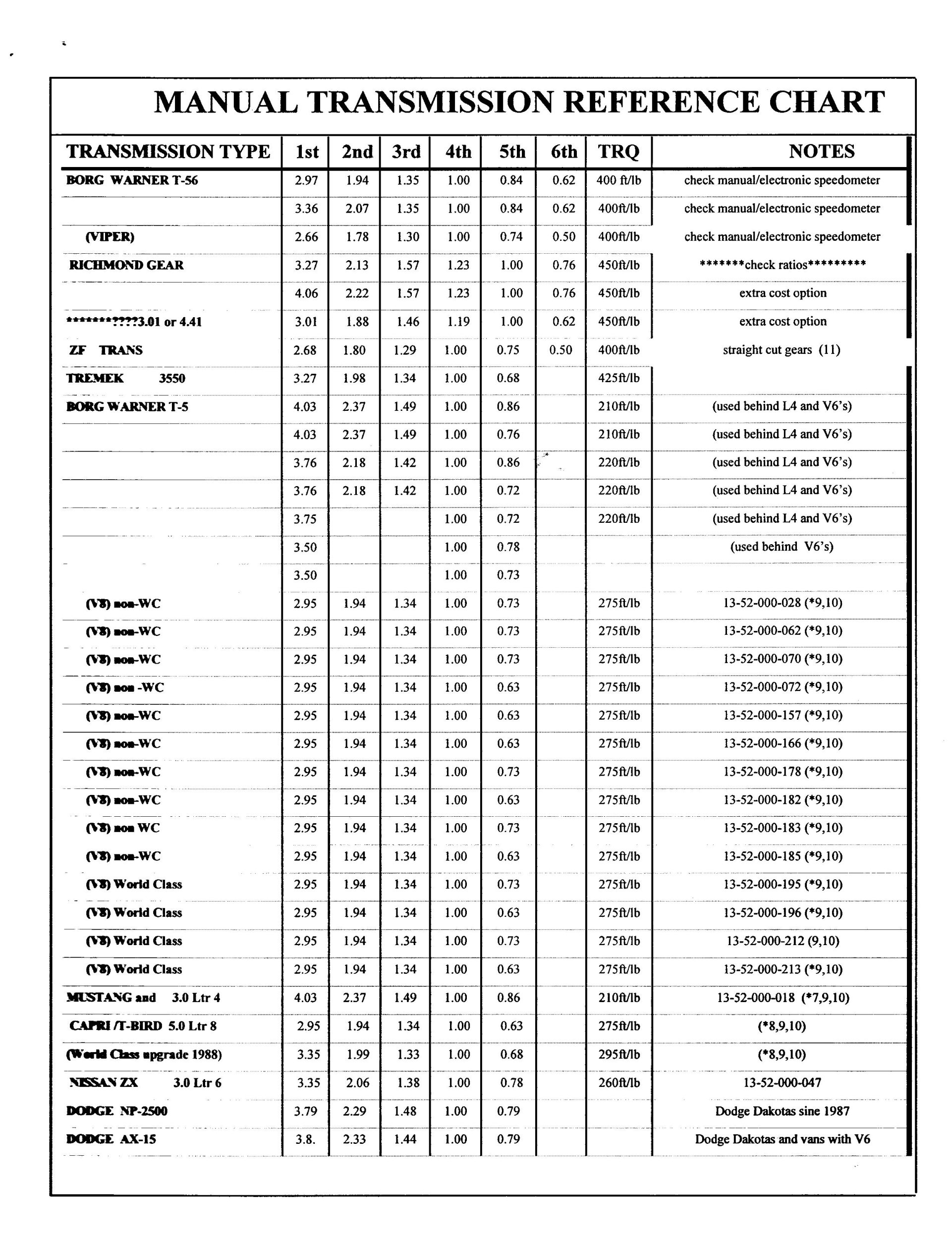

    Here is some info on the transmissions.
    Go to Amazon and buy a copy of this book. It will save you more than it costs and has info on the T5s. About $25
    I would contact Ky Clutch and ask them what clutch and disc and throw out bearing. They have rebuilt ones very reasonable, or they can supply you with a new one. I would just buy a rebuilt one for your conversion. 502 955 9173
