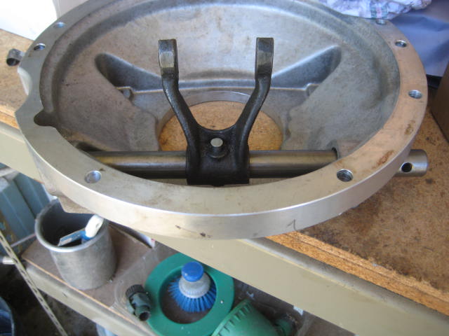

    So I have a new flathead T5 bellhousing and clutch shaft, both from Speedway. With the TO bearing fork centered the new shaft only protrudes half way (1/2") into the driver's side bushing. The tech at Speedway got right back to me, he is checking some other stock but says that's just the way some are. Probably work but what do you guys think? The drive side is right where it needs to be for the lever.
  30. RandyZ
    Joined: Jan 13, 2008
    Posts: 2
    RandyZ
    from murillo,on
    Mine was the same way 20 years ago. No problems other than the grease runs out of the bearing.
