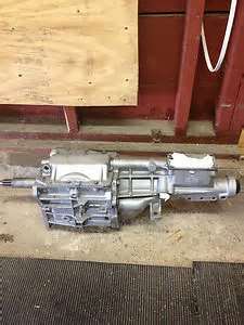

    Exactly! Mustang in THIS pic, for comparison. DD

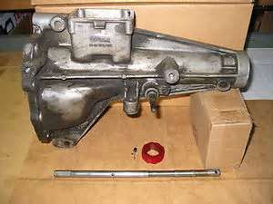

  16. This is the transmission case I used in my '58 Apache. I took a Muncie Rock Crusher out of the truck and the Astro shifter location was a near perfect fit where the Muncie shifter came up through the floor. I notched the seat frame for the Muncie shifter similar to one I saw in an old T-bird before having the seat reupholstered. The T-5 has served well for the last 10 years but needs some work due to over aggresive shifting by my son.
