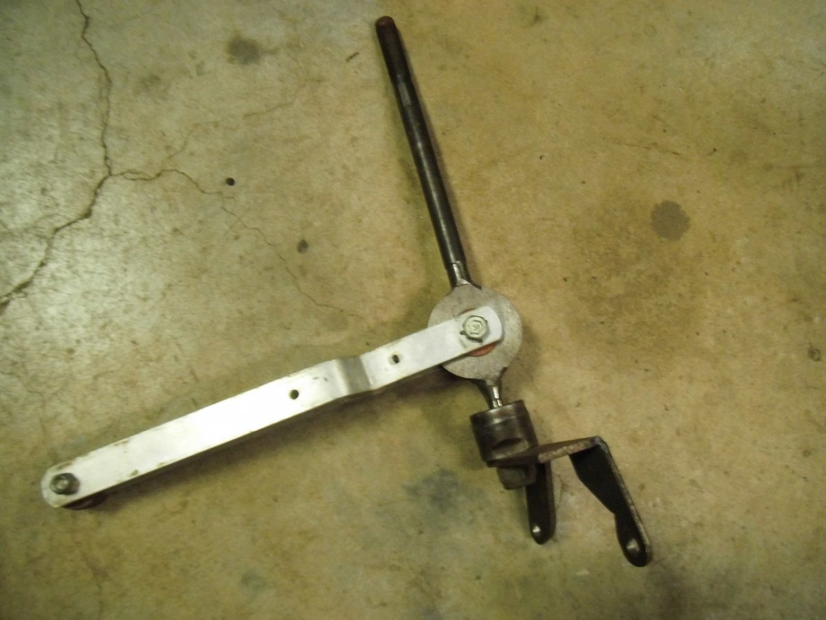

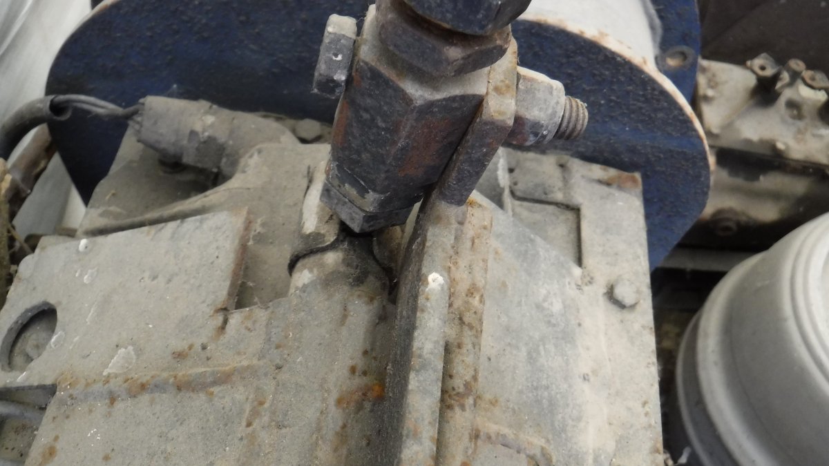

    This isn't my creation but I've thought about maybe recreating at some point. This was built by a retired mechanical engineer for his 52 Ford truck. He built it so the gearshift would be in the stock location. Looking at it I think the main thing is making your pivot points all on the same plane so the linkage doesn't fight itself. This is very smooth and you'd never know what was going on if you didn't see it. This is a Mustang T5 WC from a 1990 5.0L. I don't think I have any other pictures of it. 20160317_170003.jpg

    Corsa, that looks like my box, thanks for pics.
    The dip down of the shaft may save me from a bigger floor hump .

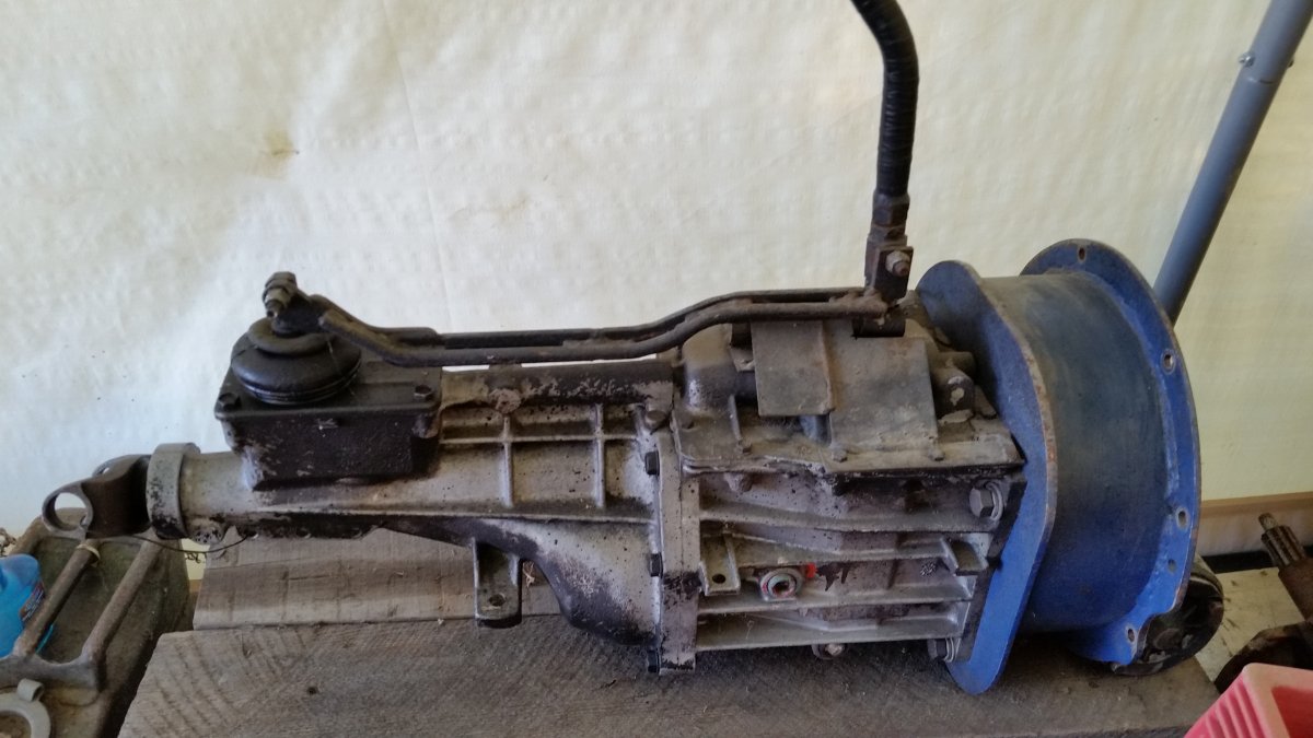

    The linkage can be bent into any shape you need. It is just an "imaginary straight line between 2 pivot points.
    In the above example the front pivot is very clever how it is moved up the shift lever [under the boot]

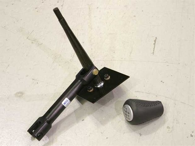

    Attached is how the shifter was done by Ford in my factory built FR500C Race Car when they used a T56R transmission [the bottom of the lever is a spherical bearing]

    Top pic is standard T5.
    Second pic is a T5 with an S10 tailshaft housing. Note the difference in shifter placement.

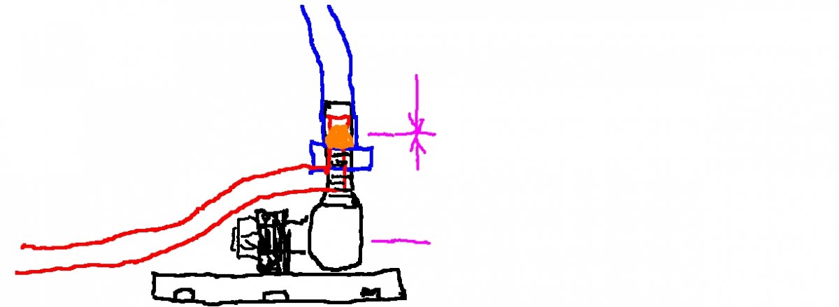

    I blew up the pic in post3 and I think maybe this guy has a tie rod jambed under the plate for a ball joint.
    That gave me the idea to maybe use a tie rod end, but vertically, so the shifter rod can screw on, and by adjusting it up or down, the throw fore and aft will be easily adjustable.
    A rough sketch....

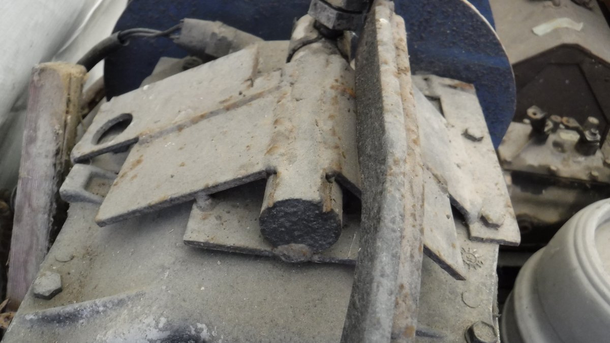

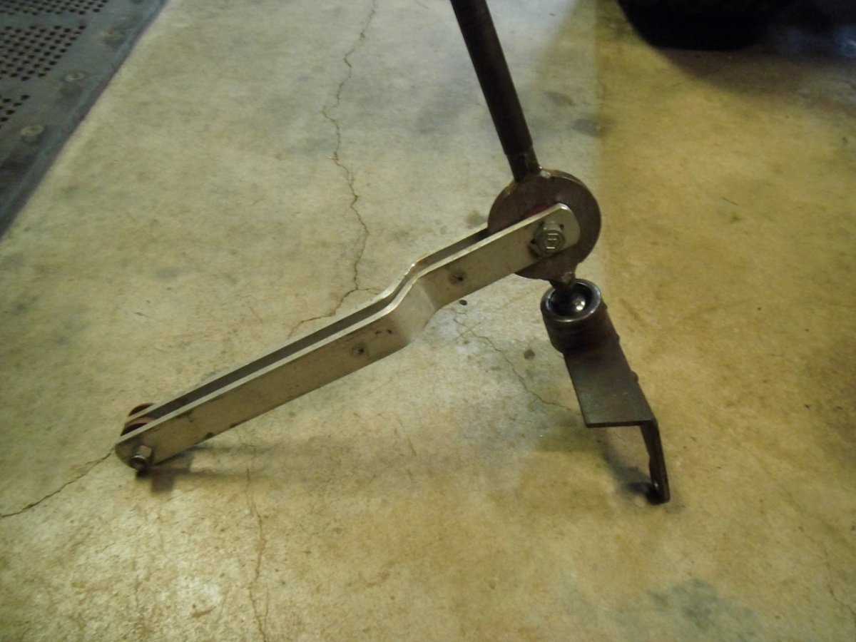

    I just fought my way through the snow to my parts tent to take some other pictures. This is actually super simple. Very crudely finished probably because the builder wasn't expecting to see it again. This could easily be made much nicer looking. It's about as low profile as I think it could be. I've seen the pivot before but I can't place where. I know one of you will remember. I thought this might be info others might find helpful even if it only gets their own minds thinking of a better way.

  22. DSCF2461.JPG Been there with the rack inner control arm,shifts beautifully ,just need to get it down a bit more.Machined up an 8mm disc,cut out the centre and welded to the shaft then fit fibre washers in between.Went the disc way so I could use a swan neck shaped shifter and that took care of any twist while shifting 2nd-3rd,and pulling reverse.I used the lower hole in the original shifter arm and cut the top off.I had the ali arms lying around and they worked out prefect. Just my take on it a couple of years ago,I like the other ideas about also.
